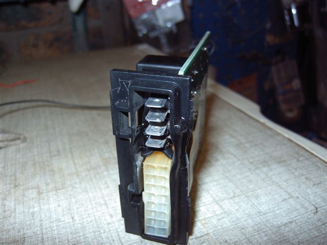

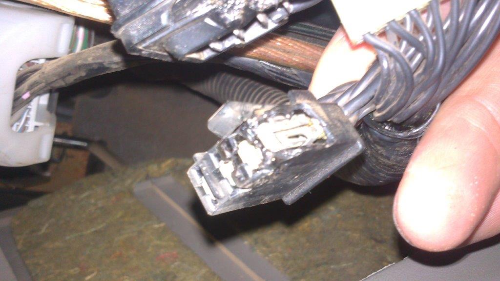

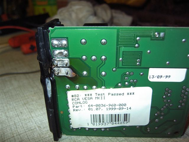

I have a problem with mine as well - is heat up and the plastic melt - I think the connection is not properly and I tried to fix it and will see if it is fixed now.

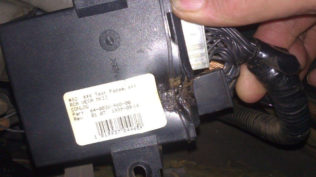

Re: 1999's Alarm Remote Replacement
Herrie,
I would install a nice thick wire from the connector pins going through the PCB to the other end of the copper track running on the PCB.
What you also need to verify is that you might be having a bad crimp on the mating connector (wire side) that is generating the heat which gets transferred through the pin in the picture.
On such a high current interface you need to confirm both sides.
Bruin Beer

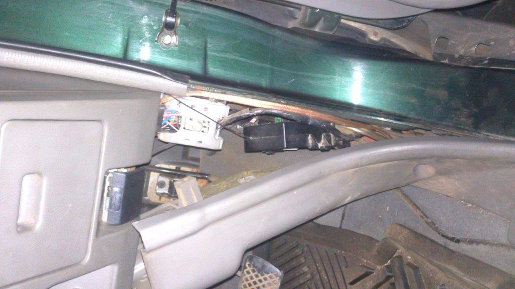

Hi Florian,
You just have to take the panel right side of you petrol pedal out and if you loosen that rubber that seal you door you will find the wire for the remote signal and that wire is connected to that unit and you will find it then.
Some more photos:
Thanks Herrie! With that even I should find it - but: I had that panel already removed and at least couldn't read any conlog-sticker on any box. But I will try again and report.
Best regards and thank you again!
Florian
