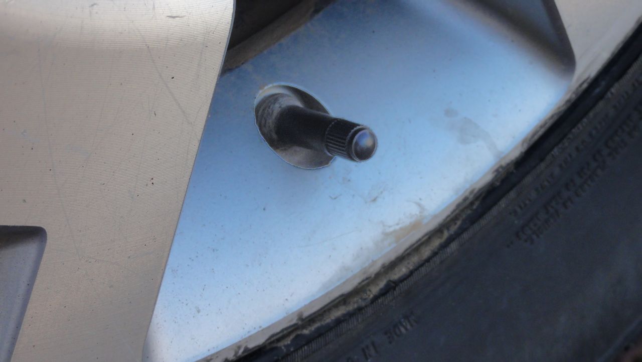

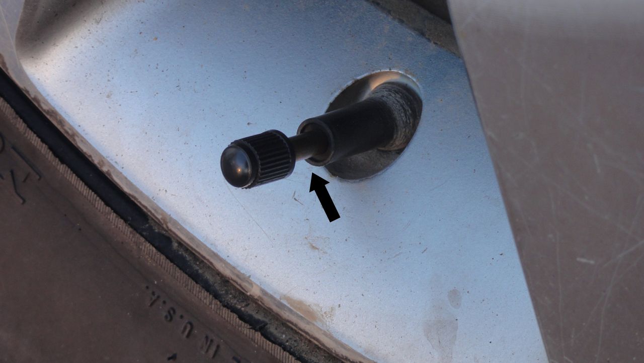

Have not been active for a while, but had to share this with you.
Recently did a 2 500km "zig zag" trip between the West Coast, Upington and back - all via back and farm roads.
Found that my left rear tyre kept on loosing pressure, like less than 500mb per day - so nothing to get anxious about, but still.
I constantly checked for a leak of some sort, even putting some moisture on the valve opening - but nothing obvious.
Until at a "pit stop" about halfway between Pofadder and Niewoudville and some 90km due West of Brandvlei (as the crow flies) I decided that the tyre pressure is just not right - something did not feel right. You know, you "mos" sometimes get that feeling...
Anyway, I hauled out the compressor, connected up the air hose and pulled on the hose to get closer to the power point, when I noticed this continuous hissing.
Thinking it was the normal deflating that you get when you connect the air hose I did not take notice until I got back to the tyre and I was just about to switch on the compressor.

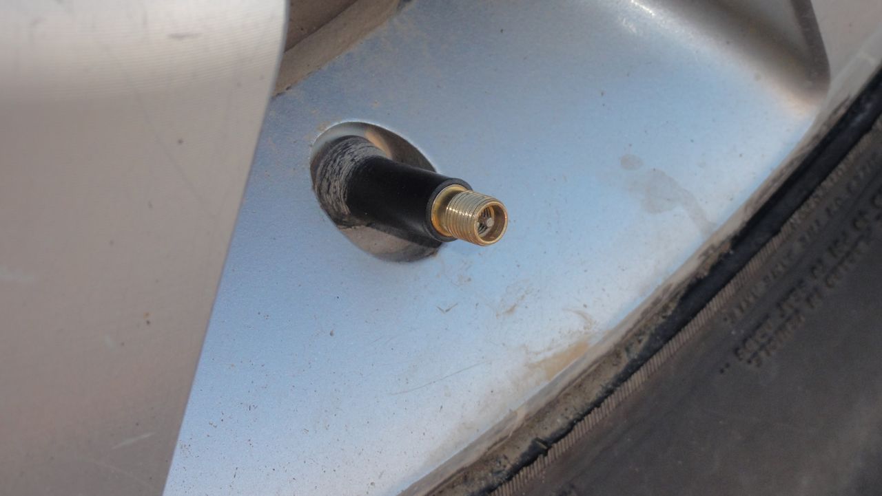

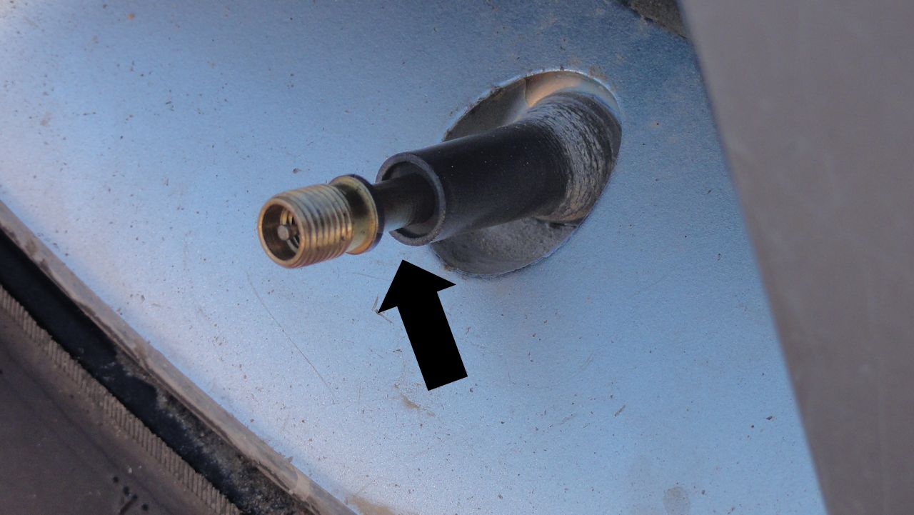

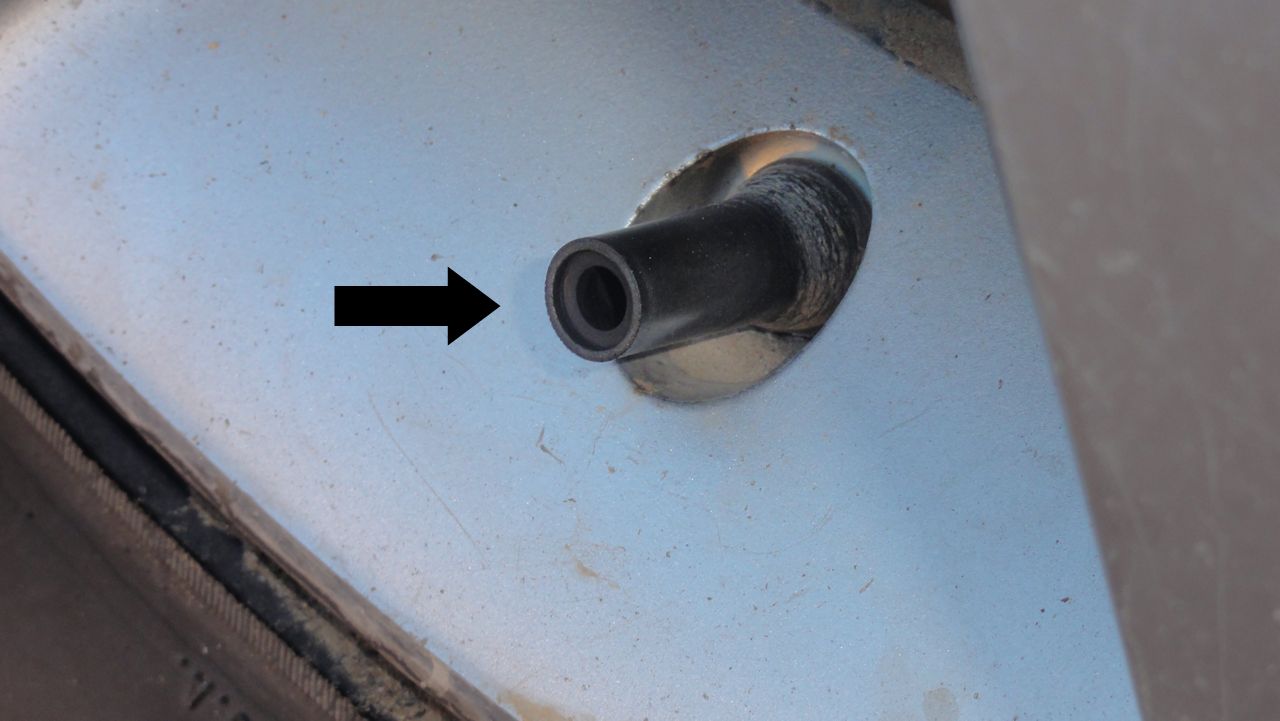

Low and behold, the metal insert of the valve was actually busy coming out of the rubber valve body...
As I touched it, it popped right out - imagine it happened at about 100km/h on one of those dust roads...
Thanks for that little voice inside my head...
Listen to it... you might just live to tell the tale...

How did you fix it?

Hi there Herrie...Herrie wrote:How did you fix it?
Used some glue from my "patch kit" as a temporary measure.
But I replaced that wheel with the spare just in case and had the valve replaced when I got home.
