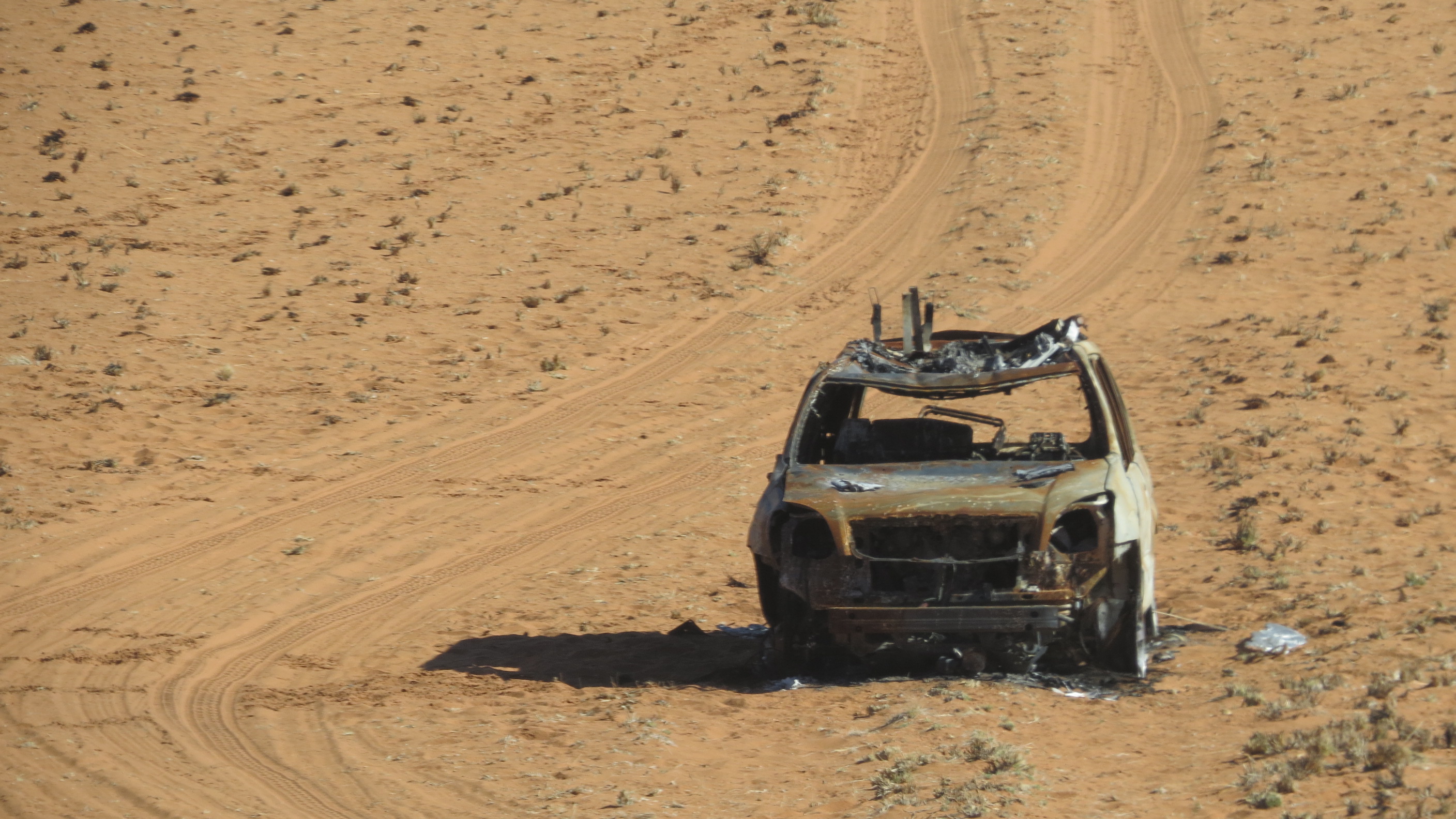

I don't know if the flammable fluid dripping onto the wrapping will get saturated and still reach its flash point.... I think as long as there can be NO liquid touching the exhaust, all should be good.Alex Roux wrote: One of the causes of fire is dry grass collecting on the pipe, also flammable heated fluid (such as break fluid when hot) dropping on the hot exhaust or manifold.
So to minimise these risks, covering the pipe may be just what is needed.
As for the grass, yes I think this will definitely resolve something like that.

I have been trying to tell the PRADO owners -- only reason why the PRADO catches fire is that exozt crossing over to th eright side [on the V6 models] -- That is the reason i am looking for the 2-inch asbestos tape
