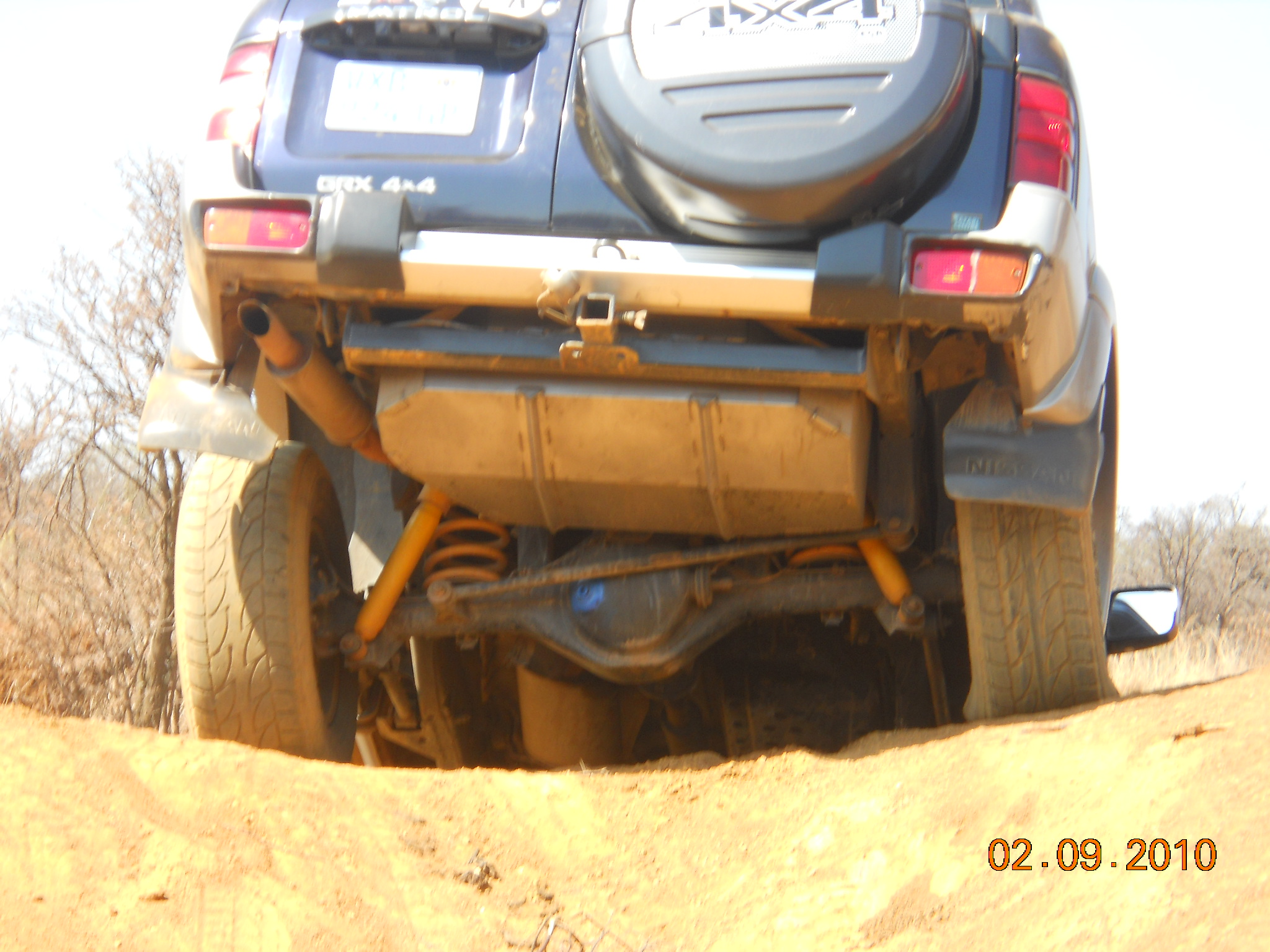

I had my standard tank replaced by a 140l tank by Safari Centre. There was a whole debate about tanks on the forum at the time and I was very scheptical before deciding. They guys assured me however that I won't have any problems. Will have to wait and see....!
With the 140l plus the subtank's 30 odd liters I manage about 840km. Because of the 285/75/16's I was told that my distance will under read by about 7%. Add another 50 km actual distance. I also found that when the vehicle is almost emty, starting to miss/hoes../proes...!, it took about 150l to fill up. Thus there was still about 20+ litres in the tank (+- 100km)
My car was at SAC last week for a service and they have managed to lower the pick-up in the tank so that I can try and get access to the last 20 odd liters. Will only be able to report on the improved range in about 800km.
In the picture belo you can clearly see what it looks like..!
- Charlkos 111.jpg (818.46 KiB) Viewed 3633 times
