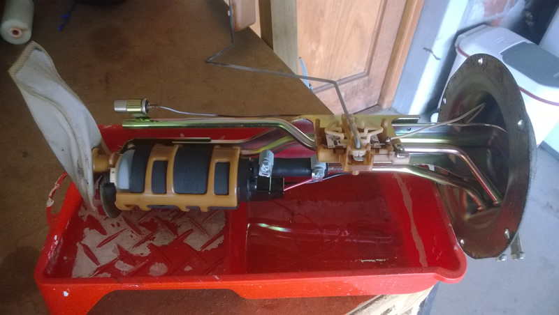

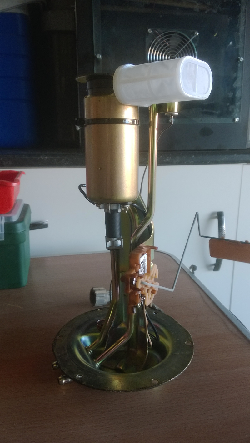

My pomp wat ek gekry het ly identies soos die wat op die prente is wat jule verskaf het. Ek het nou my pomp uitgekry maar dit is aansienlik kleiner fisies as die wat ek gekry het en die krag koppeling is met n plug nie sulke aparte pole nie??????
Nou wat gemaak? Customise ek nou maar die storie om te pas? Lengte is dieslfe alhoewel ek sal nie die plastiek raampie kan gebruik nie. Ek sal ook die krag proppie moet knip om aparte konneksies op te sit.

Prior to this I have replaced the Fuel filter. Cleaned the Airflow sensor and had it on the dyno which improved the situation a bit just to return again not too long after.
I decided to go ahead with snipping cables and the rest last night as the pump I found was an aftermarket (Walbro GSS250) already along with the power connectors that was soldered on. I got it installed back into the car and so far results are looking promising although I have not taken her for a proper drive to get a real idea. Some before and after pics.
Thanks to everyones input. This forum absolutely rocks. I have saved many moola in terms of suggestions on how to repair something or finding alternative replacement parts thanks to you guys.

If the top pic is the "before" and the bottom pic the "after", that pump was replaced previously. Top pick shows "screw" hose clamps not used by the manufacturers as OME. Maybe the pump pressure is thus not sufficient for the big motor?
Phillip
