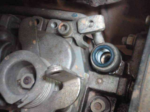

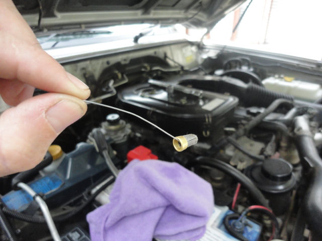

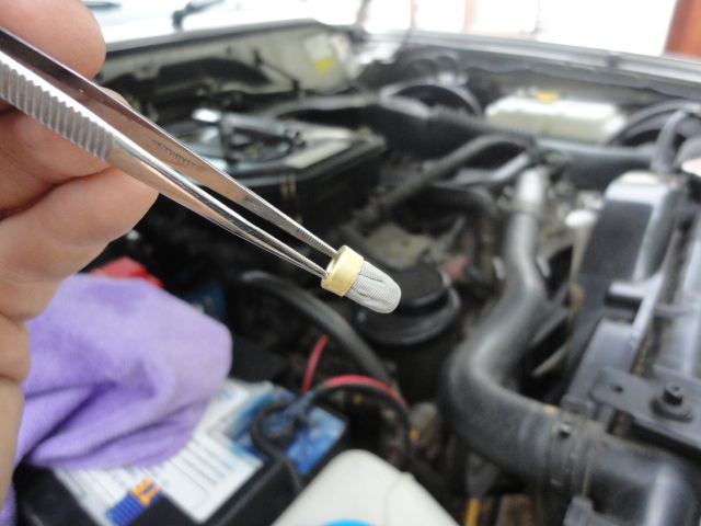

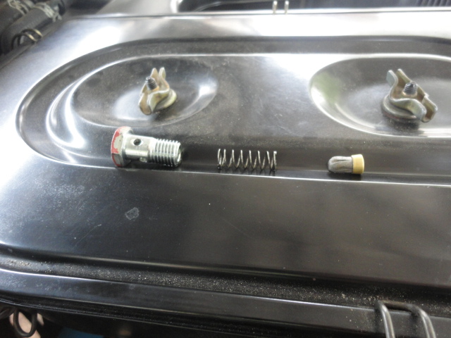

Read up on these symptoms on the Auzzi Site.. lead me to multiple threads on the same subject and most pointed to a small filter on the fuel lift pump call a banjo filter. It sits right below the bajo bolt on the radiator side of the pump and is easily removed by means of a small hook, or tweezers.
Turns out mine was hellova blocked up!... i cleaned this out with compressed air,...refitted, and bobs your gay brother... SORTED... vehicle ran like a new Patrol!
I was so scared that dirty fuel had made its way to the injector tips, but im pleased to say that Nissan peeps were thinking clearly that day and designed this little gem of a part.
Check yours, it take a minute or so to do.
Heres some pics.
Check Your Banjo boys.... trust me... pics added

Re: Check Your Banjo boys.... trust me... pics added
Thanks Russ, That last pic look like Dr Rus was performing a little surgery....
I will check mine too.
