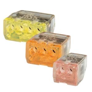

Have a look at this:
http://patrol4x4.co.za/viewtopic.php?f= ... ght#p26135
I have also done my lights. Cost me no more than R200 for connectors and bulbs. I used these connectors:
Put some silicone in to prevent a short in water. I also put some nice LED bulbs in. You can order the lights from Aus with connectors and light fittings. Not sure what the cost is.

Marino - what type of connectors are those that you show above? I dont know of them.
