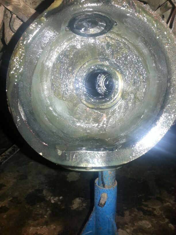

I stripped off the hub components to reveal the culprit, and upon removal I could see that the old seal was damaged on installation already. It went in at an angle and it was simply hammered home, which bent the lip quite a lot and there were scoring marks on the seal as it was forced in at an angle.

The culprit...

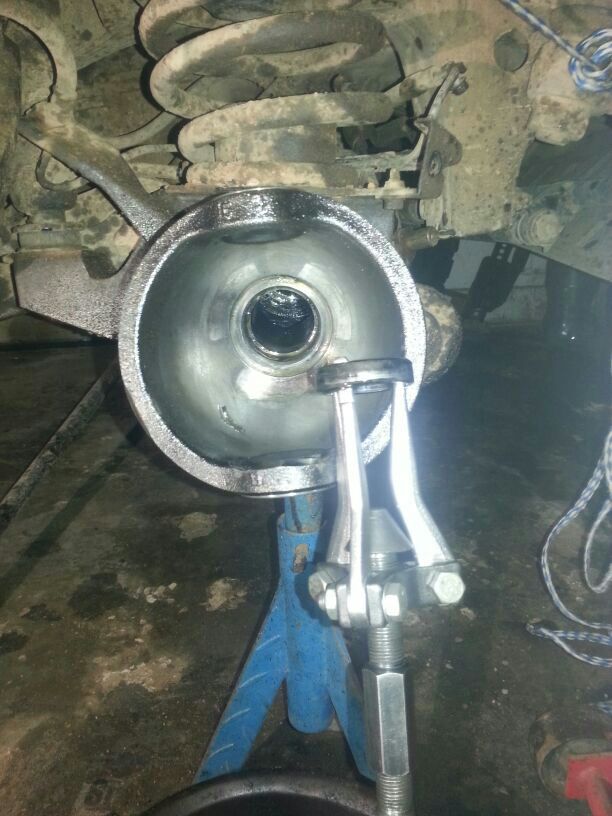

Seal easily removed with an internal puller from my local Coastal Hire, which is not only run by a friend of mine, but also conveniently located right next to the complex where I work :wink:

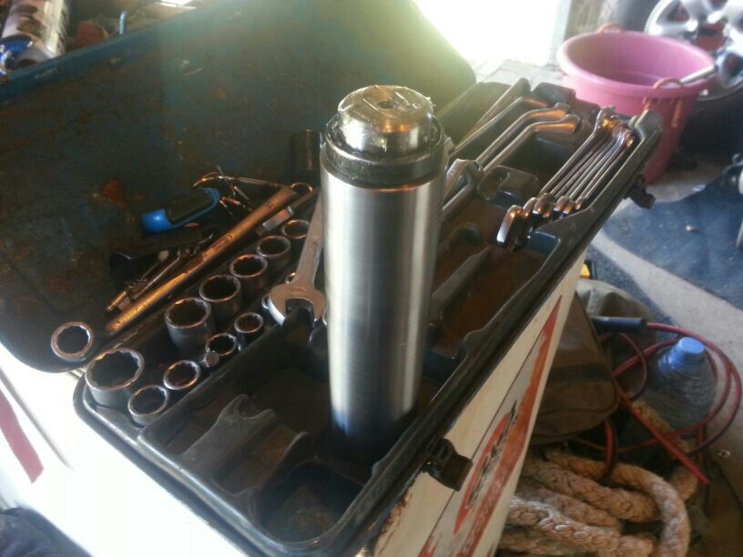

The "special" tool I had made to install the seal. A very simple slug of metal, but it makes it sooo much easier.

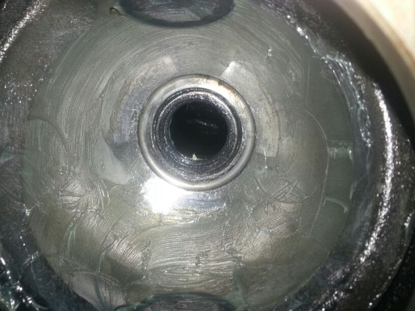

The new seal in place.

I like that tool !!... Where abouts are you .... I might want to try Zantus Hire which is next to Coastal Hire..... :rolling: :rolling: :rolling:

Unfortunately I'm in PE and at 3kg's the tool won't be cheap to throw in the mail.....I think.
Re: Inner Axle Oil Seal
Agreed on the mail issue !!!....ha ha
But no a complicated to quickly turn out
