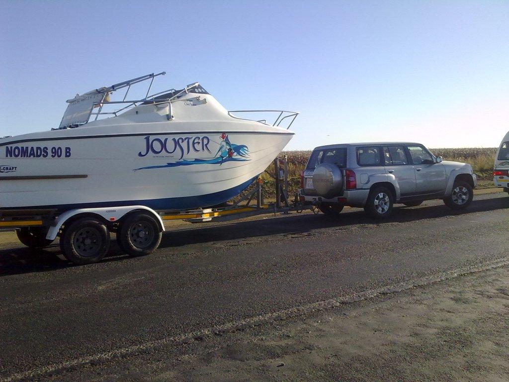

I really do not think you will see any difference in fuel consumption when towing whether in 4th or 5th, at the speeds 90-110kms/h. Actually at these speeds I am almost always throttle almost to the floor to overcome the wind resistance anyway - and in 4th you are closer to optimal torque so better efficiency theoretically in my view.
I was towing a trailer filled with hunting spoils (probably 1,5 tons) when I blew a 5th gear on my 4.5 patrol - on the long straight road from Warmbaths to Pta. I wont make the same mistake again. The 5th gear is very small and not well lubricated (in the manual box anyway!), as told to me by the specialists that repaired it. Eventually it heats up to the point of self destruction when under longer and harder than normal driving load.
- the large burden!
- 27042011144_2.jpg (132.39 KiB) Viewed 6611 times

Re: Auto and Cruise Control and towing.
Thanks!
Ok now that is what I call a boat!!!! Maybe mine next to that will be seen as a canoe with an engine!!!
