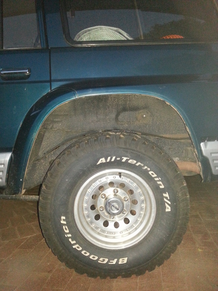

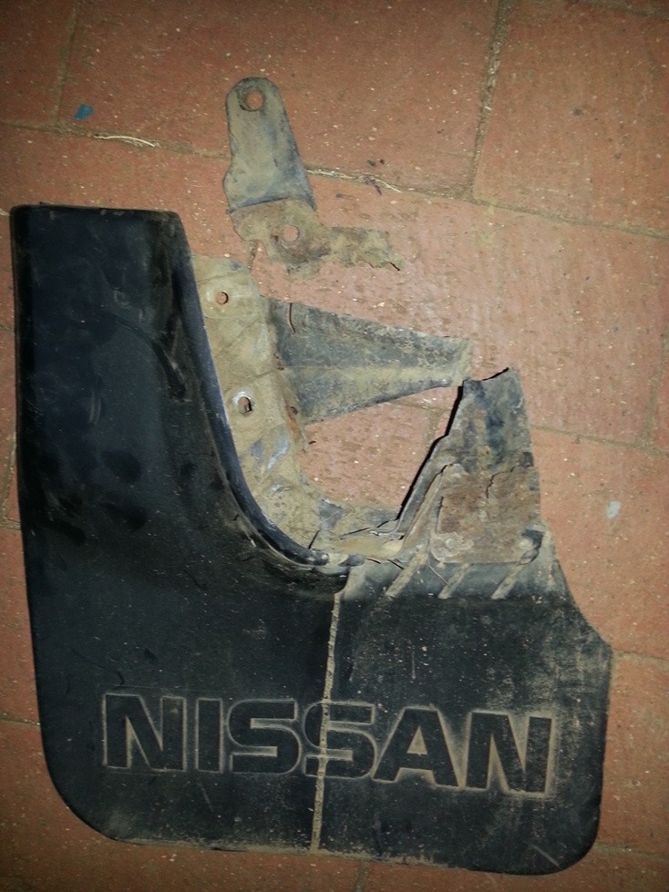

Hi all,
Please help with some opinions.
One of the rear mudflaps broke. Here are some pics. so now the questions are;
1. are there any mudflaps lying around I can buy to replace the broken one?

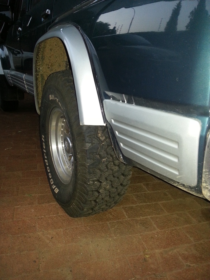

2. do I just remove the lot- flares and flaps? (pic 3)
As this is a old vehicle and 2nd hand spares are scarce, what are my options?
Deon

The mudflaps helps with stones on trailers ect I am sure nissan sould have one
- Been thanked: 473 times
Re: Fender flares/mud flaps or not???
Conveyor belting !!!!.... I want to do that with mine. I also want to get some 2mm thick rubber matting for the sides of the wheel arch opening into the engine bay

Make a steel bracket to fit the coneyor belt/insertion rubber to the existing flares.

Thanks guys,
Found this place in Boksburg,
http://www.proautorubber.co.za
They have all sorts of bits and pieces including truck mudflaps which can be cut to size. R120ea

Hi Deon
I use truck rubber flaps.
This is what Ben put on for me because I only had one original Nissan flap left on my car and I hate paying "stealer" prices.
http://www.patrol4x4.co.za/viewtopic.php?f=43&t=3474
I also think nthey do a better job than the originals
With regard to the "rubber matting for the sides of the wheel arch opening into the engine bay", it may look more tidy, but I also feel that some ventilaiton there is not a bad thing. If you go through a mud hole it will dirty your engine anyhow.

Quick update. I had the flares sprayed same colour as the truck, and made new braces with 20 x 3mm flatbar and fitted commercial mudflaps. Probably not the most professional job around, but it will do. Will post pics later of the finished product.
