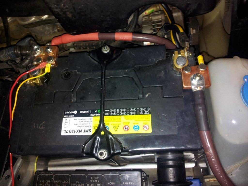

Chris Skinner
Posts: 852
Joined: 26 Nov 2009 12:58
Full Name: Chris Skinner
Nickname: Chris
Has thanked: 10 times
Been thanked: 53 times
Re: Battery for 4.5 GRX
Post by Chris Skinner »
I have this battery - probably about the biggest that fits into the space - 2,5 years and going strong.
Make some proper heavy duty terminal connectors for yourself as well...
