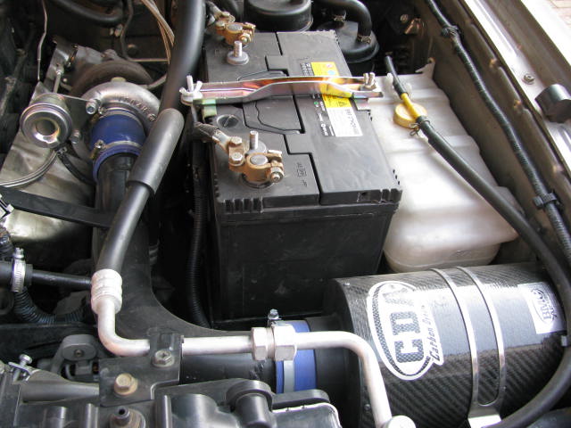

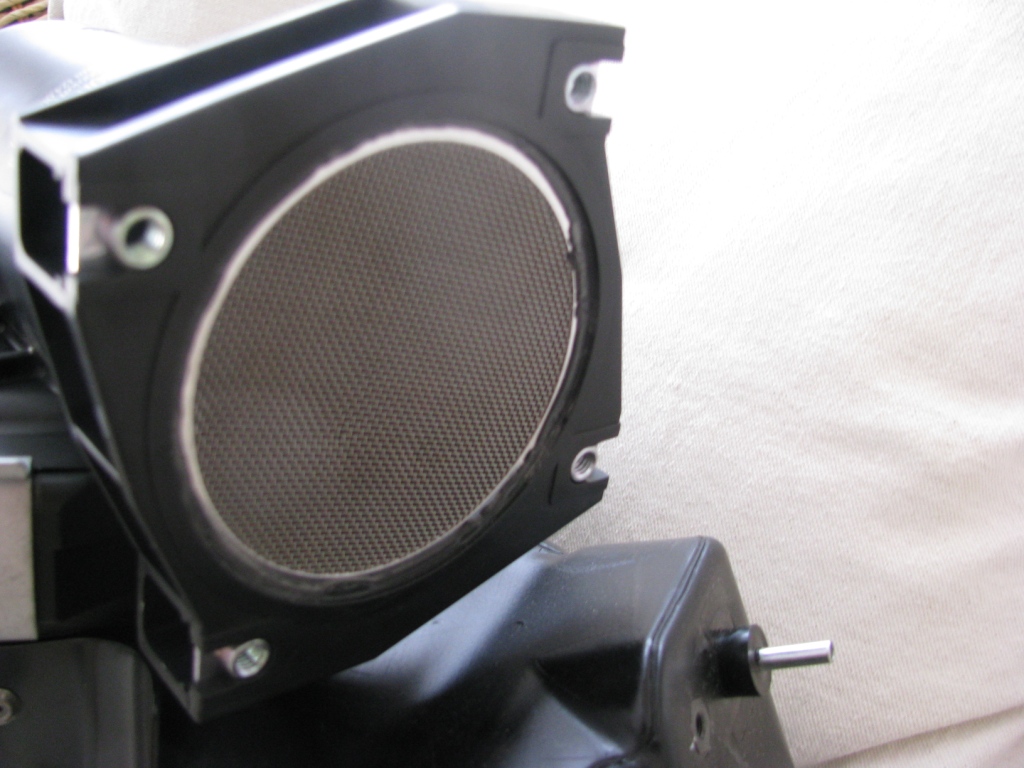

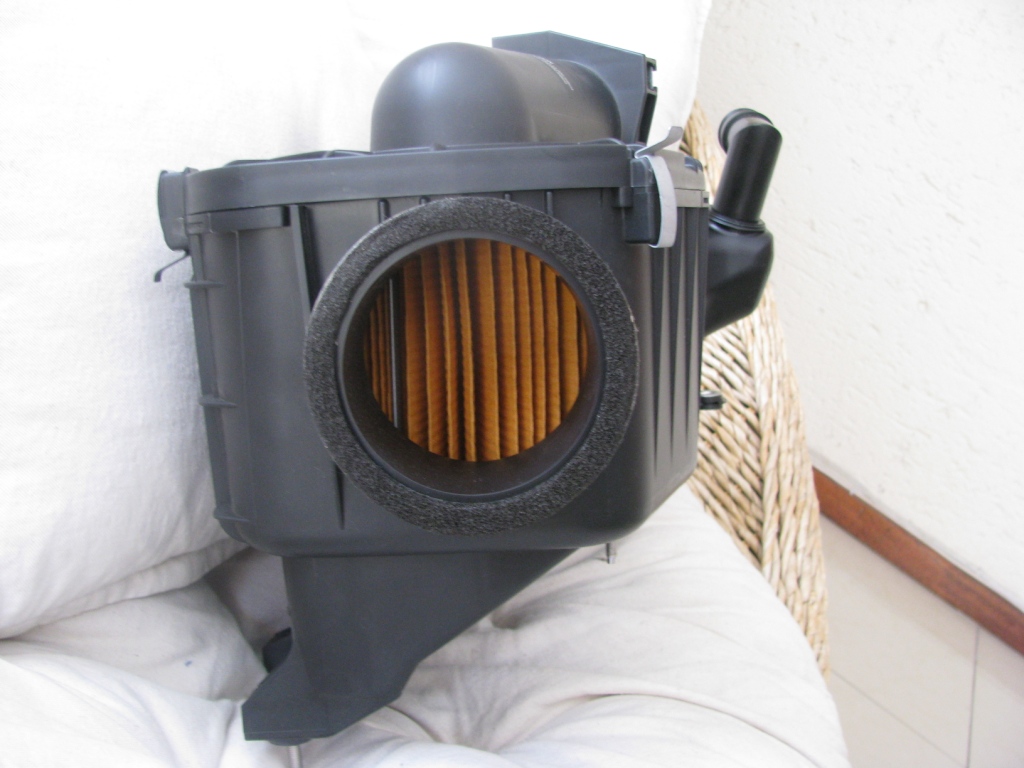

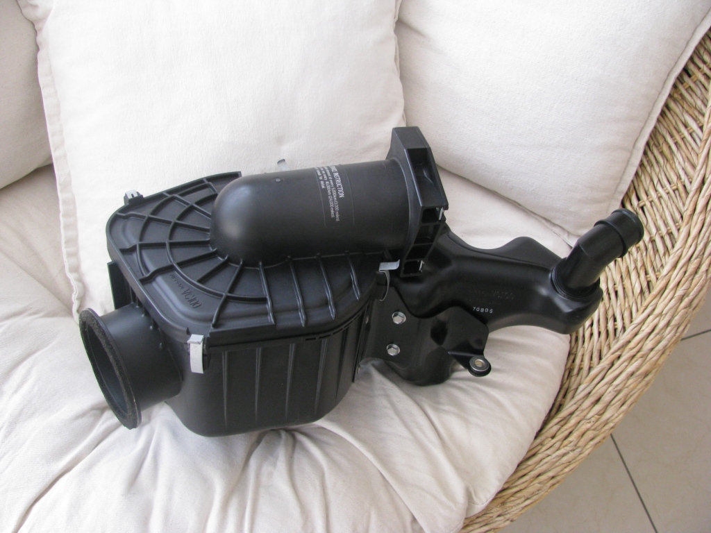

Air filter housing, part number 16500VC11A, price R3,504 incl VAT and filter. Assuming upon fitment that the part attached on the right (i think a kind of reservoir) can be removed completely, only needed with the ZD30 engine as part of airflow meter system. The outlet - i think the trick will be machining a bracket to connect the outlet to piping through to the turbo The current set up, patrol has done about 35,000km like this (except i've since replaced the piping with stainless, done last year) The inlet that will connect to the fender. Notice the paper filter
