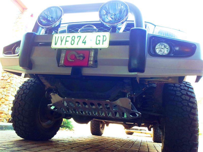

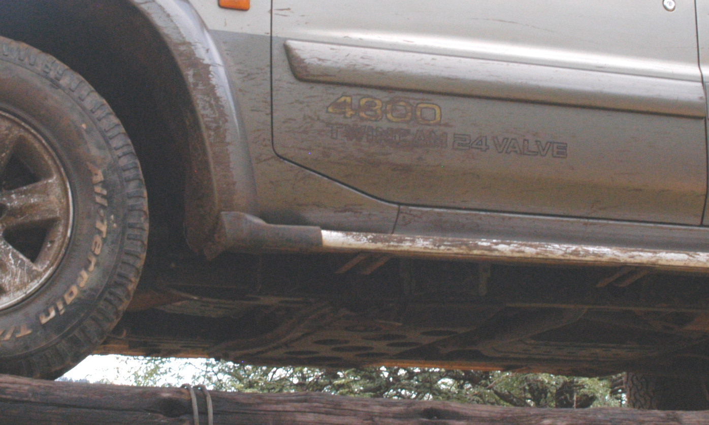

Hello Chris
This is a 4.8 bash plate: And this is a transfer case skidplate: My apologies for the picture quality, I had to fiddle in photoshop to make the plates more visible.

Re: Bash and skid plates
What will the front bash plate protect ?
- Posts: 6137
- Has thanked: 1125 times
- Been thanked: 1036 times
Ja boet. Ons weet mos daar is modder daar.Tinus lotz wrote:piet
is daai my kar wat so vuil is by barraka ????
Jules the front bash plate protects mostly the front steering arm, the panhard rod and the steering damper. It may also provide some protection for the diff casing in certain circumstances and on the 4.8 it could also protect the sump which hangs lower on those cars than on the others, but only under exceptional circumstances.Jules wrote:What will the front bash plate protect ?

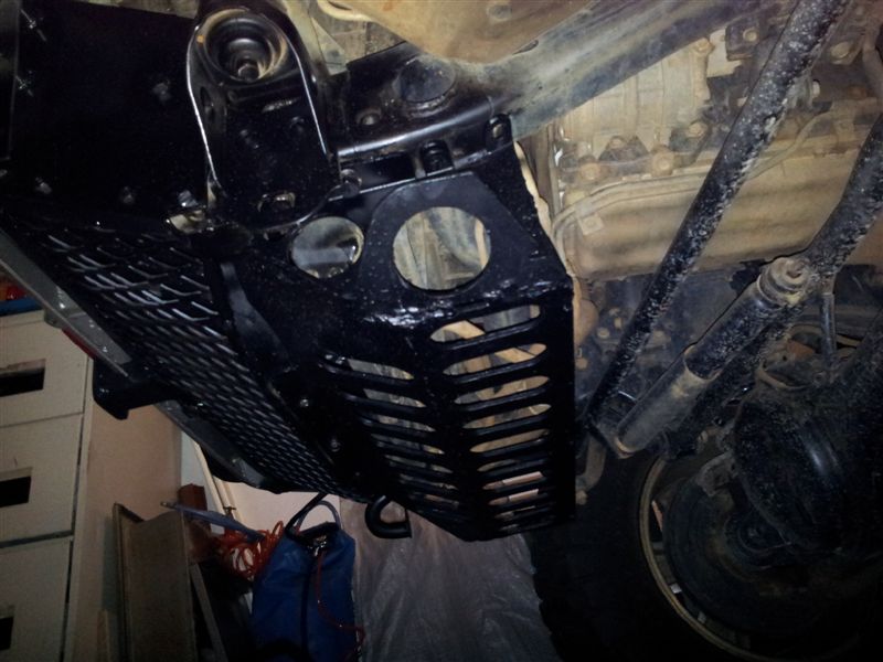

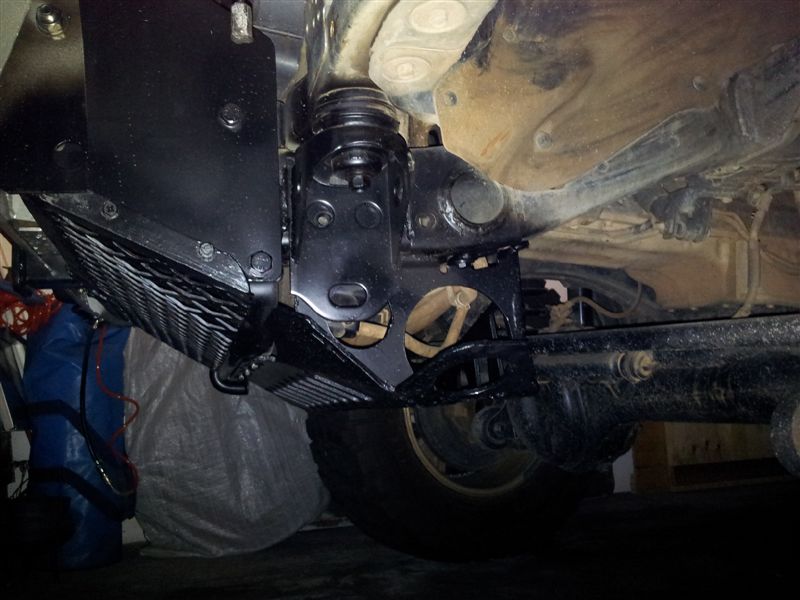

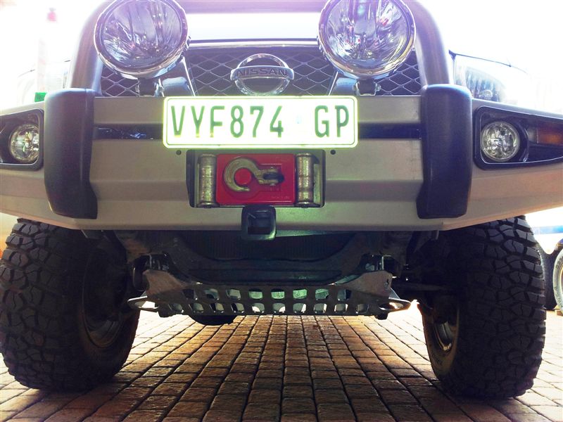

Pictures of the bash plate fitted - looks great!
- 2011-08-07 13.45.08.jpg (85.32 KiB) Viewed 1806 times
- 2011-08-07 13.45.17.jpg (77.55 KiB) Viewed 1806 times

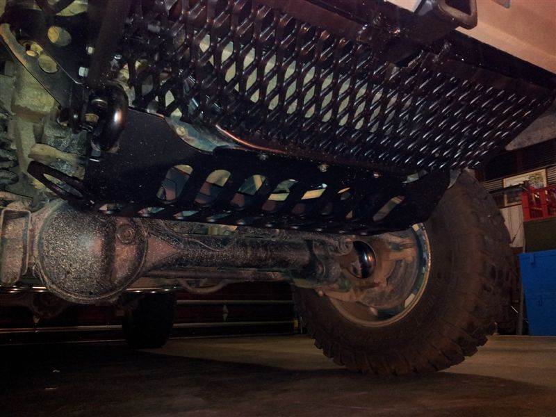

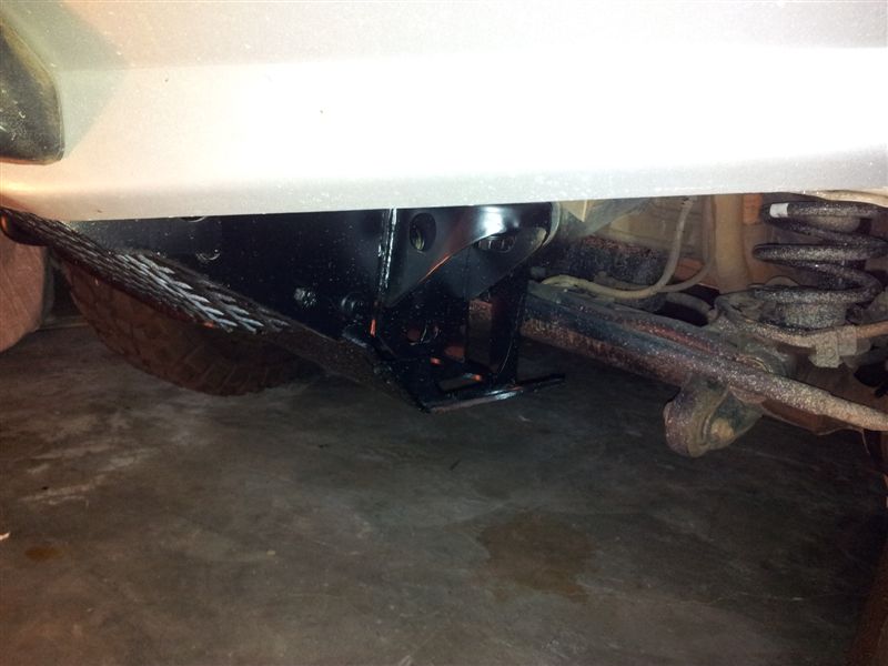

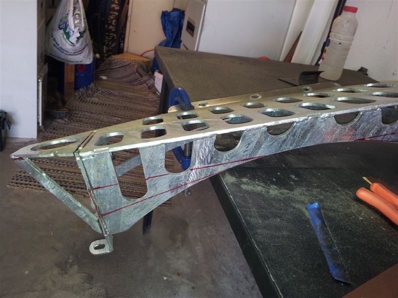

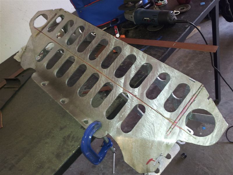

I have now added some protection for the radiator - some heavy duty expanded metal.
I have also made some slight mods to the Bash Plate as my thinking was that it came down a bit too low at the rear end. So I made a few cuts and bends, a couple of welds - and voila!
It looks far more suble now, although I will still neaten it up the welds with the grinder next weekend.
I should have been a plastic sturgeon.
Now the car is really starting to pick up some character!
