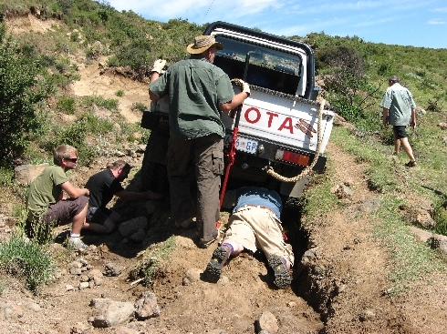

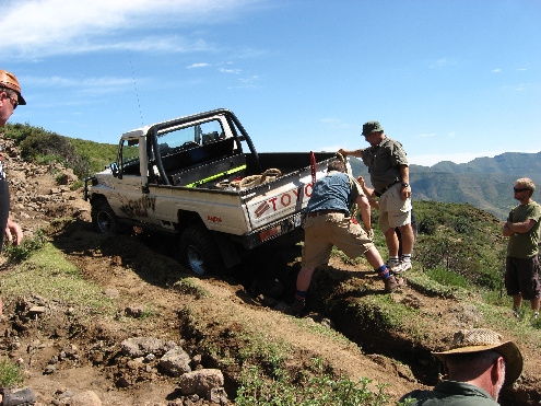

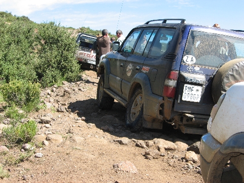

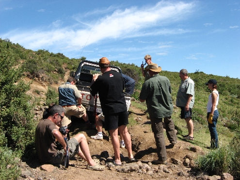

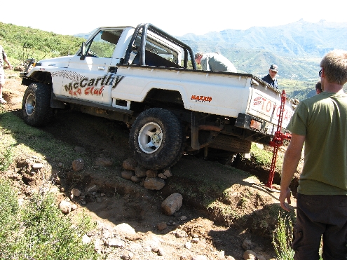

Without stepping on any toes - but to prevent any woes - get complete and proper "schooling" [read 'experience'] BEFORE you attempt a Hi Lift Jack recovery. Follows some picts taken on Baboon's Pass Lesotho [2009] - [you can figure out which actions were safe, and wich not - and try to figure out how YOU would approach the rocovery of that 'bumperless' Prado.
The first pict is of Boezman at De Wildt - the rest are Baboon's Pass]
and this is how high you must lift up before the tyre comes off the ground [Actually - Boezman's wheel was still on the ground in this pict]
Boezman hoogtrap.jpg (196.9 KiB) Viewed 2289 times
HiLift appl1.jpg (203.01 KiB) Viewed 2289 times
HiLift appl2.jpg (186.64 KiB) Viewed 2289 times
Hilift appl3.jpg (183.06 KiB) Viewed 2289 times
HiLift appl4.jpg (157.13 KiB) Viewed 2289 times
HiLift appl5.jpg (187.8 KiB) Viewed 2289 times
HiLift appl6.jpg (196.2 KiB) Viewed 2289 times

I want to agree with what Uncle Mac says, but also if you can get a lighter car to practise on, it is much easier to handle a light car.
Oom Mac did that prado lose it's bumper on Baboons, or did it arrive like that?
Re: Steering Gaurds and Recovery Points
Hey tha P/ter - nope, he lost his 'parts' on Baboon's -
[posting some of those picts on F/Book as well - this 'resizing' one by one pict and then placing 0ne by one is time consuming :oldtimer:
