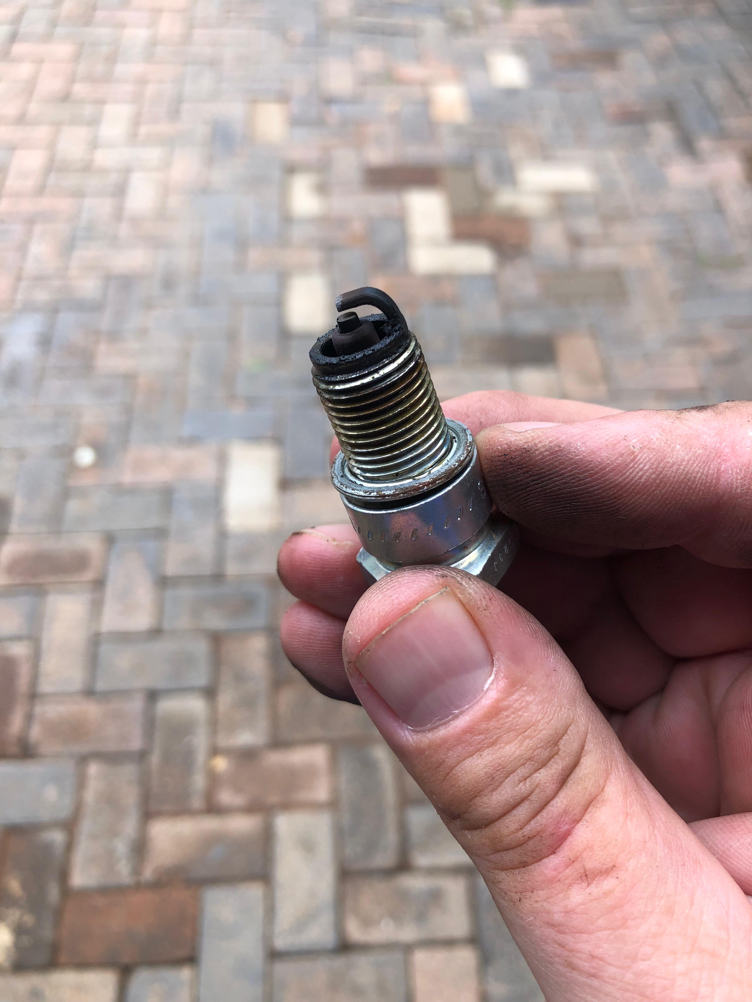

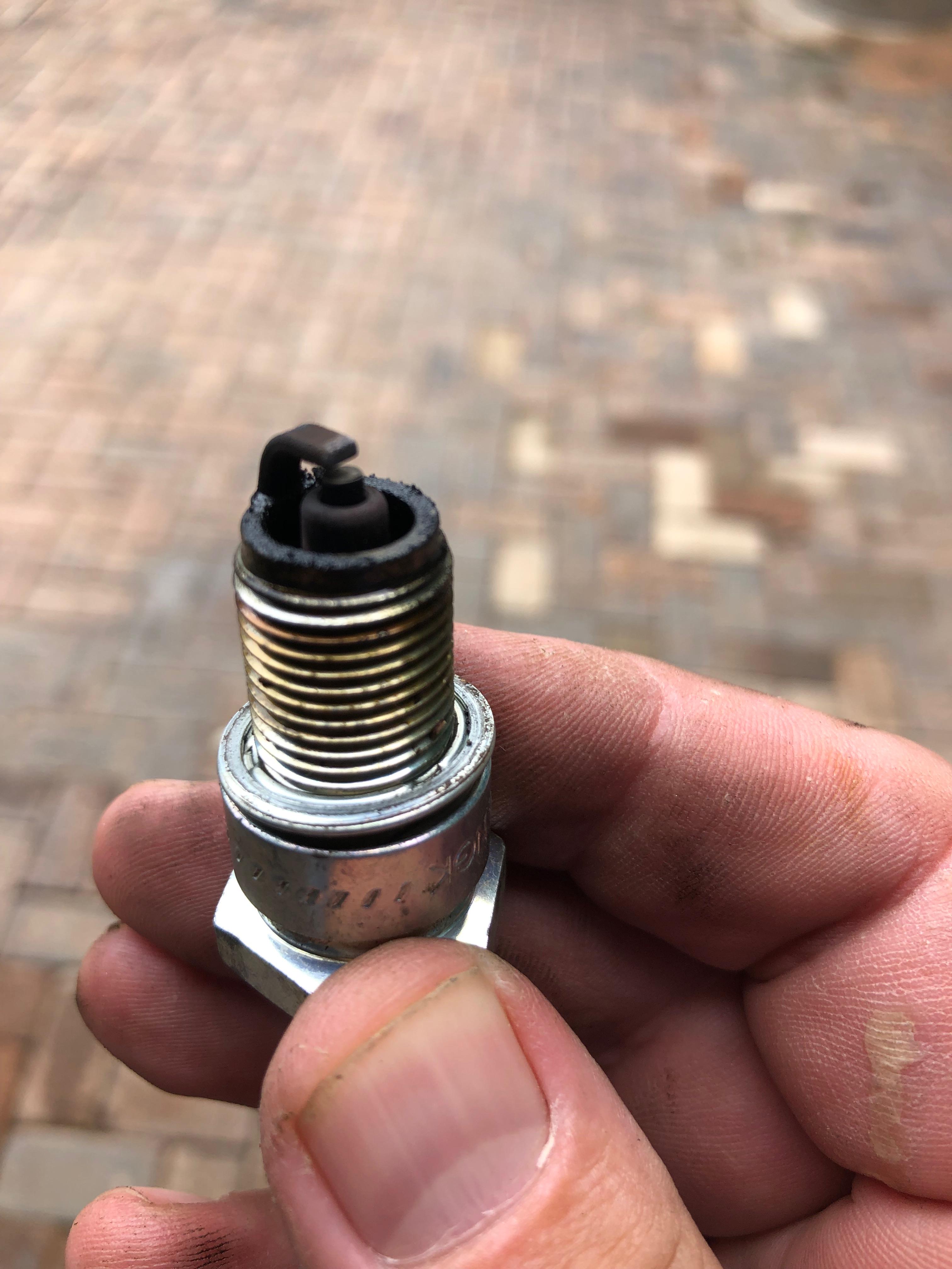

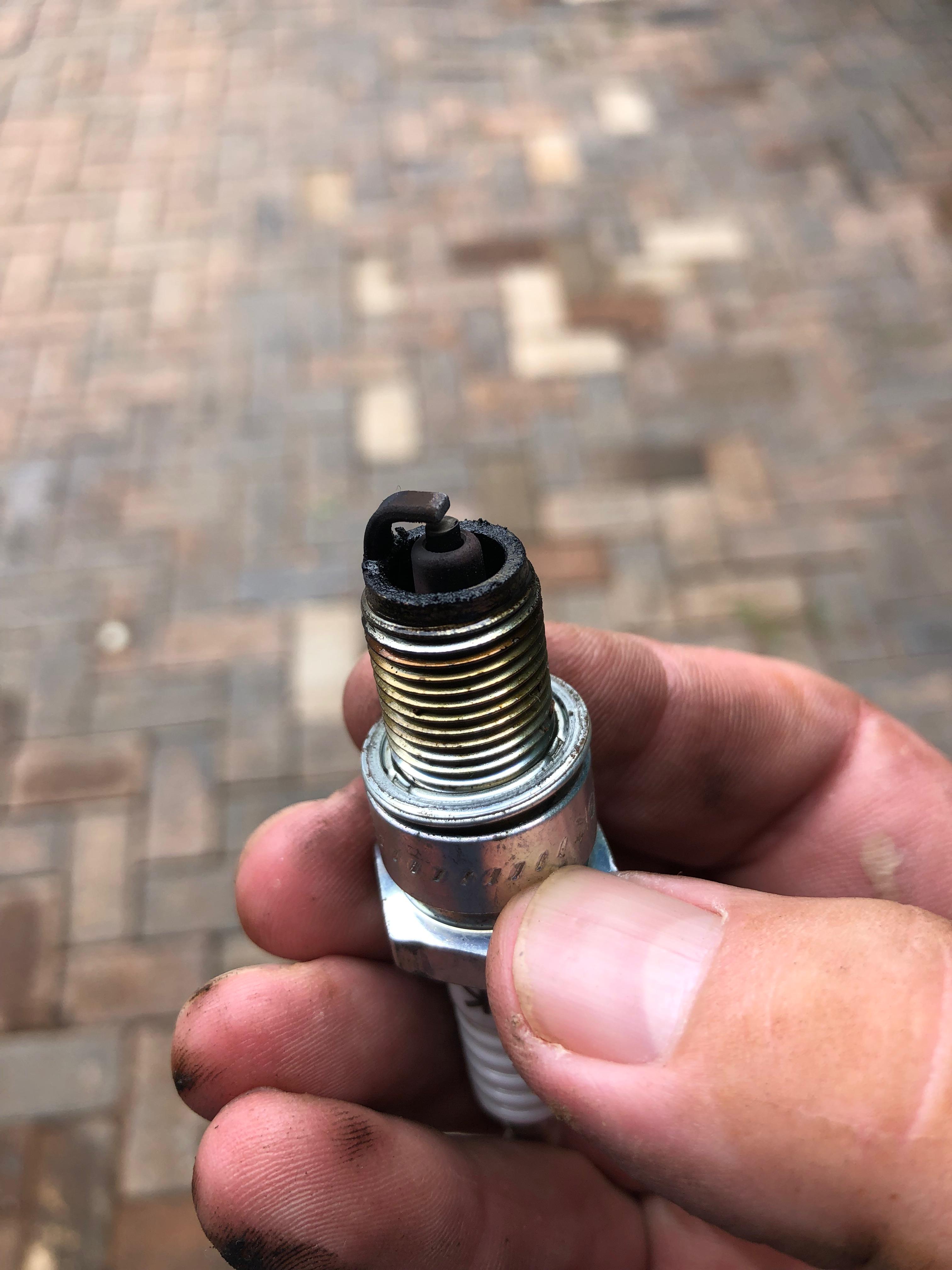

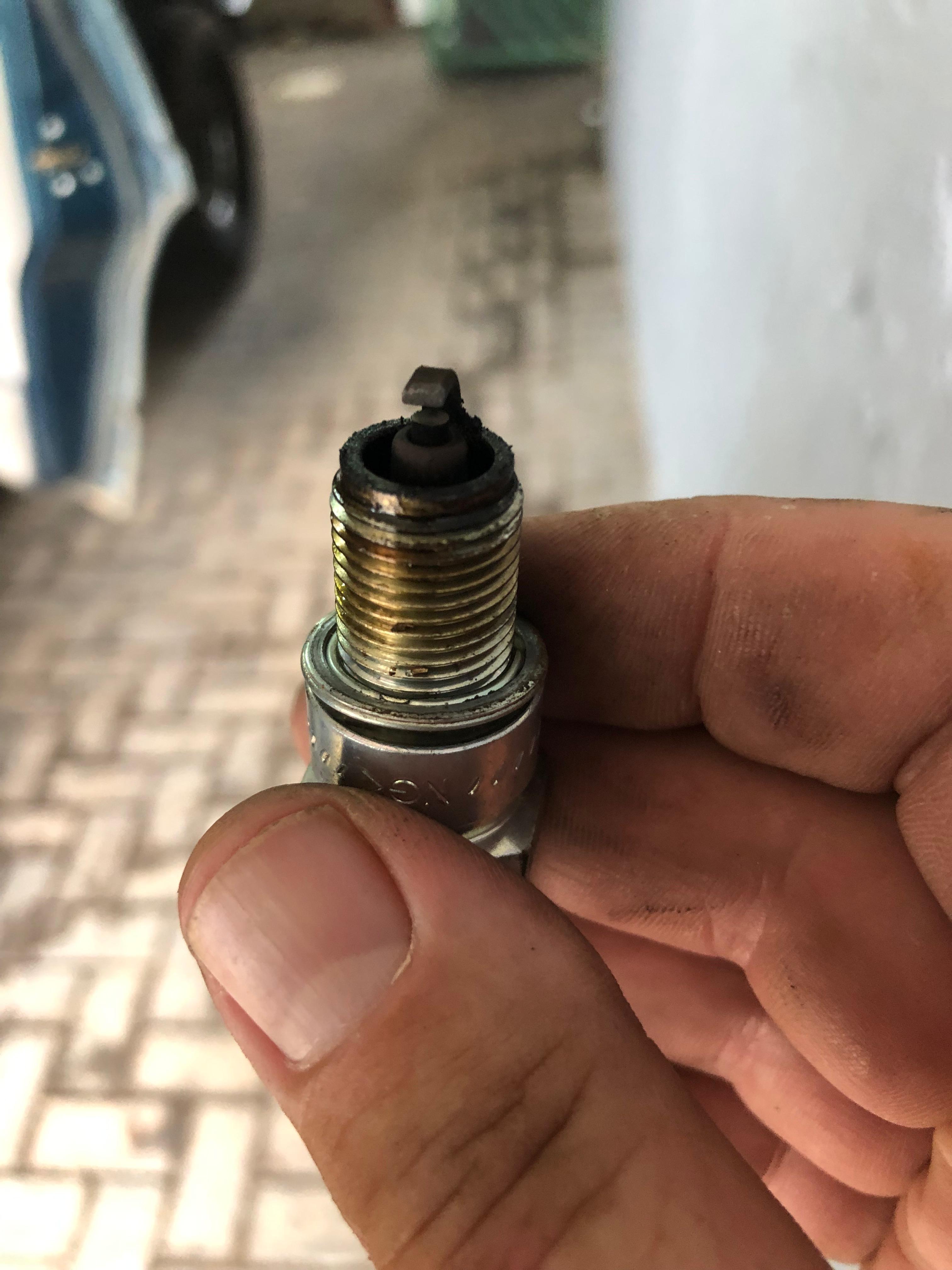

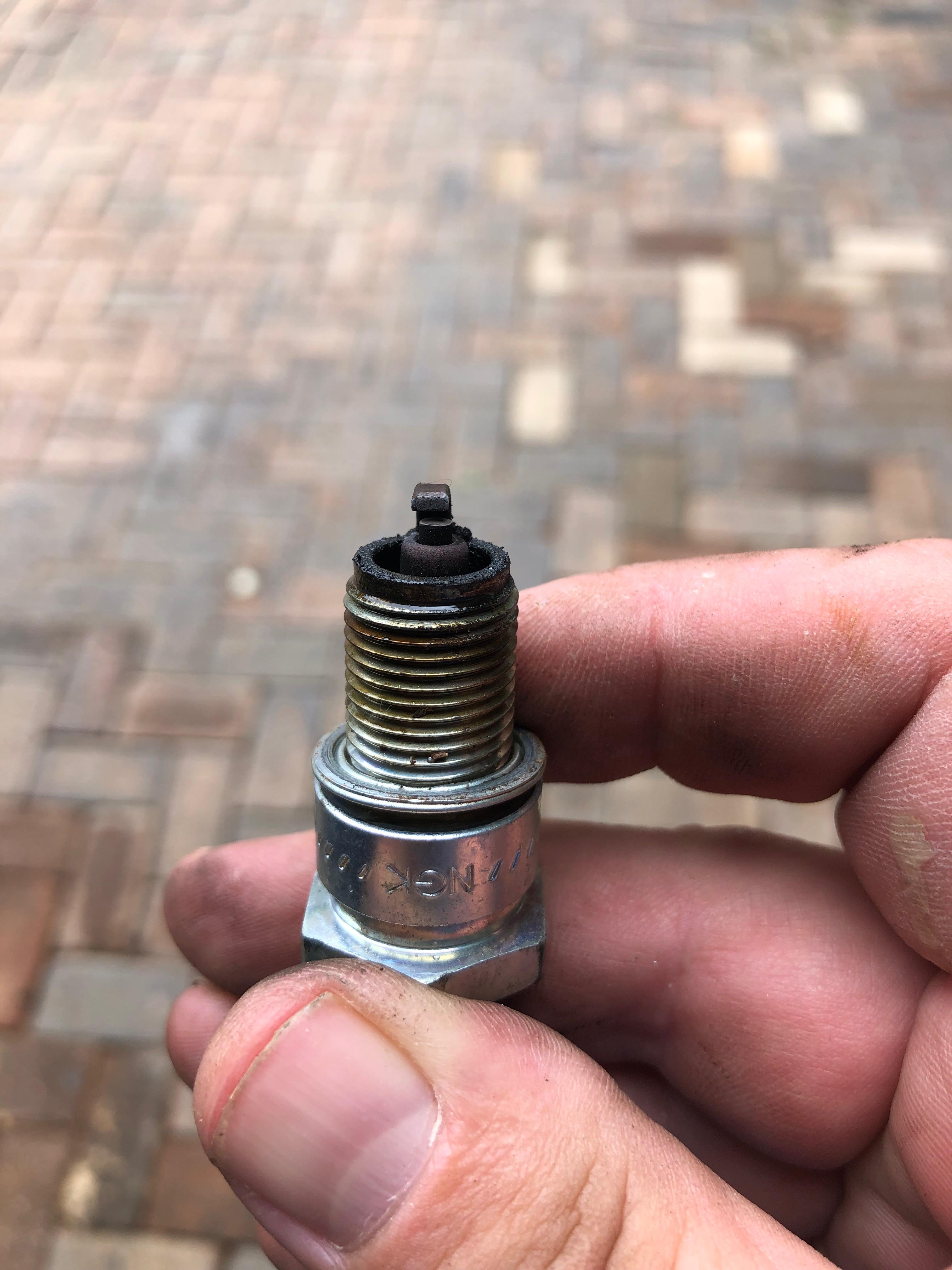

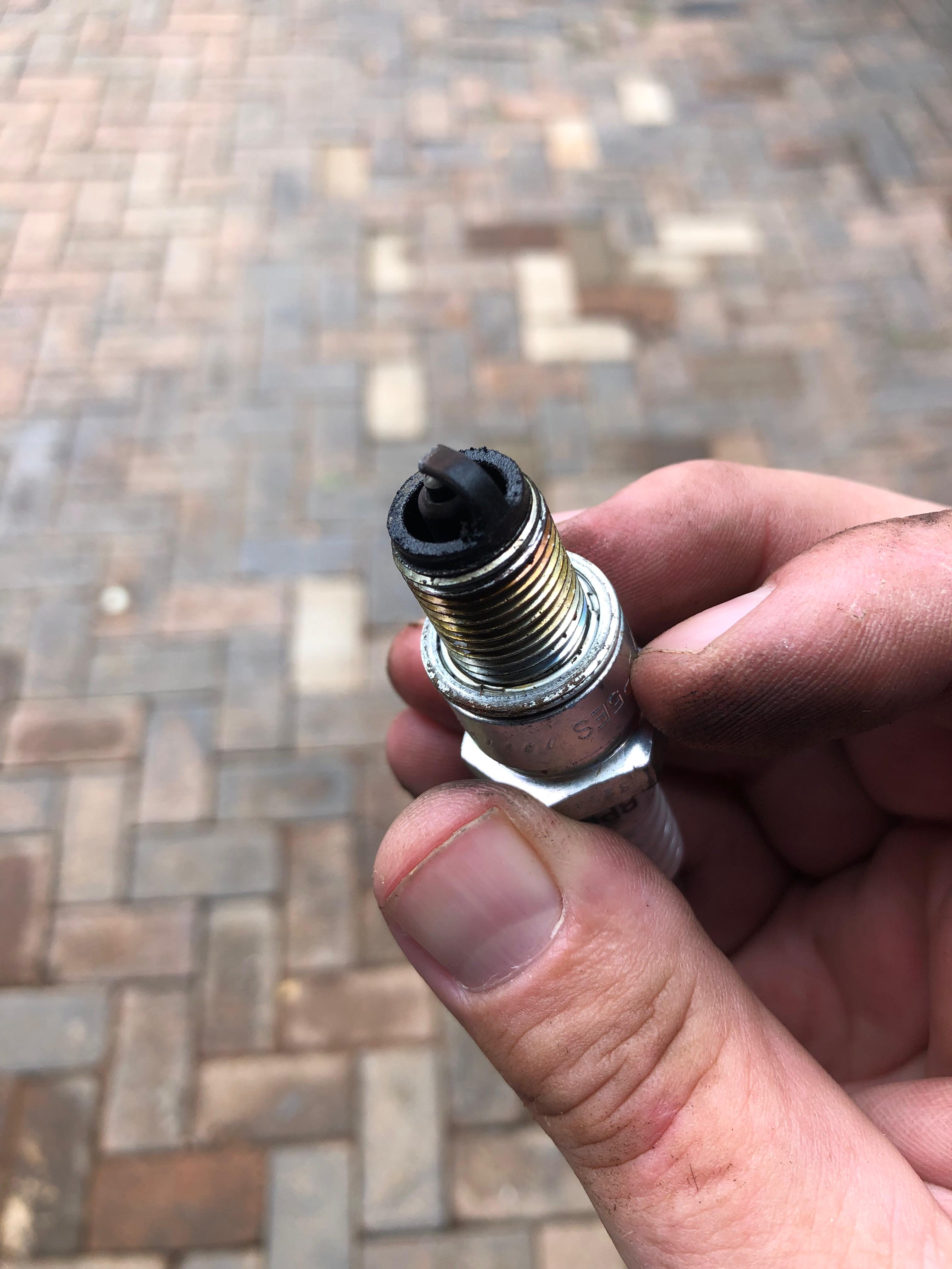

Look at the condition of the plugs.
If they are fouling, you can try hotter plugs, but if they stay nice and clean it won't make a difference.

Re: Y60/GQ Spark plugs
BP5ES fitted 17k km ago in 2022. (how often are you suppose to change spark plugs? I think the manual says 40k km and check every 20k km? :think: )
Daai lyk nie great nie. Probeer een warmer gaan, of stel die gaps effe kleiner.

Peter Connan wrote: 15 Mar 2025 15:14 Daai lyk nie great nie. Probeer een warmer gaan, of stel die gaps effe kleiner.
0.7 ?
Dis omtrent die kleinste wat sin maak.
