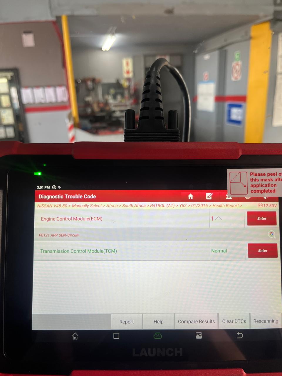

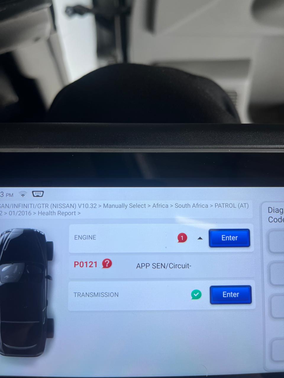

Update, I have received a throttle body and harness plug from Graham. The mechanic installed it and connected the same colour wires to the existing harness. After that, the diagnostic still showed the attached error and remains in limp mode.
A few auto electricians have now looked at it, car standing months at some of them, and no one can find the issue.
Description: Graham installed the turbo on the TB48 and cut and stuck blue intake hoses over the connecting pipes. One of them came loose and fell into the engine which caught fire and burnt the throttle body sensor. That’s why the throttle body needed replacement.

Hi Zak!
I presume the error wasn't there with the old throttle body and that the mechanics have cleared the DTC codes after fitting the new one?
I also find this a bit weird - are they reading the right code?

There were different error codes because of the melted body sensor. They did clear everything though.
About the model, I also immediately showed him the model that he selected and that it's wrong, but he said it doesn't matter. Which I highly questioned. although the attached is from another sparky which used the correct model and got the same error.
Thanks for the reply!
