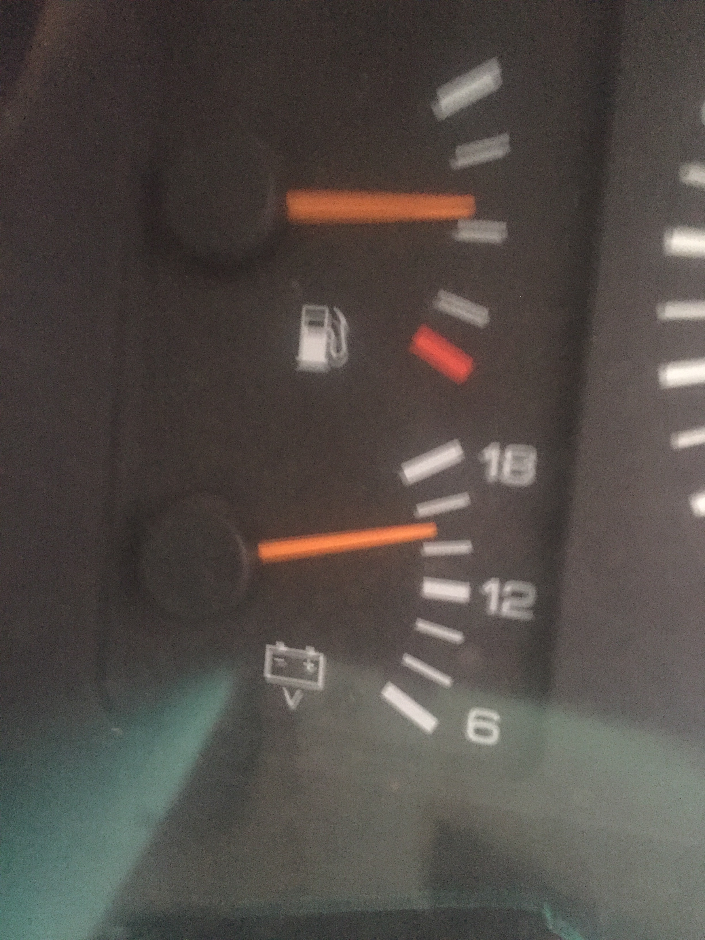

Florian320 wrote: 08 Nov 2023 07:19 It seems, my alternator is giving me a hard time.
It generates between 15.1 and 15.9V on higher revs - far too much I think.
Now I am considering a replacement - does anyone have experience with Denki alternators? I found it at Partsouq. Or which brand / type would you recommend, available in South Africa?
It is for my 99 TB45E.

What is it suppose to be, around 14V?

SJC wrote: 10 Nov 2023 15:18
Best regards,
Florian
Yes, 13.7 to 14.3 probably.

my gq...

Mine is pretty inaccurate.
Compare it to a multimeter sometime.

sal dit probeer.. :thumbup:
