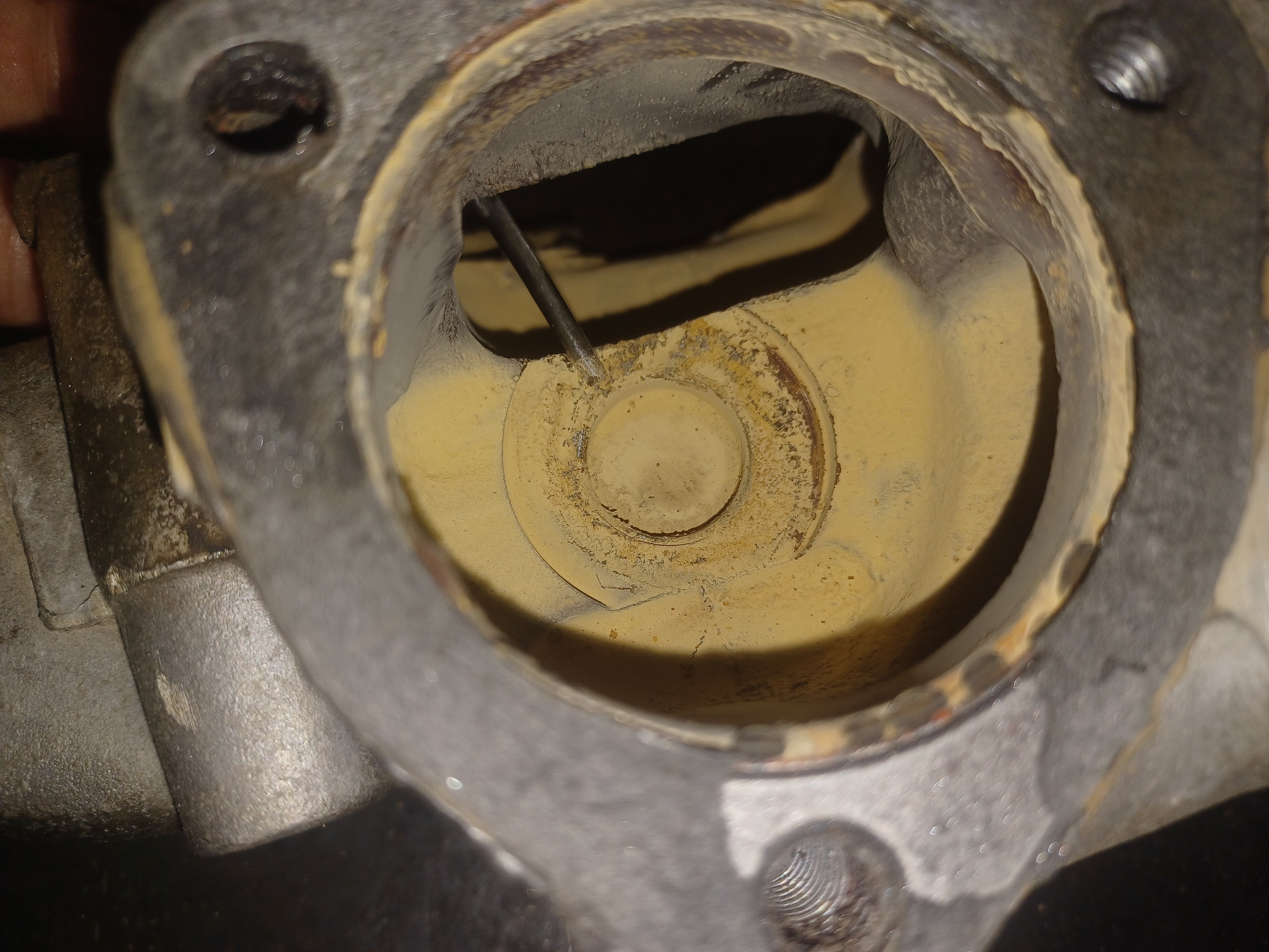

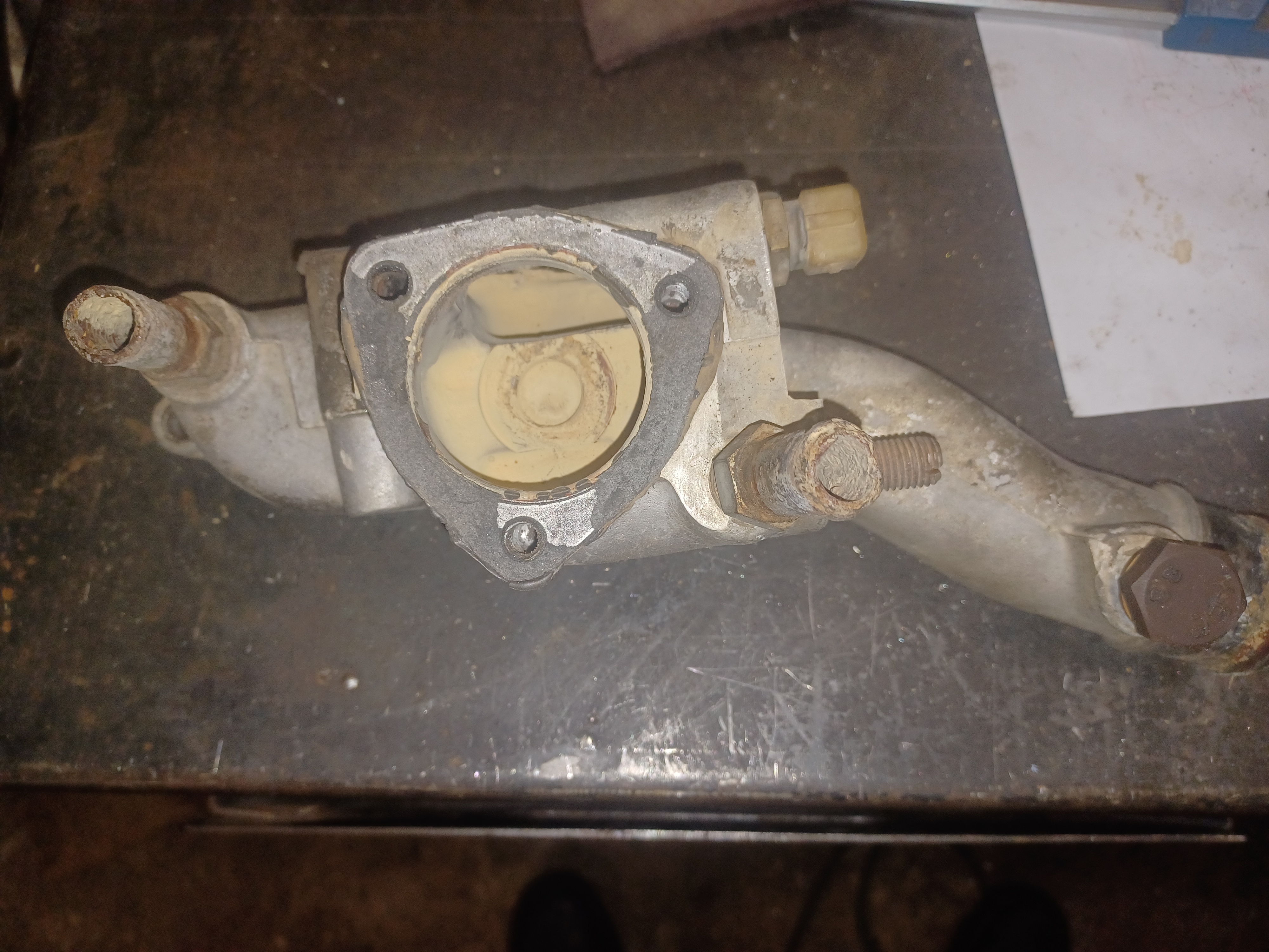

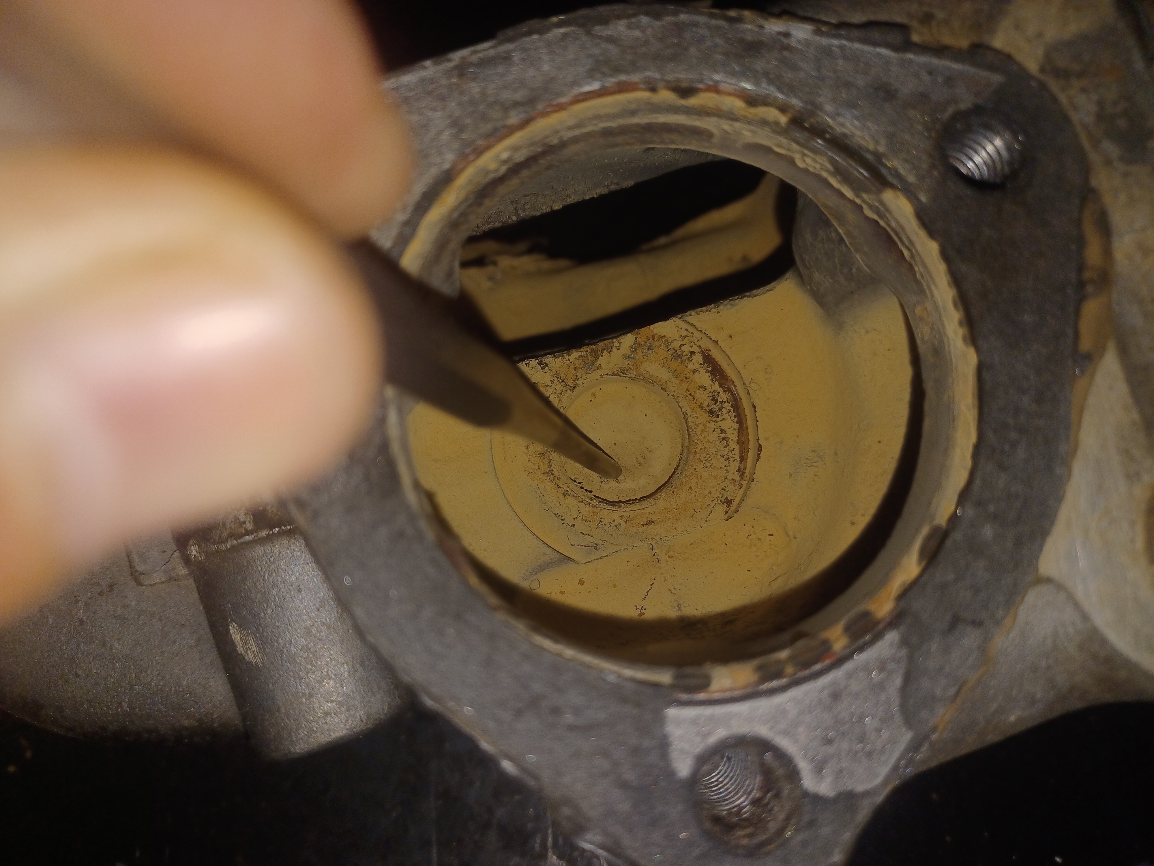

Re: Overheating
Here is the thermostat housing:
In this photo, the punch is pointing to the welsh plug which is fitted to prevent water by-passing the radiator. However, as mentioned, when this is done a different type of thermostat must be fitted.
Unfortunately I do not have photos of the thermostats, nor spare ones lying around.
The surface at the tip of the punch in above photo needs to be a flat, machined surface. It's a bit difficult to see, but on this one the surface is pitted and damaged. When this happens, water by-passes the radiator and cooling is compromised.In this photo, the punch is pointing to the welsh plug which is fitted to prevent water by-passing the radiator. However, as mentioned, when this is done a different type of thermostat must be fitted.

Wow this is what I am talking about this is great help I will be working on the car probably on Wednesday first will be the thermostat housing I will be sending you pictures if you don’t mind??Peter Connan wrote: ↑20 Feb 2023 16:06 Here is the thermostat housing:
