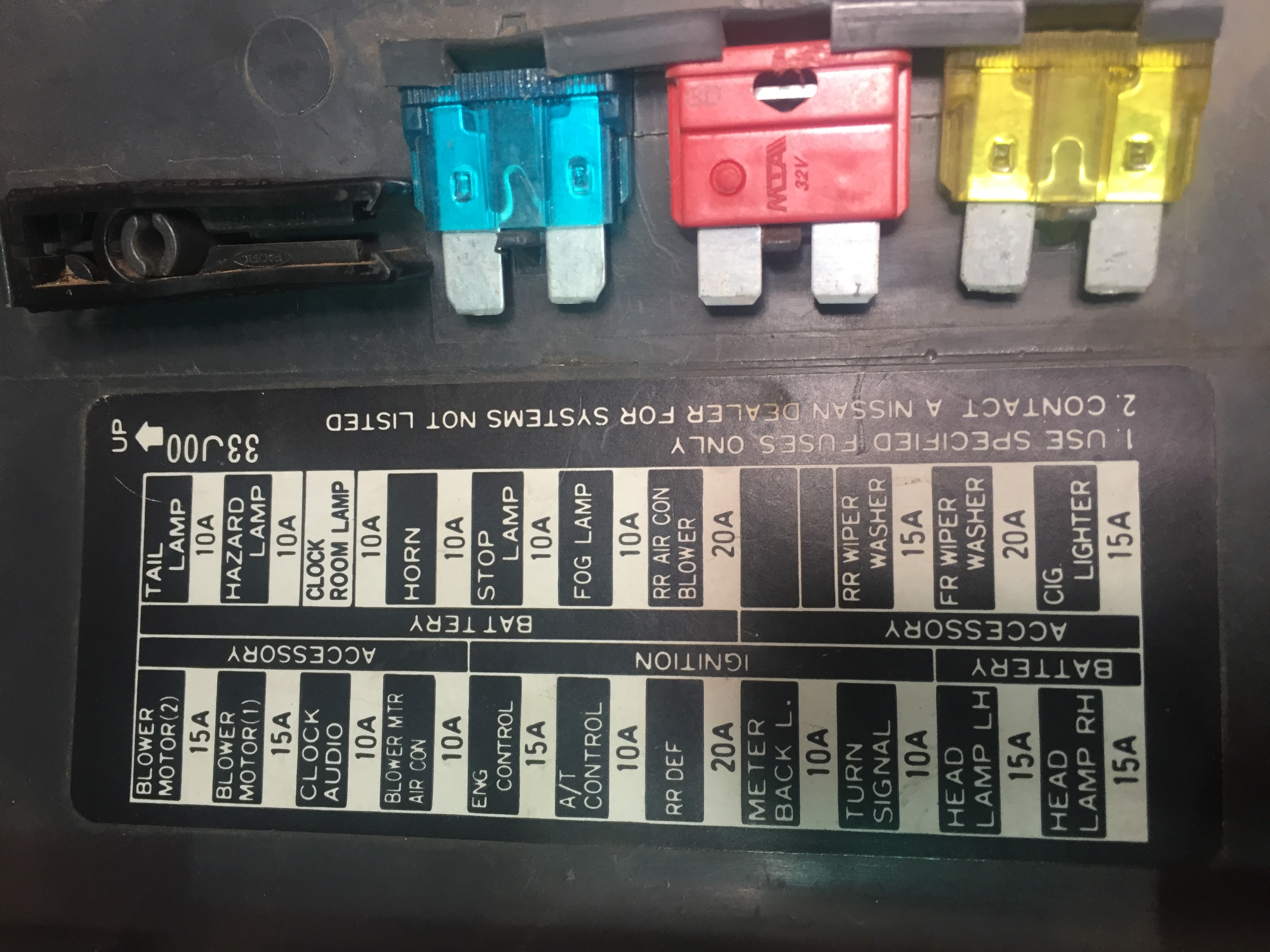

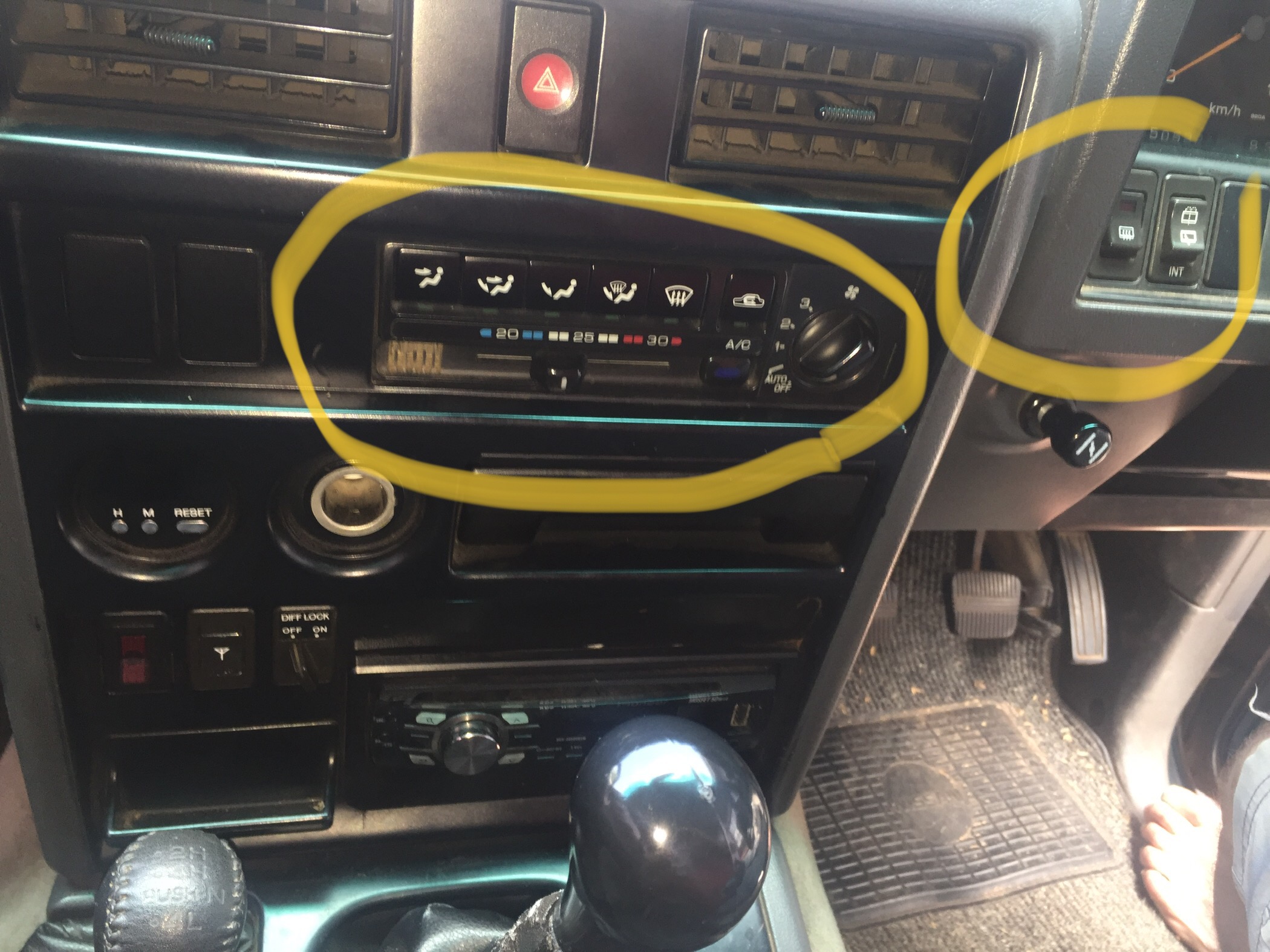

My gq’s dashboard lights does not work. Instrument cluster is fine thought.
Does not seem like there’s a fuse for this?
Any suggestions?
Any suggestions?

There should be some very small incandescent bulbs behind the heater panel. Best to dig around your model's service manual to find out how to replace them, or see if you can find a helpful thread on the "Oz" Patrol forum.
The bulbs in the switches are not serviceable items (Nissan would gladly sell you a new switch, though!), but if you have a lot of patience you can dismantle the switches and replace their bulbs too.
I replaced the heater panel's bulbs as well as the bulbs in the switches (hazard/demister/aircon/recirc) of my Y61 with LEDs while I was on leave in December using this thread to guide me along.

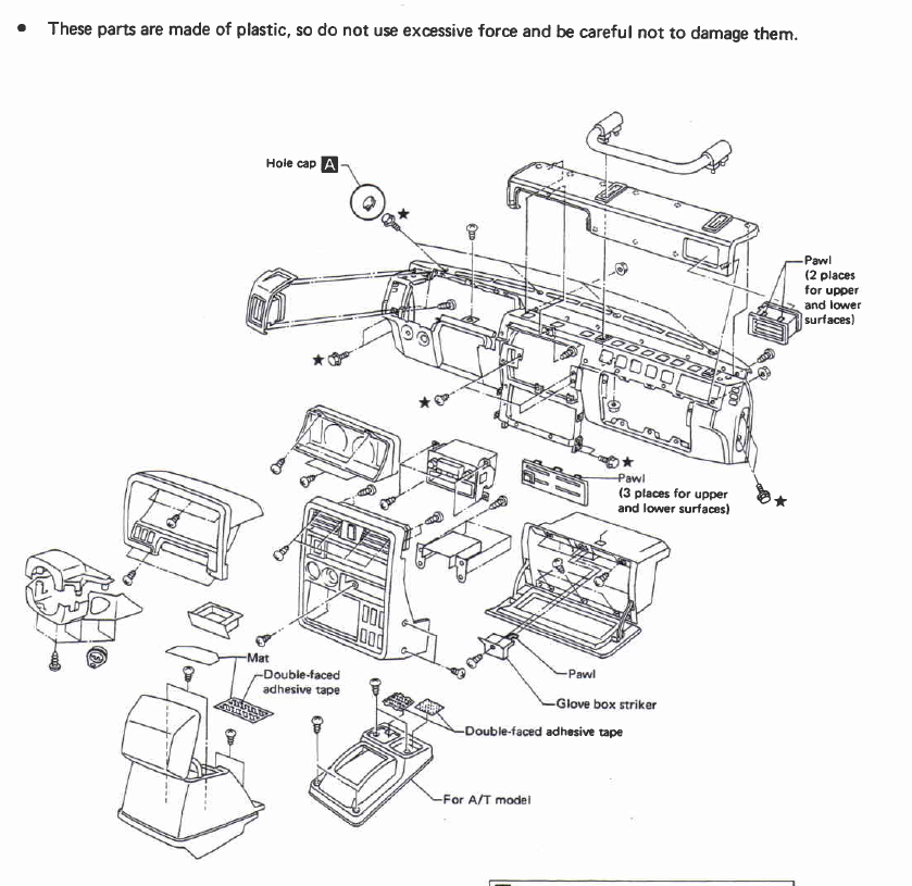

Found this...
- 7EE4C49E-FAFE-46EE-A3C5-78DCD0289EF6.jpeg (264.41 KiB) Viewed 7189 times

The temp switch for the fan/heater unit also doesn’t work. Always running on max cold setting regardless of position of switch.
Which made me wonder if it could be an (easier) option to replace the heater control unit with a second hand one (Depending on availability though....)
