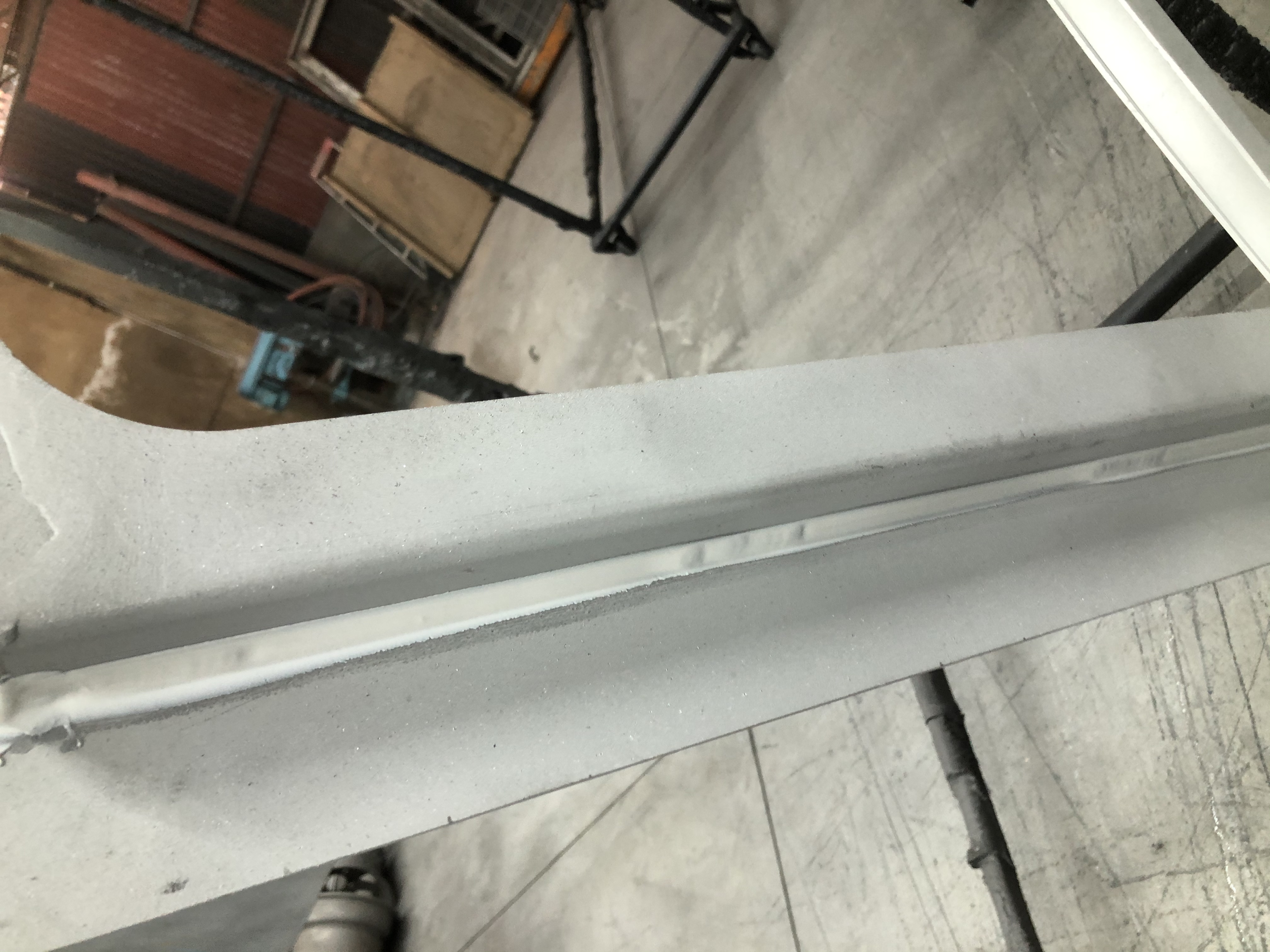

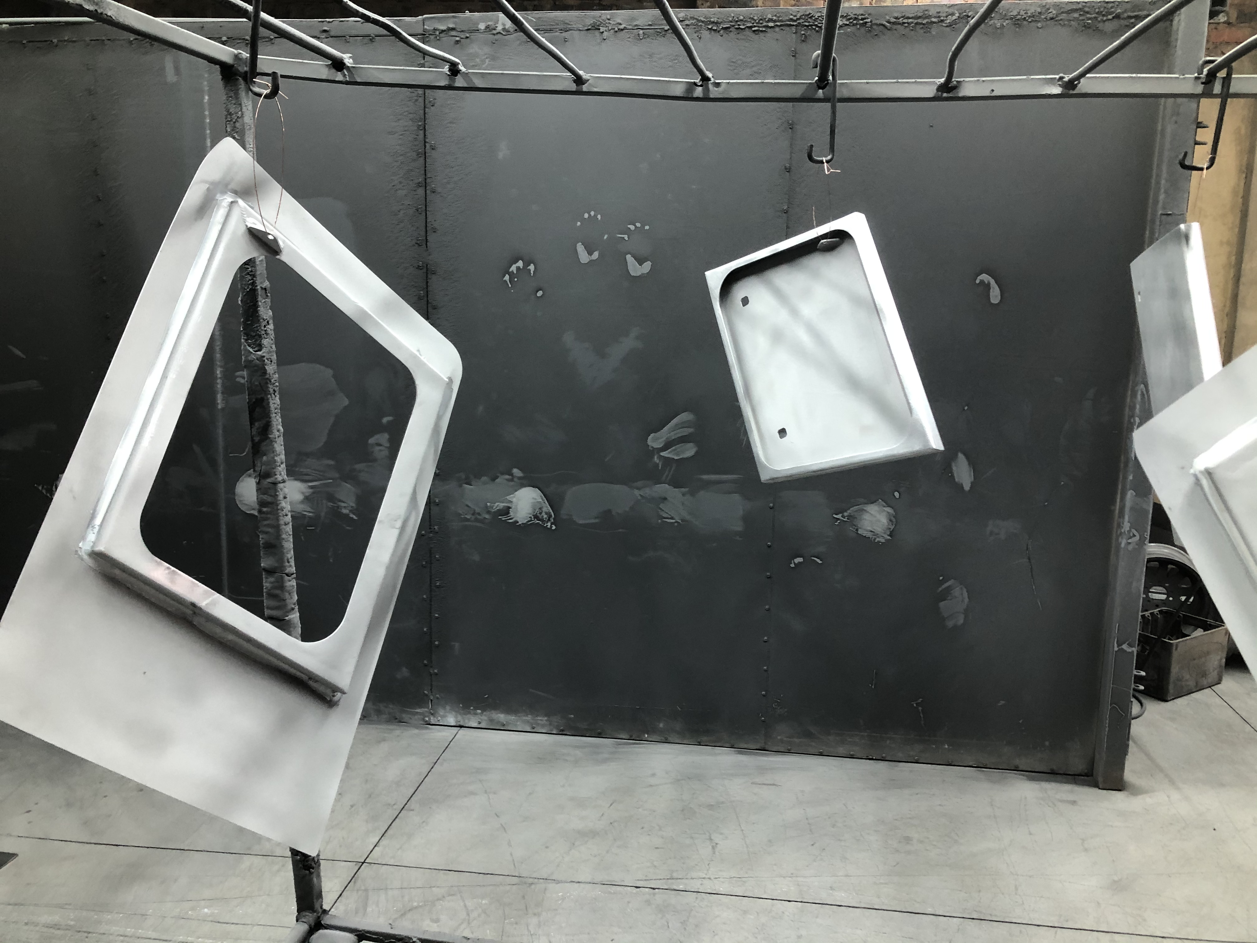

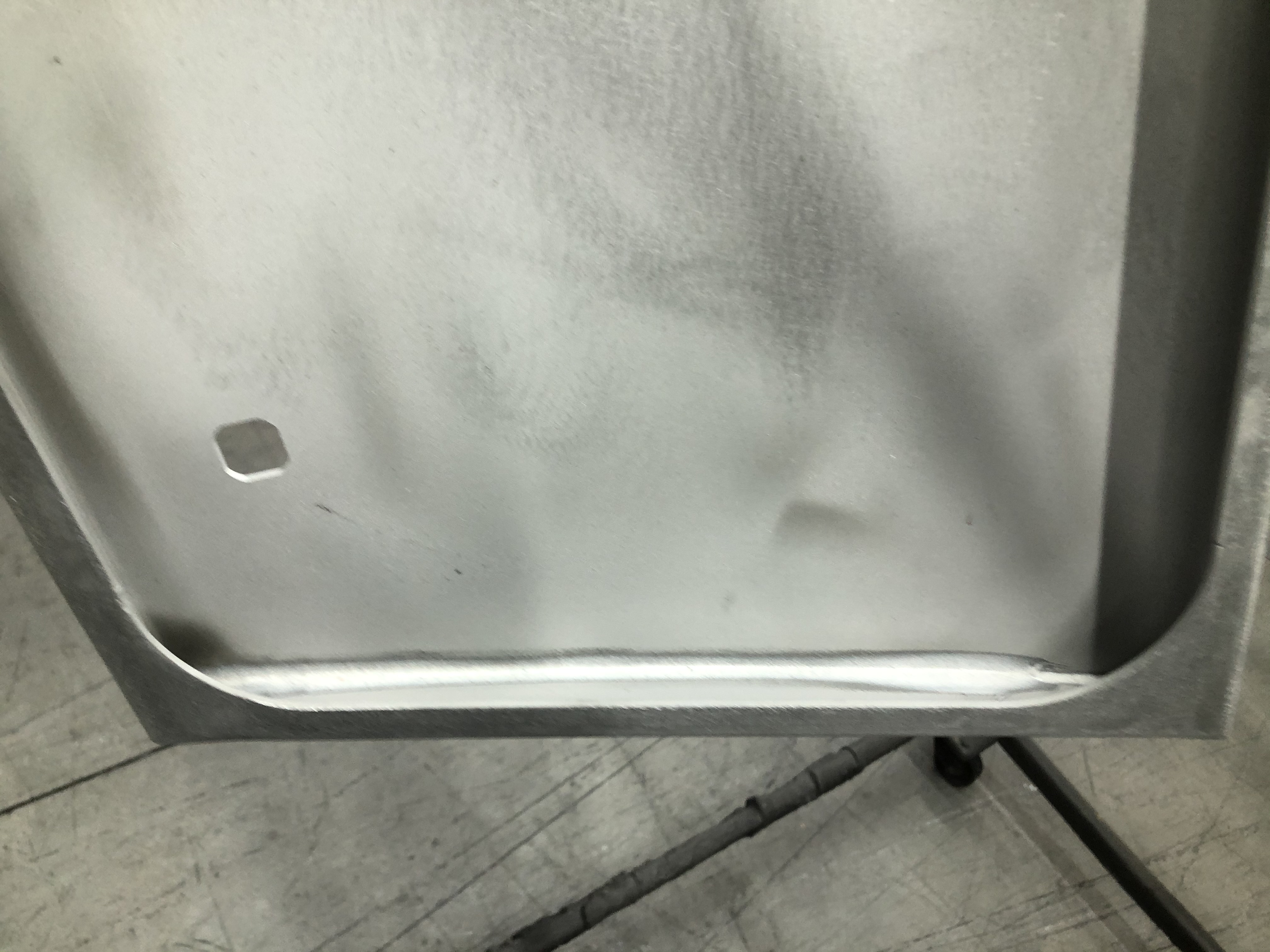

Some more Photos of the process
Had some free time this morning and decided to quickly finish grinding all the welding and the they were sandblasted afterwards for some good adhesion for the powdercoating and also everything gets sealed pre powdercoating for extra precaution
