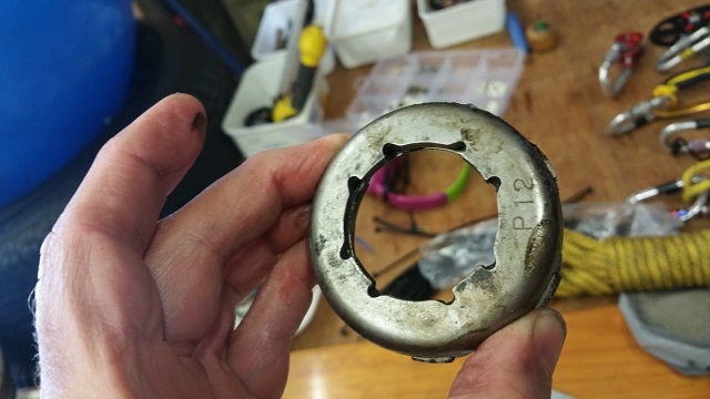

The auto-locking mechanism can be problematic and on my "platkar" patrol I have removed the auto mechanism (still using the OEM hub but with just the auto bit removed) so when it is in locked mode it is locked and when it is in auto mode it is freewheeling not auto. I drive with it in locked mode in 2H on tar quite a lot and it is not a problem.

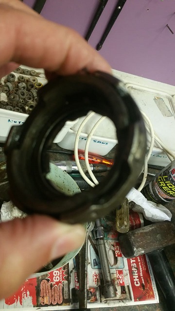

Take this thing out (as per the photo). Put everything else back how it was.
- IMG-20191208-WA0034.jpg (80.7 KiB) Viewed 6318 times
- IMG-20191016-WA0003.jpg (68.64 KiB) Viewed 6318 times

Thanks a ton for the details and photos belowSpike wrote: ↑17 Dec 2021 06:28 Nothing will happen to the Patrol if you drive in 2H with the hubs locked. Some people say you will use more fuel but I haven't noticed a significant difference. The Patrol is so heavy I don't think it notices![]()
