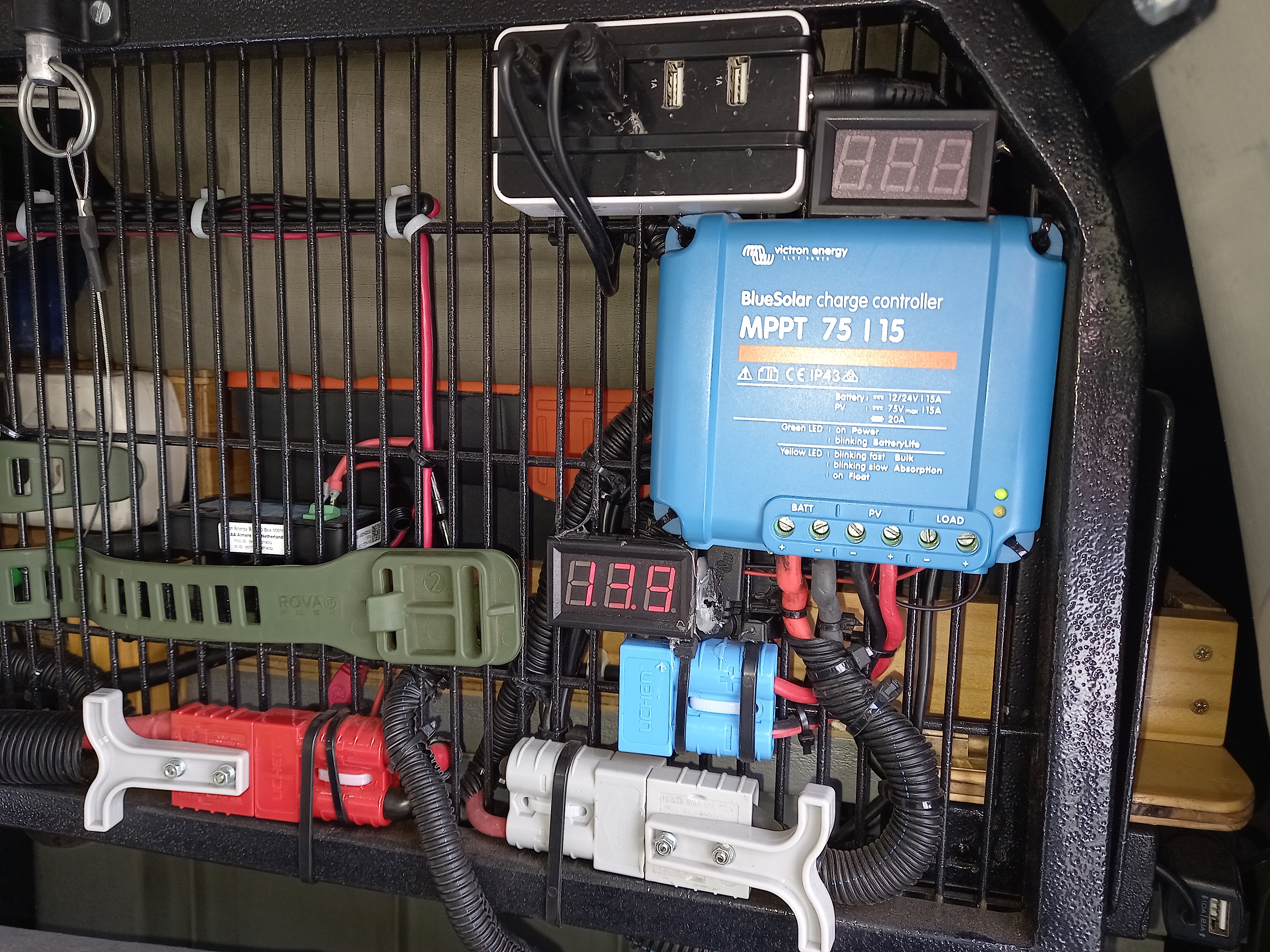

Fortunately at about the start of the lockdown last year, I had bought a new Orion (Victron) 12|12|18 Smart charger (18a) and a few month later I bought a Victron MPPT 75|15 Solar Charger (15a). These were all in preparation for the day I will inevitably move to LiFePo4 batteries.

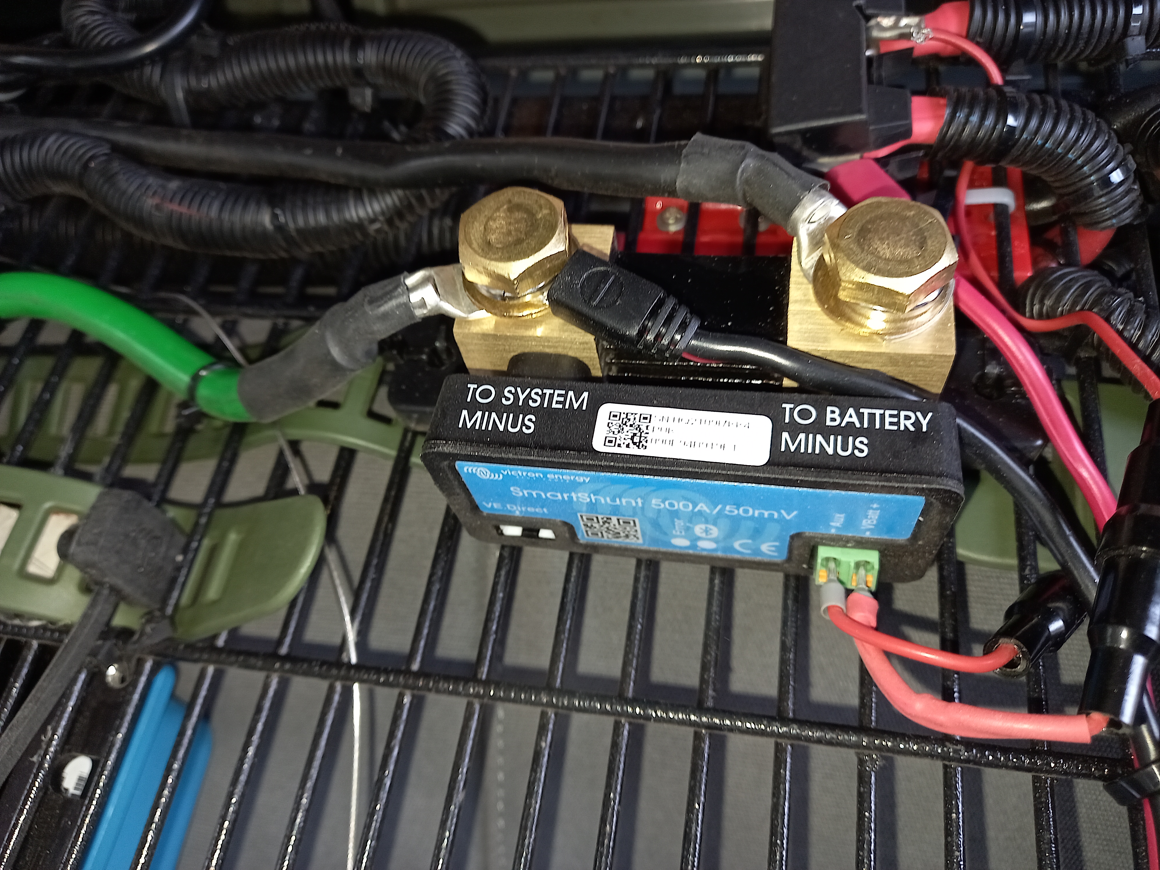

One problem with batteries is to accurately determine their State of Charge. Voltage is a very poor indication of SoC, it does not really tell you much of the SoC, the only way to determine SoC properly is to install a shut. If a lead acid style battery drops to below 12.2 volts, you have damaged it and would not last much longer. I was lucky to see that Current Automation's solar division had these on special a few months ago, So I got a Victron Energy 500A Smart Shunt (see here - https://www.bing.com/videos/search?q=vi ... &FORM=VIRE)
So when the battery arrived, I was amazed at how light it was, and instead of two 100ah batteries (at 34kg per battery) I now have one 14kg battery!! I fitted it and with some help from a friend, set up the correct charging voltages for the LiFePo4 Blue Nova battery. It wants 14.2v for the bulk and absorption phases and 13.6v during float charging. This was easily enough via the app that I downloaded to my phone from the Victron Website for each device.

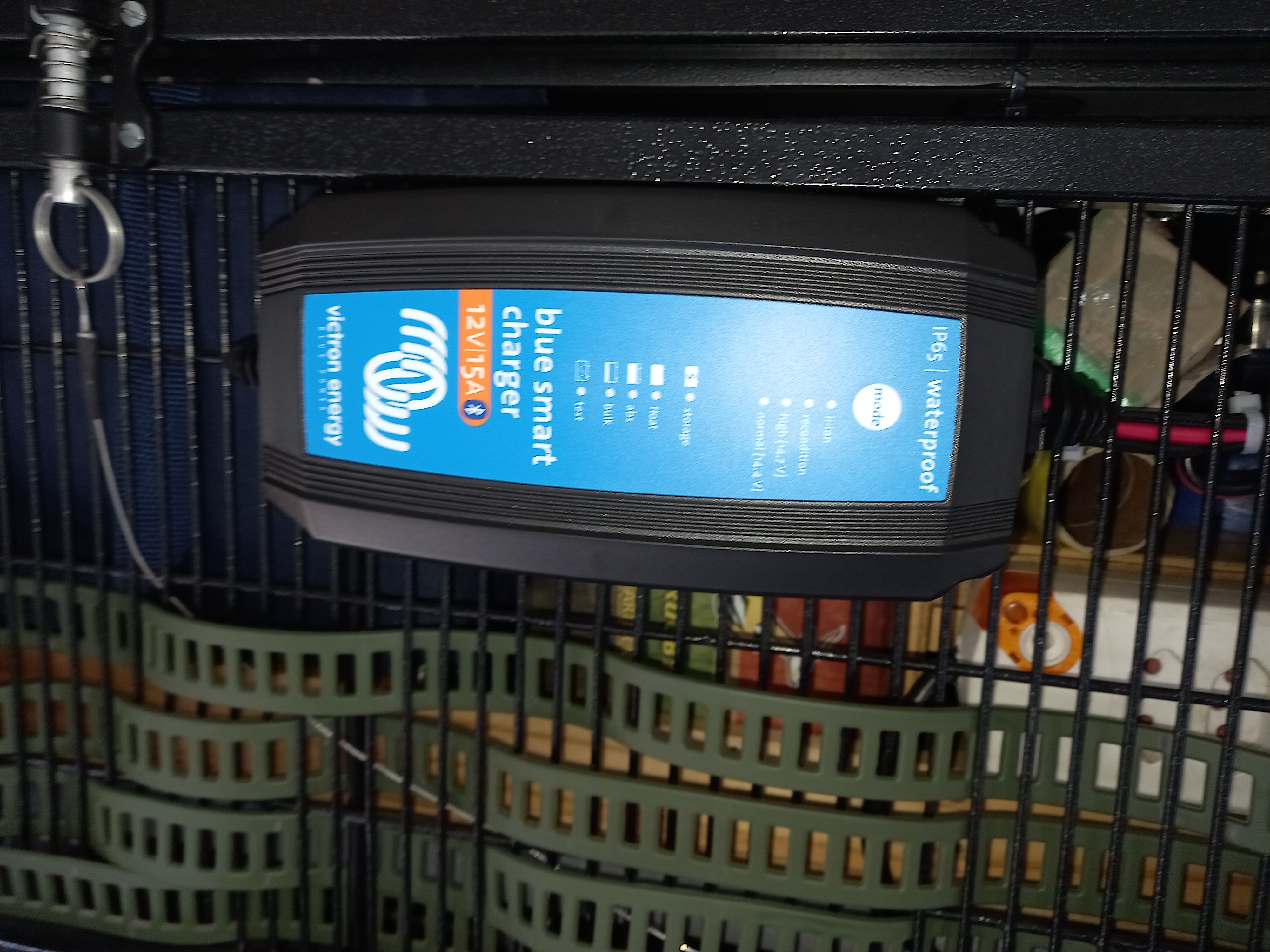

I will a bit later, I am first going to 4x4 Direct in Boksburg to get the Victron Blue Smart DC to 12Volt 15 Amp charger this morning, then I will find a place to mount it. Once fitted, I will take and post pictures.

Pleas give feedback on the Shunt, as that is the one thing I do not have in my system and its not cheap ... so would like to know how it works.

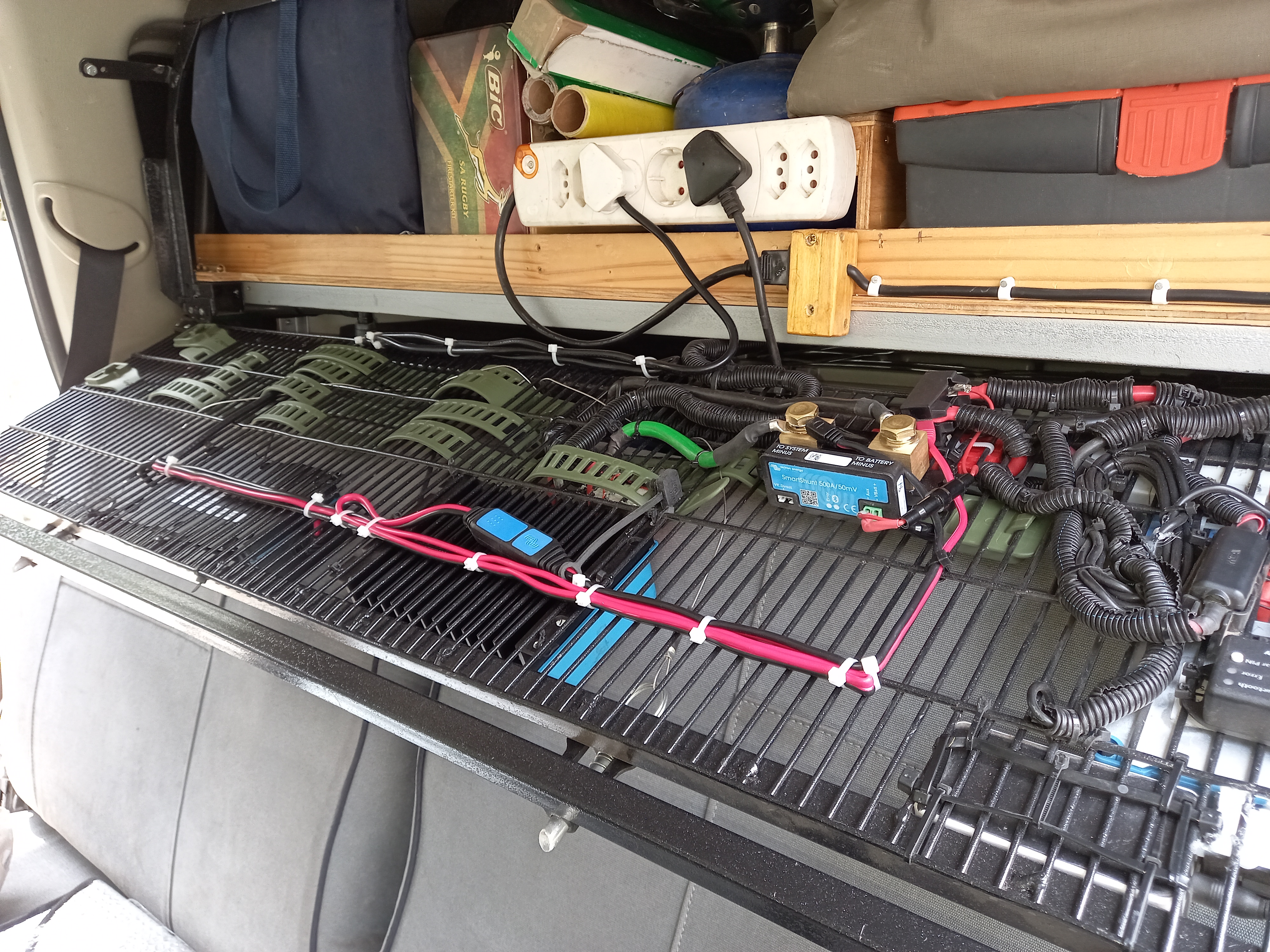

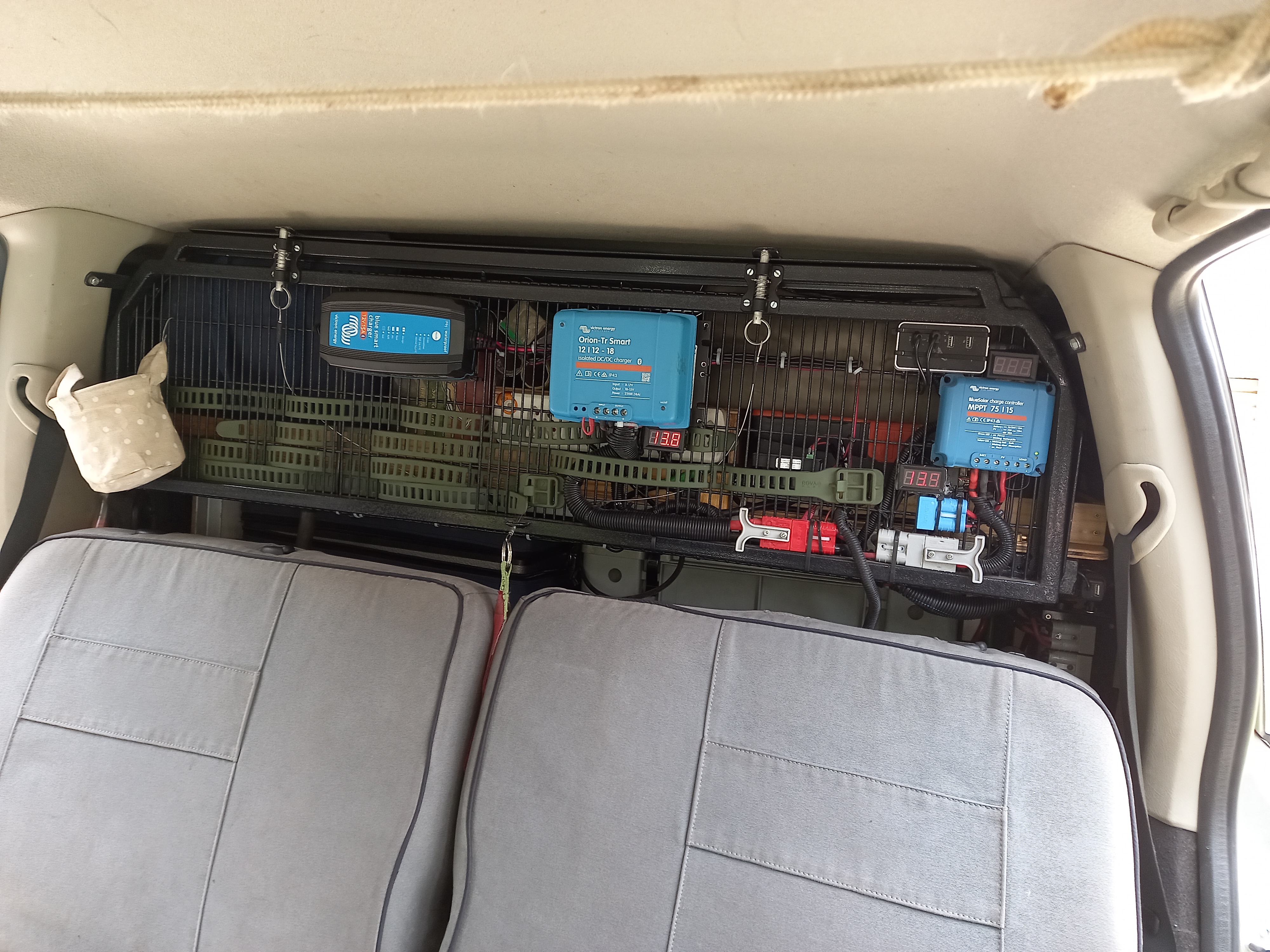

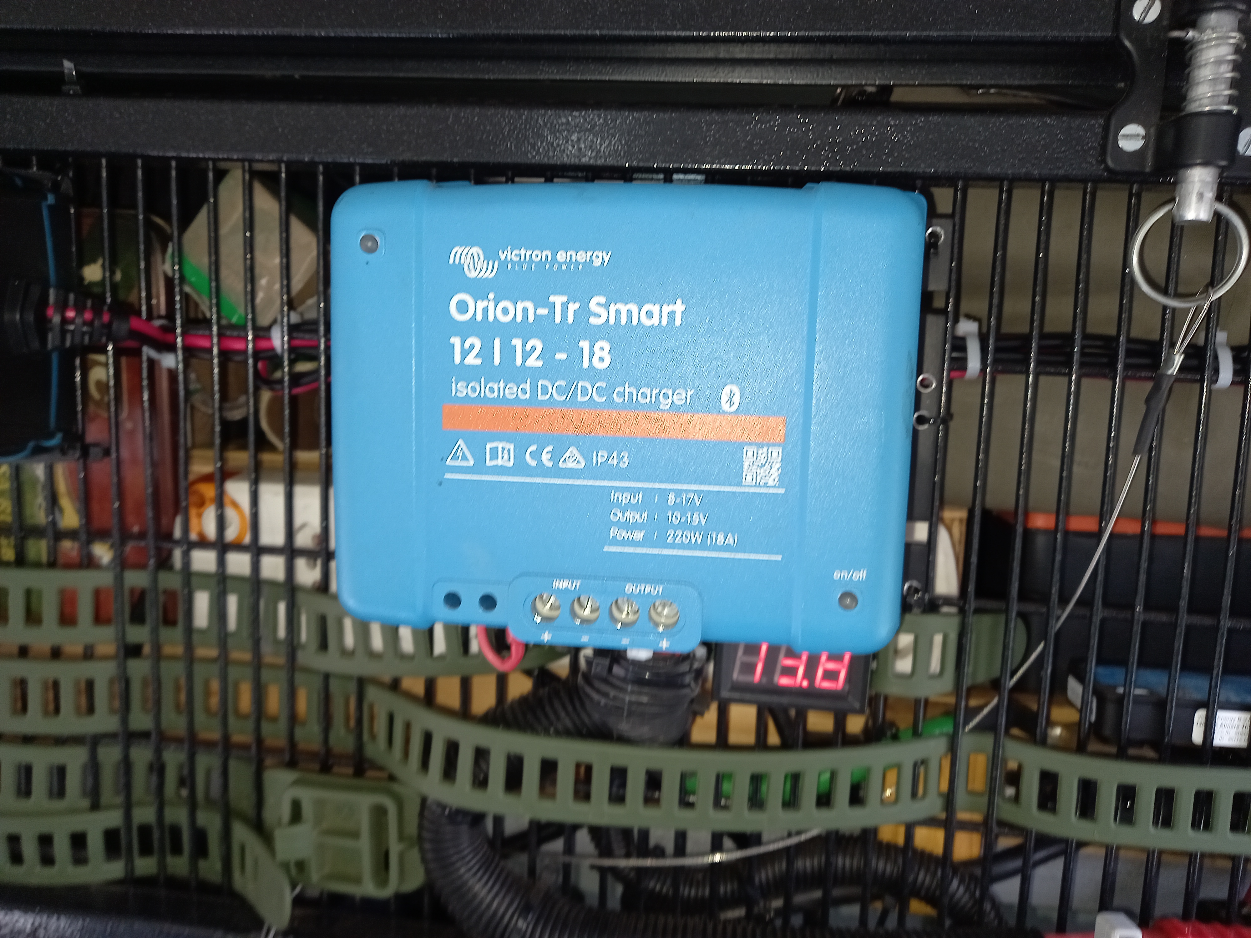

So here are the pictures:

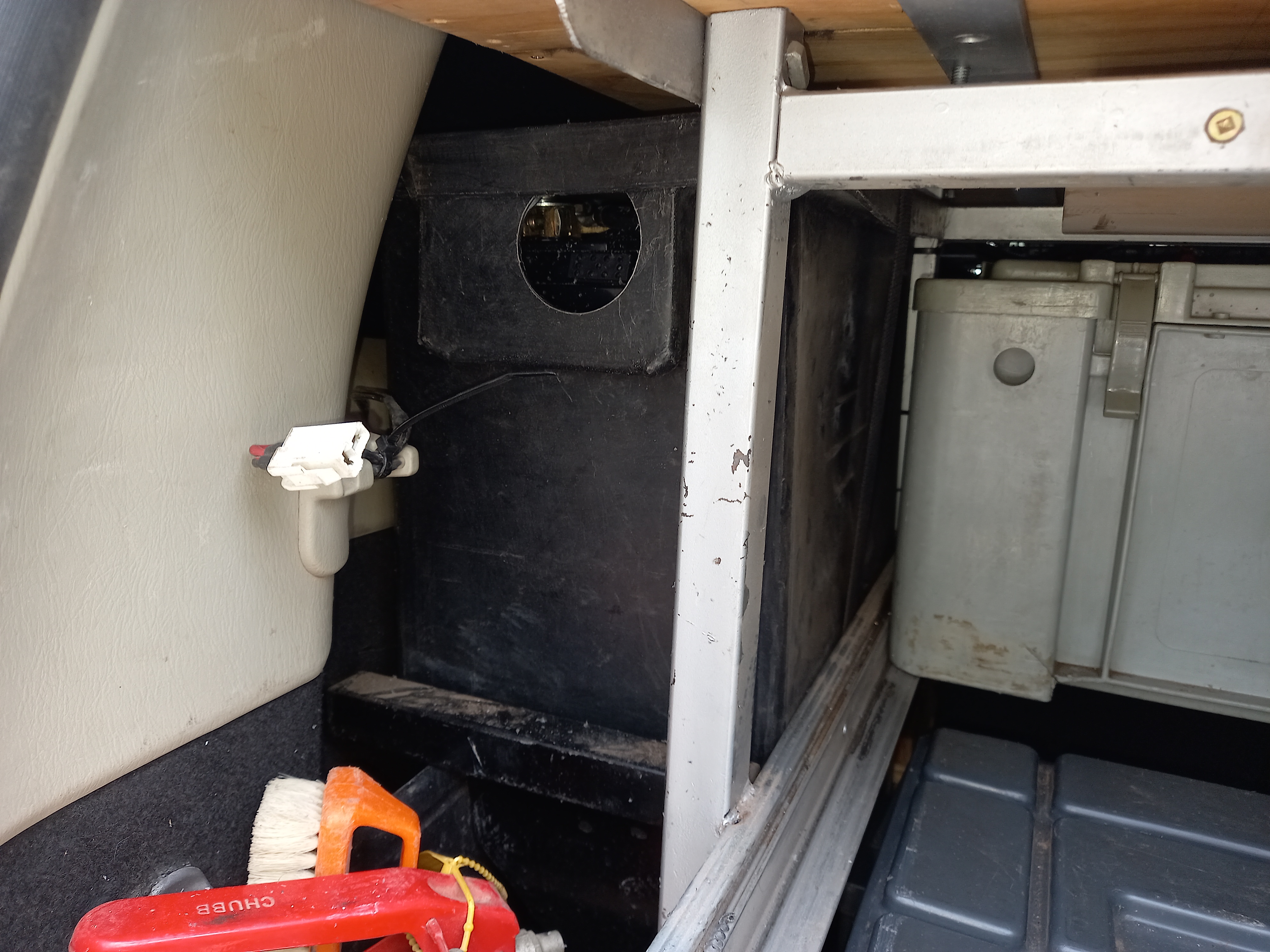

The first one is the battery in a box with ventilation holes. It is up against the left rearmost window, above the left rear wheel arch, in what would have been wasted space.
All this now means is that I have now an empty hole in the engine bay, where the second auxiliary battery used to go. This may be a good place to fit an "On the Road Oven" for slow cooking a roast en-route to our day's destination....
