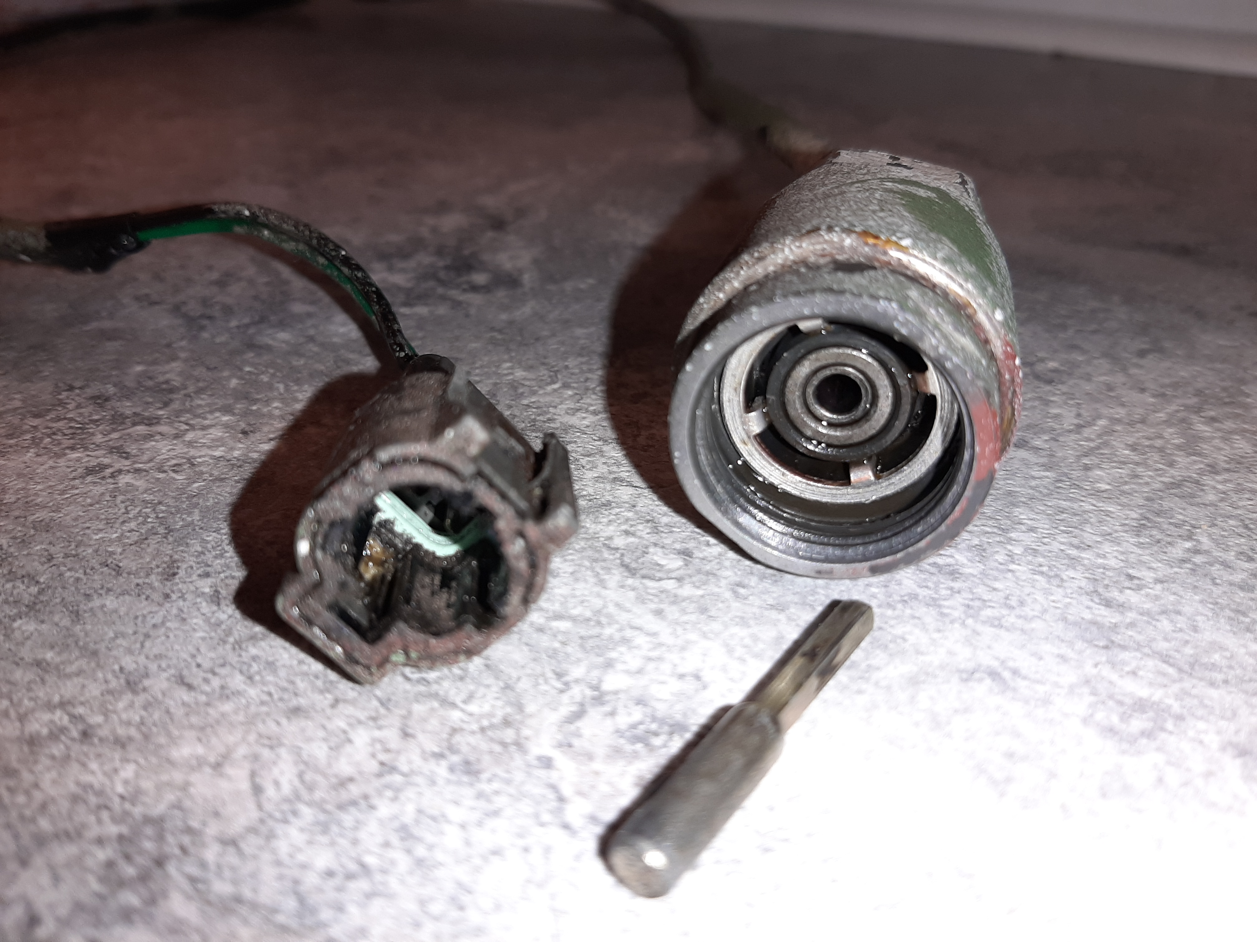

I removed the speedometer sensor and the pinion (correct word?) insider the gearbox. Pinion seems to be OK. I checked the sensor: seems to be OK. I see some volt on the voltmeter. oscilloscope says OK.
But I ordered a new one in Dubai: but same results. I used a drill on the sensor to check the function: but nothing.
So the only idea: both speedometers are broken or a broken cable.

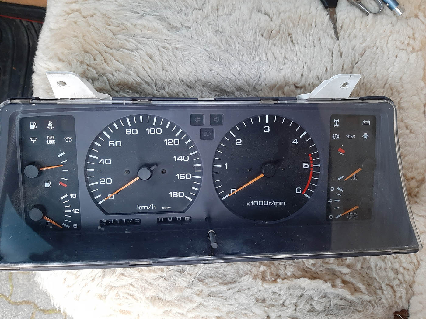

(the first pic shows the bought used speedometer. Normally I do not disconnect plugs this way :biggrin: )

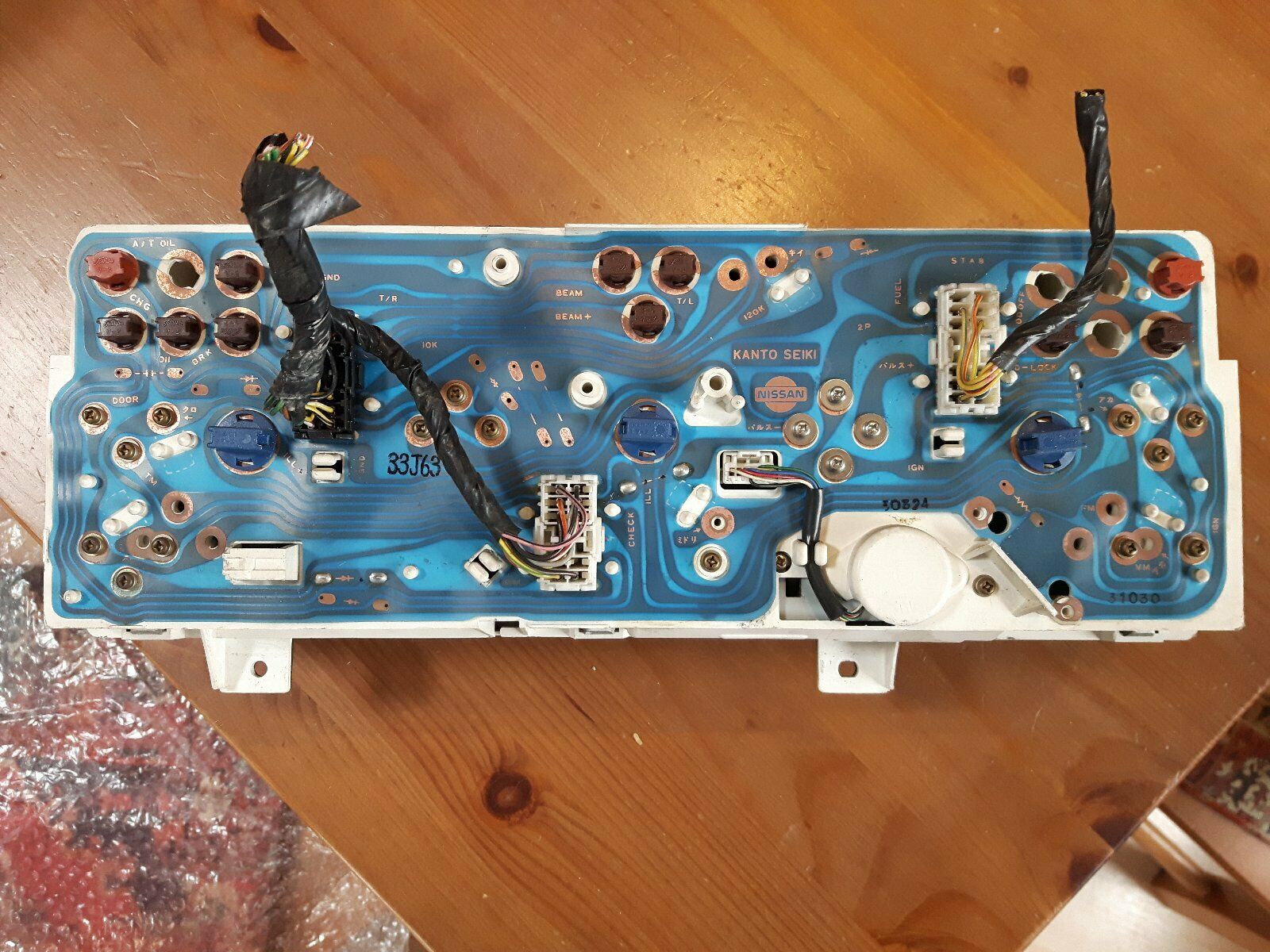

So, I have the solution:
the original and the spare speedometer had exavtly the same issue. How big is the chance to get the same problem in 2 different parts? Big enough!
After repair (3 weeks and 400 Euro urgh...) of the speedometer everything OK again.
And of course the dealer of the spare speedometer says: everything was OK when he shipped it
