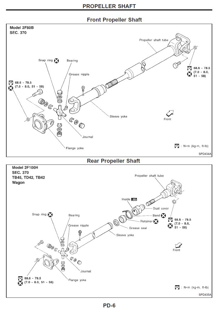

Re: Lubrication Points On 4.8 When Servicing
Same as on the GU. Three on each prop shaft (one inside each U-joint and one on the spline/slip joint.
There may or may not be nipples on the four tie rod ends.

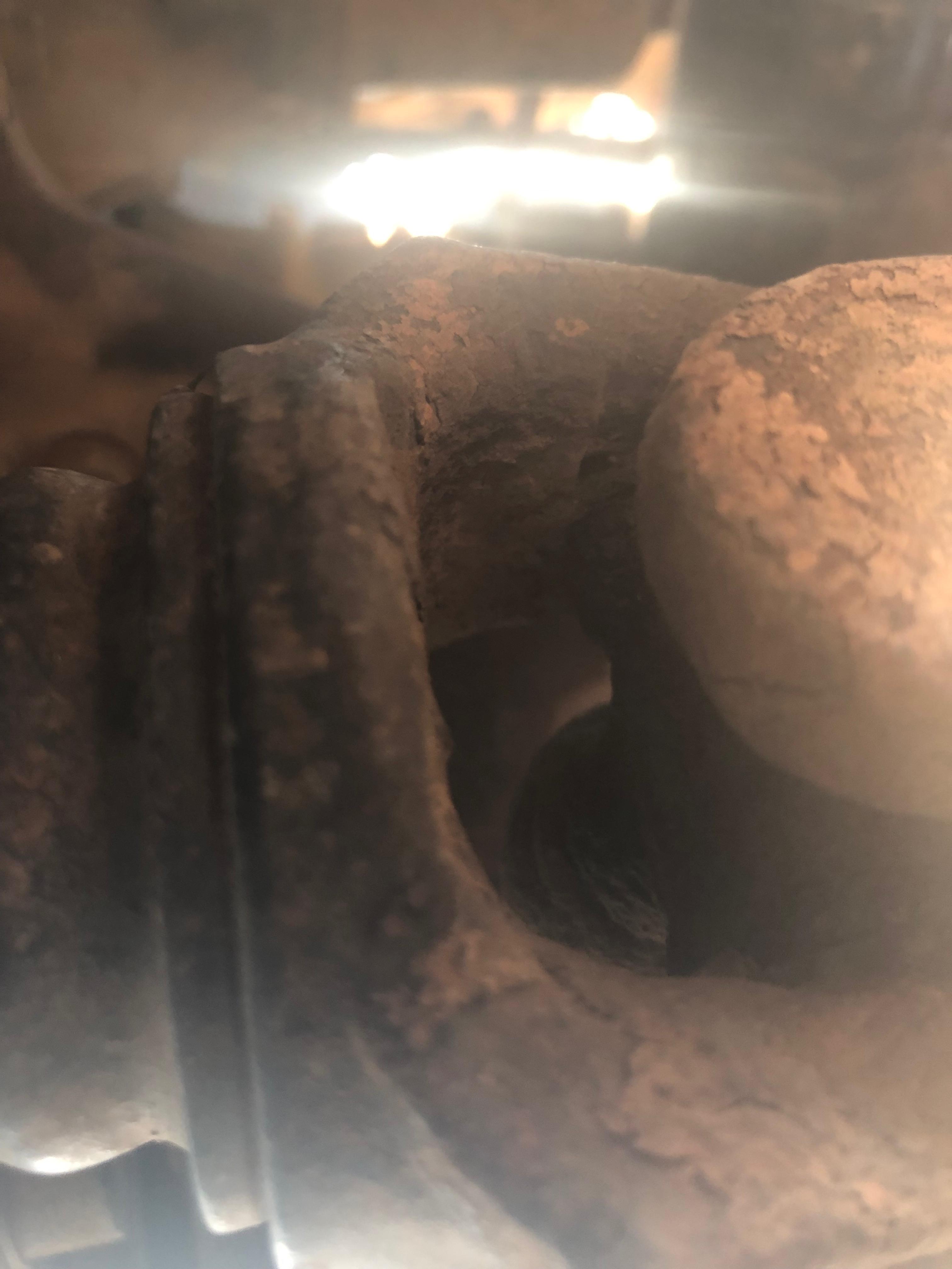

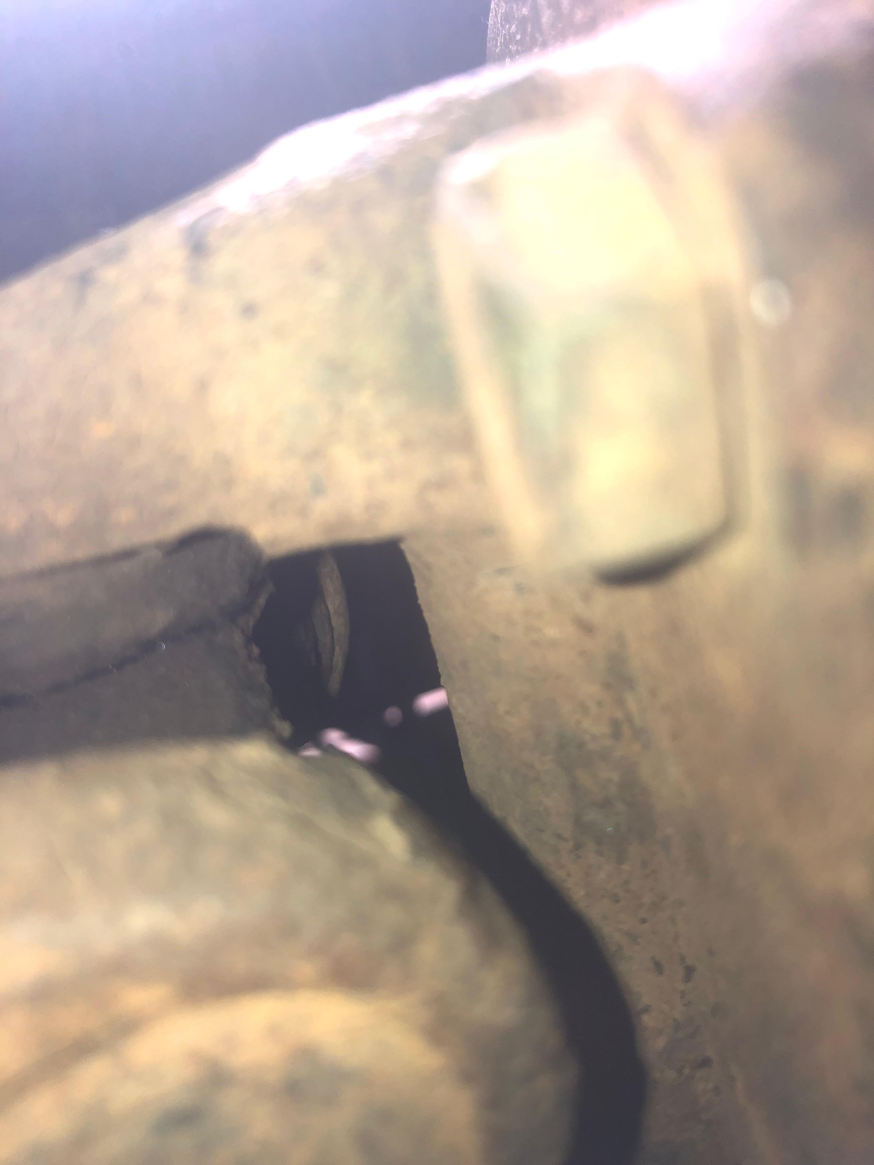

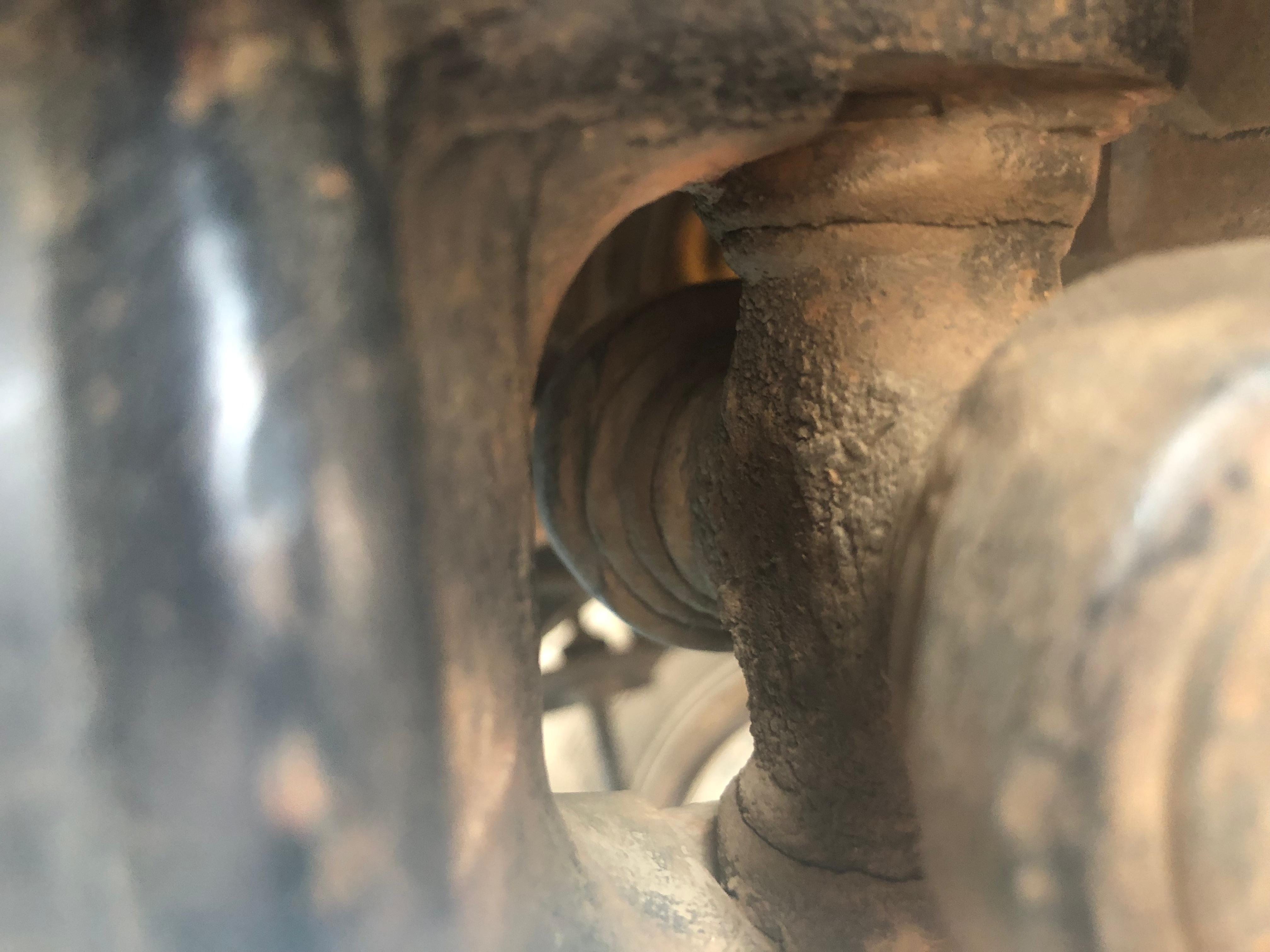

I could only find one on each slip joint and one on each u-joint.
(4 in total - on both prop shafts I find only one nipple, both in u-joint closest to slip joint.
In u-joint furthers from slip joint, on both prop shafts, I cannot see a nipple).
No nipples on the tie rod ends.
Interesting.
On mine there are most definitely nipples in all the U-joints.
I don't think it's possible to feed a U-joint grease from the shaft either. At least not without significantly weakening it.
Did somebody perhaps remove the grease nipples and fit a plug instead? Although I can't think of a good reason to do so?
I would spend some time and effort on this if I were you. A U-joint breakage can under certain circumstances be extremely dangerous! Just ask the guys who saw the U-joint breakage on Rust de Winter's Hilux on the first forum trip there (I think it was 2011).

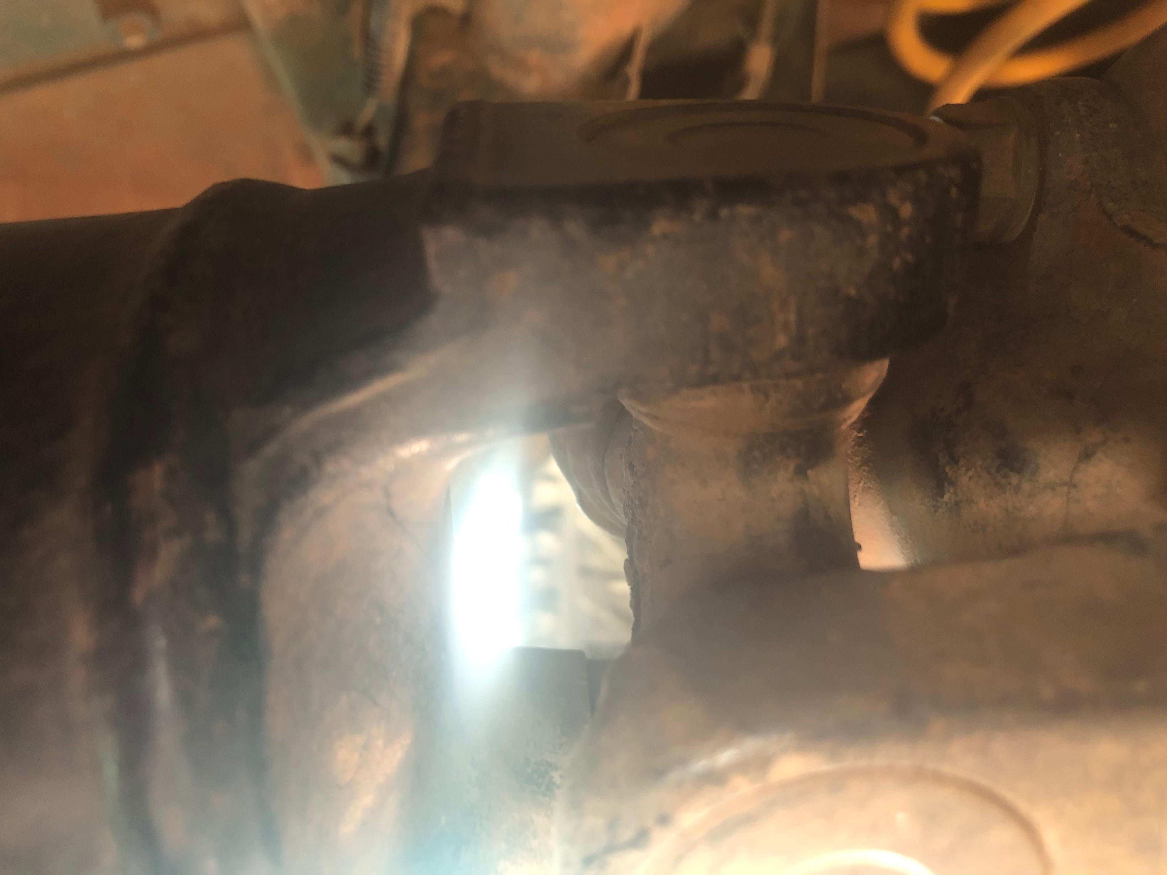

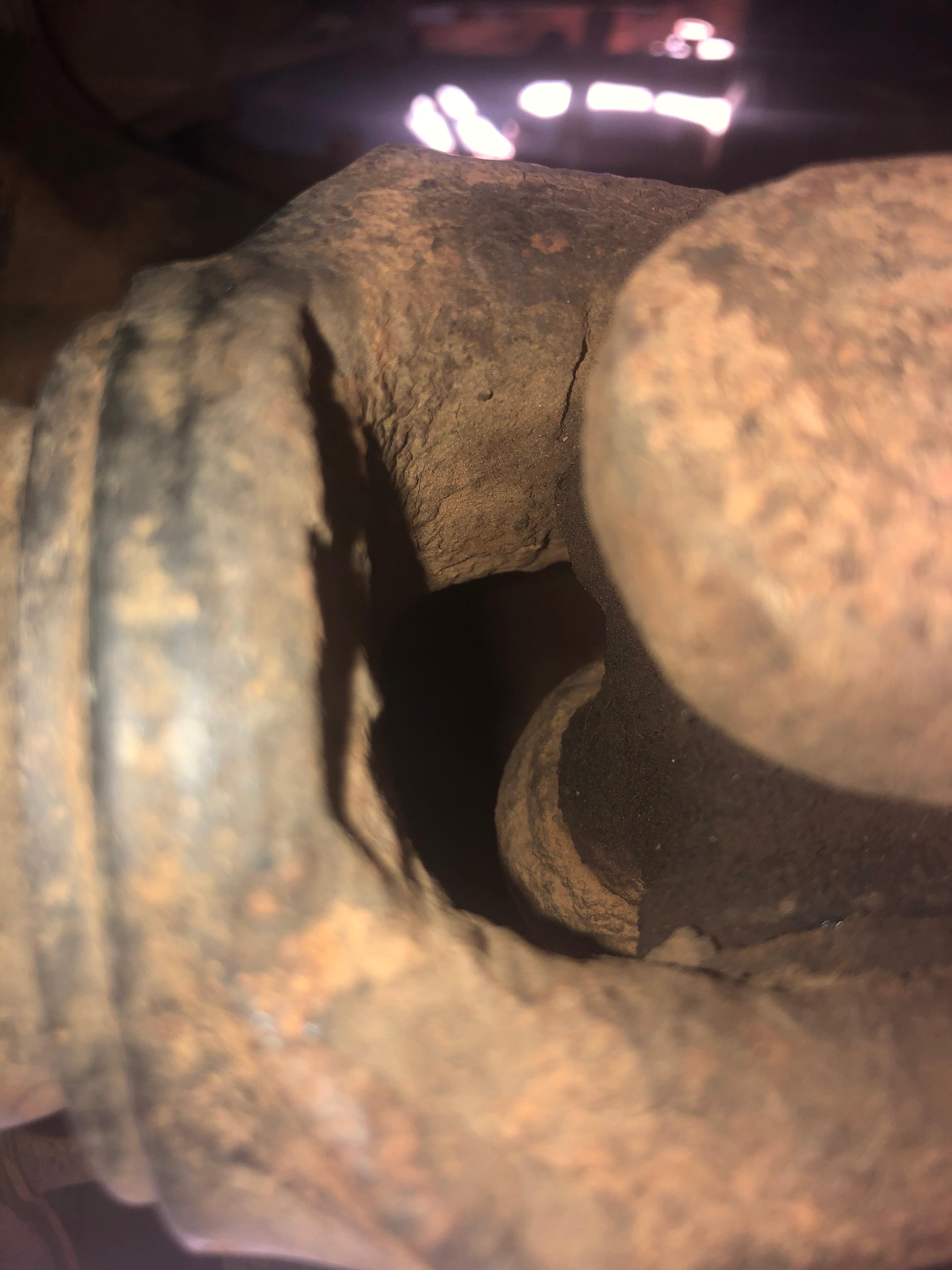

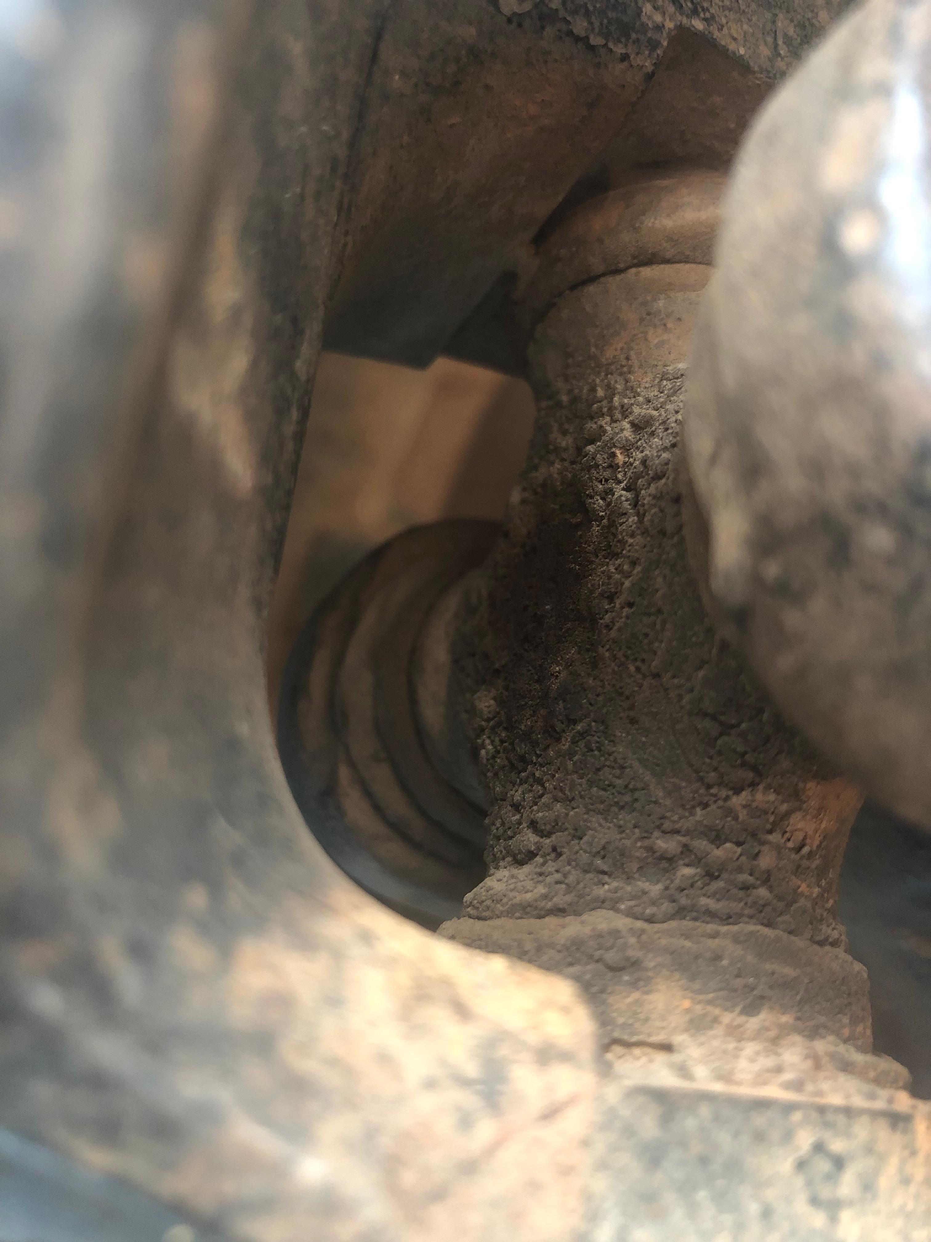

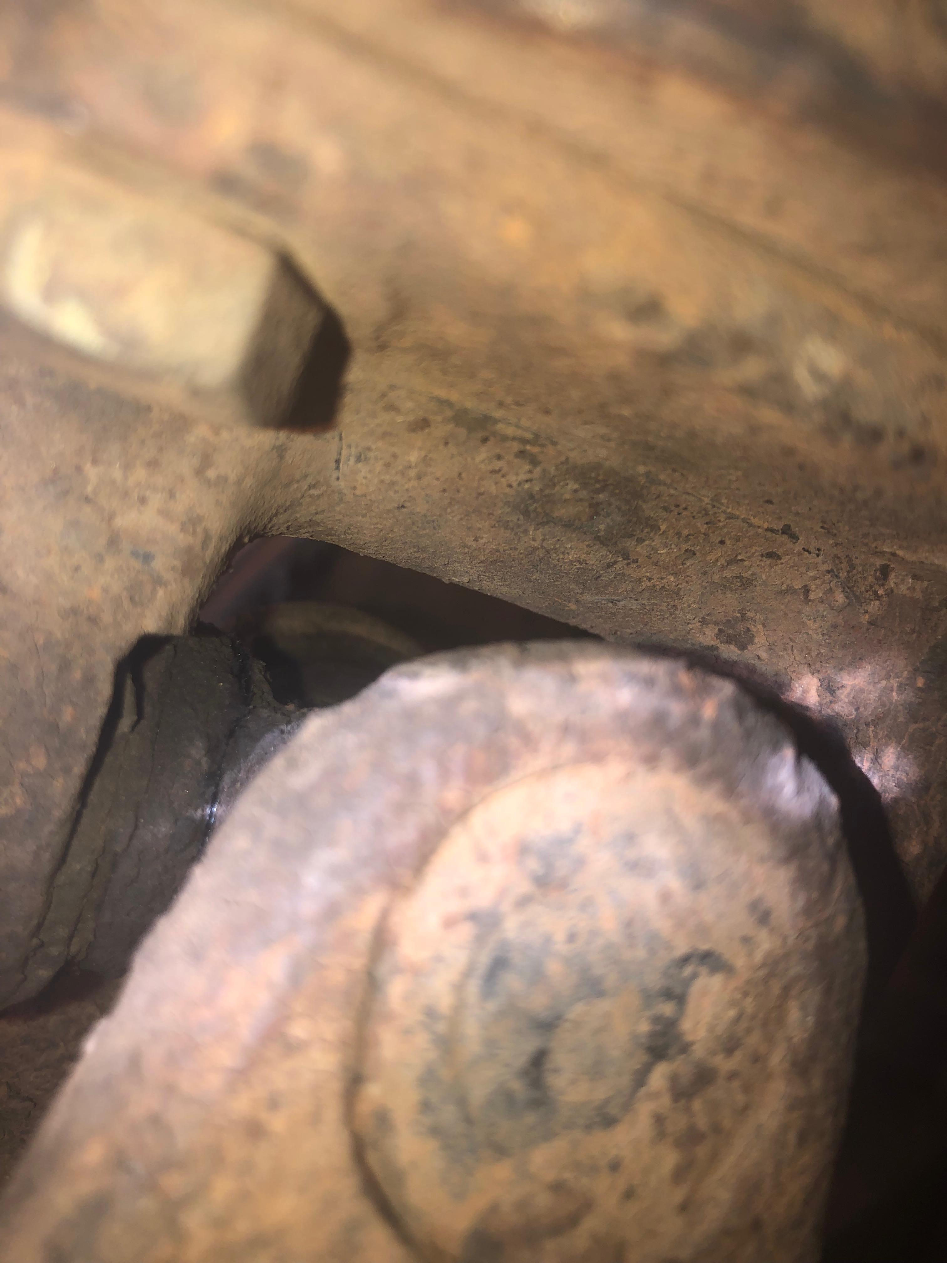

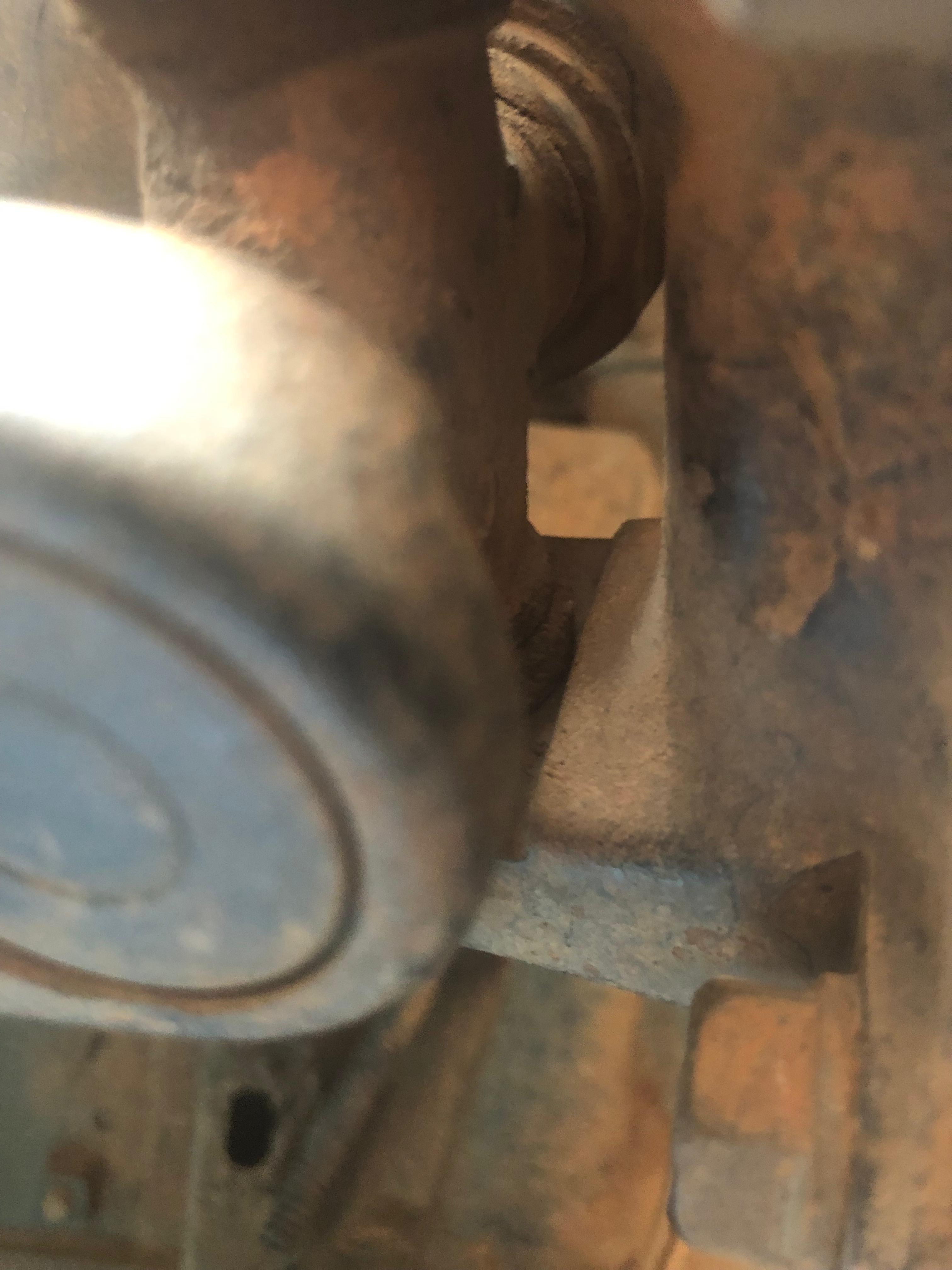

- Posts: 3370
- Full Name: Fanus
- Has thanked: 249 times
- Been thanked: 219 times

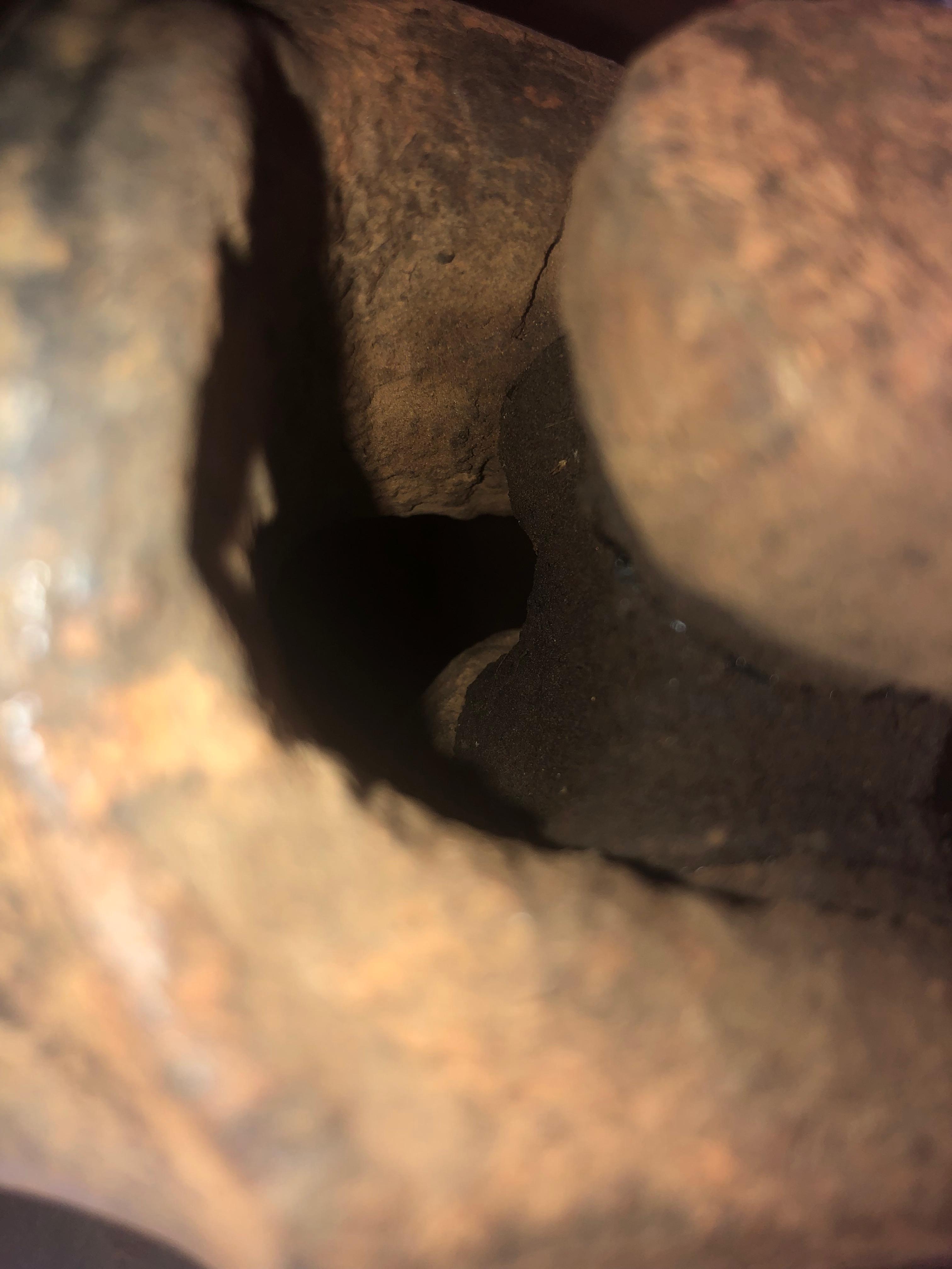

Just double checked mine, definitely no grease nipples in the two uni's marked in yellow...

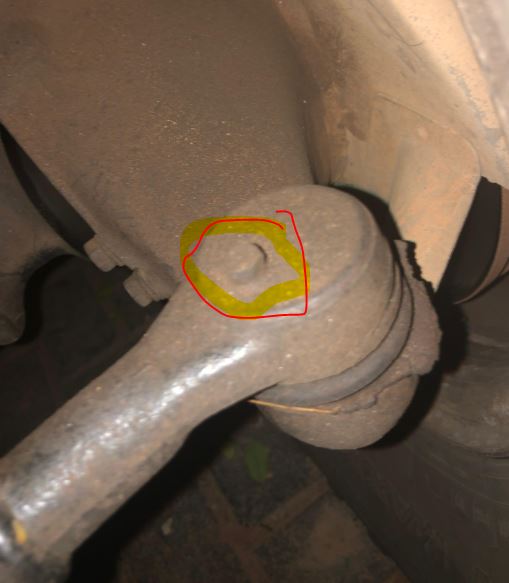

I see on my gq's tie rod ends, there are these little bolts.
Can this be undone to feed some grease? (Or be replaced with grease nipples?).
Yes, those can be temporarily or permanently replaced with grease nipples.
