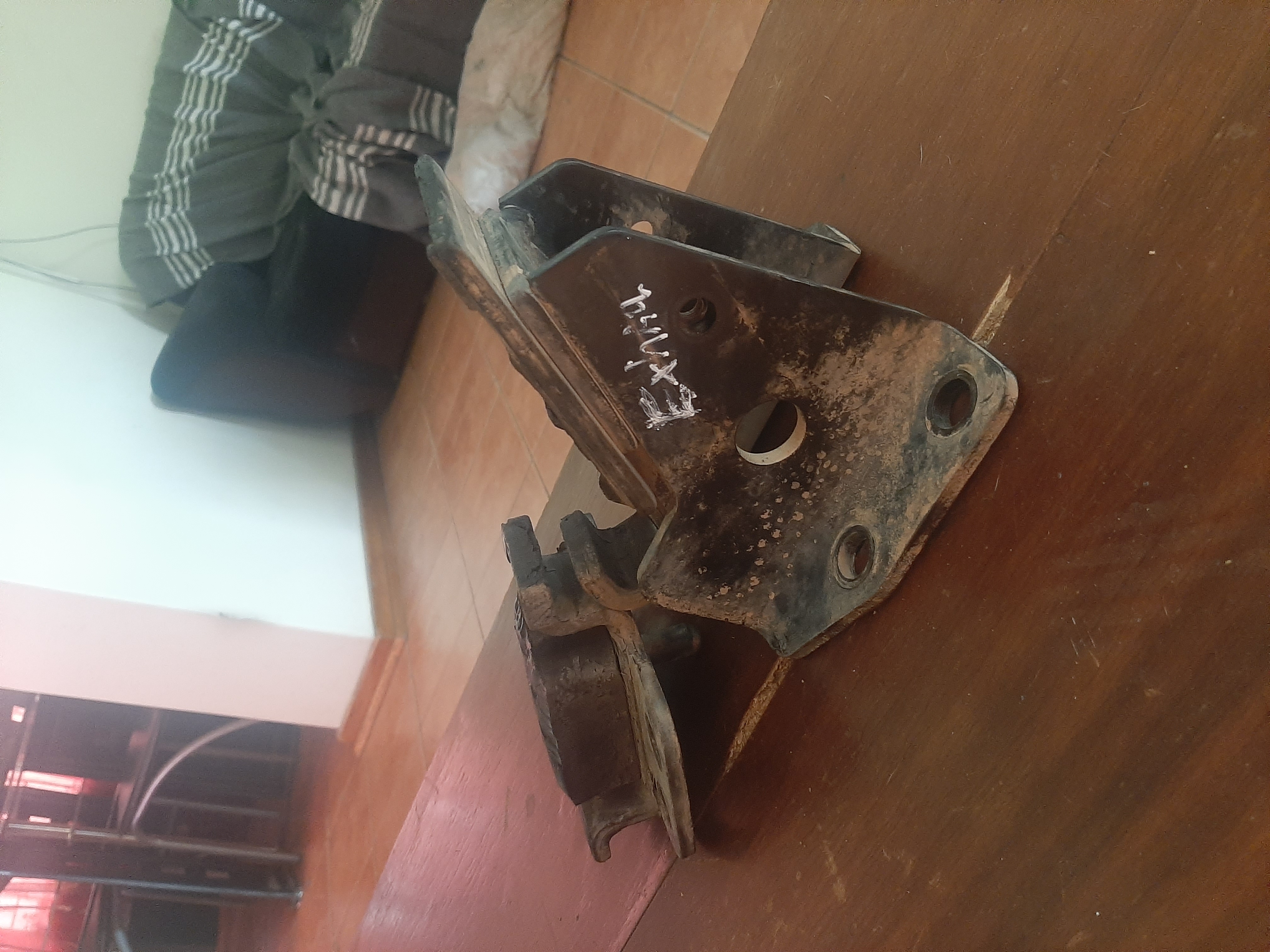

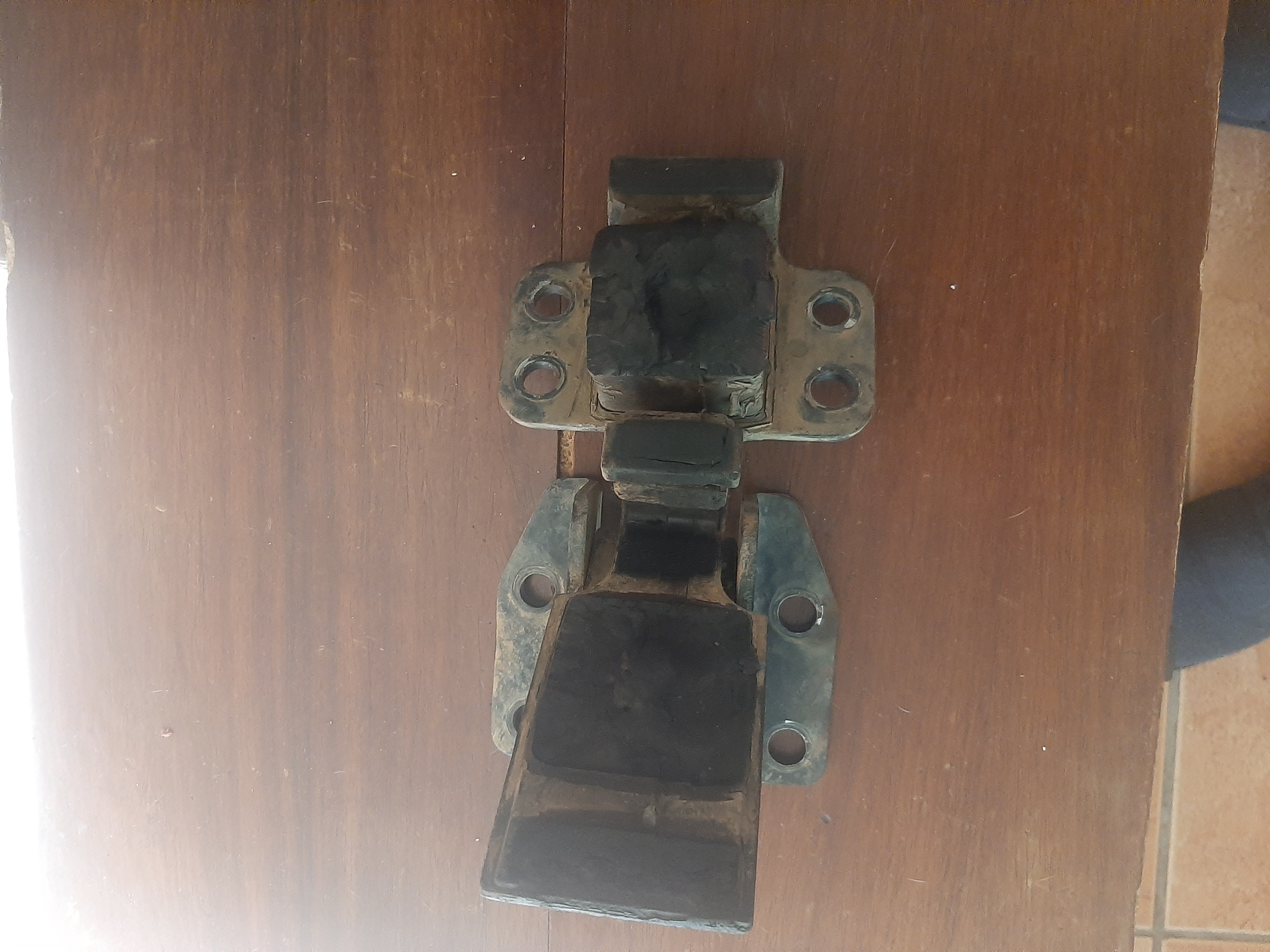

Hye guys, I got a finale question, Went through everything today to make the engine install smooth as possible and found out this mounting
on the exhaust side of the block was hanging on by a litteral thread! :) It spoke its last words as a turned it around lol.
Do any of you guys know where I can get one please? At nissan they are R1840ish inclusive each.
Hopefully I can get a 2nd hand one or maybe an after market not sure?
Thanks all and have an awsome day!
