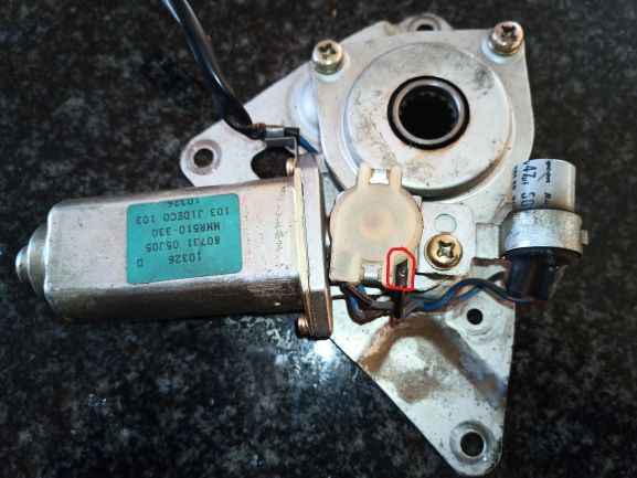

So the Safari is old, 1992. I would think she will require a bit of care, I do not know her history.
The drivers window stopped working. So i decided to take a look.
And heaven forbid, this old car has those old style door door cards of soft "wood" with a "rivet" plastic which holds onto the door frame.
After a few VW's owned, once you remove the door card; it never goes back snuggly. And sure enough, the soft wood broke where the rivet holds.
Will need to get a few more rivets and create some kind of fastener to the wood area.
Anyway, i tested the switch panel. The switch was registering voltage when operated up & down.
So this left the motor. Stripped it off and connect a 12V supply to it. Nothing. My first thought was the relay. After tussling with it, i managed to open and test the relay. All good too.
My fear was the motor itself. But just by chance, i noticed a loose wire out of a round plastic white shield. I'm not sure what the purpose of it was. So i wacked out the 12V again, added power and connected the loose wire. Presto, it worked.
Lesson learnt here, old cars have old brittle wires; it should have been my first inspection.
Re-solder the wire and re-installed.

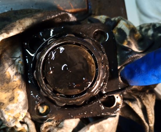

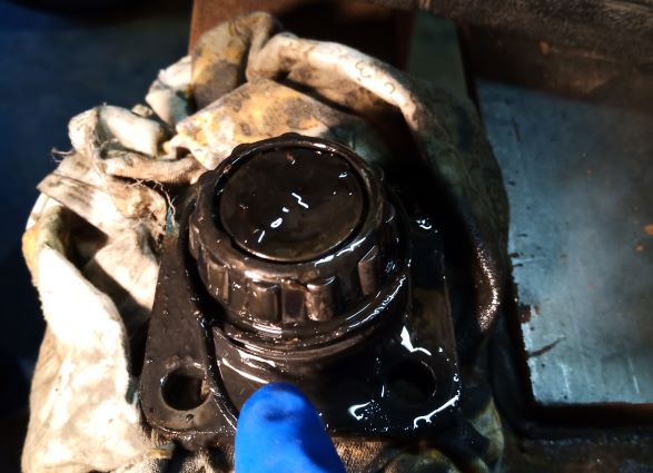

I took my wife for a drive, very proud and stuff. Going around a bend, the steering started to shake. I ride a motorcycle as well, although that has never happened to me on my bike; the rule i remember is never death grip the steering if it shakes violently as it will only exacerbate it. So loosely held on, foot of the gas and with being a diesel; the speed slowed down significantly and the shaking stopped.
I played it cool with the wife, like it was not much; but i would not want to experience that again.
So, when i got home; i googled the issues. The common fault pointed out was balancing, wheel bearing loose, panhard bushes worn and kingpin bearing shim.
I was eager to sort it out, as wanted to use it to Hazyview last weekend. I thought if i could quick fix it; we would be good. After a few Youtube videos and great writeup from this forum; i decided to give it a try.
Jacked up, tyre removed.
The top kingpin bearing was easy to remove and replace & took out the shim.
The bottom was also easy to get off (lots write ups suggest the brake dust cover getting in the way of bolts) as well.
But i could not get the bearing back into its housing. I huffed and puffed and maybe too much; i damage the rubber seal around the bearing.
So, i was stuffed. I decided to close it up and sort out next weekend.
I cut off the rubber seal as I did not want shards of it going into the housing and knew it would go in much easier with it off.
Pic of the bearing with rubber seal damaged.

I do not have any experience with this kind of stuff. So its very much learning as I do. With that said, for a few days after, I gave it a bit of thought; what i did wrong or should have noticed.
A few things stuck out to me.
First, the grease was not grease. It was slimy liquid like oil.
Second, I should have packed grease on the bearing/seal and receiver.
Third, I had to jiggly the swivel to align the inside and outer swivel.
I was impatience and wanted to go on holiday with it. Whereas i should have paid more attention. The slimy liquid is probably a sign of oil mixing from the diff.
If i has applied grease to bearing; i would not have damaged the seal.
So, with all of this; it has made me realize; I should actually be stripping the swivel hub and replacing the seals, bearings etc.
