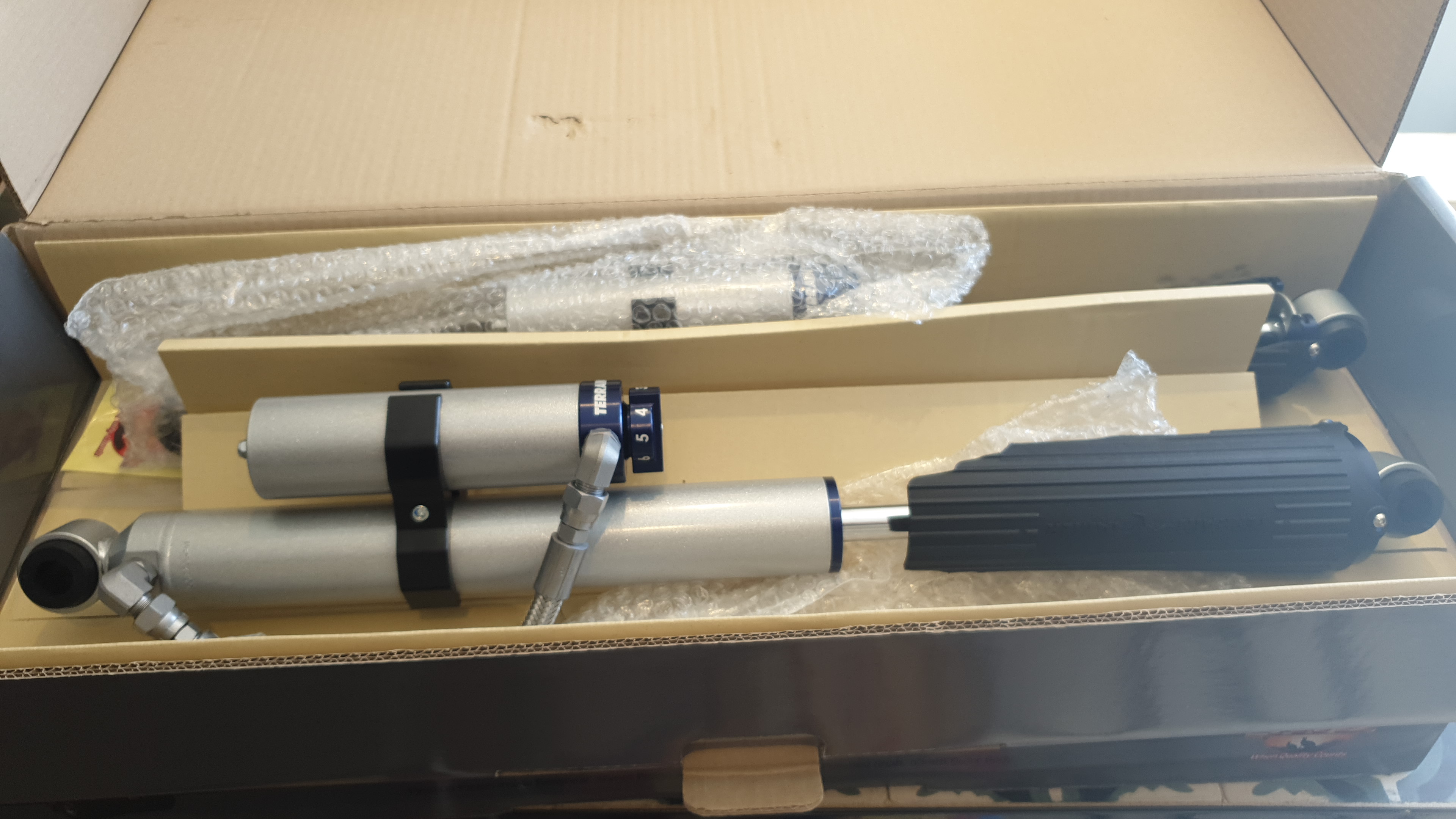

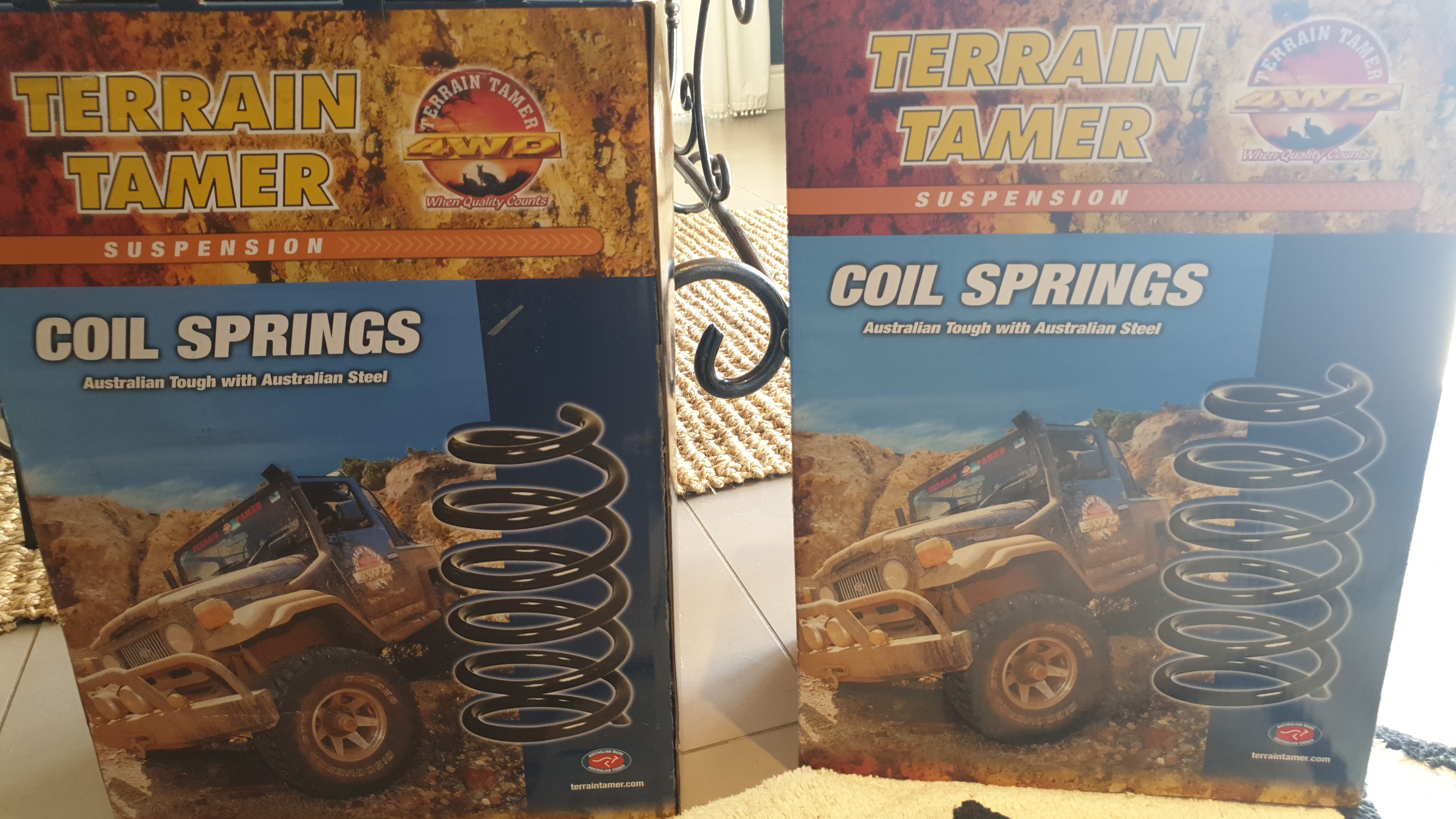

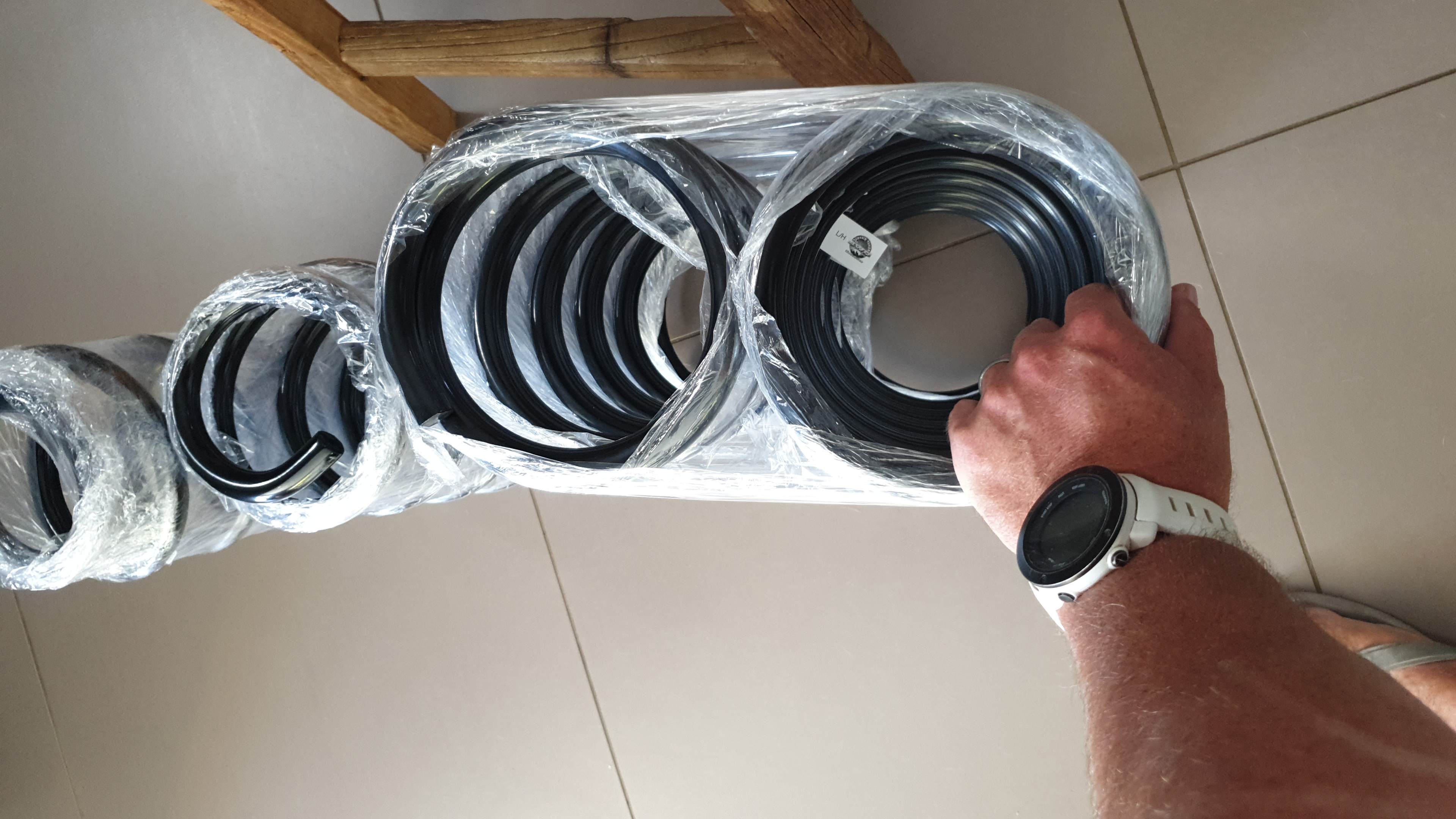

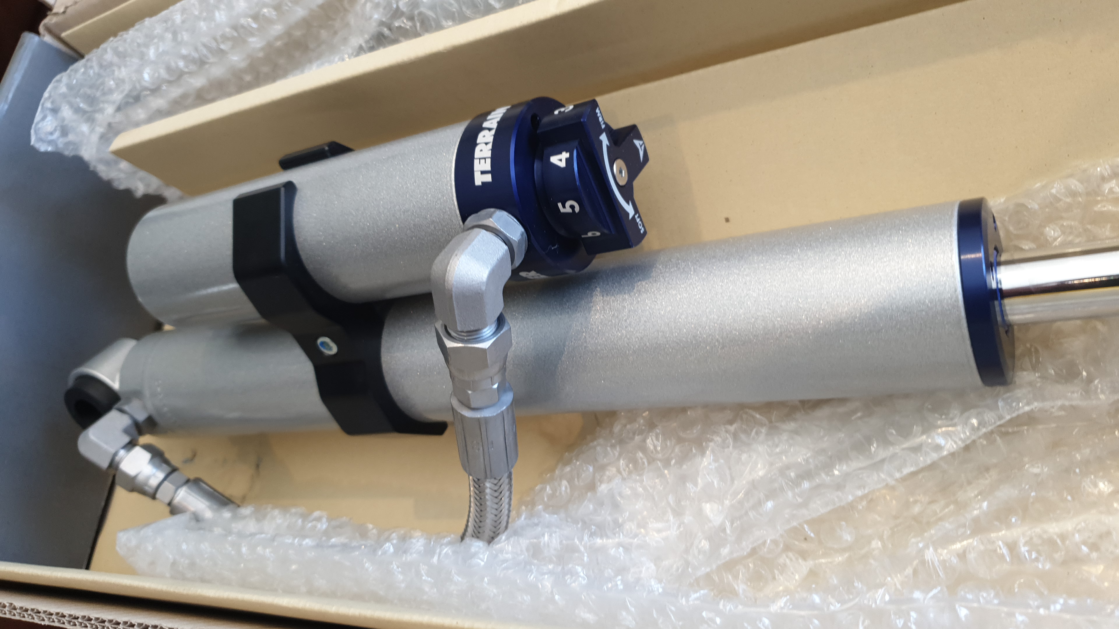

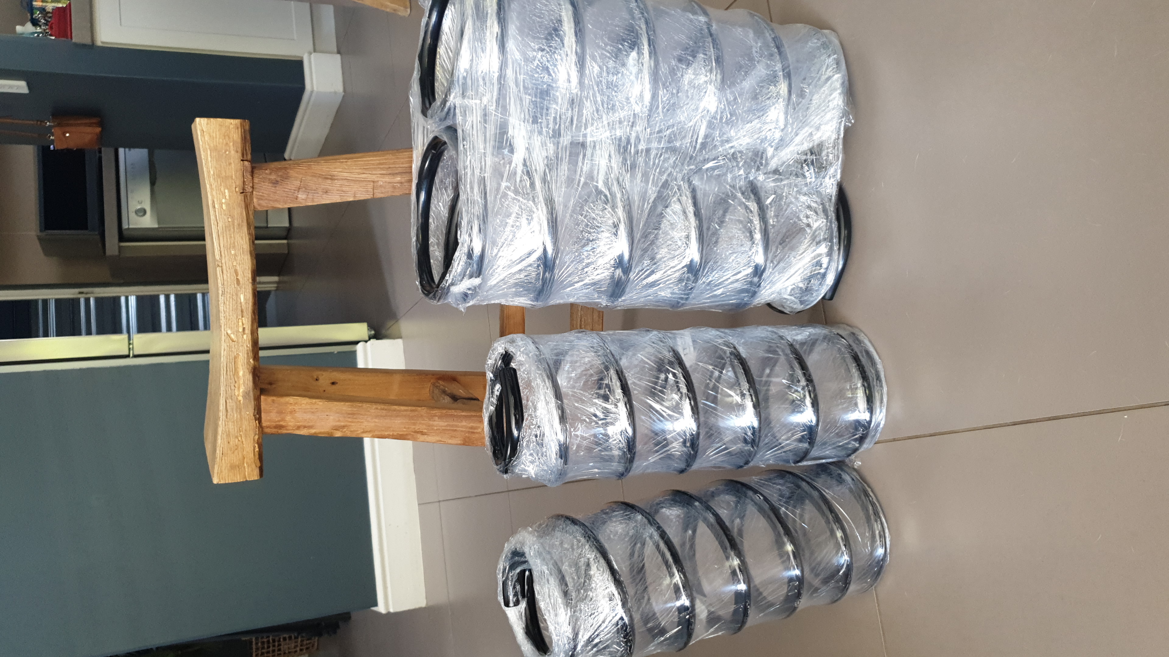

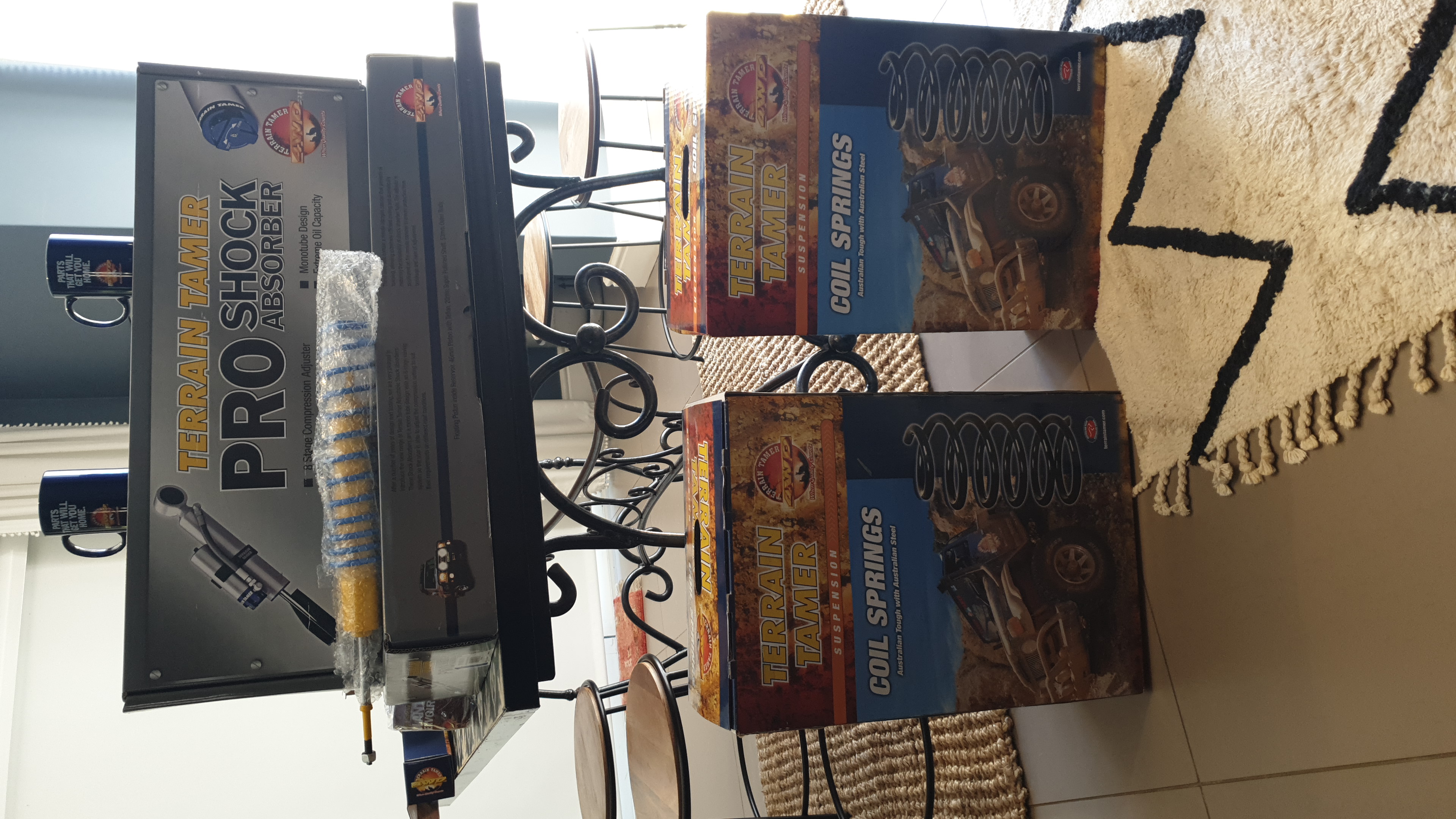

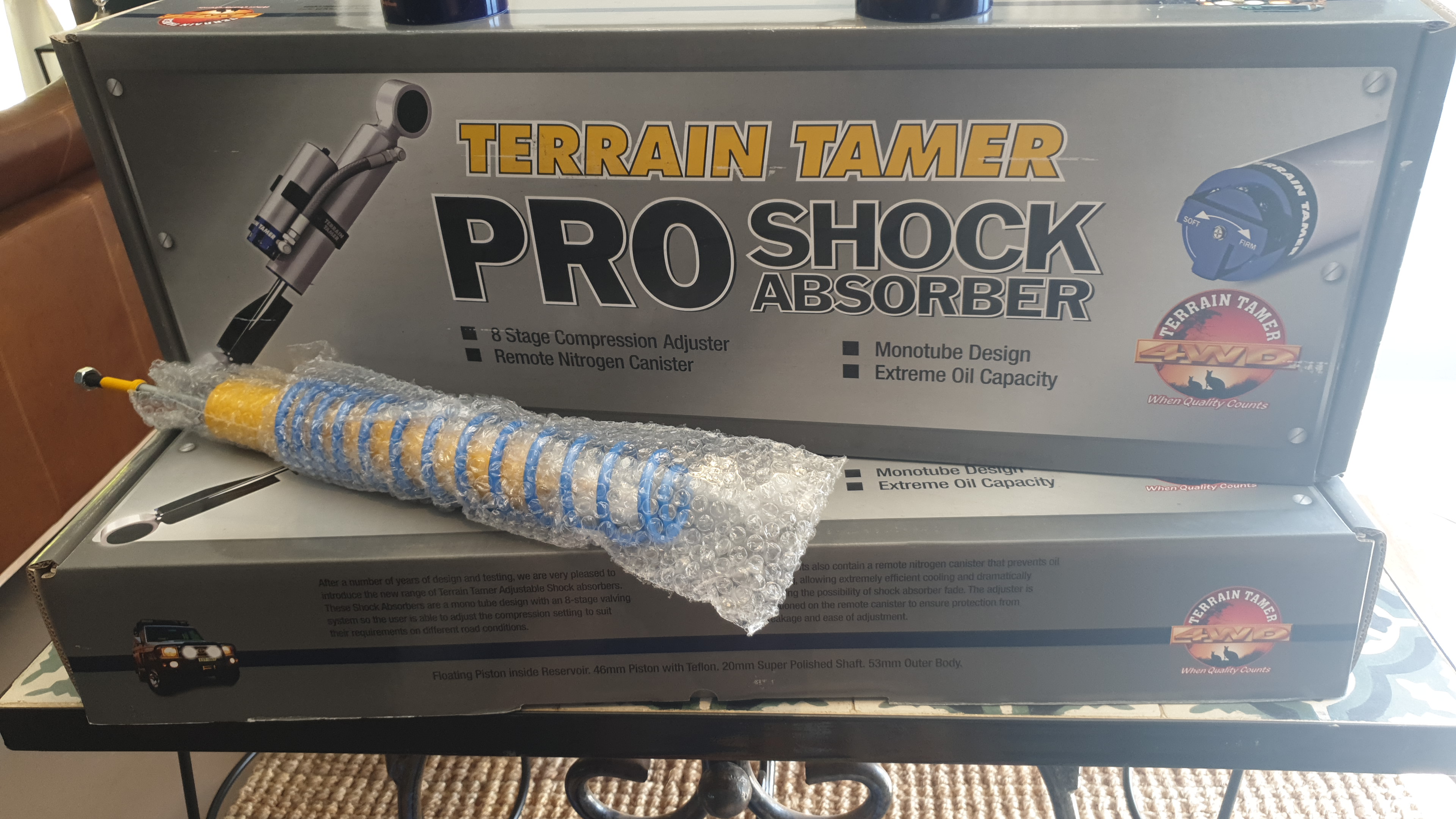

Re: Upgrade to 3" lift on series 4 GU 4.8 Station Wagon. What do I need?
Here is some pictures of the TT gear.
- IMG-20210213-WA0026.jpeg (1.36 MiB) Viewed 8734 times
- IMG-20210213-WA0025.jpeg (1.66 MiB) Viewed 8734 times
- IMG-20210213-WA0018.jpeg (1.17 MiB) Viewed 8734 times
- IMG-20210213-WA0017.jpeg (1.07 MiB) Viewed 8734 times
- IMG-20210213-WA0016.jpeg (1.37 MiB) Viewed 8734 times
- IMG-20210213-WA0015.jpeg (1.56 MiB) Viewed 8734 times
- IMG-20210213-WA0014.jpeg (1.6 MiB) Viewed 8734 times
Hey PietPeter Connan wrote: ↑13 Feb 2021 19:04 I don't know if this comes too late but:
Keep in mind that for a suspension to be capable of good flex, it must be relatively soft.
A relatively soft suspension will obviously sag under load.
Furthermore rising-rate springs will sag more under load than constant-rate springs.
Personally I would have rather gone for lighter springs and live with some sag when heavily loaded, or at worst supplement the softer springs with air-bags.
With regard to the shocks, the TT Pro's look like a good product, and I am sure they are much better than what you have had before. I don't think they are directly comparable to the BP51's, but then neither is the price.
The advantage of having the adjustable shocks is that I can dial them in for a softer or firmer ride depending on the driving scenario. So harder on the blacktop, but softer in an offroad application. I can also adjust for when I'm towing or not. The variable / rising rate springs are only in the front where 41% of the weight is carried so I'm hoping that the sag will be minimal. The 500 kg contants are in the rear and I'm hoping that the uprated load rate of these springs will keep the car more level without being as dependent on the air-bags as I am now. My concern would be that I have to pump them too hard to level the fully loaded vehicle and then I start to increase the stress on the coil towers and chassis.
My car is very heavy even when unloaded so the constant load 500kg should be well matched for the loaded and unloaded variations, well this is the plan at least.
The BP51's are an incredible product, but unfortunately I'm too heavy for them and wouldn't benefit enough from the tech to make the expense worthwhile. I think they would be excellent for a GU that is below GVM when fully loaded.
Cheers
H
