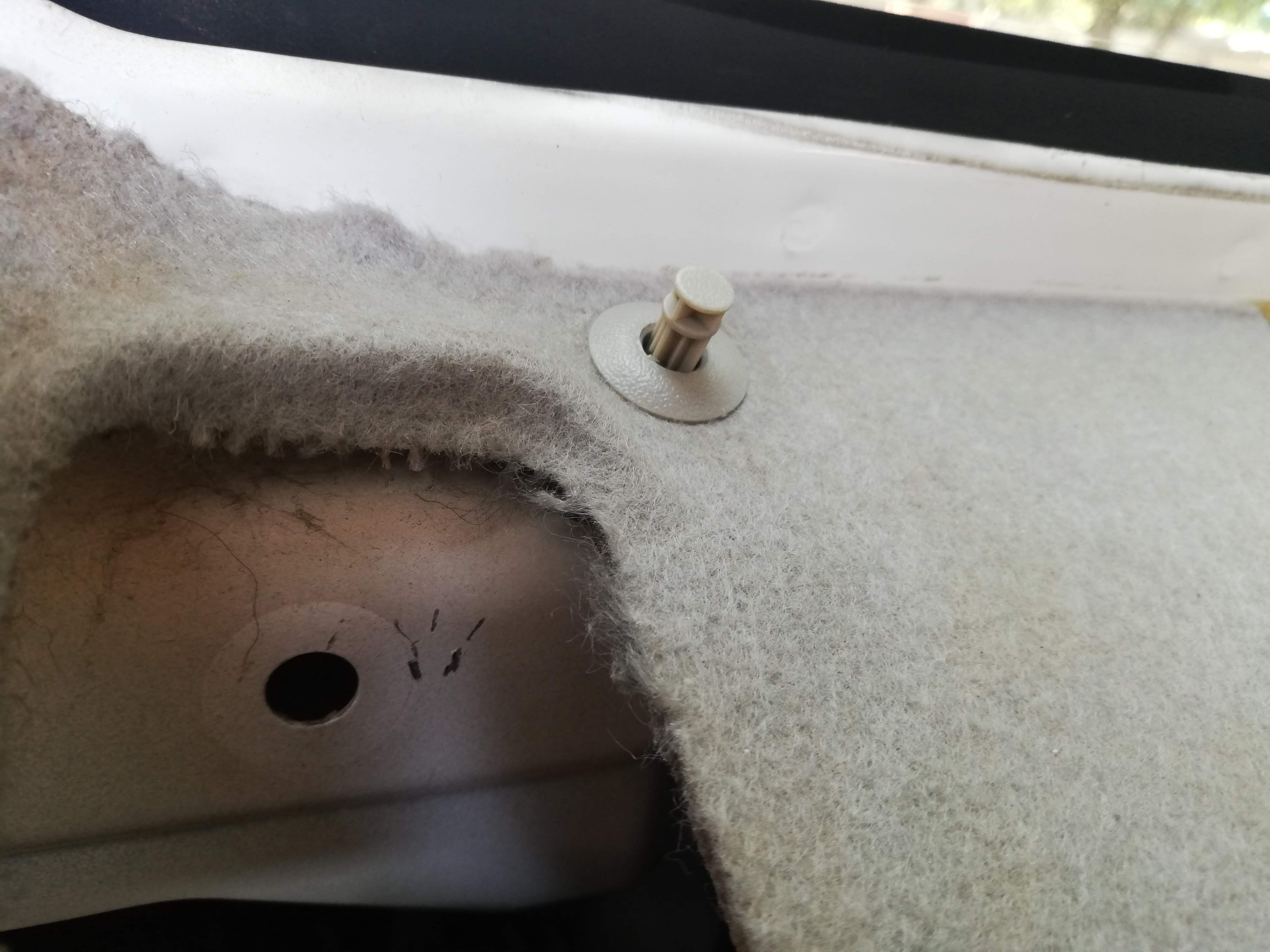

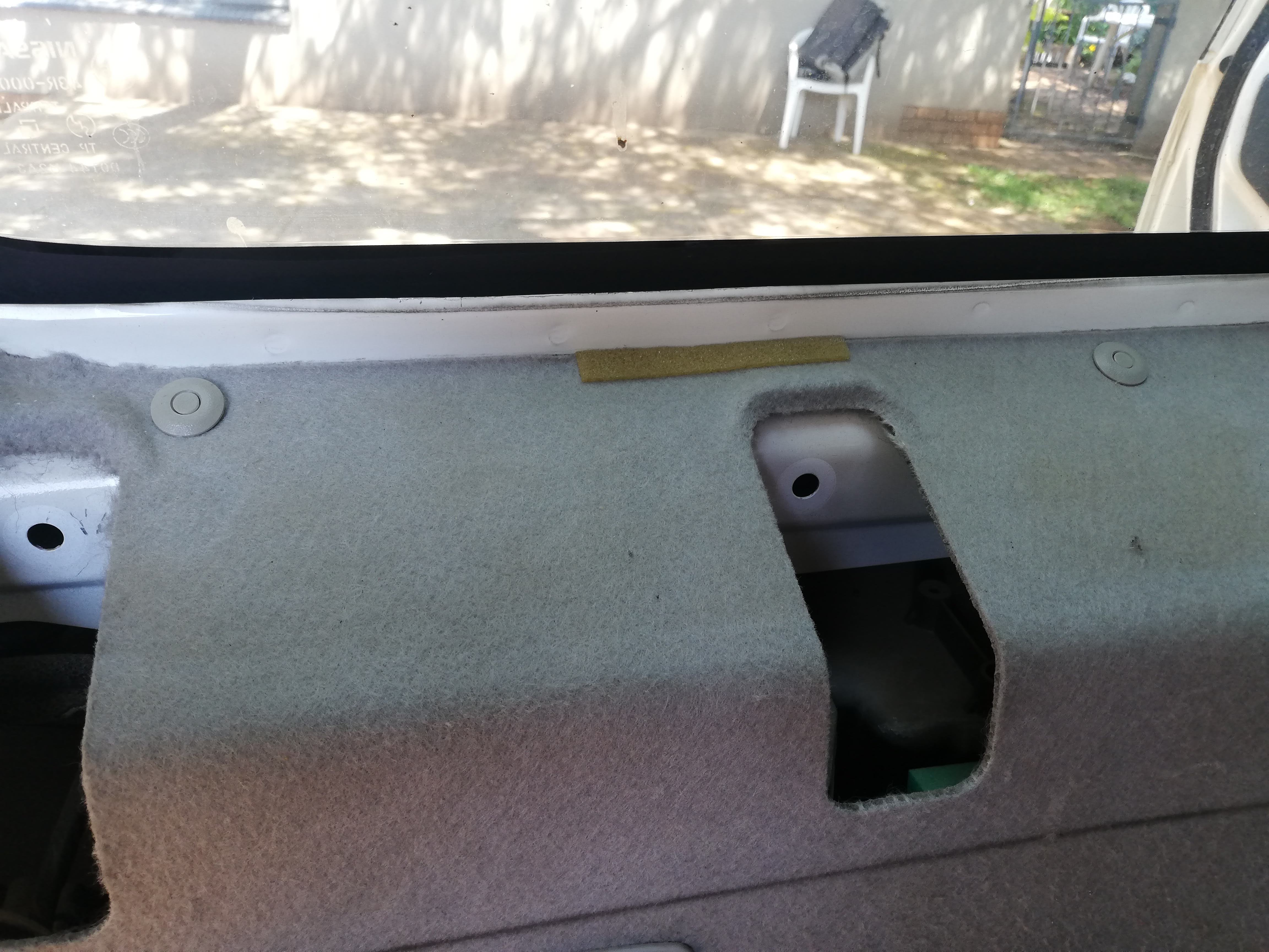

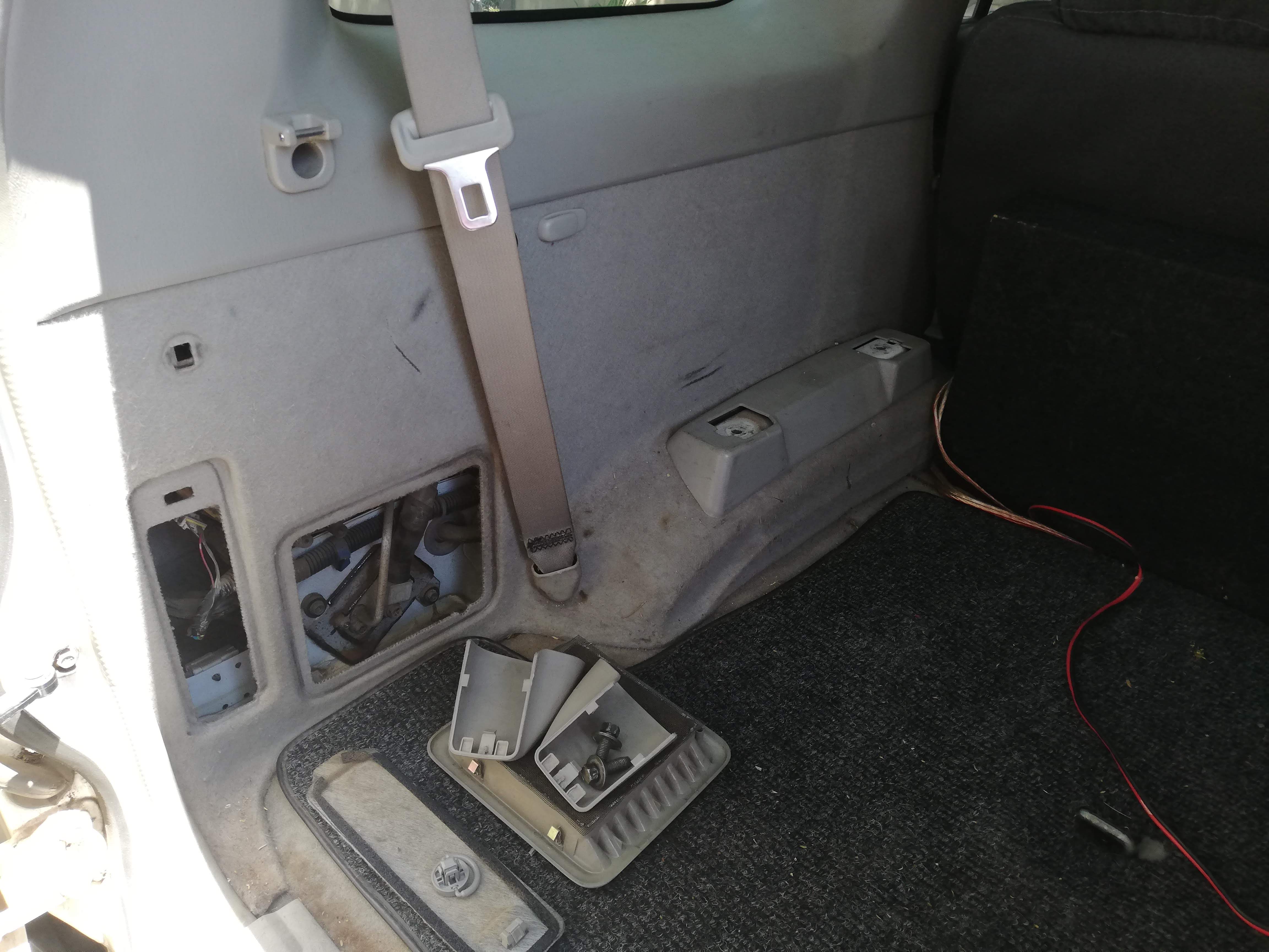

The aircon unit is hidden under the left rear trim of the Patrol. After removing the smaller panels it was obvious all the trim will have to come off.
It seems the best way to remove the panels would be to start from the top and remove the upper plastic portion first. I thought it might be possible only remove the bottom half, but it is attached at the top with clips hidden from view under the plastic panel.
Bottom trim seat belt removal.

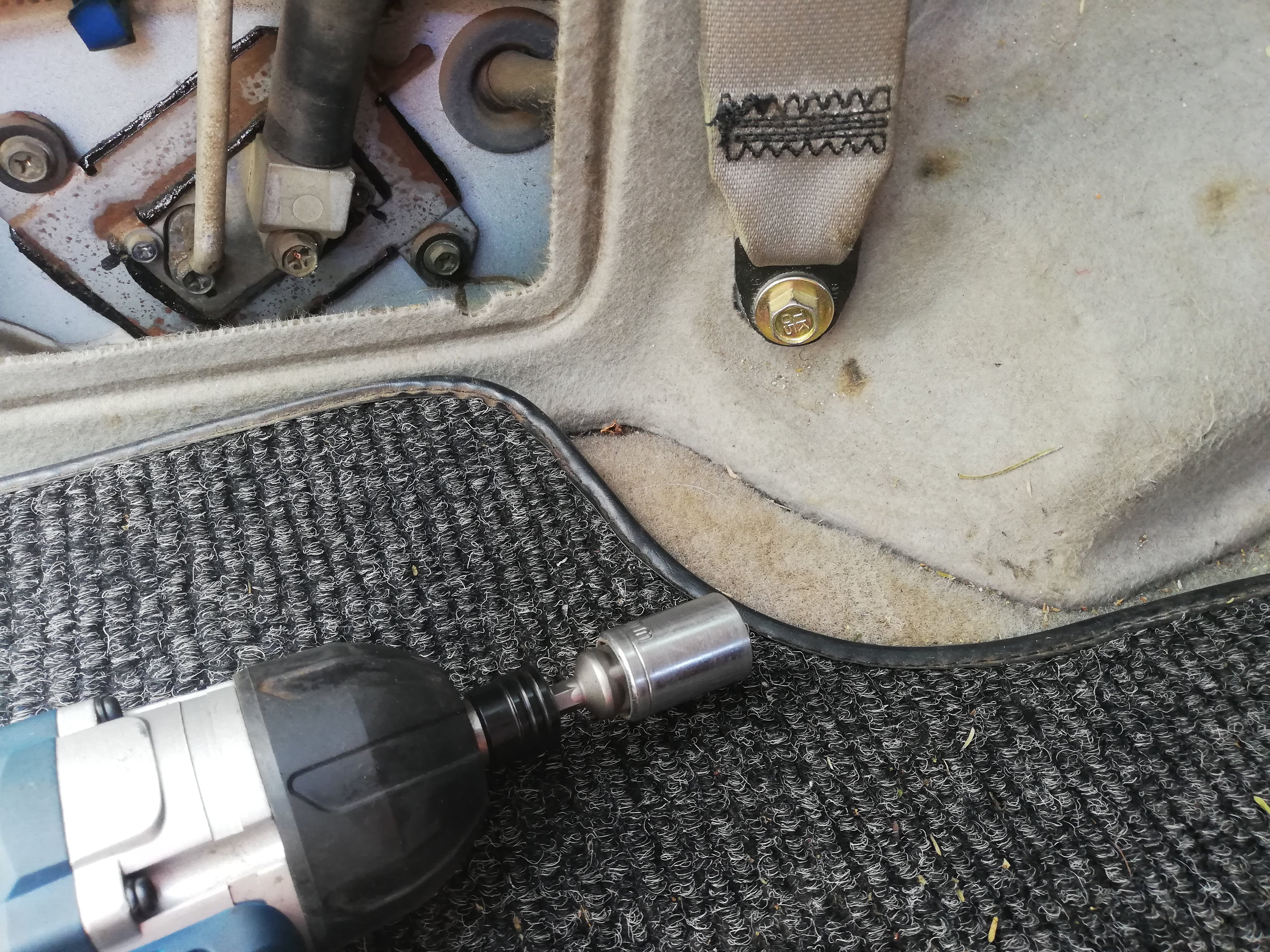

Seatbelt removal. Both the third row and second row seatbelts will have to be removed for the whole panel to come out.
Bottom trim loop removal.

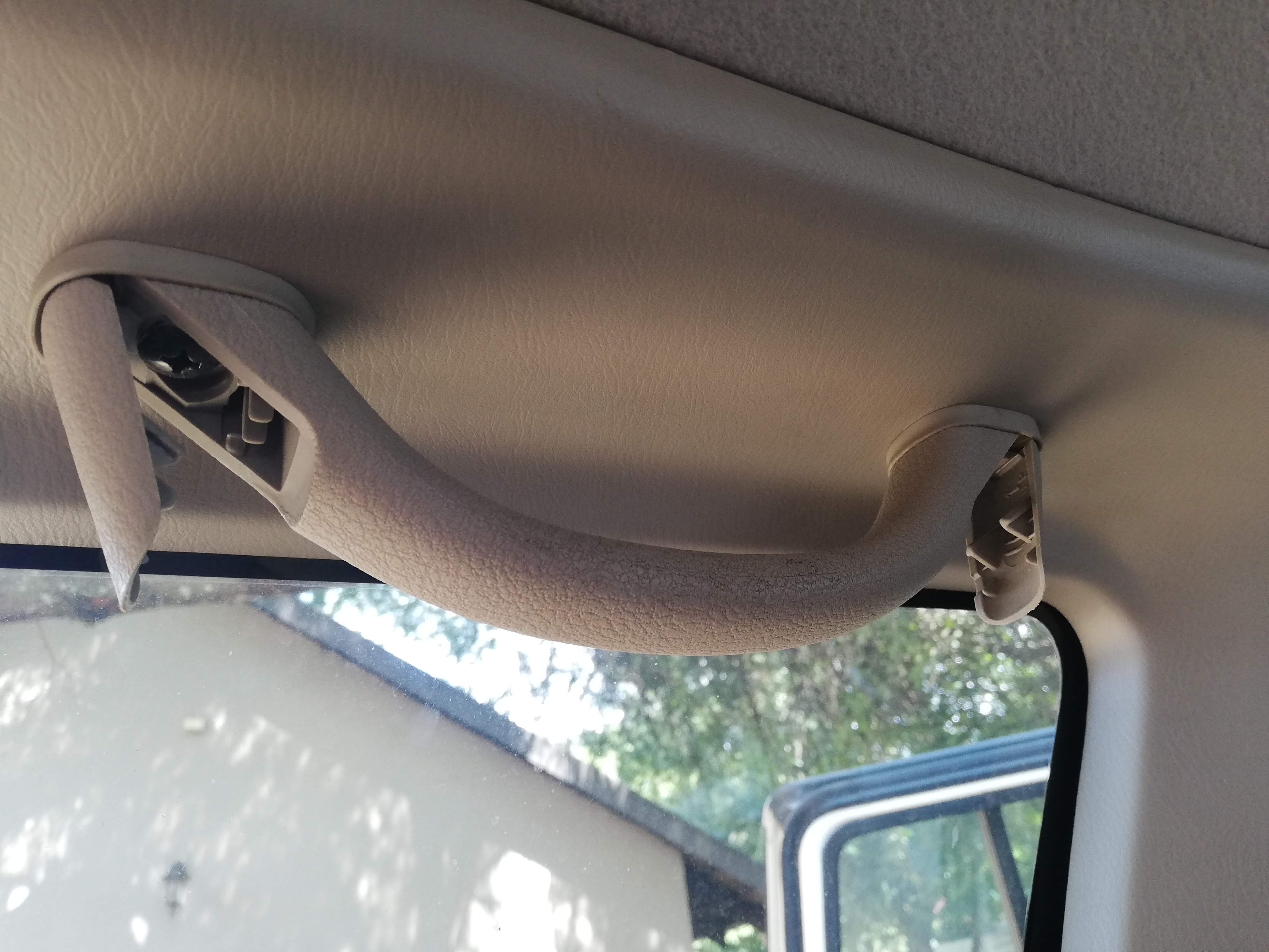

Upper trim handle removal.

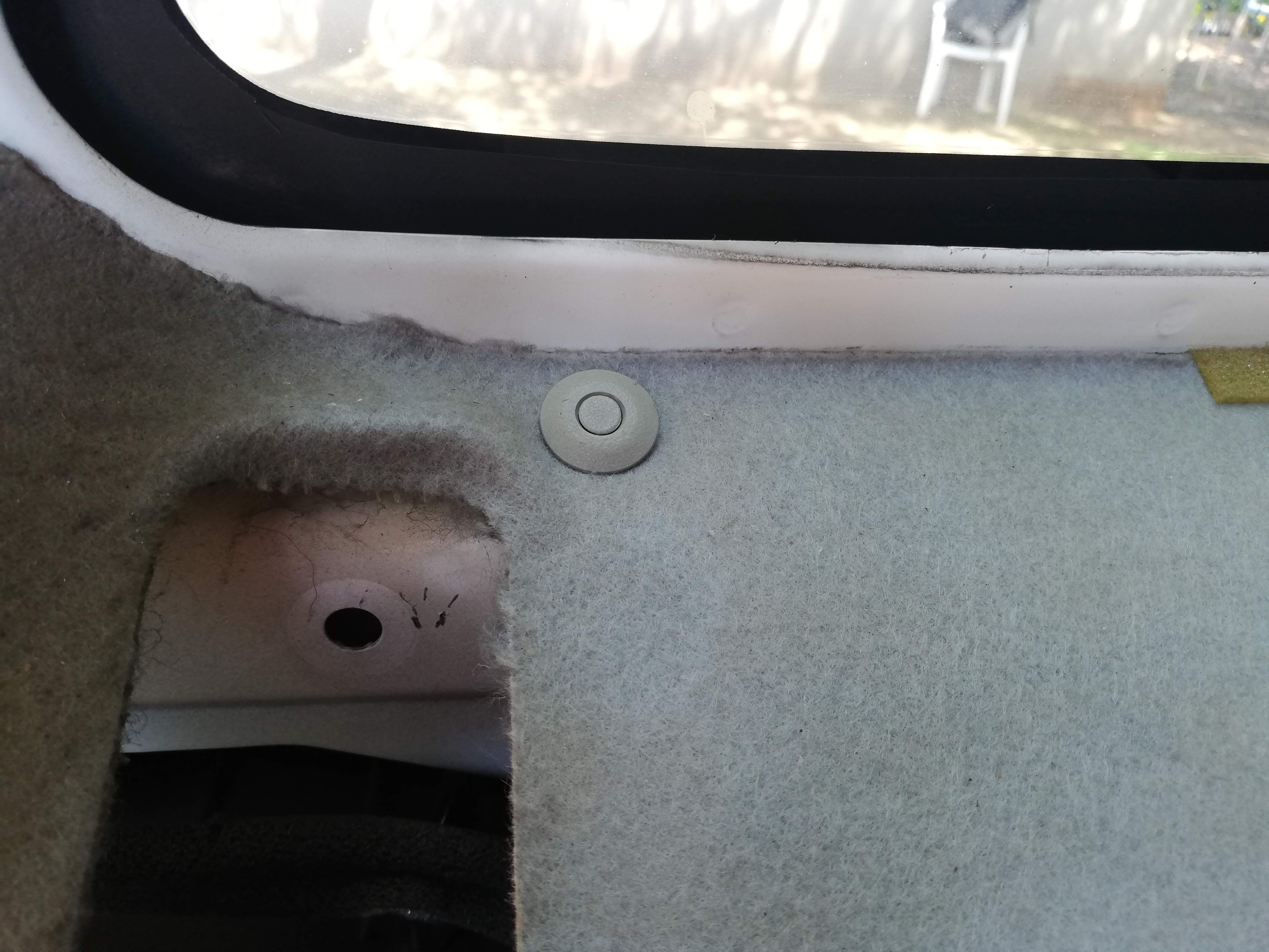

Bottom trim last clip.
Bottom trim last clips.

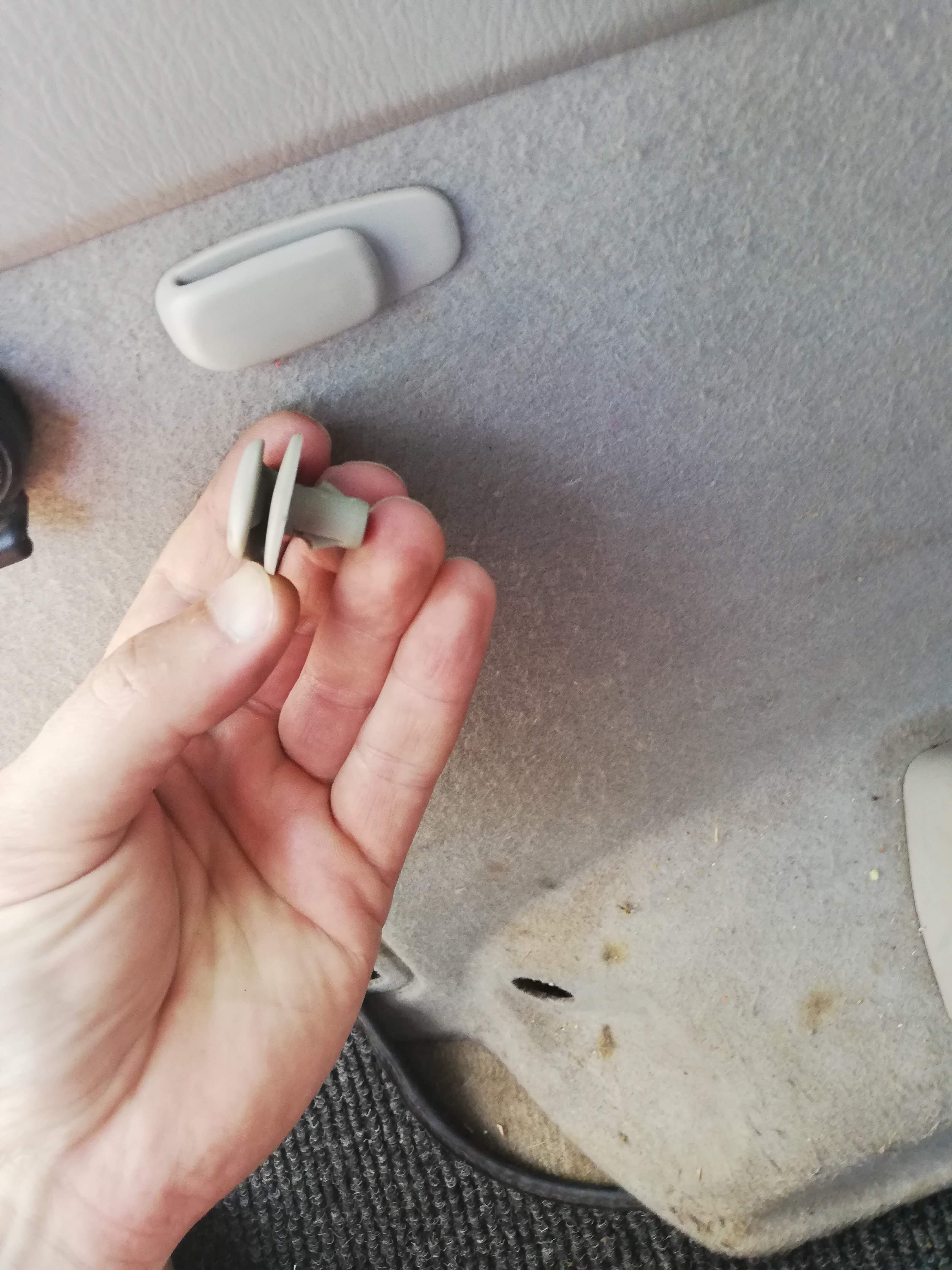

Bottom trim clip removal up close.
It's necessary to remove both attachment loops and the second row seat belt clip (not the one for the third row). The accessories socket remains in place, the wiring harnass is unclipped from the back of the panel.

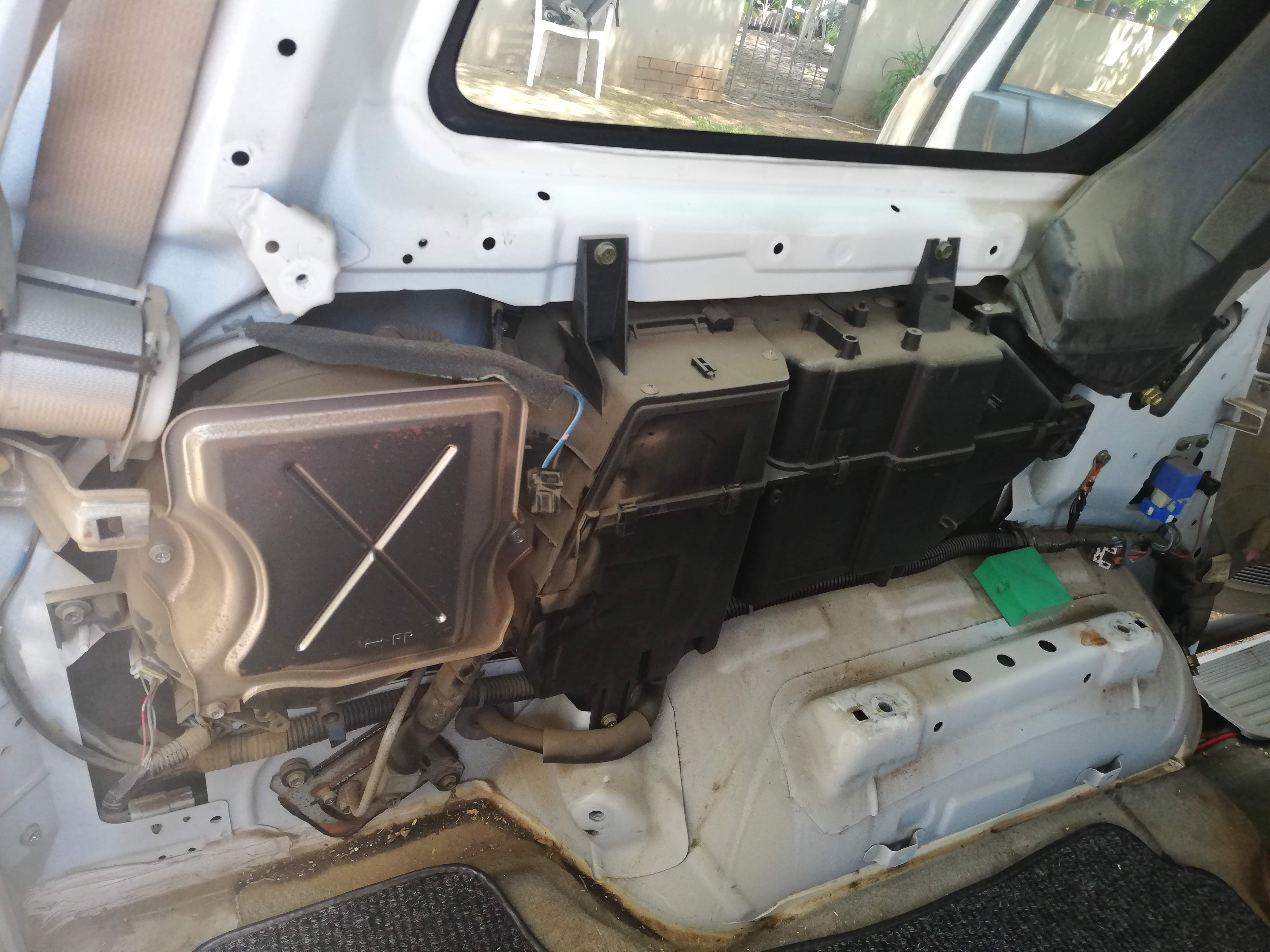

Inside trim removed.

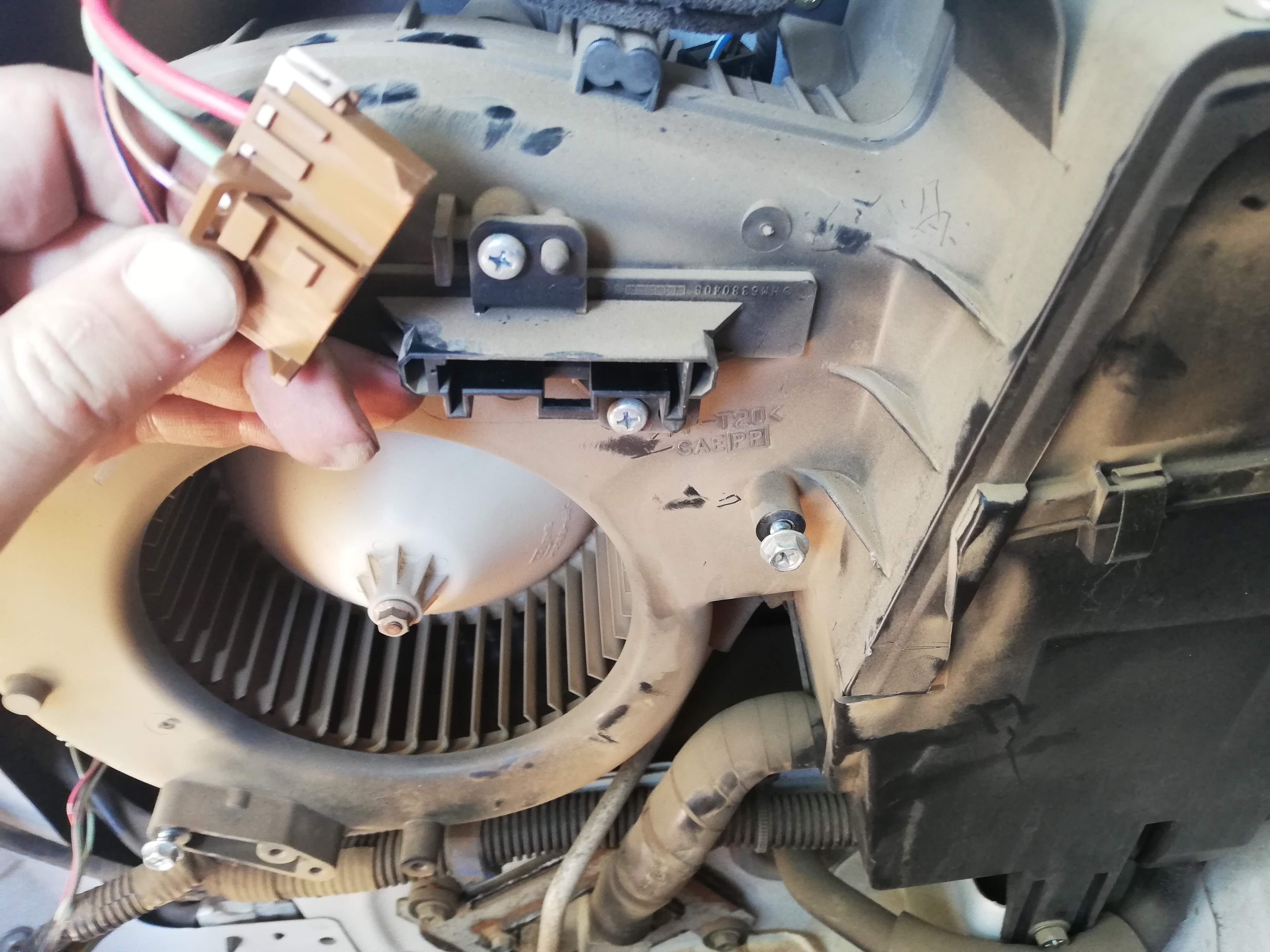

Fortunately, in typical Nissan forward thinking they marked the spot and what we want is under the giant X.
Location and removal of resistor board.
These four wires plug into the resistor board which is held in place with the two visible screws.

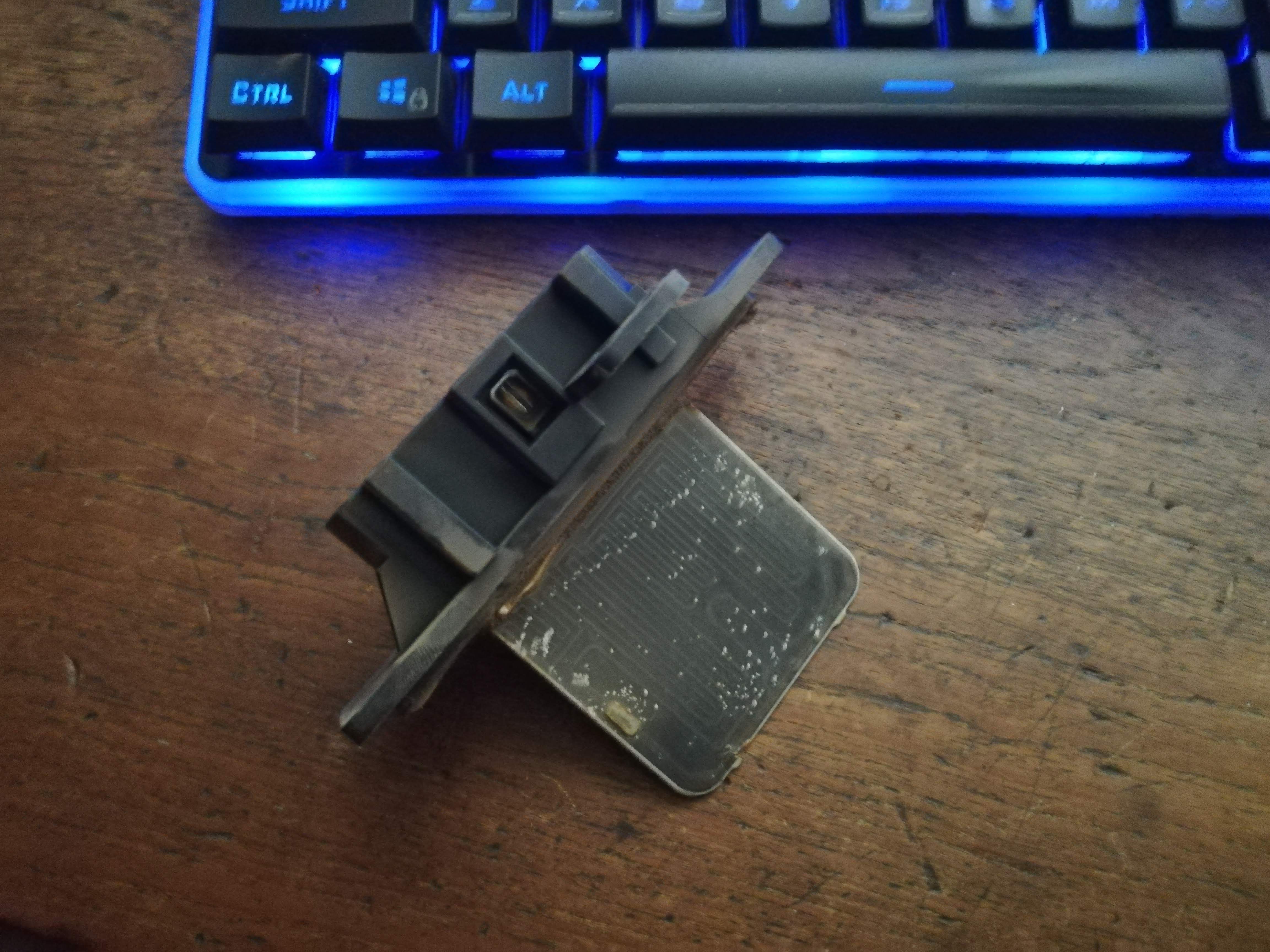

Dirty resistor board.

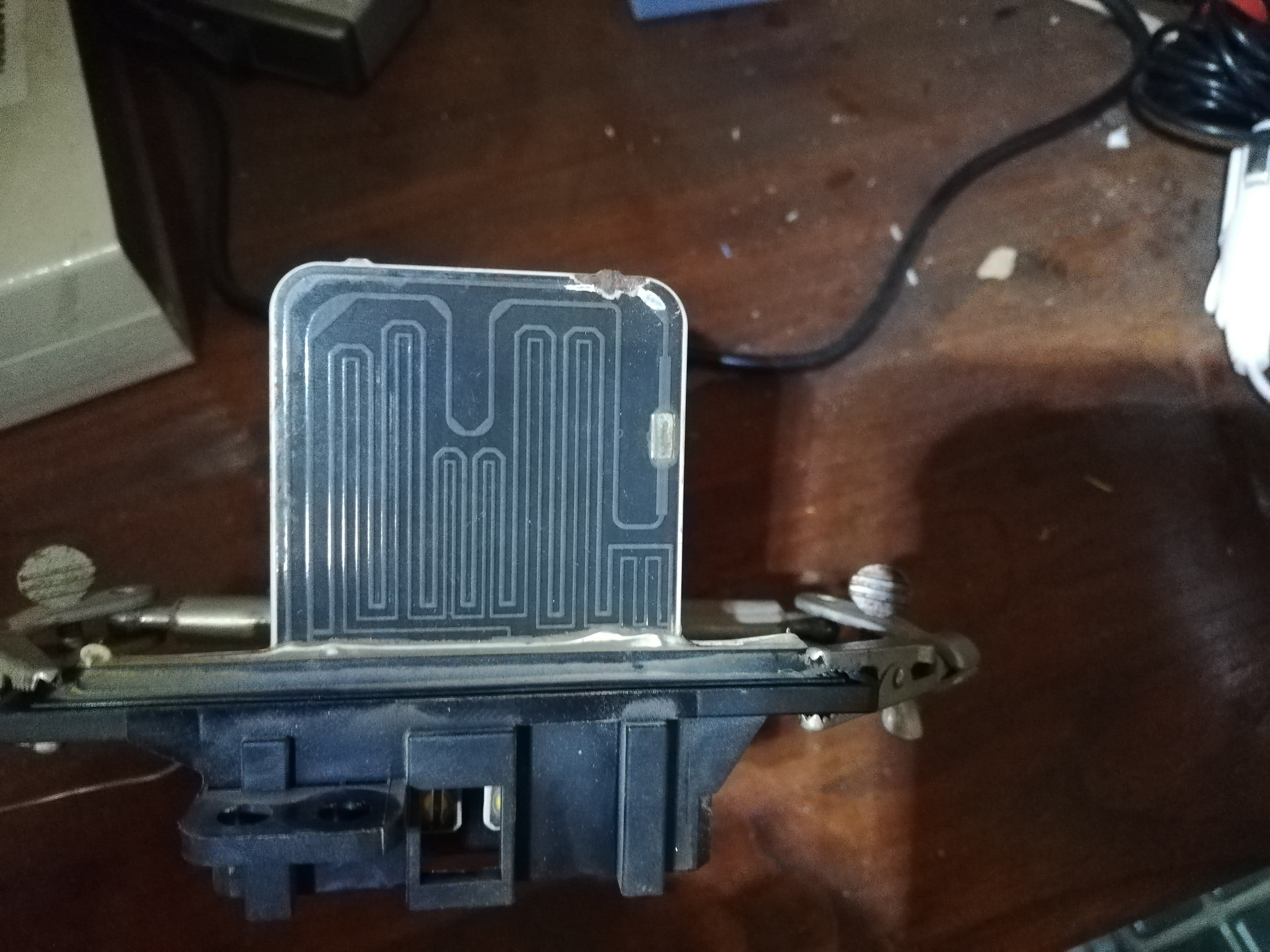

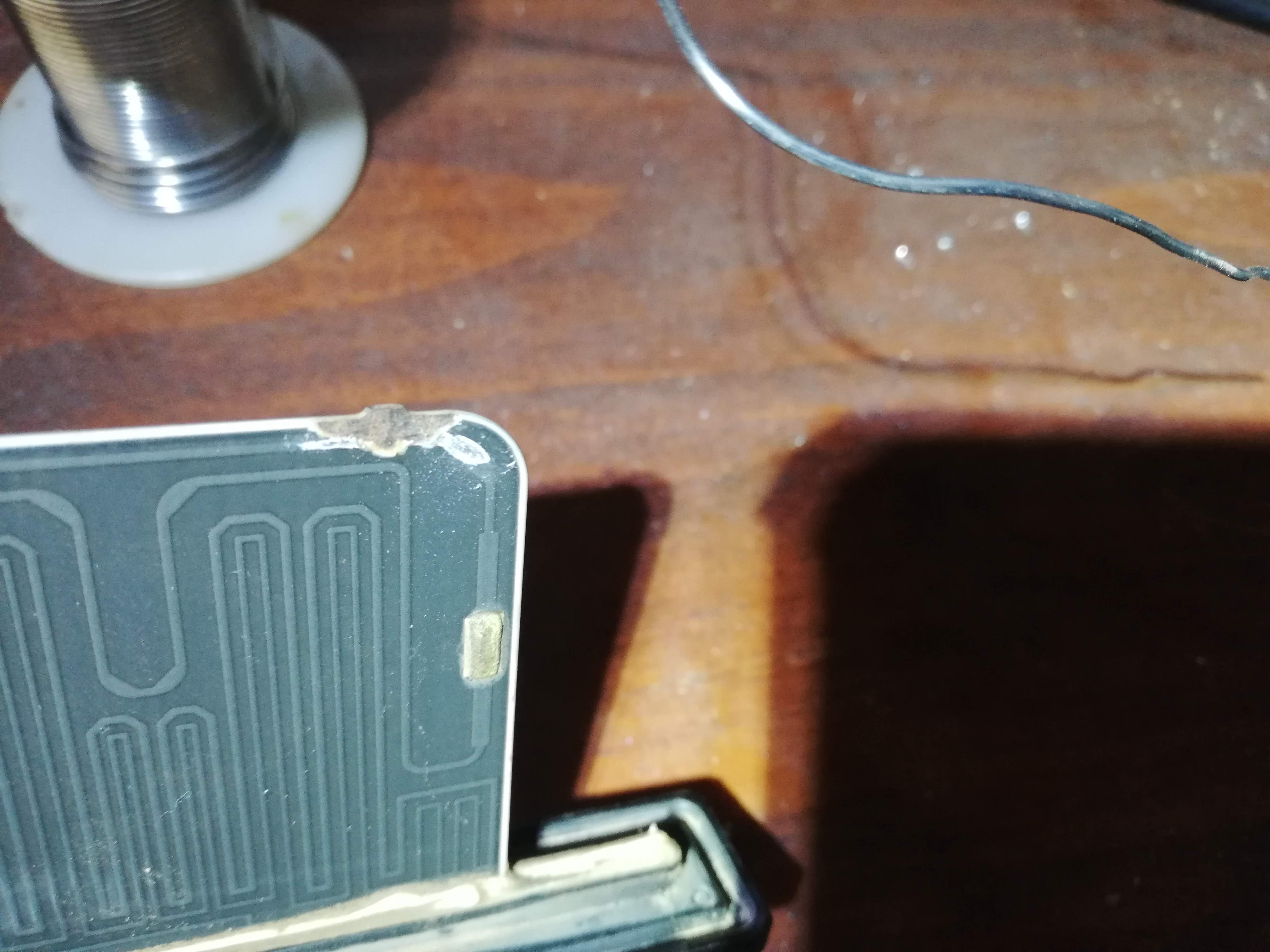

The damage to the board is easy to spot, even through all the dirt and what looks like corrosion.
Visible damage.
Visible damage.
Visible damage.
Visible damage.

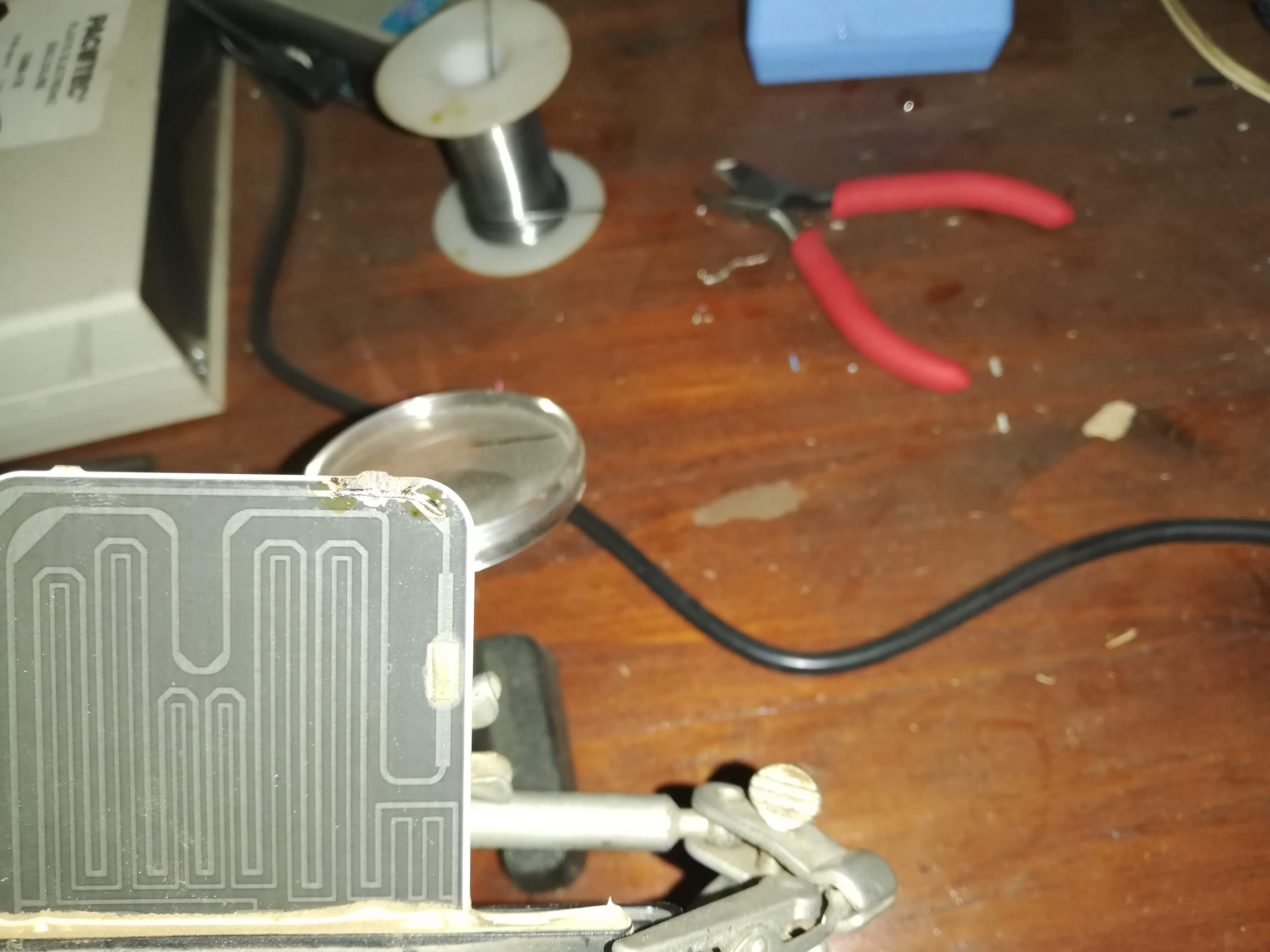

I expected the damage to be the fused link, but what looks like corrosion and heat damage caused the track from the input to disintegrate.
Damage bridged.
Damage bridged.
A short section of the track was cleaned on either side of the damaged portion and a few mm on either side bridged with a piece of wire.

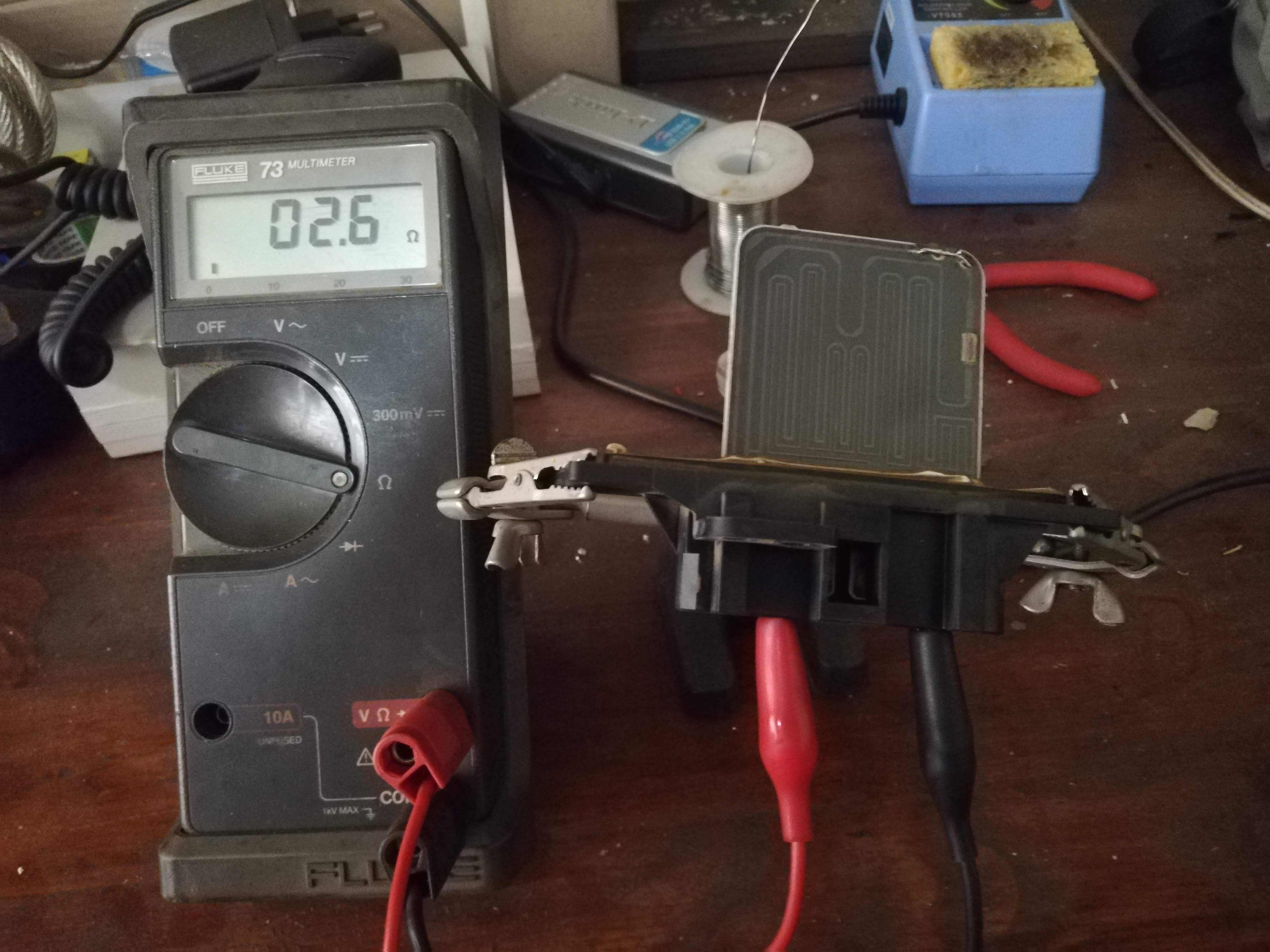

Testing repair.
Testing repair.
Testing continuity.
