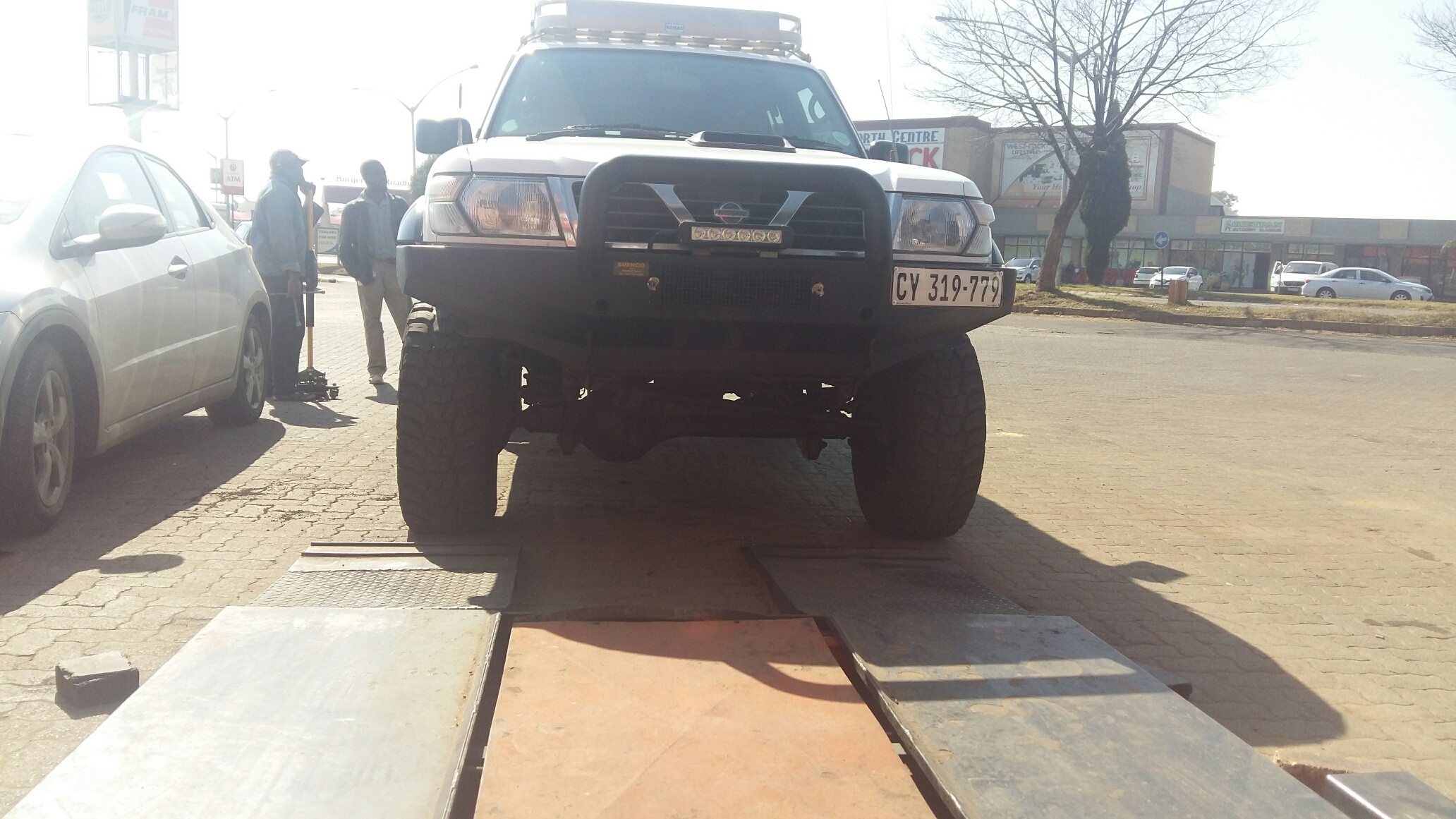

Ek sien HKGK oor daai voor nommerplaat..... Mark my words..... Hoop jy gaan nie huil nie!

Malcolm, yes, it is a risk. However it has been in exactly the same place for at least ten years. I have once had an officer get a little up-tight about it, but only a little.
There used to be a diagram in the law book indicating from what angles and distances the number plate needs to be visible, and this setup conforms to that, although it seems that has been removed from the law now (or at least I couldn't find it in 5 minutes on Google).
The problem is there really isn't anywhere else I can put it that is both legal, not problematic to air flow and where it won't look like a ball of scrap sheet-metal after the first river trip...
Either way, if the recent changes haven't made enough difference, I may have to find somewhere else to put it, so I can put an oil cooler behind where it is now.

Oom, hoe loop hy met CY nommer?? Oom is mos in Gauteng.
