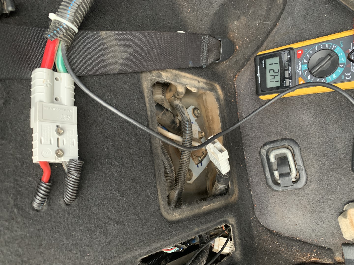

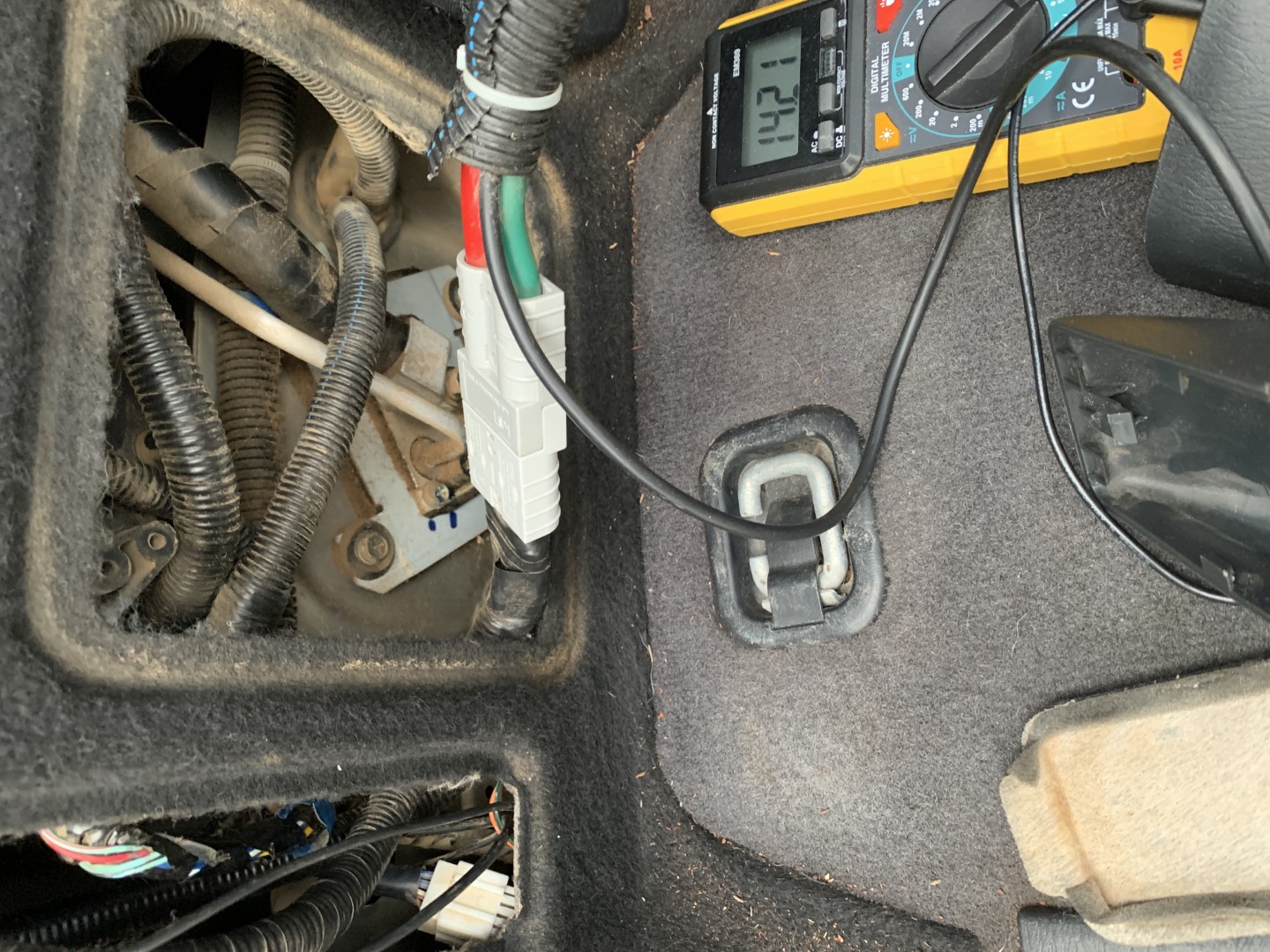

On a side note, discovered that where the cabling exits into the vehicle at the back the wires are actually much thinner, maybe 5mm and probably done to make it easier to bend. I quickly checked the voltage from the thinner wire and the thicker wire behind the inspection hatch and they are both produce 14.2V when the engine is idling (see pics). Is this because the thin wire is so short? Should I be concerned? I have been using this setup for 13 years.
Thank you
John

John, how are you measuring the wire, as that looks way thicker than 5 or 10 to me? Remember, the number refers to cross-sectional area of the copper, not diameter.
In other words, you need to measure the diameter of the wire (excluding the insulation), halve it, square the answer and then multiply by PI (3.124). 25mm wire thus has an actual diameter of 5.6mm.
Secondly, the voltage drop will only become evident if you are drawing significant amperage. Thus you need to run the fridge for a few hours, and then see what voltage you get.

Bliksem Peter, didn't know that about the cable area vs diameter :redface: Measured voltage without drawing any power, will do similar test when fridge is running and let you know.
