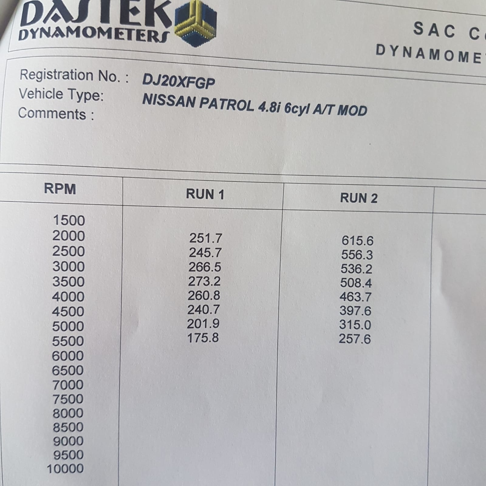

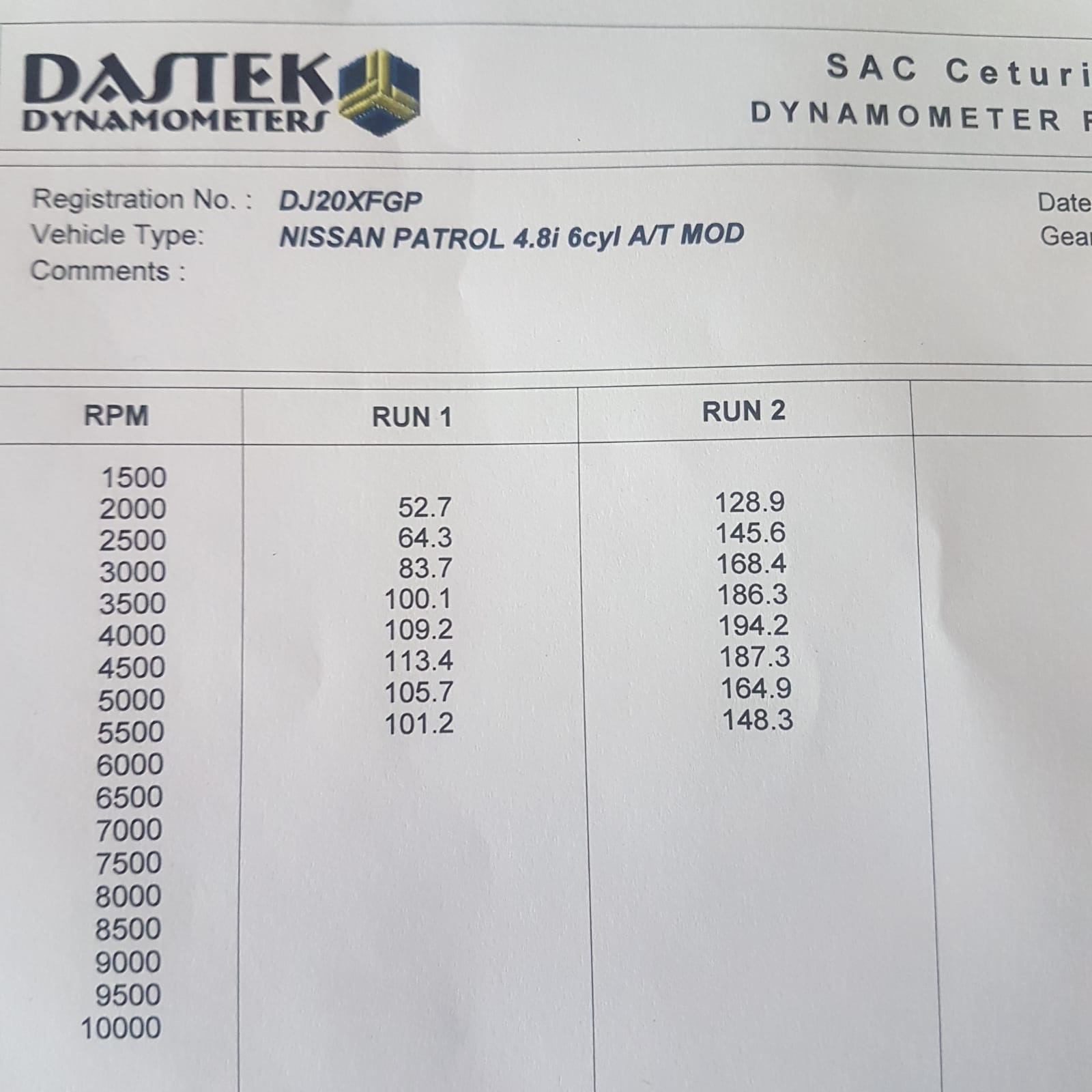

Thanx for the feedback Ian, super cool, would love to see the dyno chart - before and after. :thumbup:

Hi Johnboy here you go :thumbup:

Re: First Impressions 4.8 with turbo
Post by IanT »
Run 1 before turbo Run 2 after
