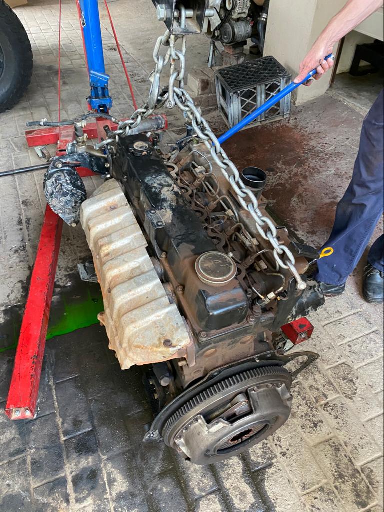

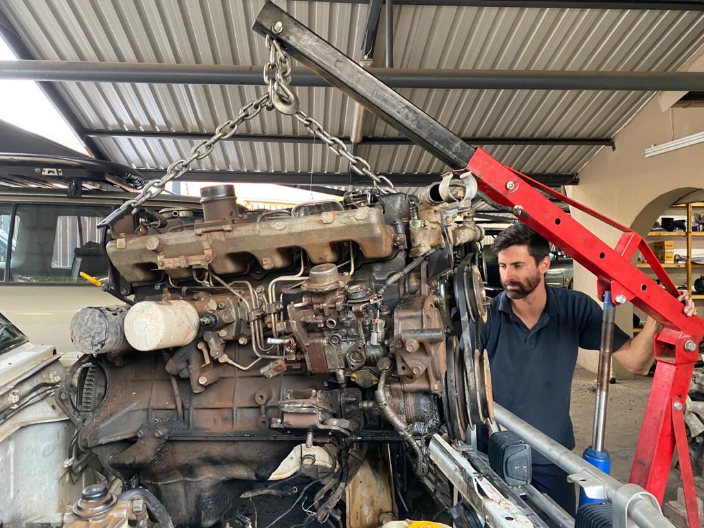

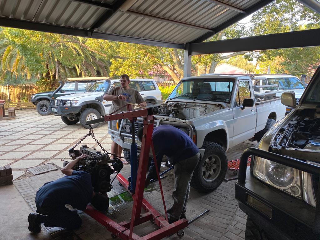

Re: Is this a TB42 or TD42
One of my very good and old clients brought one of his many Patrols in for some work. Its a 1998 GQ bakkie fitted with a TD42 non turbo engine. It has now done 891,000km and is still the original engine.
Unfortunately it was used by a friend a whike back and was over heated and the engine got some damage. They still drove it after the over heating for more than 100,000km, but its time for thange abd getting the Patrol running properly again.
Its now getting a new TD42 turbo engine. This will be a low boost no intercooler setup to just have it running around 20% better than the standard TD42 non turbo engine. So it will be good for another 20 years.
- Been thanked: 432 times
Some pics of the old ladd
- IMG-20200423-WA0030.jpg (165.55 KiB) Viewed 5278 times
- IMG-20200423-WA0031.jpg (161.27 KiB) Viewed 5278 times
- IMG-20200423-WA0035.jpg (160.54 KiB) Viewed 5278 times
- IMG-20200423-WA0029.jpg (102.23 KiB) Viewed 5278 times
