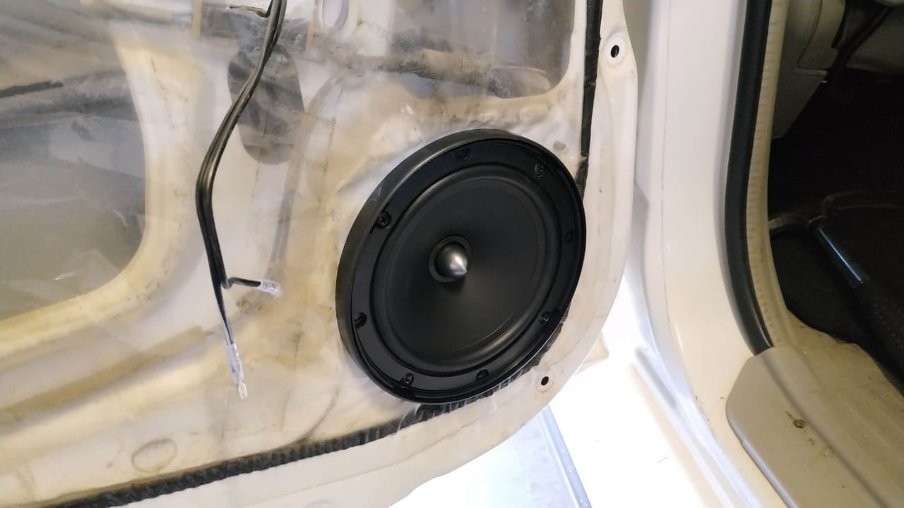

Speakers....
5he factory speakers in the GRX are Clarion units. With the right head unit, they provide a fairly decent sound. I did that in David Taljaard's 4.8. sounded great.
However, the factory speakers had been replaced with junk and the tweeters cut out. :sad: :sad:
5he decision was made to replace the speakers. I recommend the Focal RSE-165 splits because they are reasonably good, reasonably well priced and have a higher sensitivity (db@1w@1m) which makes them ideal to run straight from the head unit.
Focal RSE165
Focal RSE165
Here they are mounted in front doors and factory location in the A-pillar
Front
Front
Front
Front

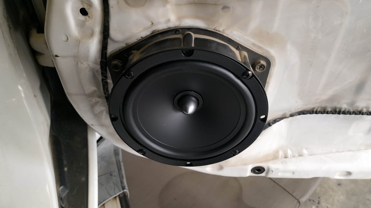

And the rear
Rear door
Rear door

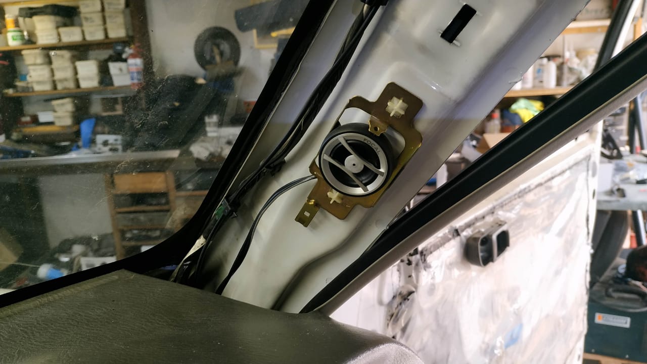

Rear tw
Rear tw

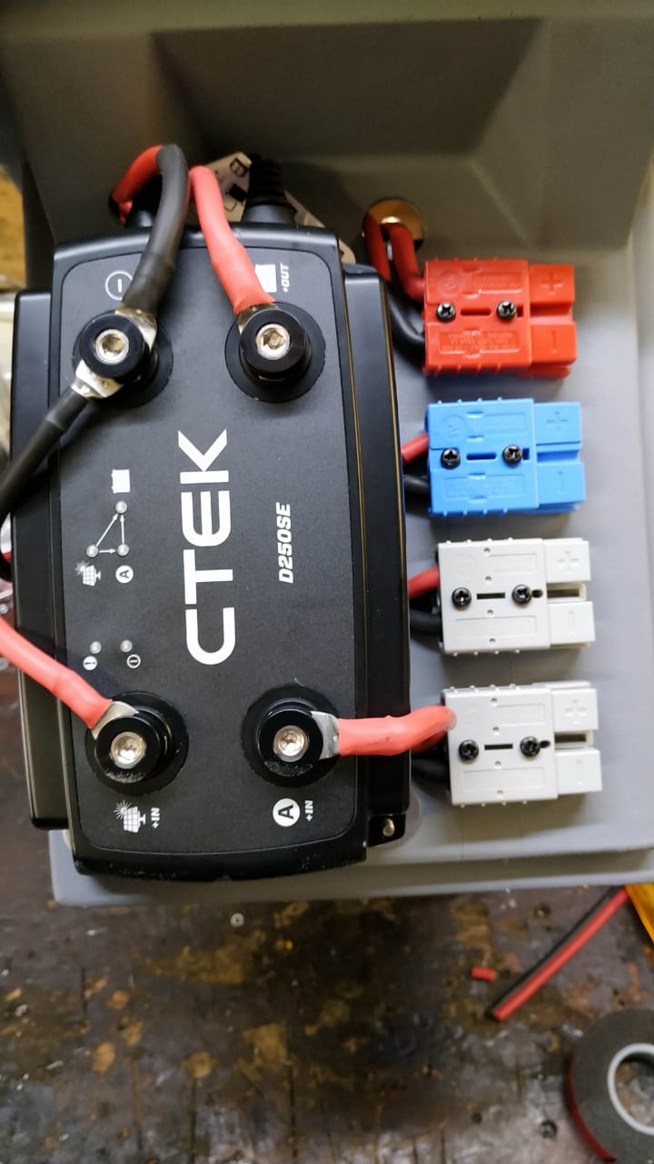

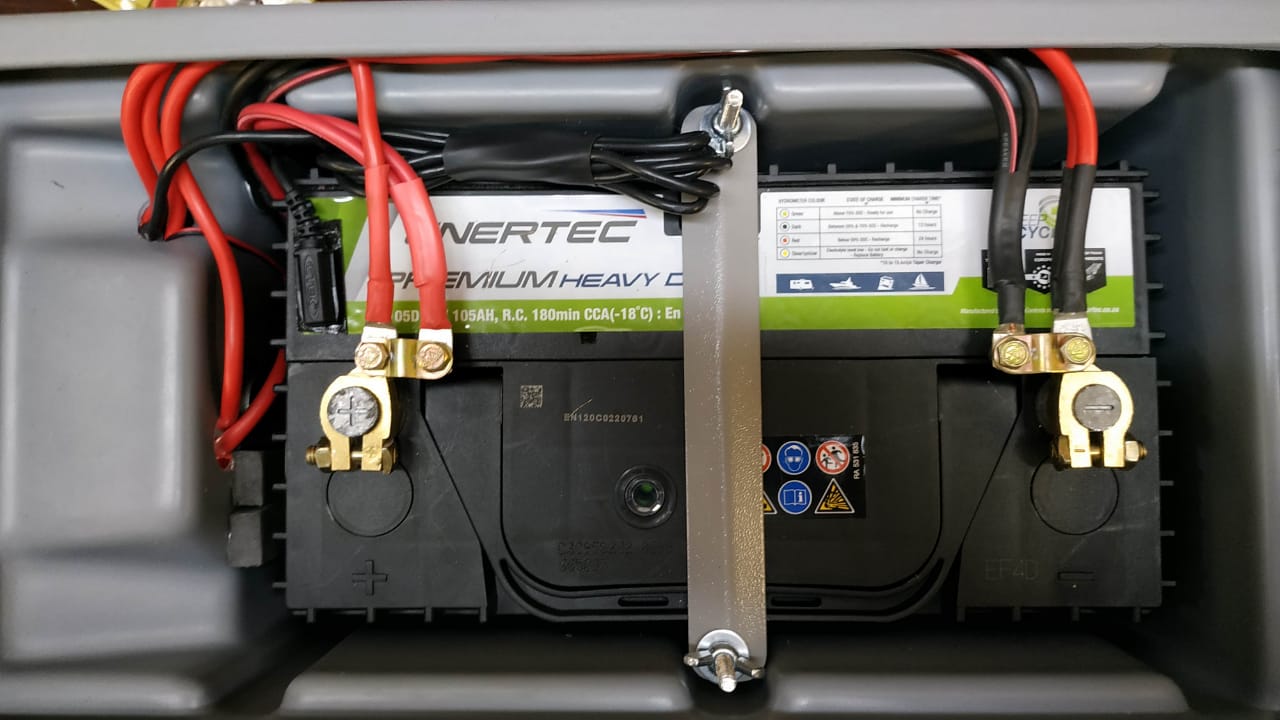

Now to start on the dual battery system.

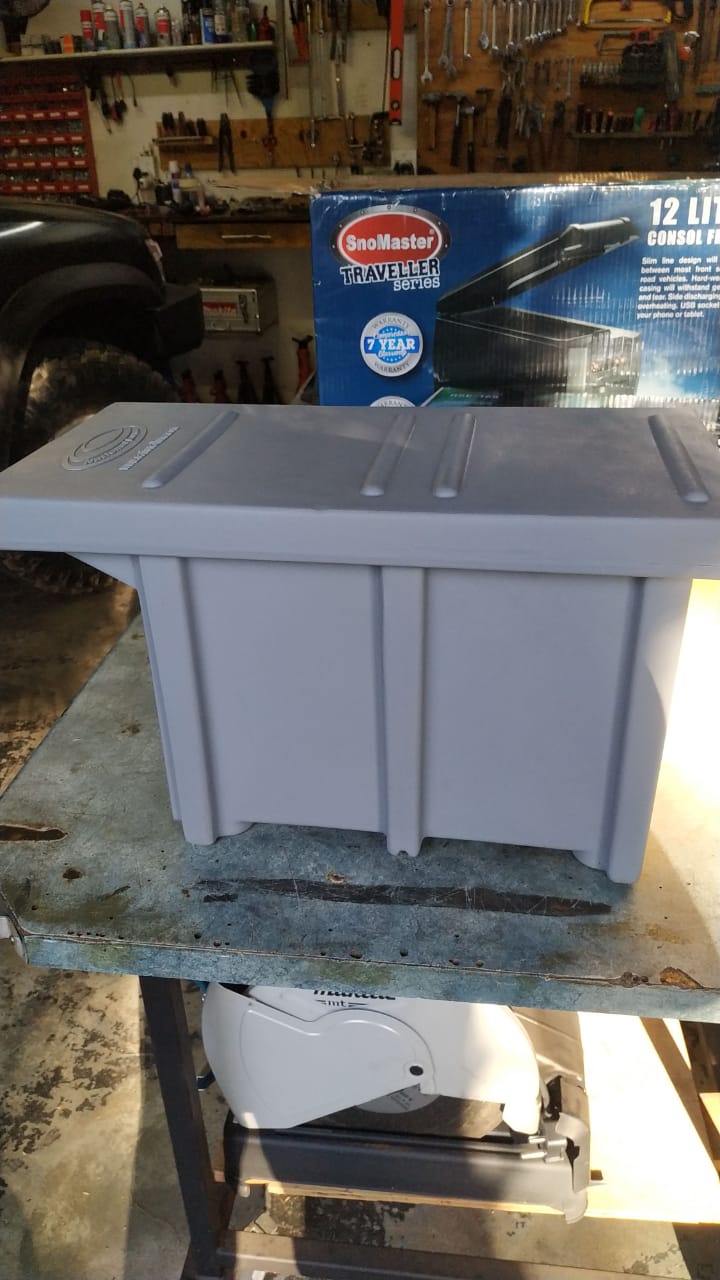

Battery box
Battery box
Battery wiring
Battery wiring
Ctek and plugs
Ctek and plugs

Battery box iso
