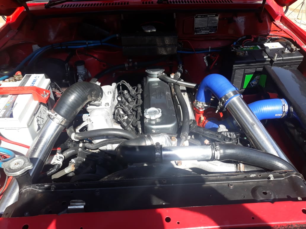

That is a pretty little TD27.
Re: RD28 Turbo options
Jip is coupled to a 5 speed cresida box .
