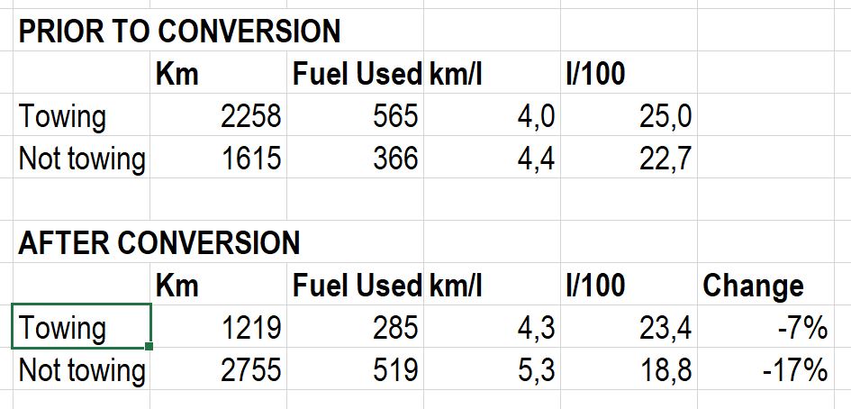

FUEL CONSUMPTION UPDATE
As promised here are some fuel consumption figures pre- the upgrade and post. (recall that i changed the manifolds - ceramic coated - installed a free flow exhaust and had a unichip installed) Filter is still standard although a k&n is going in this week. ( :naughty: we've had this online debate - im trying it anyway :biggrin: )
Below a summary.
- The towing figures are based on towing my boat which has the aerodynamic properties of a large country cottage. The before and after were almost the same route as well and incorporate going to the coast and back.
- The post conversion towing figures include half of those km towing at 130km/h at about 26l/100. I would therefore estimate about 22L for general towing at my normal speeds of 100 which is a 10% improvement.
- the best I got without towing was 16l/100 over a 1000km stretch - thats a 28% improvement.
So.... conclusions:
1. in rand savings its not going to make for a great ROI vs the cost... but thats not why we bought a patrol in the first place!
2. It does however mean that i have saved taking an extra jerry can on my 6 week 7000km botswana trip in December/January.
3. Pity that the performance itself is not noticable as outlined in the discussion earlier in the thread.
