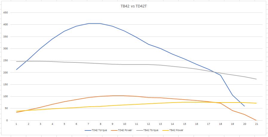

Something interesting. I was looking at the results of last weekend's dyno day, and accidentally found dyno graphs from a previous forun dyno day (6 November 2010), when my car still had it's original engine.
Now I realize that the runs were done on different dynos in different weather and with different tires, so the results are strictly speaking not comparable, but I believe the trends are stil both valid and interesting:
Also, I could's get the revs to show, but the graph runs from 1500 to 4000rpm
Here's my takeaway:
The TB42 has a far flatter torque curve. More torque under 1600 and over 3500rpm. But the TD has far higher maximum torque (408 vs 245Nm), and even has more power (this was a surprise to me), 104kW vs 76kW.
I still maintain that the petrol engines flatter torque curve makes it better for most types of off-roading as it is easier to control, but it needs to be controlled, whereas the diesel can basically just be allowed to idle with no driver input.
However, on the open road there is no comparison. the TD42's rich seam of torque right at cruising speed means the drive is far more relaxing. Basically one never needs to change gear for a hill at 100-120km/h, whereas that definitely wasn't true for the TB42.
