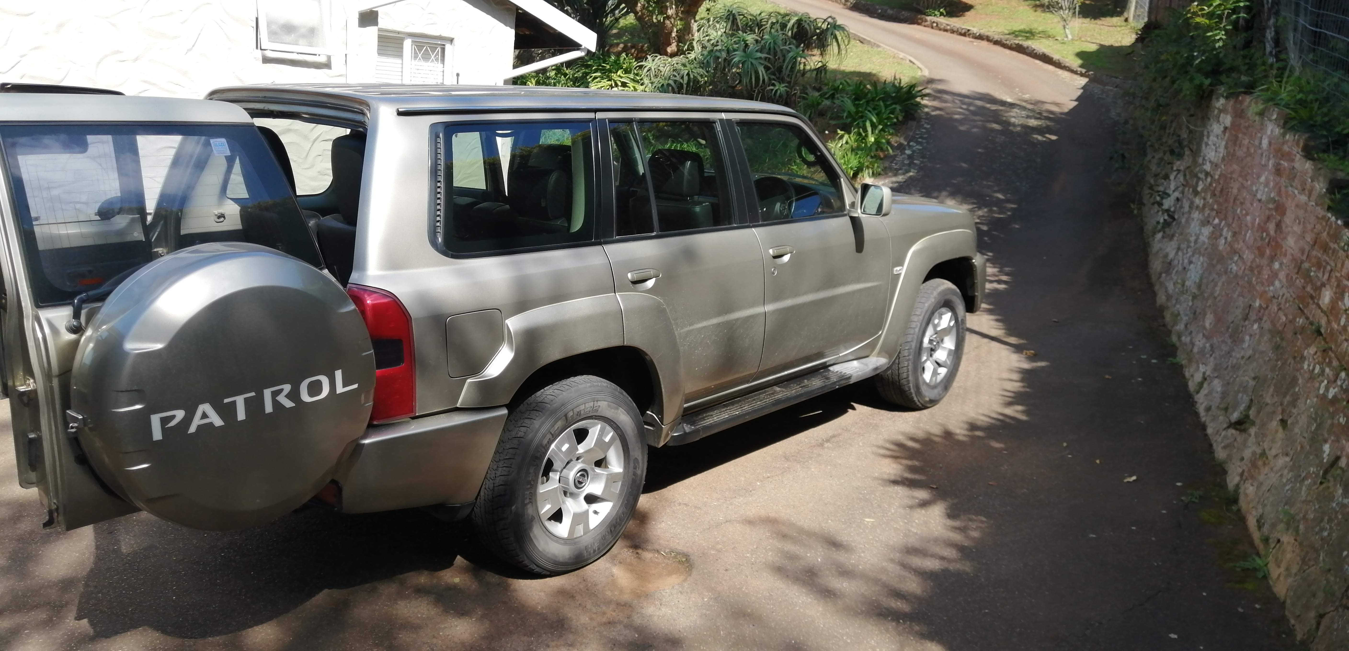

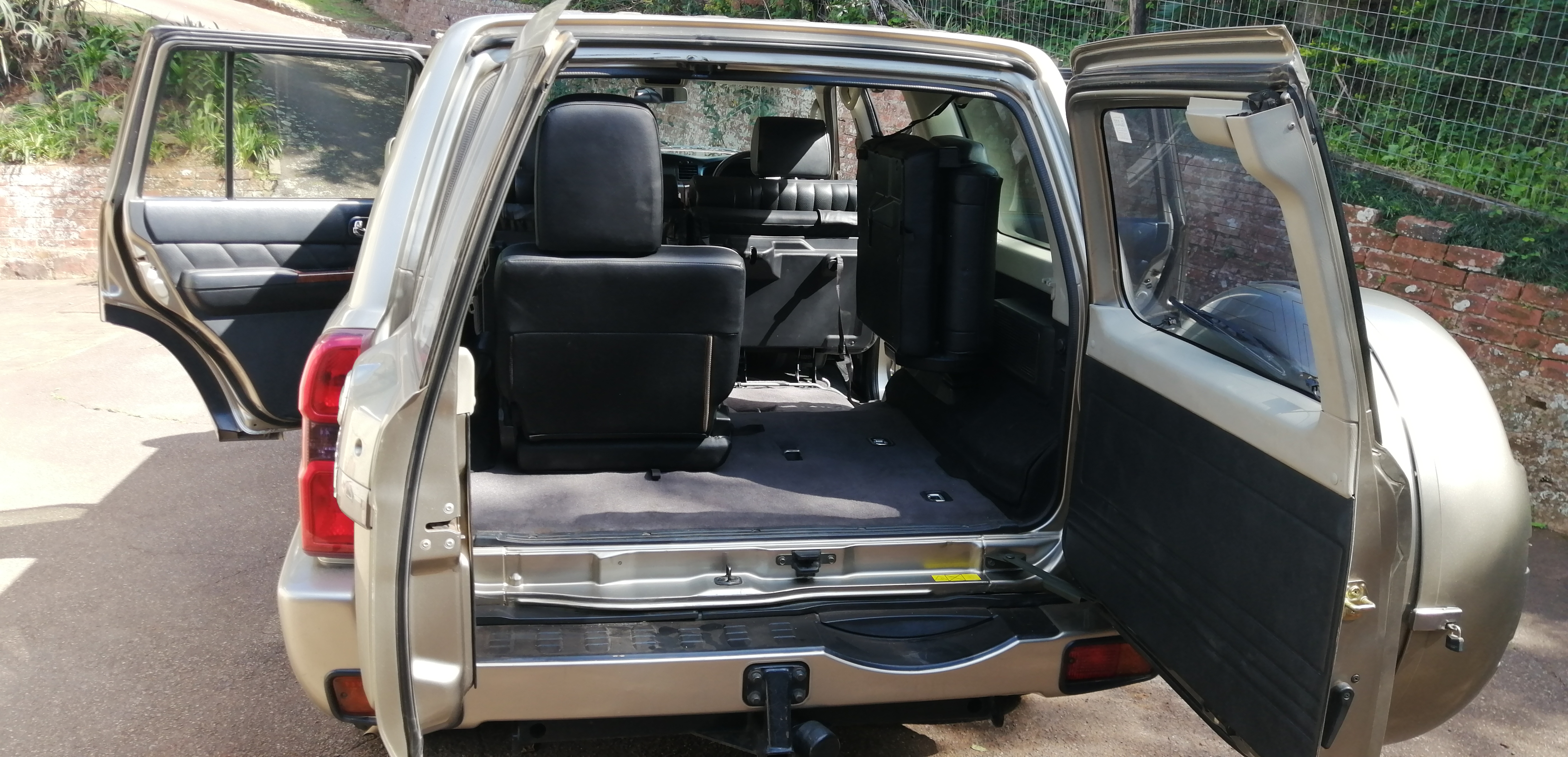

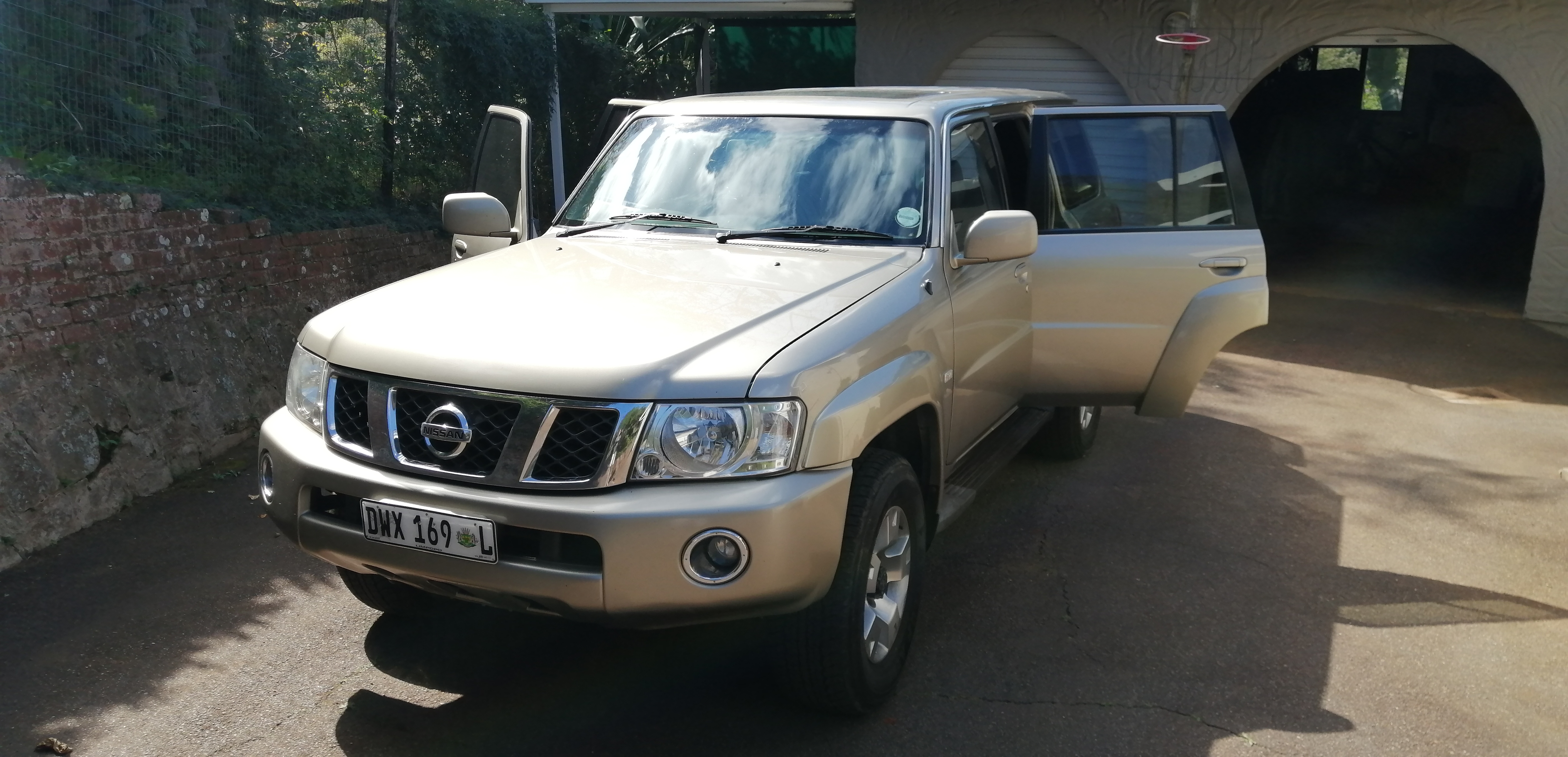

well, the GQ is long gone, and after a couple of years without one, Tinus helped me get a proper vehicle in my garage again
4.8 GRX, courtesy of Leon

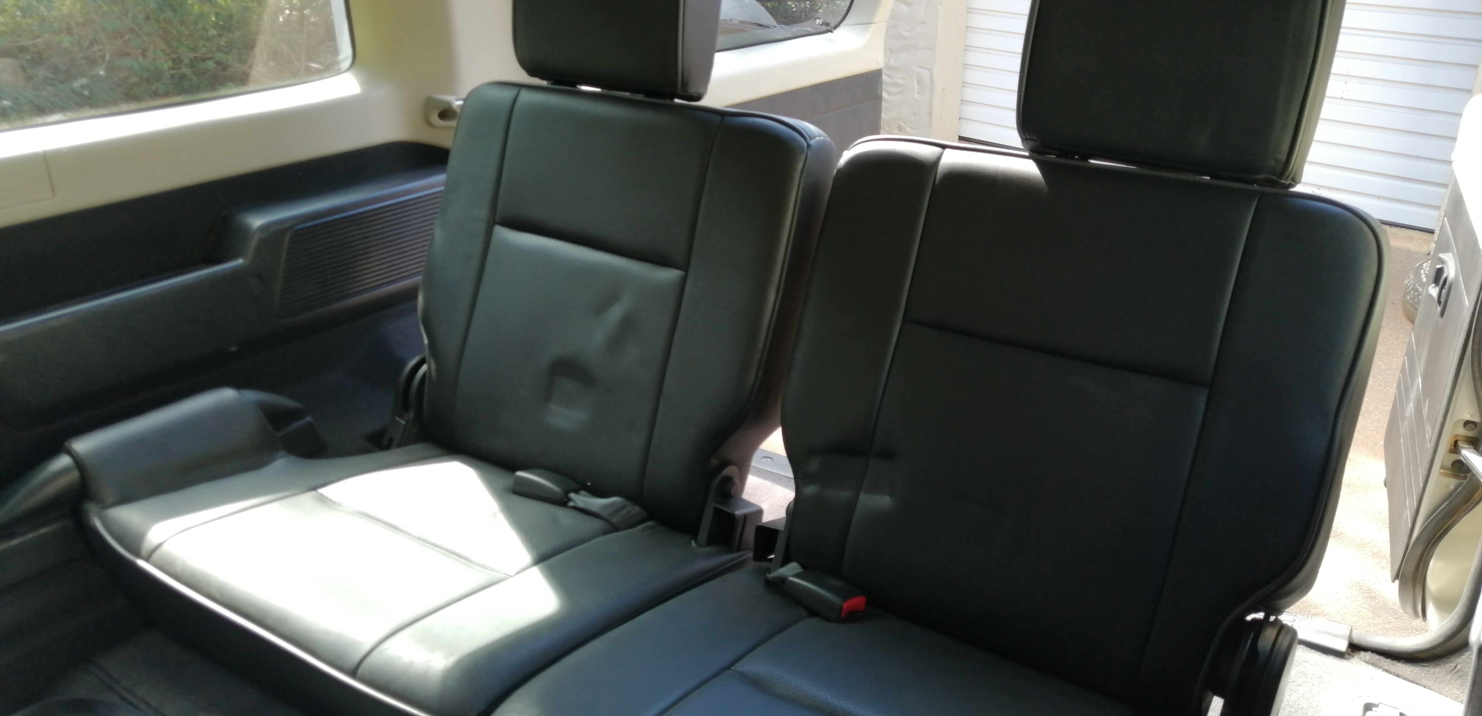

Thanks Izak for the rear seats
thanks izak, they are perfect
