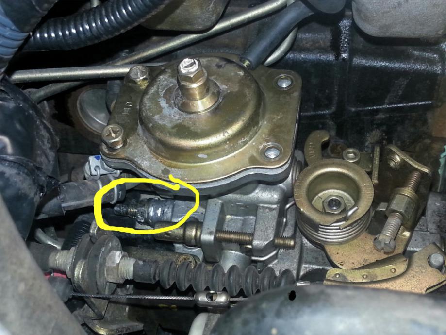

Ok... Have a look here, this is the fuel screw. Turn it out 1/8 turn at a time, drive it and adjust again if necessary a 1/8 turn again till its just giving off a slight puff of black smoke under hard acceleration or load

By the way, does your TD42 motor have an inline Injector pump or rotary?
If a rotary pump, does it have an anneroid thingy on it like in the pic posted earlier?
