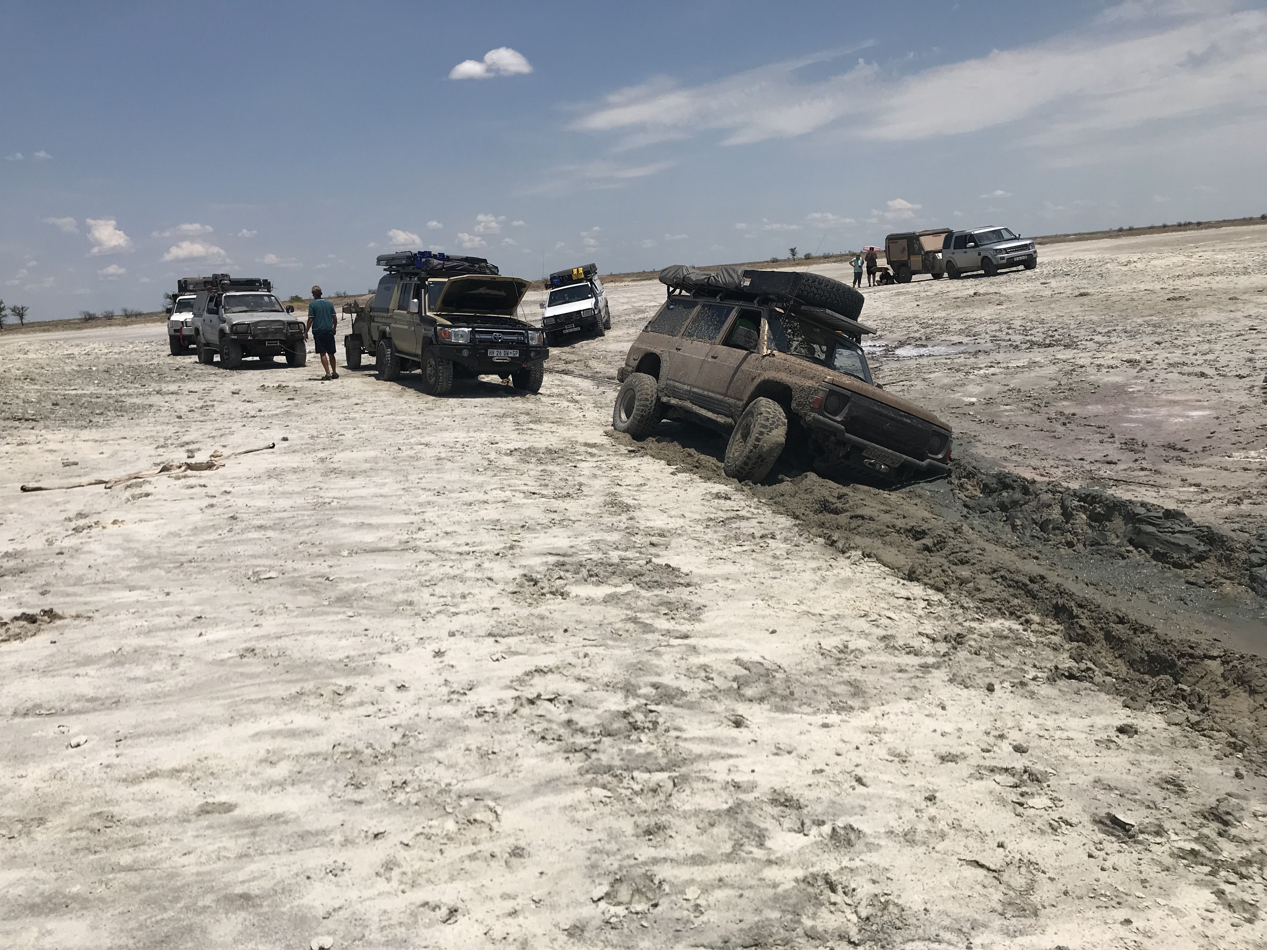

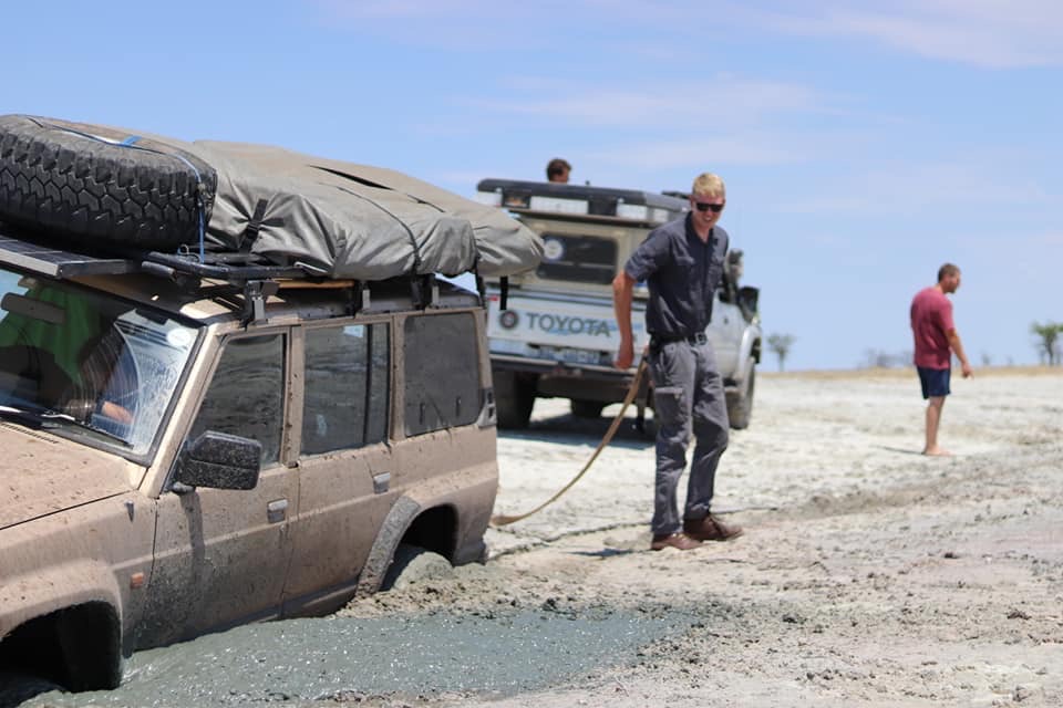

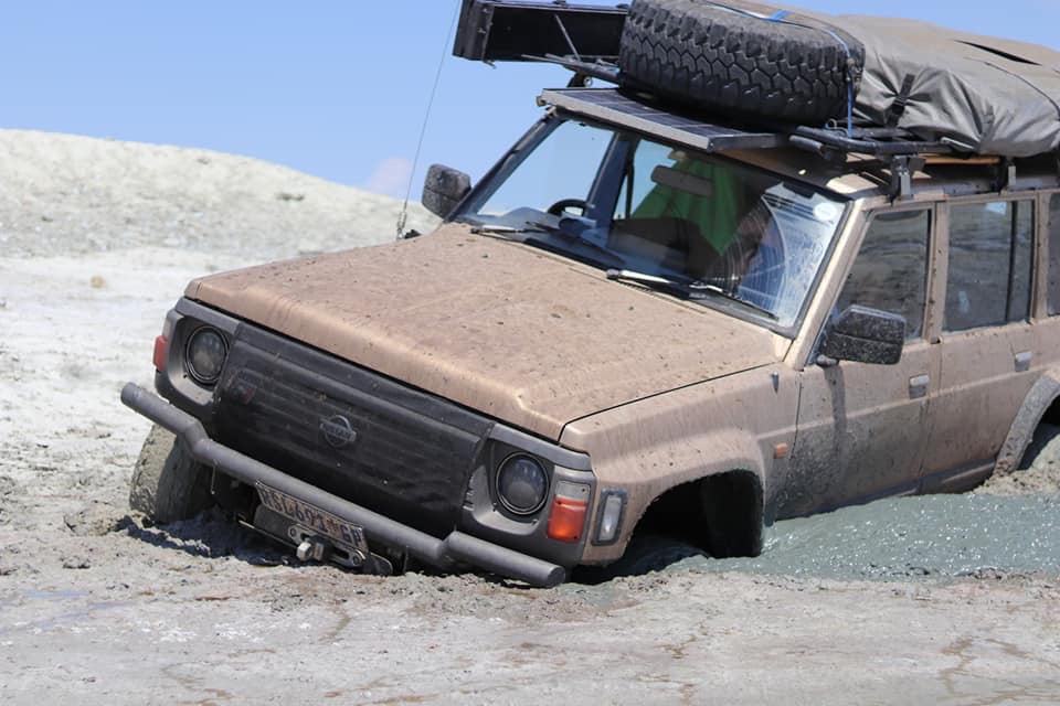

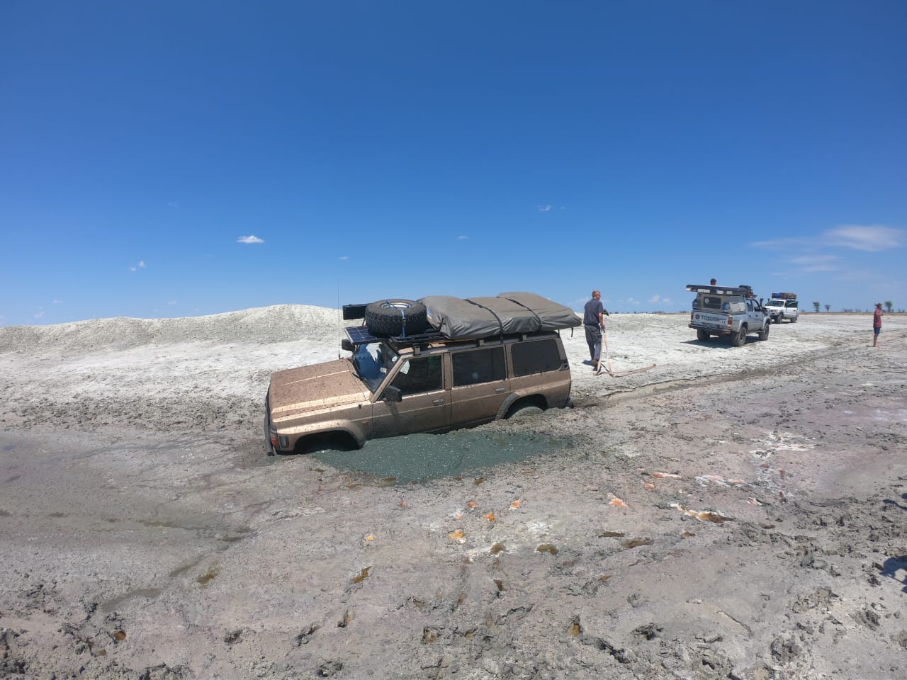

11 Tons of pulling power stood still. 3 Toyotas and a Isuzu to get me out.

Wow :coolphotos:
Salt is not your friend....
:mop: That took a while to clean thereafter I'm sure!

TijmenvdS wrote: 13 Jul 2019 07:50 11 Tons of pulling power stood still. 3 Toyotas and a Isuzu to get me out.
That is a job well done :salute:

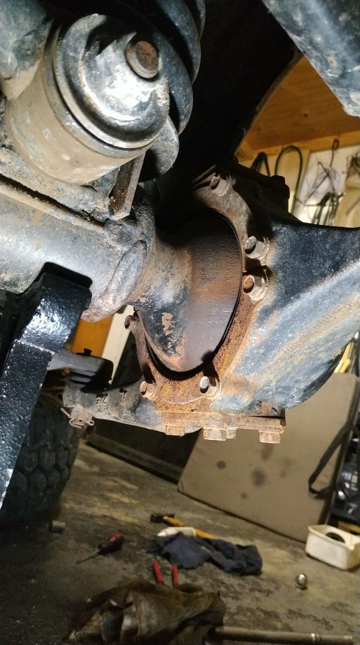

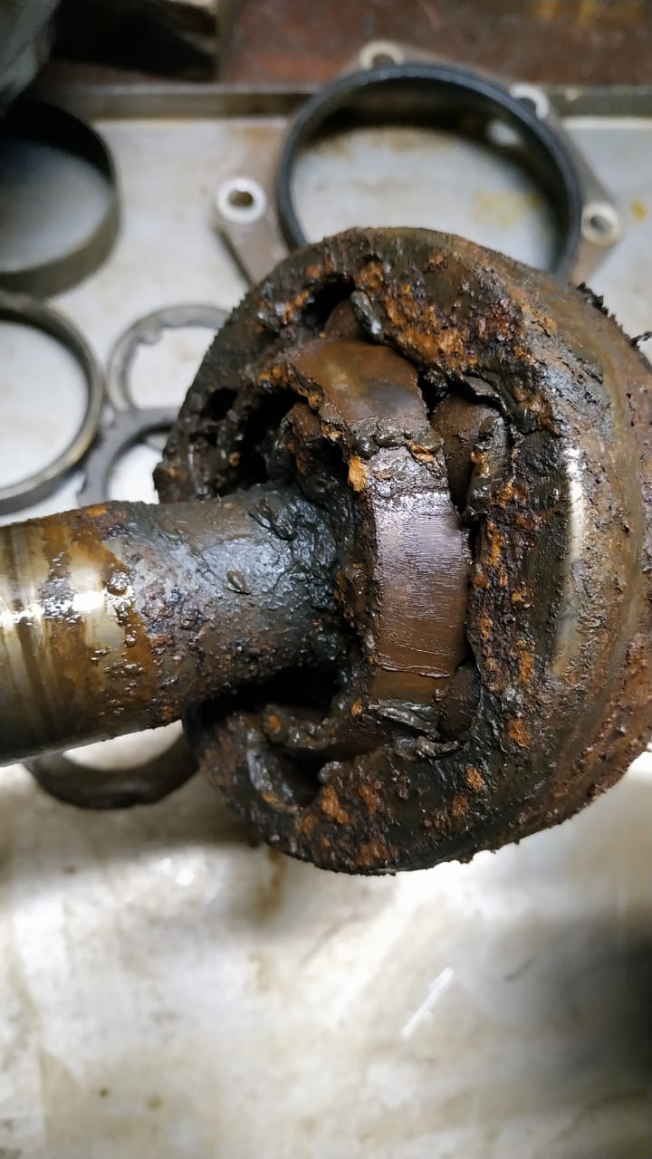

Big issues :doh:
Since all those Toyotas couldn’t pull me out I had to try and break the suction with help from my clutch and by turning side to side. Little did I know the fine salt would be creeping past the wiper seals and a 3 months later Anthony found this mess.
Mud, Water and Salt!!!!! Is not your friend.
