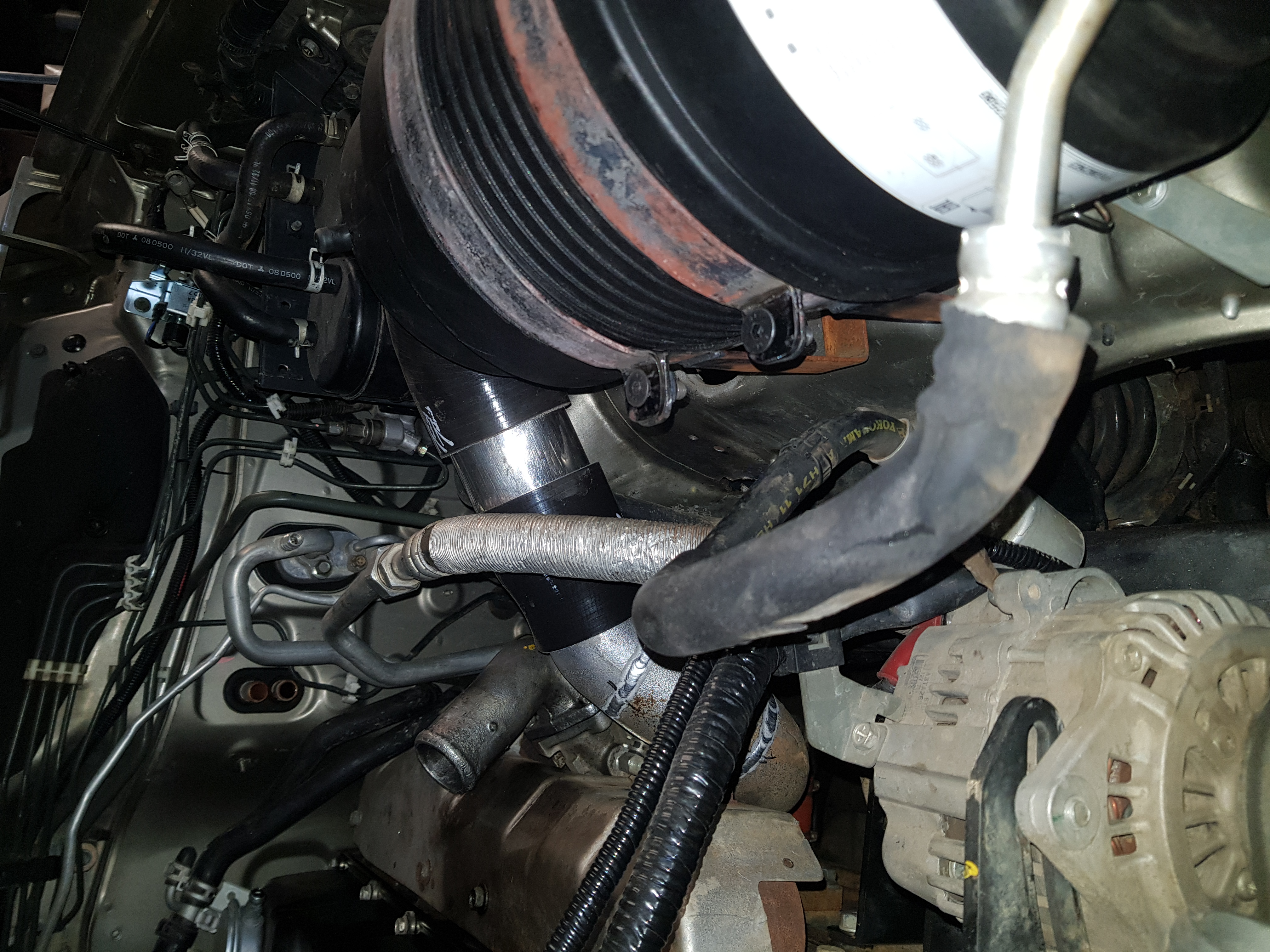

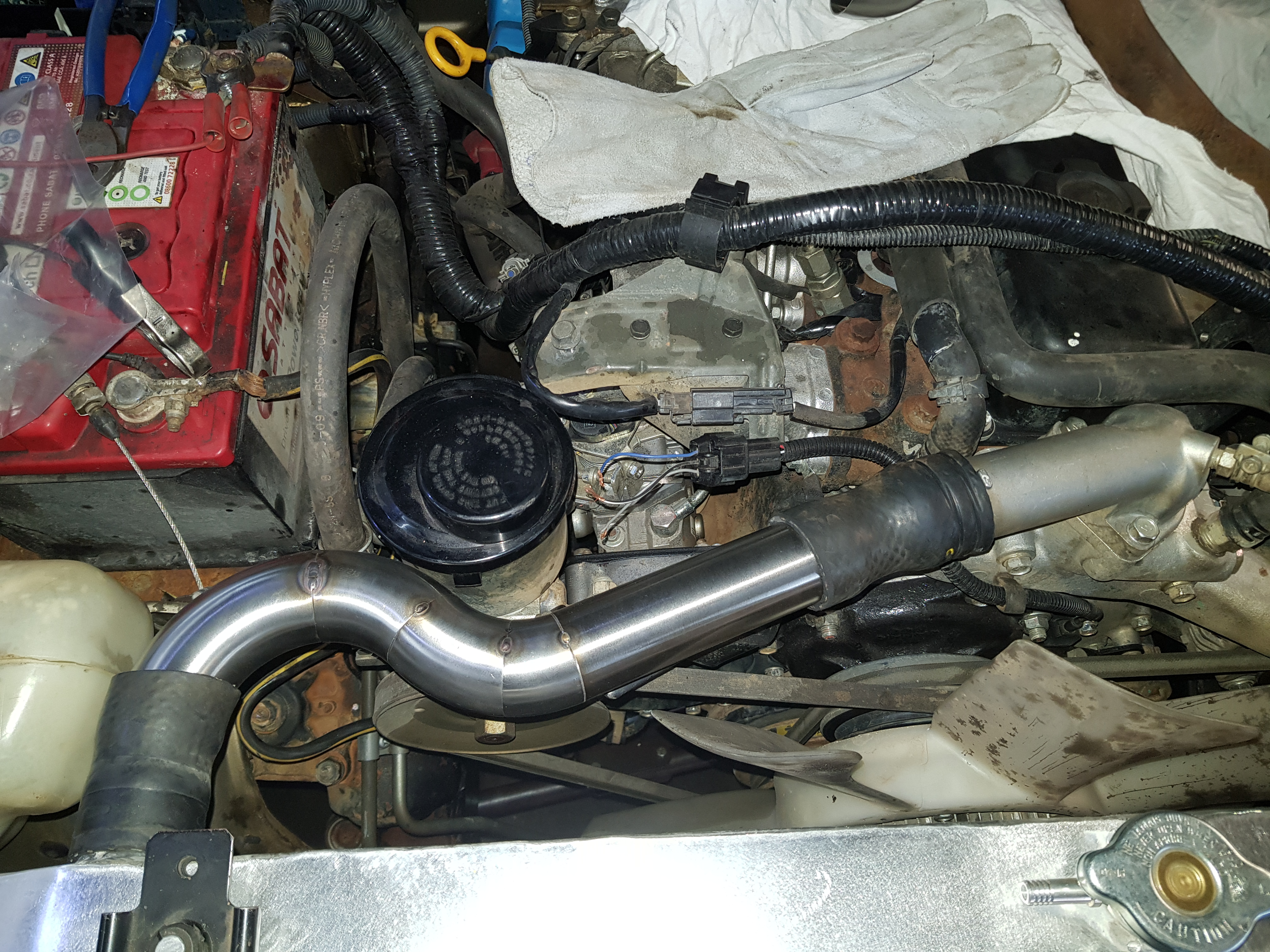

So today was a busy day finished the donaldson's brackets and the pipe work for it.Tomorrow it needs to be stripped down again to get powder coated and then it needs to be put back together.And then i made up some stainless water pipes for top and bottom.Still needs some final welding but will get it sorted out tomorrow.But first need to make my welding machine's regulator to a dual regulator to back purge my stainless from the inside other wise the start to rust from the inside out.
