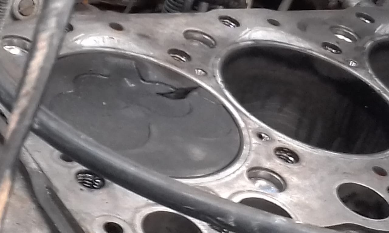

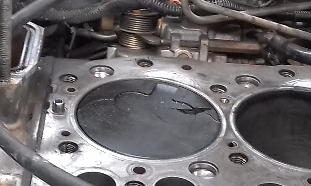

Sooooooooooo, big dept at the banks. iNyathi to be revived. This time by a reputable Engineering shop,
Engine pressure tested. No 1 piston 0 [zero] pressure.
Opened the engine today and Dennis sent me these photo's
My question WHAT Causes that?

Maar Mac, daai lyk vir my soos 'n stukkende piston, en dit sal sump pressure veroorsaak wat olie orals laat uitspuit!!
Dis nie ringe wat pap geword het daai nie. Ringe word pap van oorverhitting. Hulle breek in stukkies van te hoog rev... Lyk vir my die ounens is reg oor daai Pirate Head van jou en pre-comps wat losgekom het......
Vir my lyk dit of jy vir Michael groot verskoning moet vra omdat jy sonder inspeksie, sy naam sommer gaan en beswadder het en hom blameer het vir swak werkmanskap!!.

Oom Mac, before this gets out of hand, I guess that's what your first post should've focused on...
Re: iNyathi did NOT make it. Sell scrap or revive ?
Oom Mac, It has become blatantly obvious to whom you are casting the blame on this. It has also become clear on many other social media platforms. Please understand that here on this Forum we do not tolerate any form of defamation etc. Although you don't mention a name on the "back yard mechanic", I will say me, as I don't want to speak for everyone am getting a bit upset with the way you are conducting yourself, especially as a Christian man that you profess to be. I think you need to step back and relook at your conduct and then you need to get a full analysis of that motor done first before you hammer in to someones credibility.
Please post a photo of the head so we can all look at it and see. Make 100% sure of ALL your facts before you say (type), and share the full whole history of what has been done and why was it done that way. We all know there is 2 sides to any story.... your side.....his side....and the truth will be evident.
I am really saddened by what I have seen, read and heard over the last few weeks. This is NOT how Patrol Owners are.
Oom Mac, please, I have known you for many years and this is not how you claim to be.
