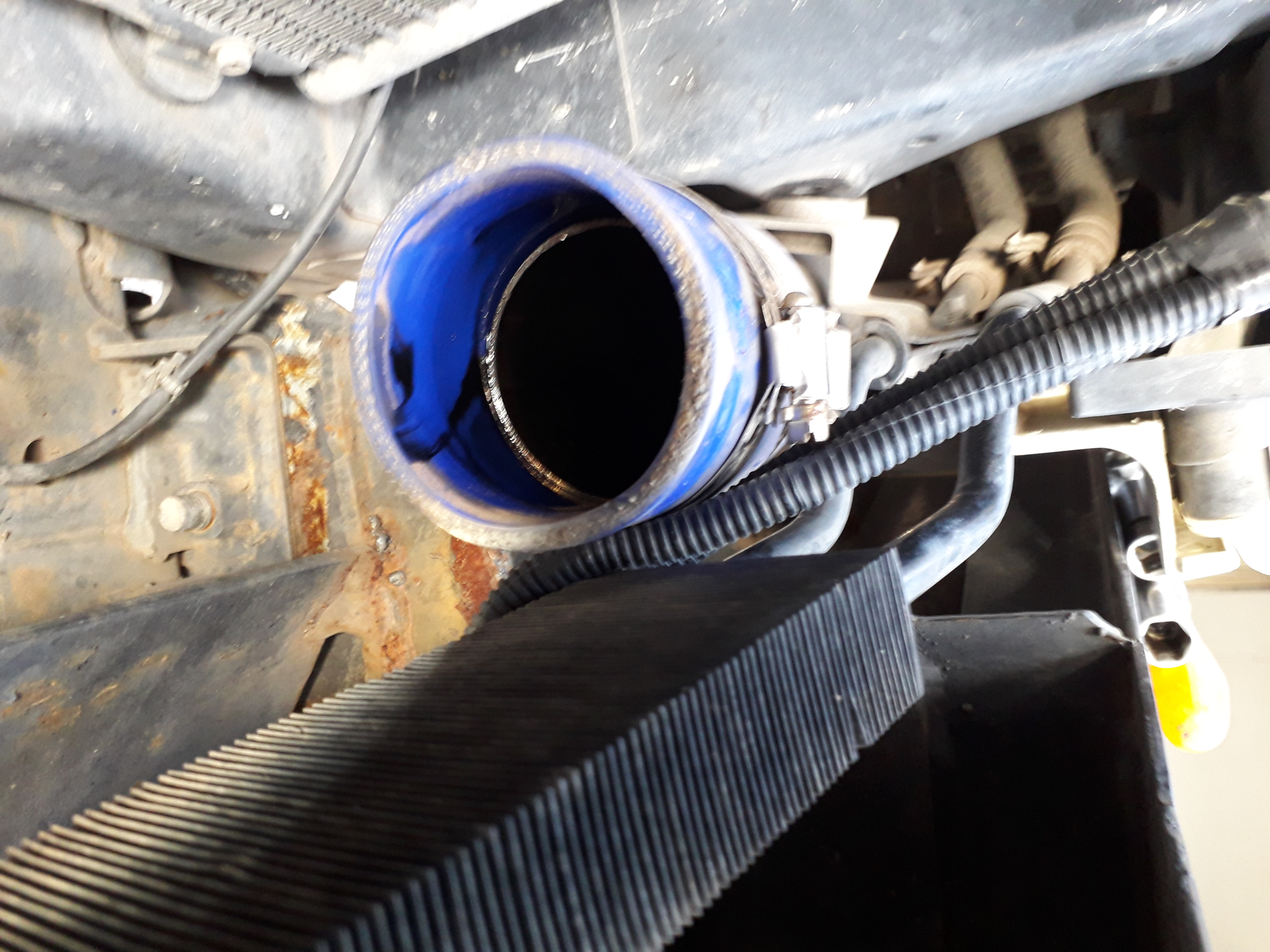

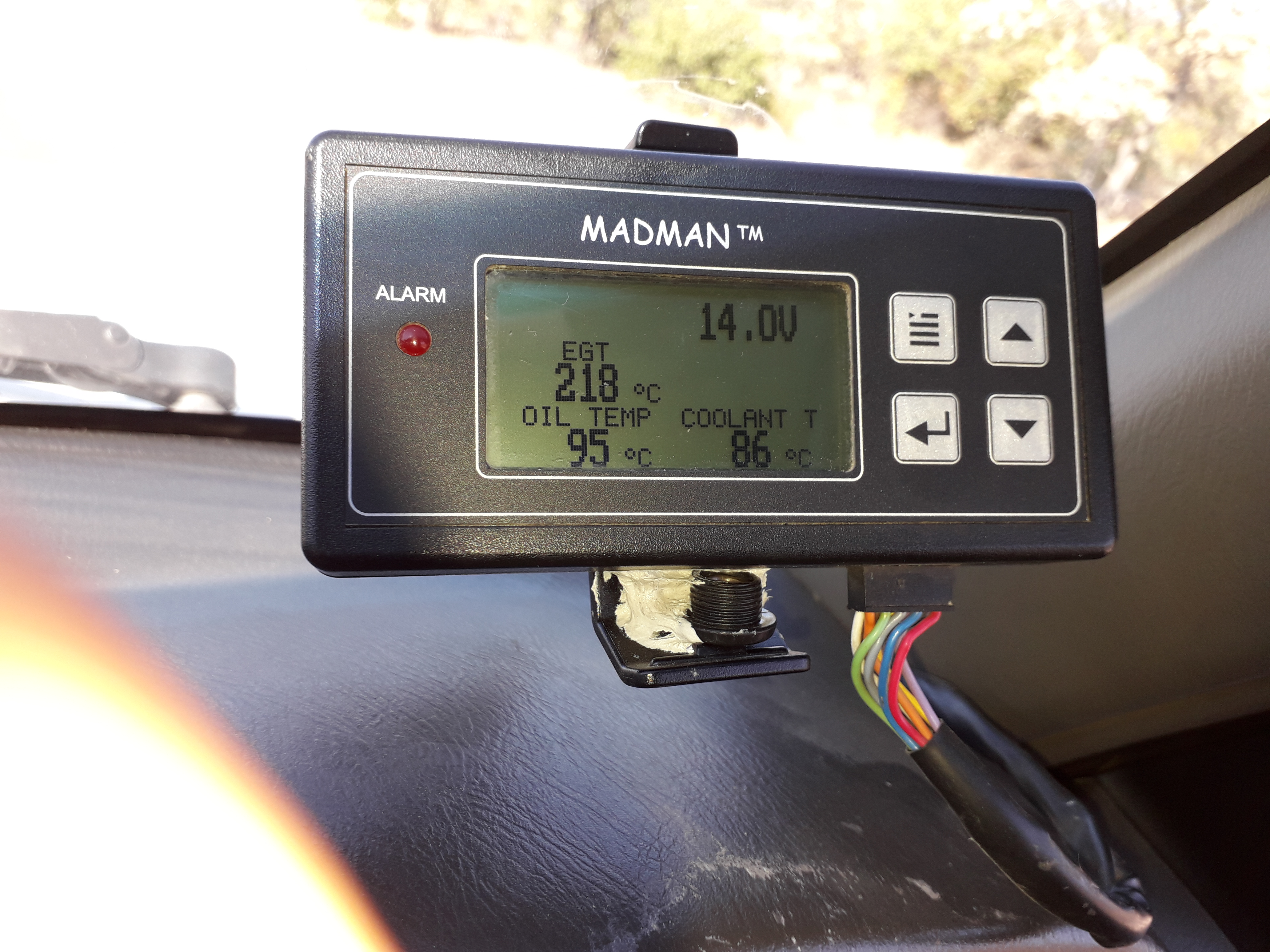

At Ghanzi we did an oil change and removed and cleaned the inter cooler just recently fitted, it was full of oil and the power on iNyathi was dropping at a rate
In Maun [380 km on] iNyathi too 4 Liters of oil to to up
At Nata it took 2 liters again
At Sebina, 3 liters again
Then, at Big Fig [few KM SA side of Groblersbrug Border the oil level was perfect.

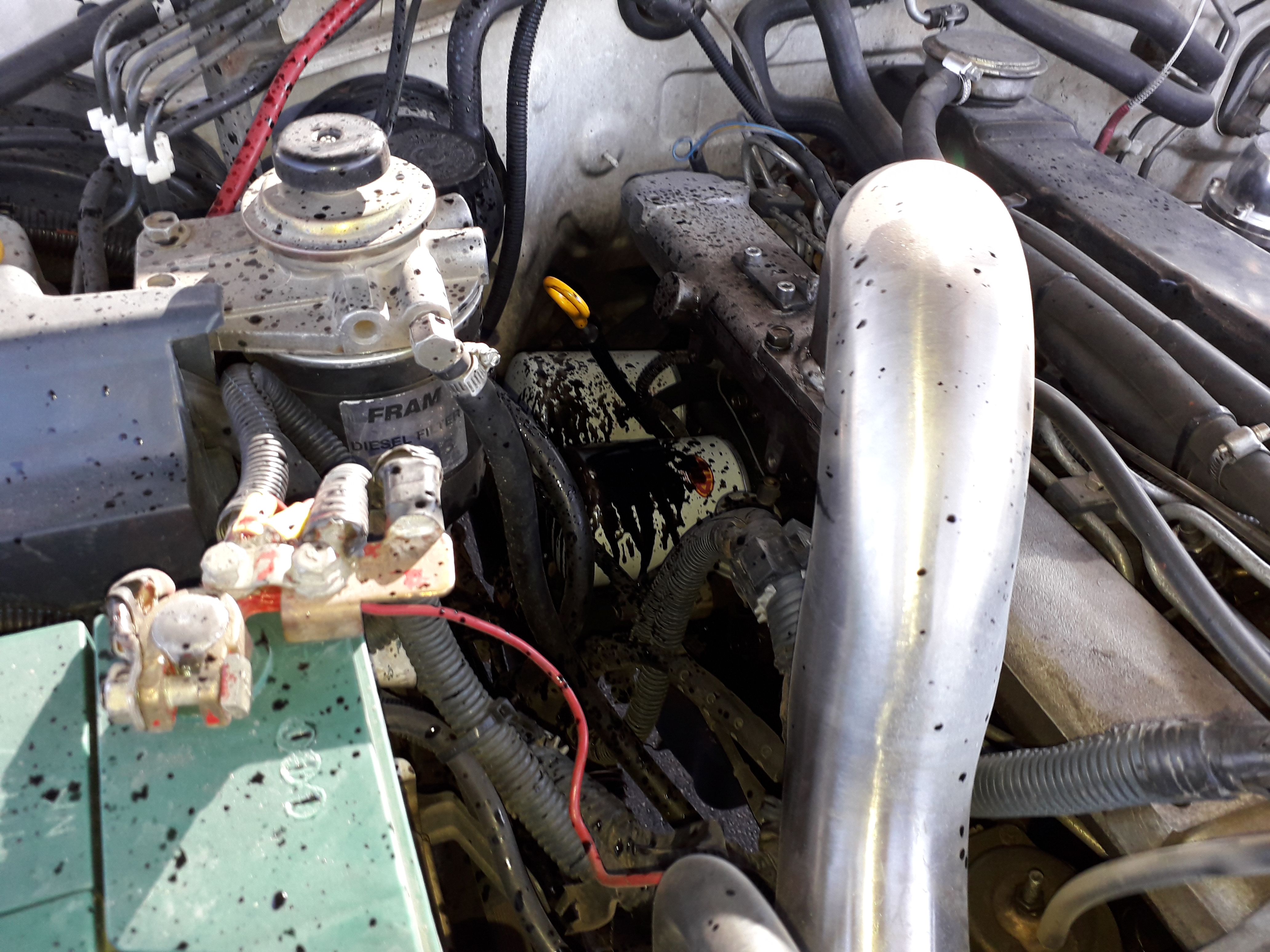

40 Km from Vaalwater on the Ellisras road, clouds of smoke, no power and a krrrrrrrrrrrrr noise.
I stopped, drew the dip stick ..... and myself and the inside of engine bay was sprayed with oil.
The mechanic who did the pistons and rings last year denies any responsibility

Die ringe wat Michael ingesit het, het platgeval [of watookal die woord daarvoor is] olie wat jy sien oppi pict het by die dipstick uit gespuit toe ek olie vlak wou tjek [engine het nog ge-idle maar erg ge mis]
