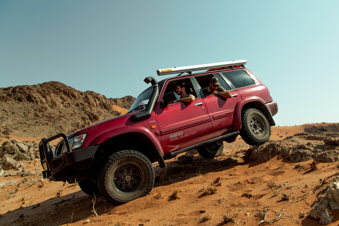

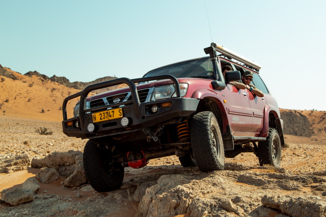

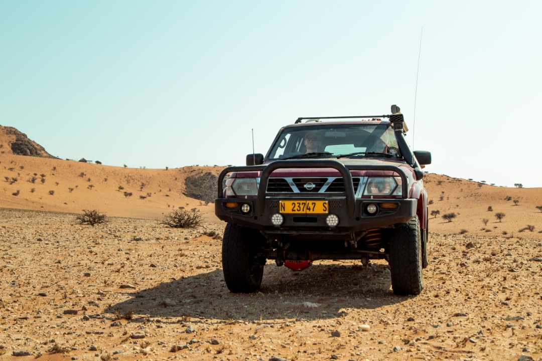

Just thought I'd put up a picture or two as it's been a while and because we like using our Patrols for their intended purposes.

- IMG-20190923-WA0045.jpg (211.75 KiB) Viewed 9367 times
- IMG-20190923-WA0053.jpg (210.77 KiB) Viewed 9367 times
- IMG-20190923-WA0057.jpg (198.09 KiB) Viewed 9367 times
