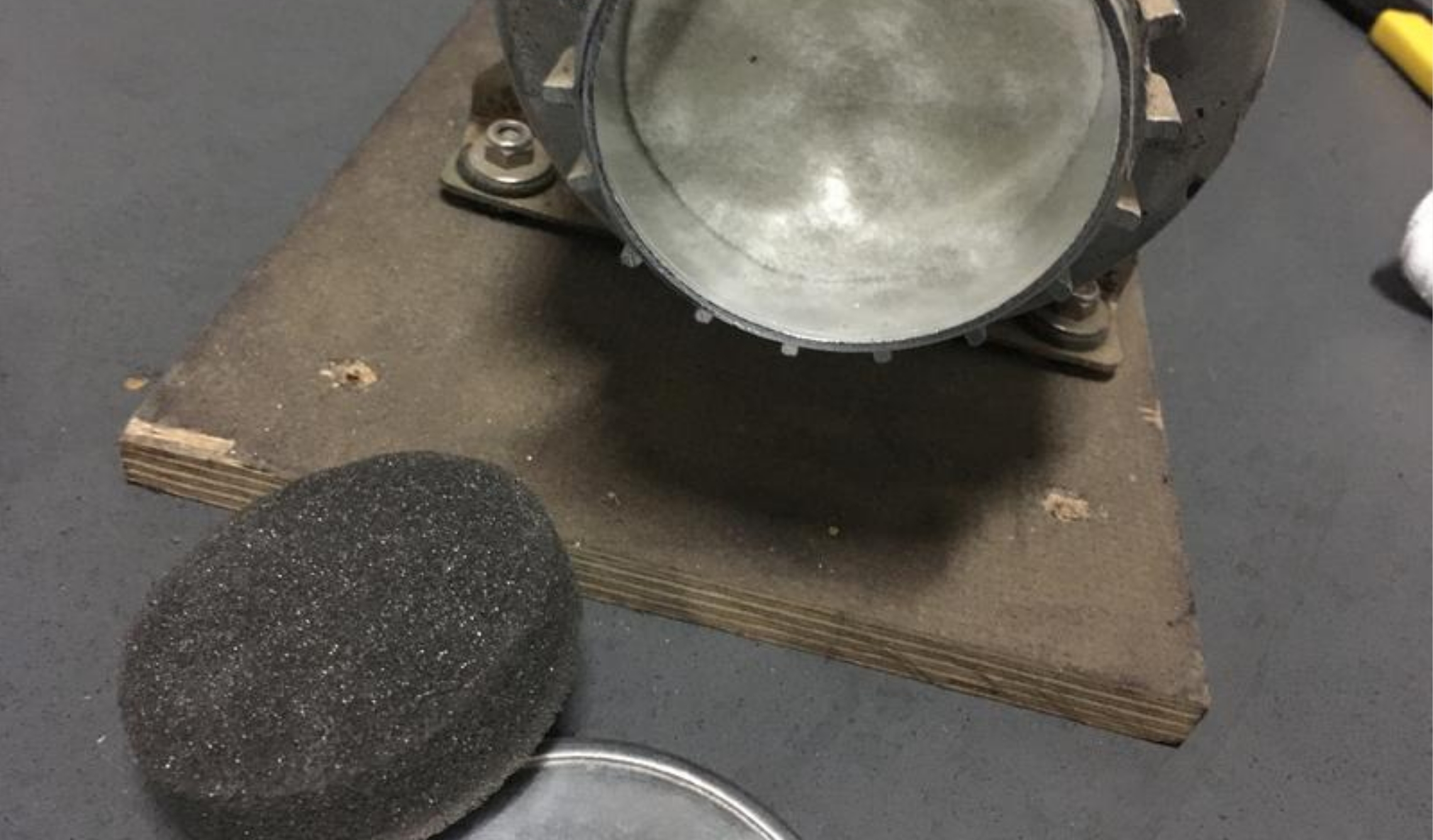

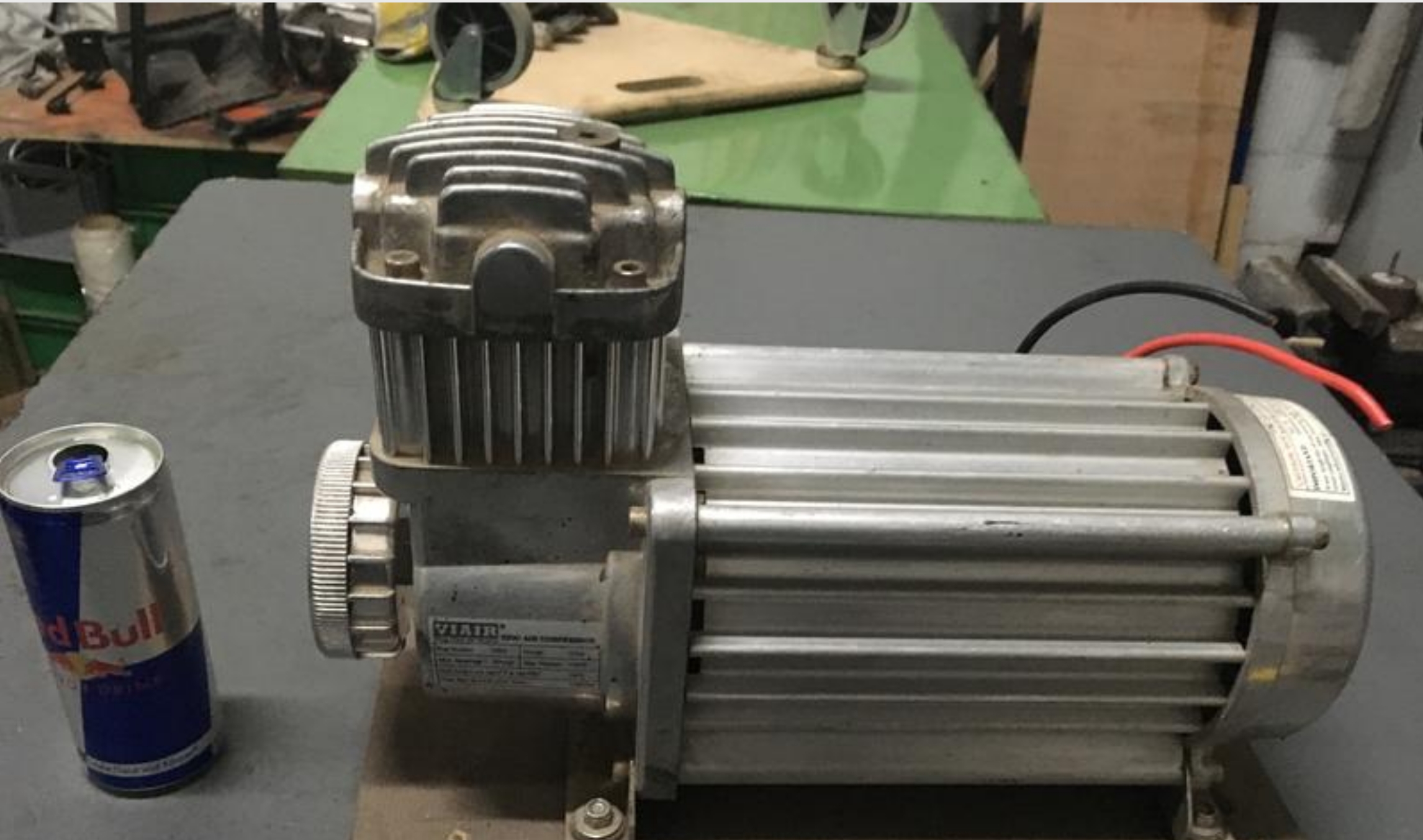

Re: 300L/min Air compressor
I run a viair 550c
Its a beast, but must be mounted inside as it is not water or dust proof.
Some pics from google...

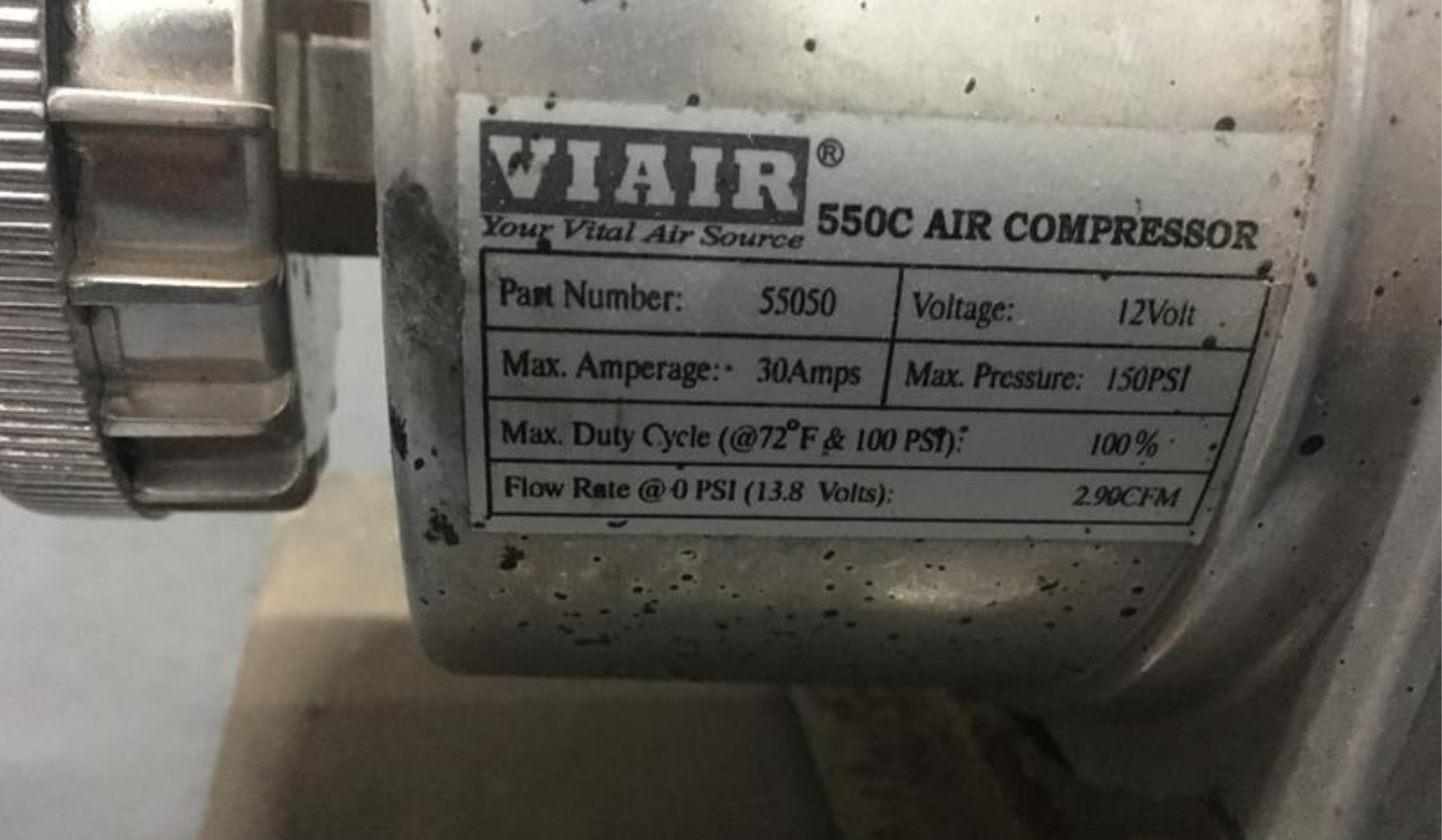

Thanks HugeJP,
It seems your compressor is about a 85L/min one. Obviously if it thumps well then it has only little flow drop (when pressure increases). The Duty cycle is nicely marked. I'm obviously a layman, but a 100% duty cycle at 6.2bar is pretty good - no start/stop neccessary.
My 160L/min and my back-up 85L/min has no such info on them. Only voltage, amperage and flow rate (probably at 0psi - but doesn't specify).
