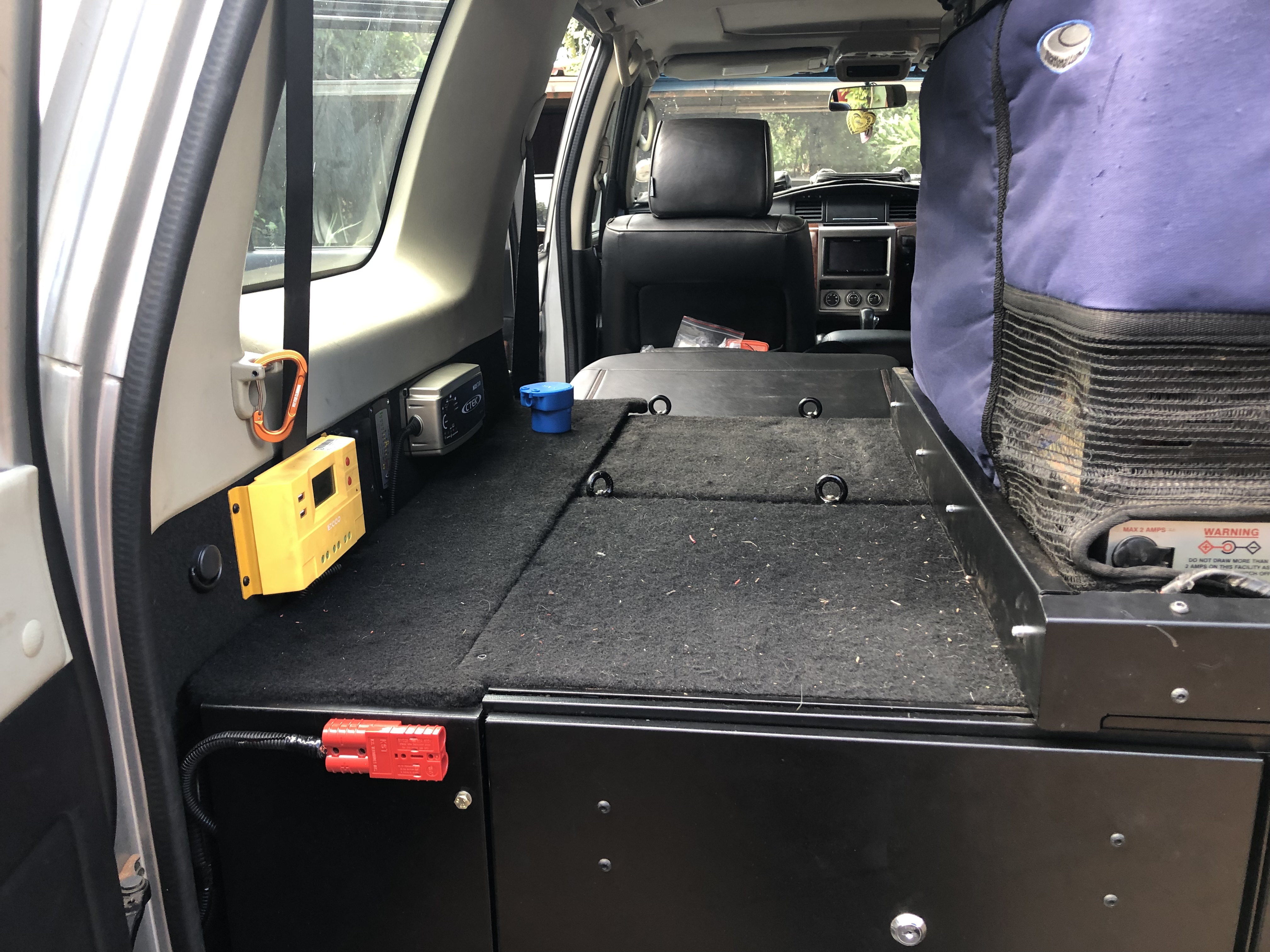

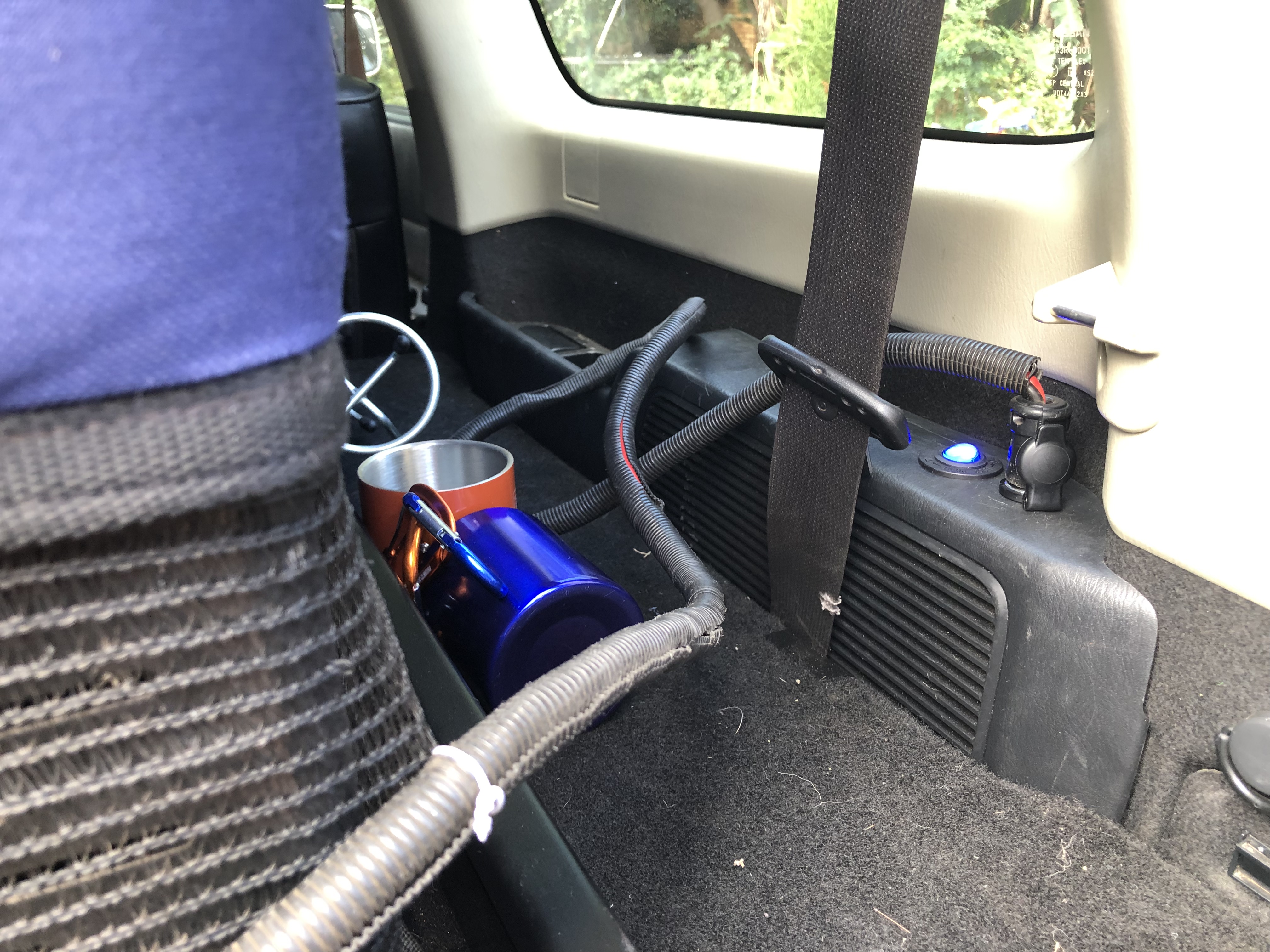

Finally. Battery installed next below next to the drawers. USB and cig plug in front (plus solar BH connector), and the fridge now has its own dedicated hella and switch
Before:
Before
Before
After the facelift:
After
After
And a dedicated power socket, if I camp where electricity is available. Plug in and it charges the battery and runs the fridge
