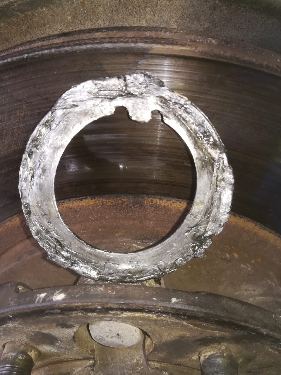

I do however have a chi chi chi sound coming from it sounds like the front wheels, when I turn it disappear and when going straight it returns

As for the chi chi chi sound, perhaps try locking the hubs to make sure it is not an issue with them ? Not sure if your hubs are manual or auto locking, but that is generally indicative of a hub requiring maintenance on the auto locking assemblies.
Alternatively, perhaps brake pads ?

The chi chi chi is possibly the old school high tech early warning system on the brake pads indicating that they are almost ready to be changed

Jack one wheel up at a time and feel the wheel bearing play, you will probably find it is a bit loose and needs tightening

Some report back, the chi chi was not the brake pad early warning system, my left wheel bearings was so loose it was scary , the culprit was the lock washer and fortunately the bearings still fine. However I am going to convert as per TourdeFrans my front bearing system from GQ to GU

Wow..... that must have been really loose. Pleased you caught it before it got worse, and damaged other things.
