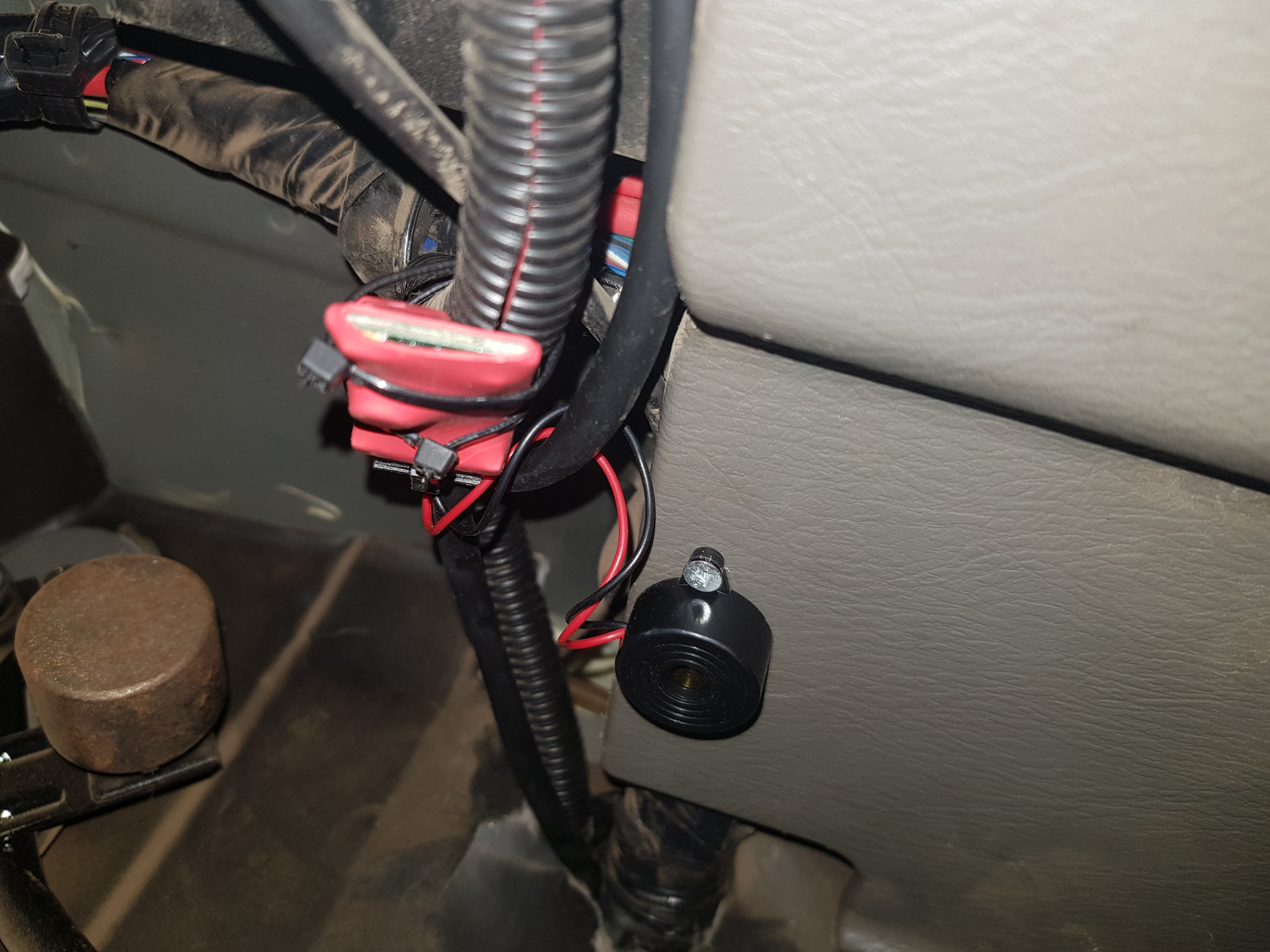

Took the harness for the sensors through the firewall at the rubber bung behind the accelerator. I cable tied the logic board to a convenient location there, and screwed the warning speaker into the trim plastic to the right of the accelerator.

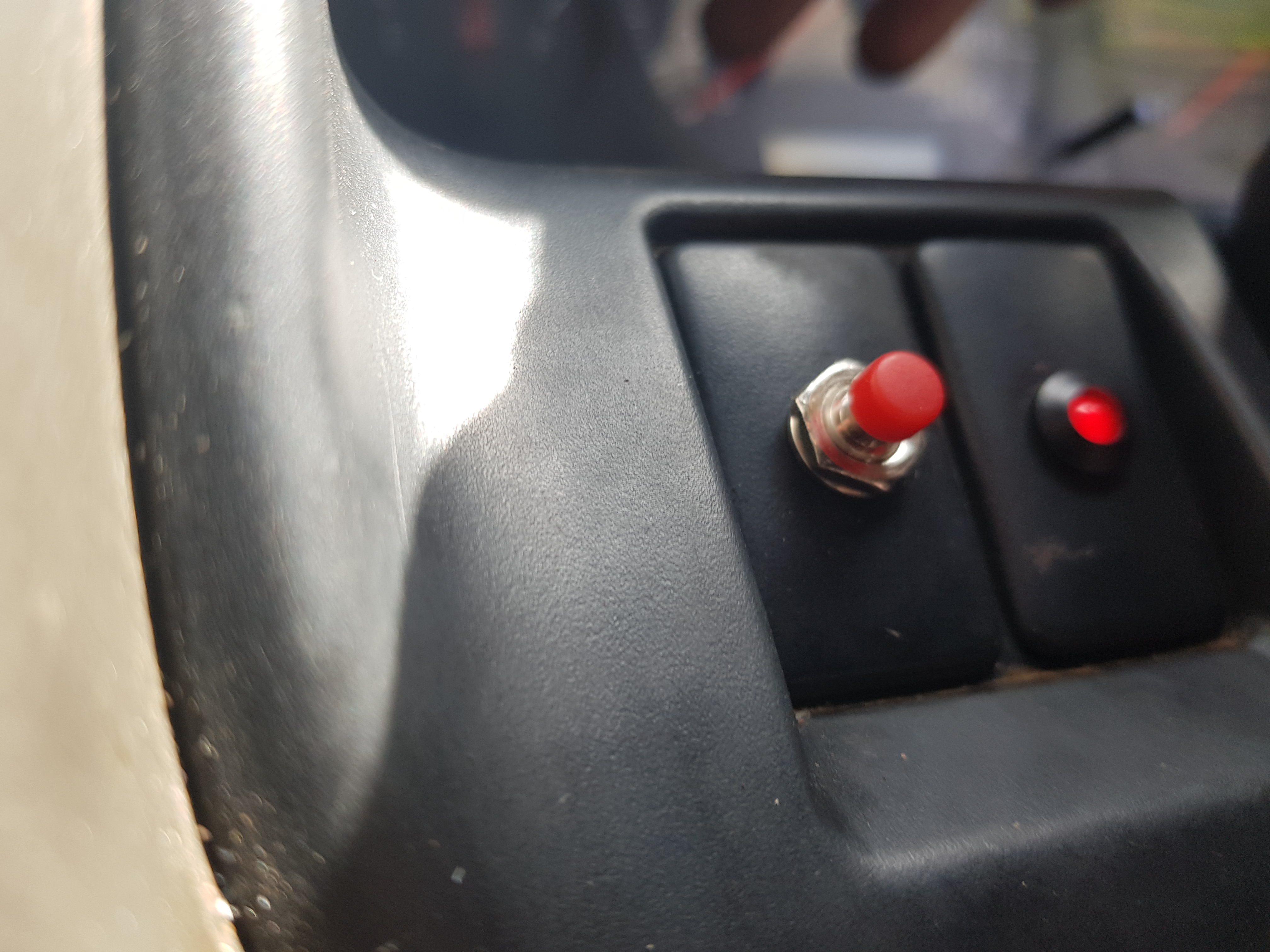

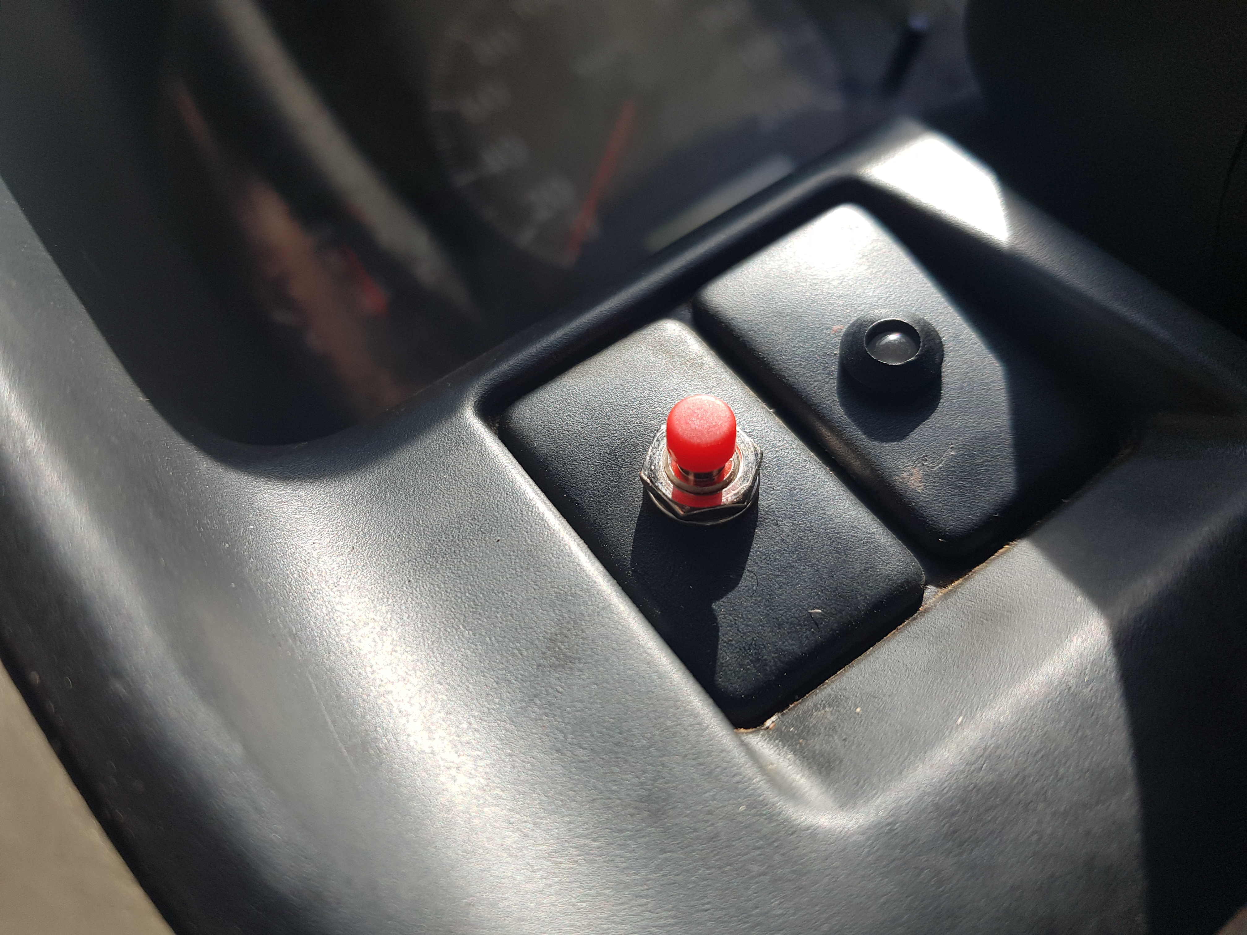

The button and LED, I installed in the two empty switch slots to the left of the steering wheel.
The red lead on the harness is +12V. Tapped power off the radio's ignition on +12V using the lug provided, and grounded the black wire on the screws on the radio mount. Made sure that the two sensor wires were not touching each other and switched on the ignition. After 5 seconds, the warning speaker started beeping and the LED flashed red - as it would should the coolant be too low. I turned off the ignition again to finish the job.

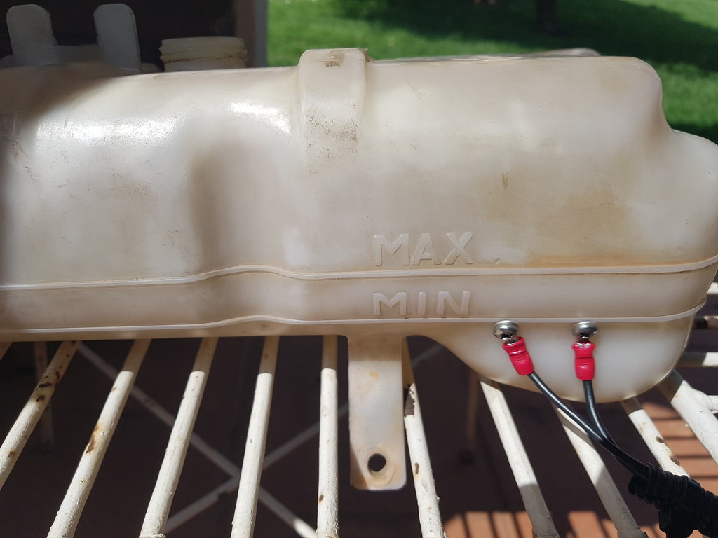

Next step was removing the plastic overflow tank. I carefully poured out the liquid gold which is my coolant, containing the proper ratio of Nissan's awesome, but very expensive anti freeze into a suitable container.
The sensors are two self tapping screws that get screwed into the overflow tank shortly below the minimum marker. They get mounted horizontally, 25mm apart from each other.
After that, I flushed out the overflow tank, filled it up and left it for 10 minutes to make sure there were no leaks. There were none, so I emptied it and reinstalled the overflow tank. After this, I connected the sensor wires to the harness. The unit's harness is a little short for a Patrol, so I just lengthened the two sensor wires using suitable cable, and clad it all in split sheathing.

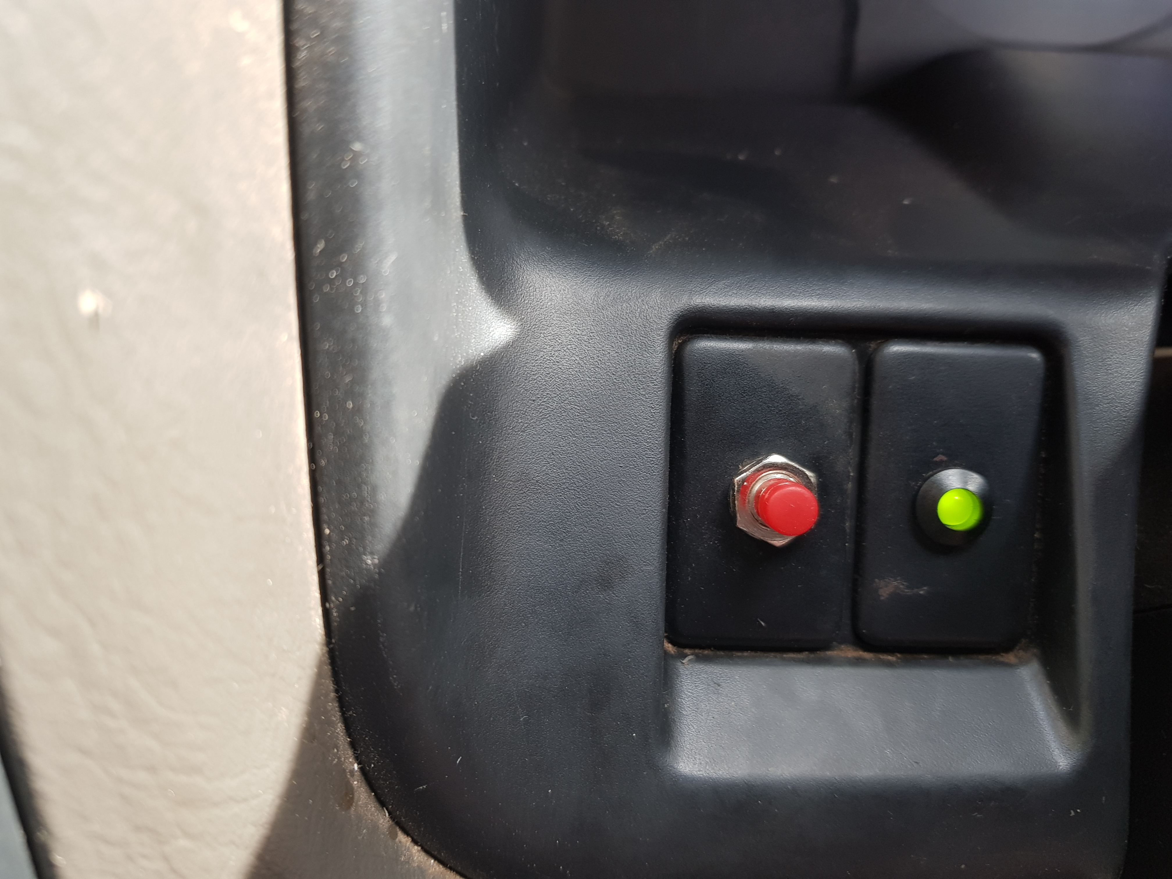

Since I wanted to test that stuff worked, I left the overflow empty, and switched on the ignition. The unit beeped, LED came on green. And after 5 seconds, the warning beeper went off and the LED started flashing red.
I did not acknowledge the warning with the button as I wanted to hear whether the warning beeper stopped whilst refilling the overflow tank. Whilst refilling the overflow tank with the coolant I had removed earlier, the device detected that the water level was correct and stopped beeping. The LED was now green.
In short, everything worked as it should.
Unit operation is simple. The light will burn solid green when coolant level is fine. If coolant level drops below the sensors, the light will flash and the warning beeper will sound until the warning is ackowledged by pressing the button. If the warning is ackowledged, the LED will burn solid red.
The device will only raise an alert regarding low coolant after 5 seconds to prevent false alarms in offroad conditions.
One can also enable or disable the speaker or the entire unit using the button.
