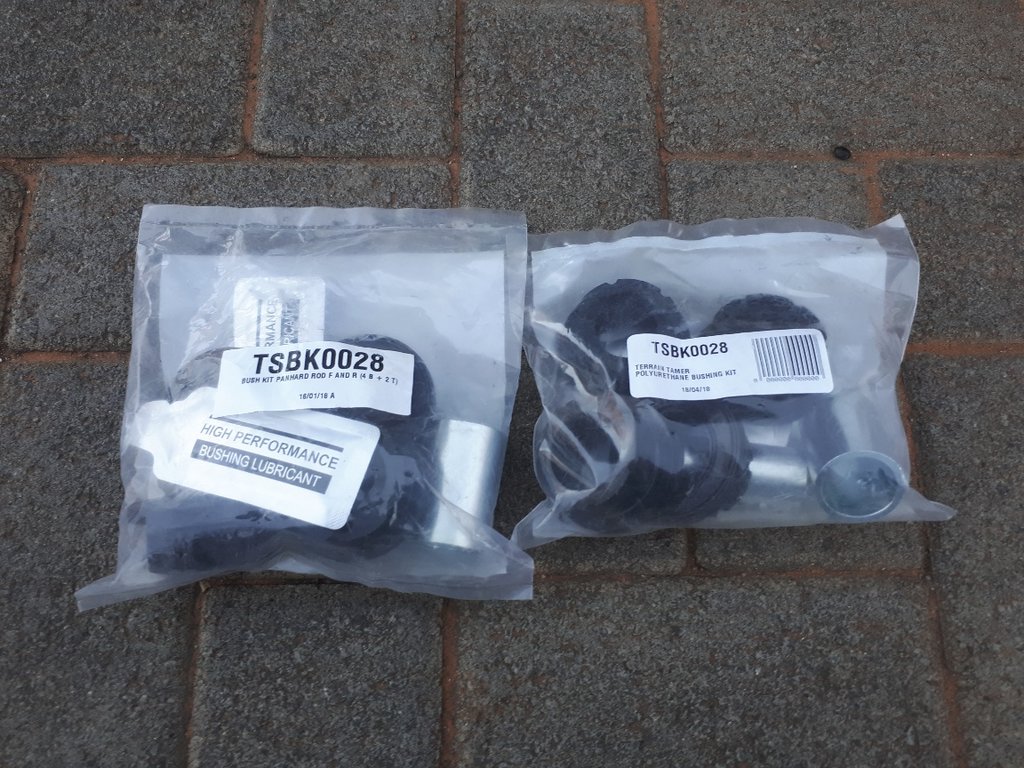

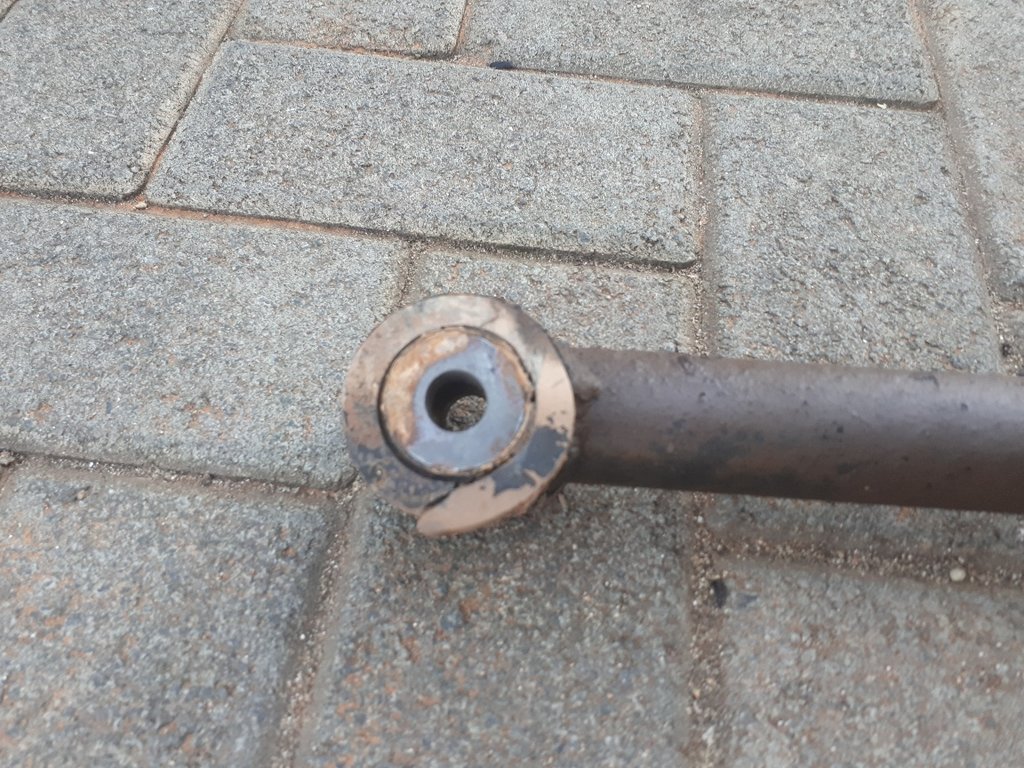

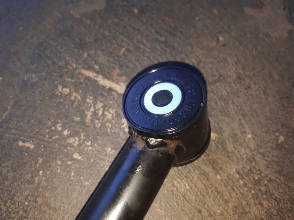

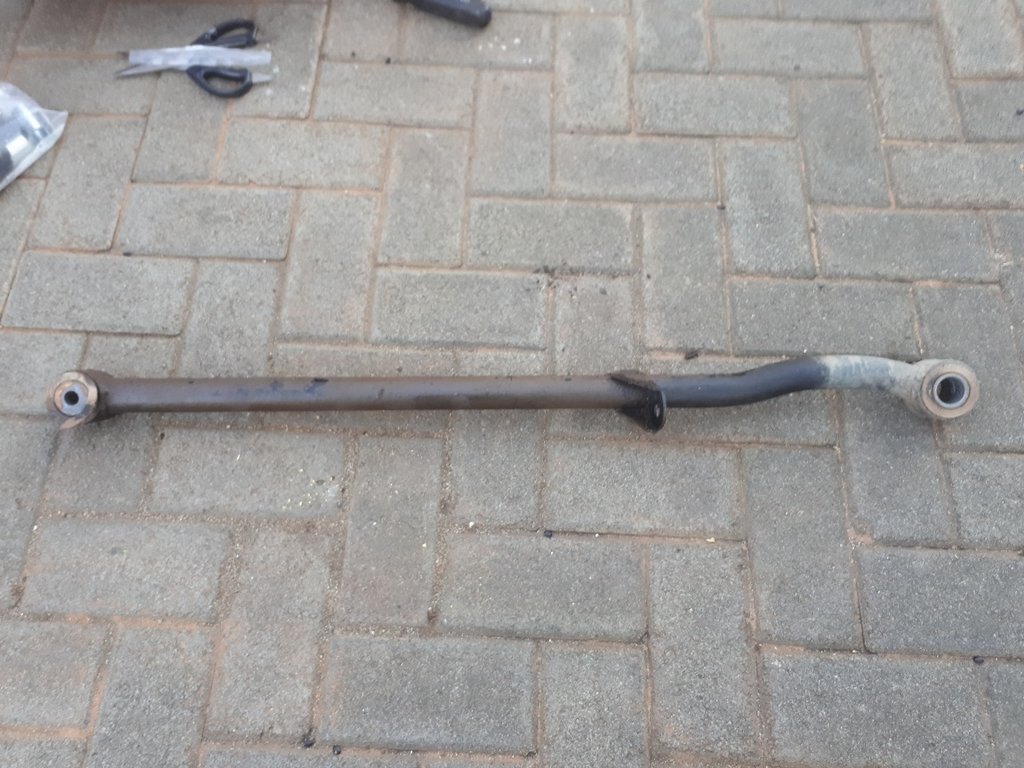

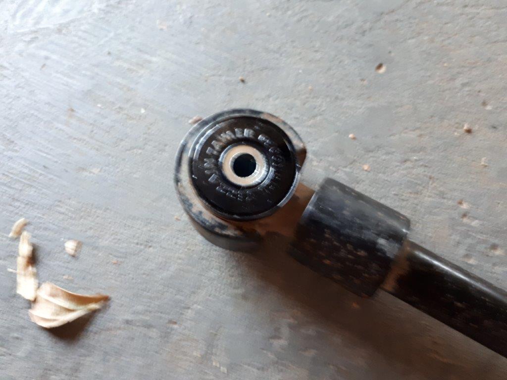

one of the first problems I picked up with the vehicle was that the was some play on the suspension bushes.

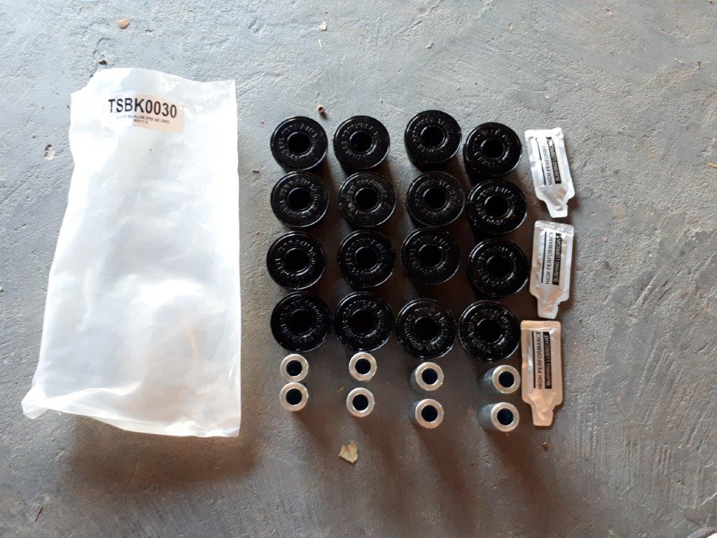

I will replace all the bushes with the Terrain Tamer Pro Bush kits, but I started with the Panhard Rod bushes over the weekend.

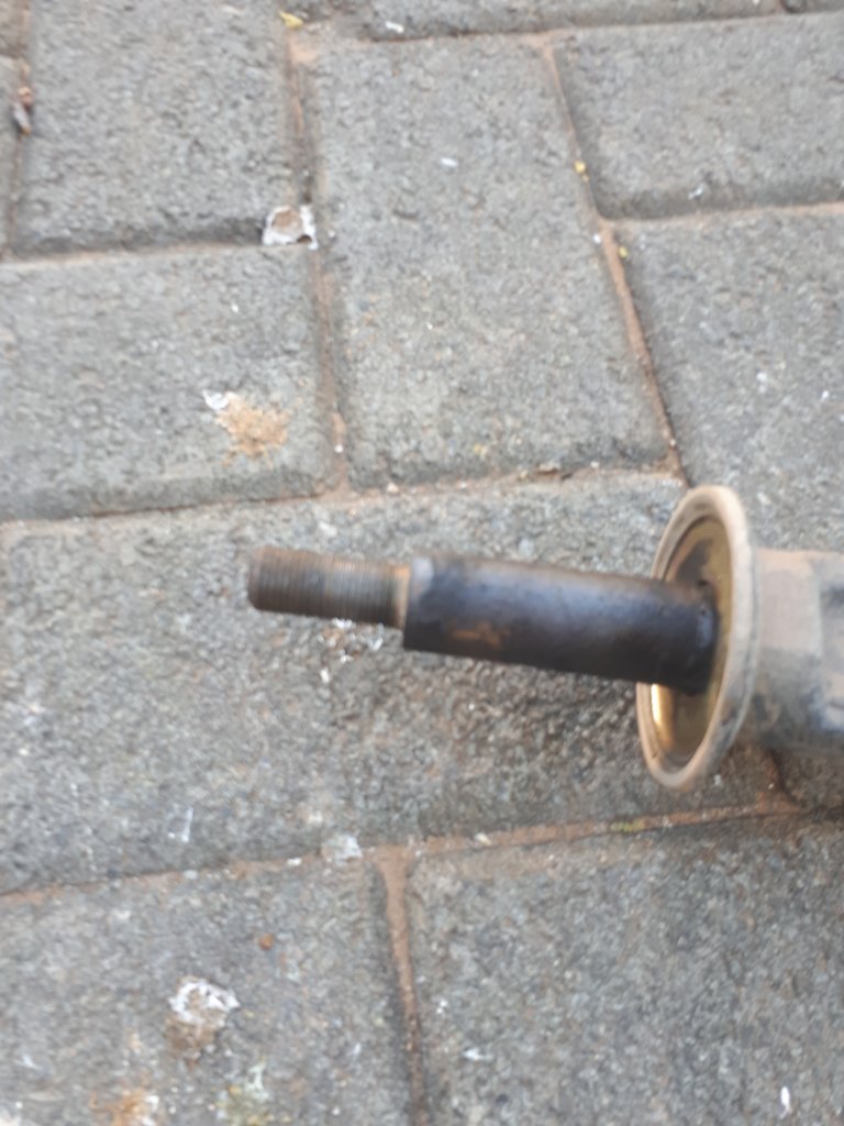

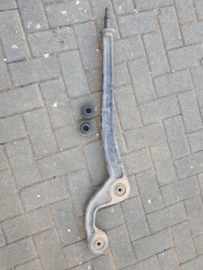

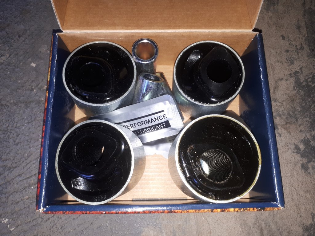

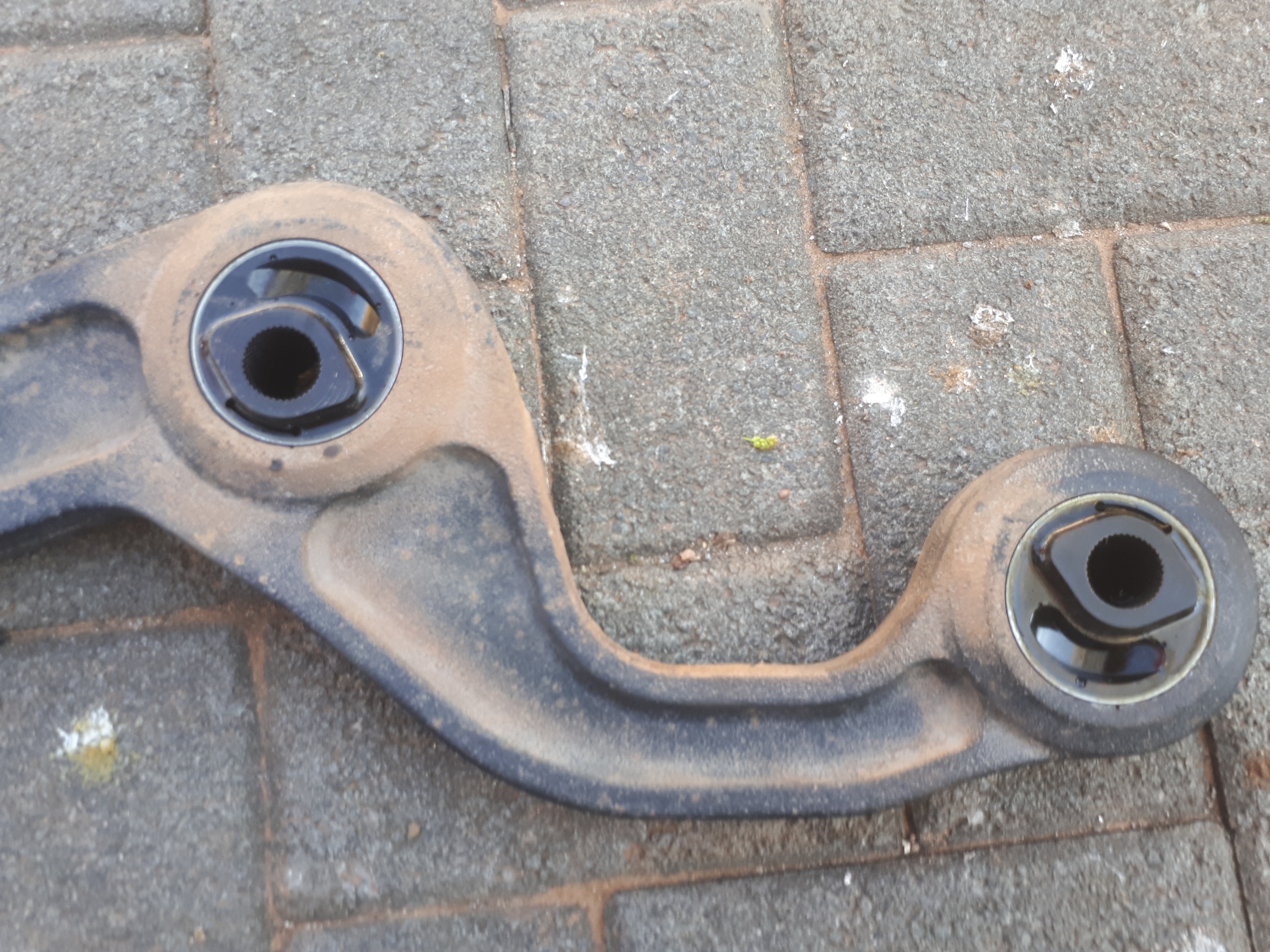

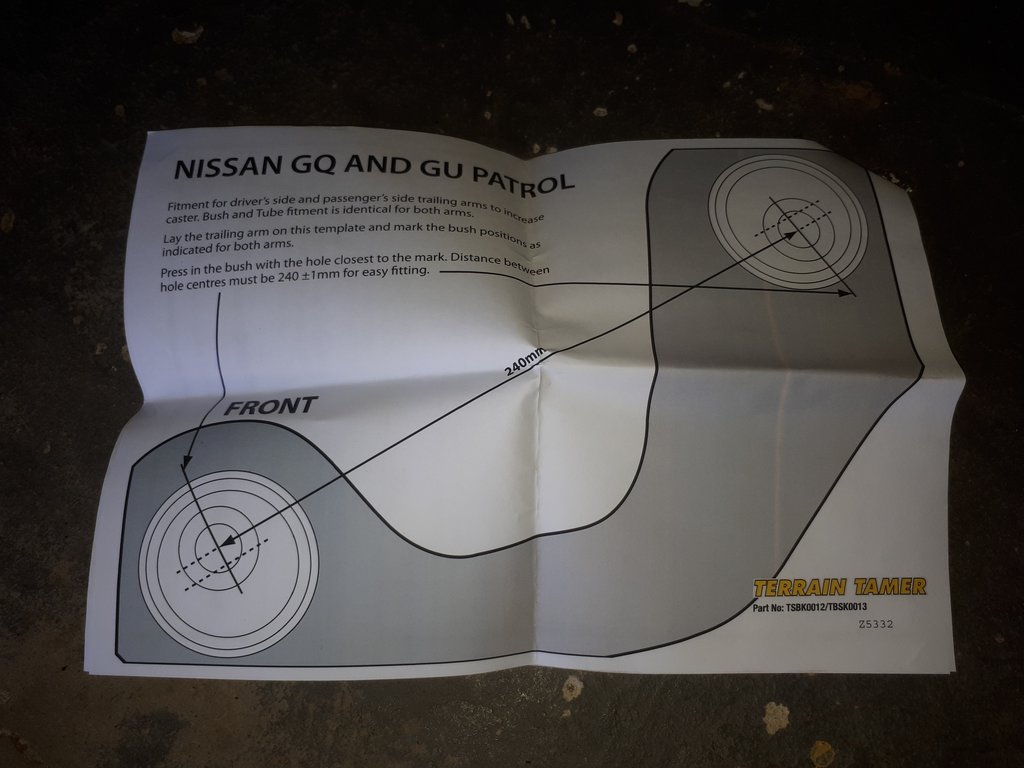

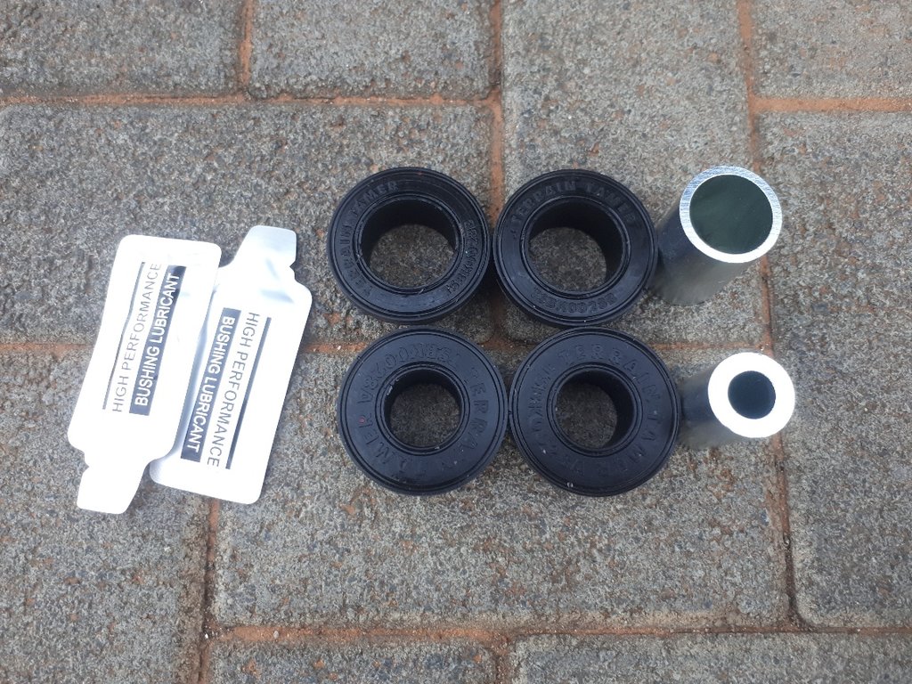

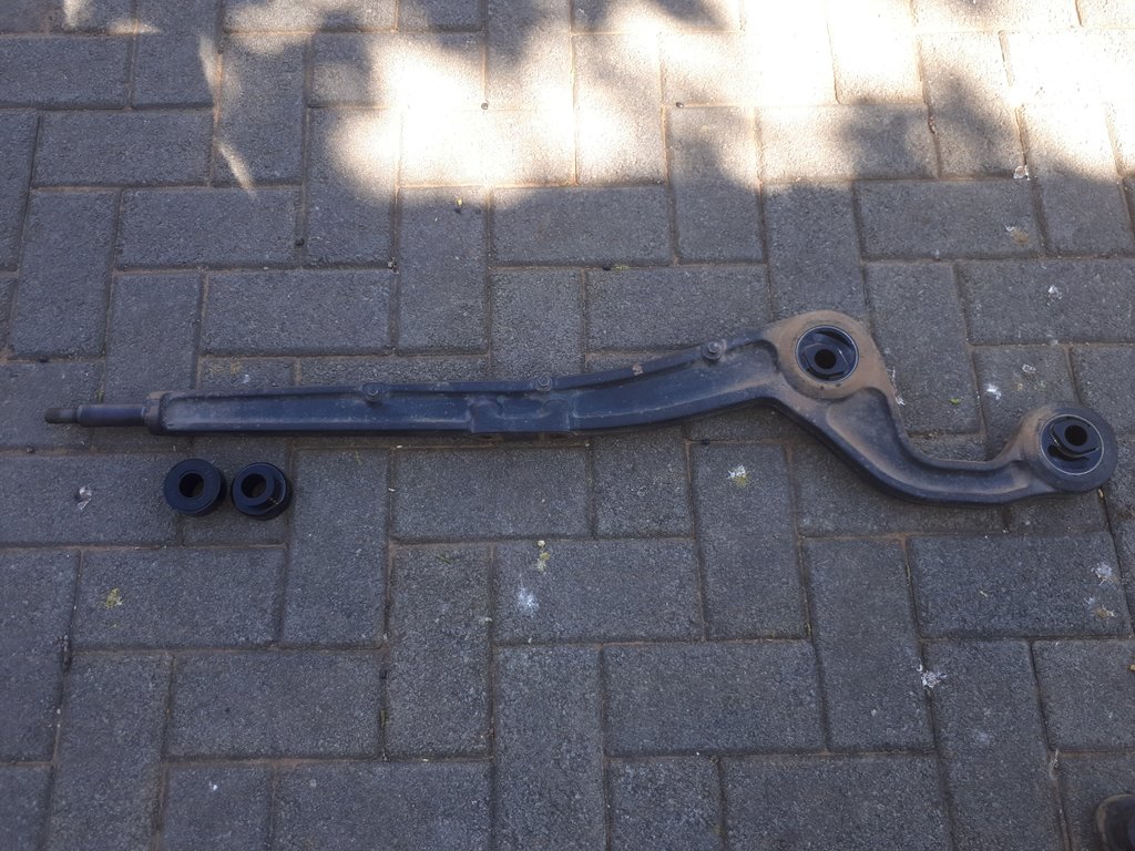

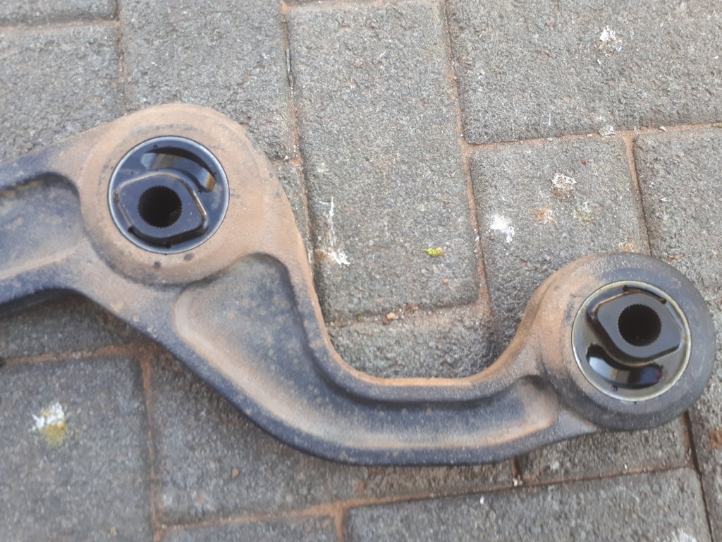

Over the weekend it was time for the front radius arms to receive new bushes. I replaced the standard bushes with castor correction bushes and the arm to chassis bushes. The Castor correction bushes comes with an installation manual with the exact placement of the bushes printed on. This worked very nice and all fitted first time.

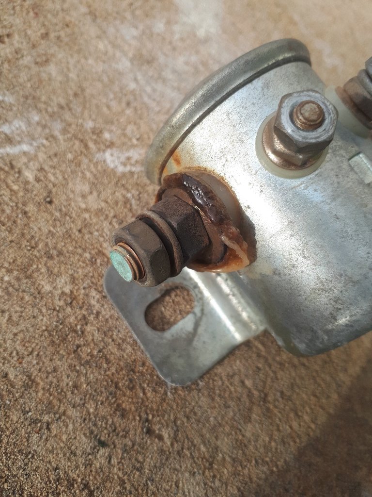

I had to remove the second battery solenoid as well. It seems that at some stage a short damaged the unit and some of the wires.
I will fit my CTEK charger and second battery in the back of the vehicle.

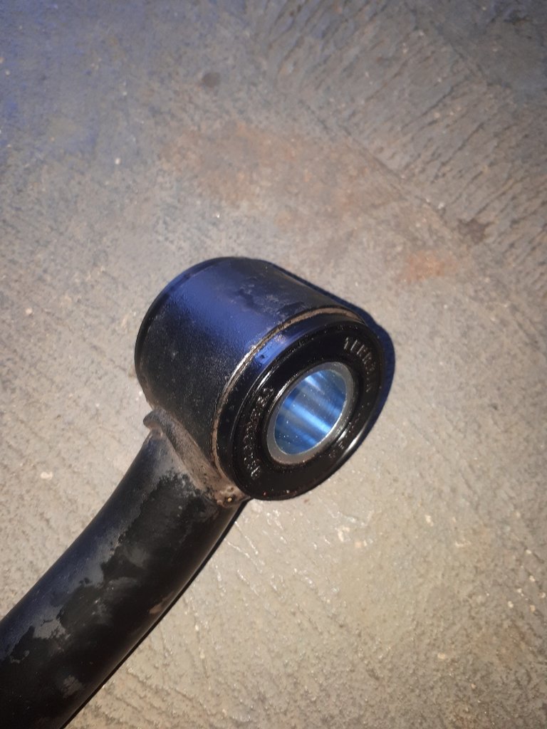

I have not posted for a while. I was preparing for our trip to the Kgalagadi. Before we left I did the rear trailing arm bushes on the Patrol.
The car did very well with the new suspension bushes on the corrugated roads. We took the road between Van Zylsrus and Askham. 168km of corrugation.
