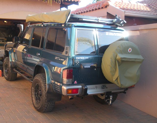

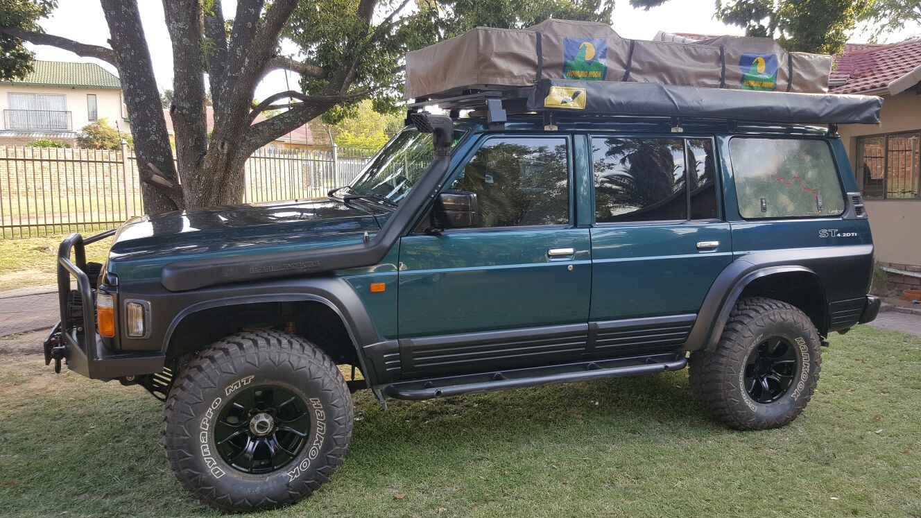

The Patrol was bought new in 1996 from Nissan by Grant's father - 95/96 ST4.2D that was imported from Aus by IC Nissan in Springs. Nissan SA keep telling that troll is a grey import. The story changes when I show them the original sale doc.

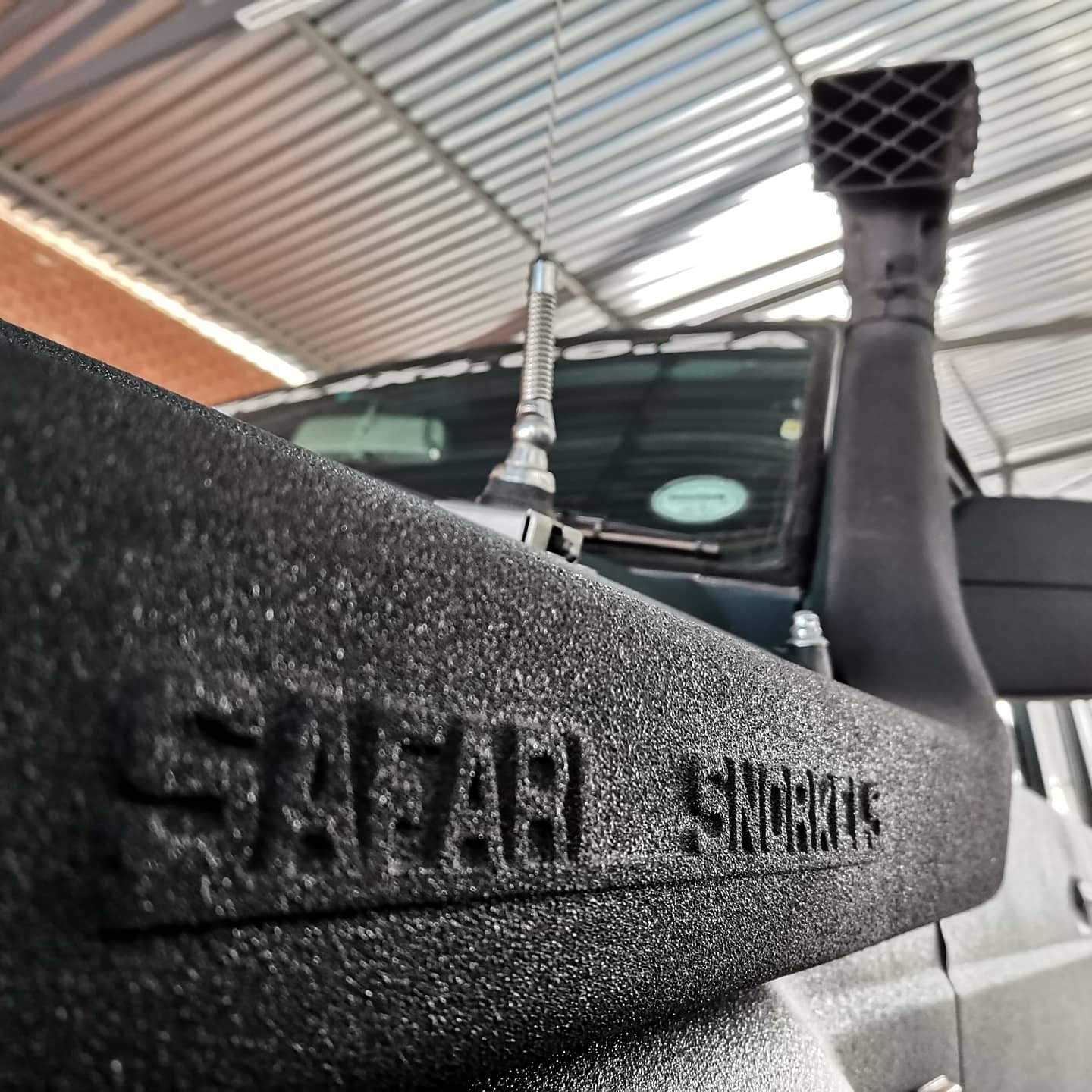

96 ST4.2 has a Safari Turbo & Intercooler fitted. This was done at 30 000km (Safari kit fitted at SAC in 99 when they were still the agents for Safari). The Ausie site quotes figures of 145 KW and 450 Nm.
A Front Safari intercooler. SAC het die sisteem in 97 opgesit - had the 76 mm exhaust on since 36k km
• Safari snorkel…

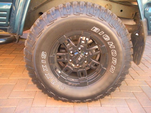

October 2009 - fitted pro white rims, painted black.

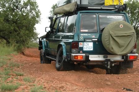

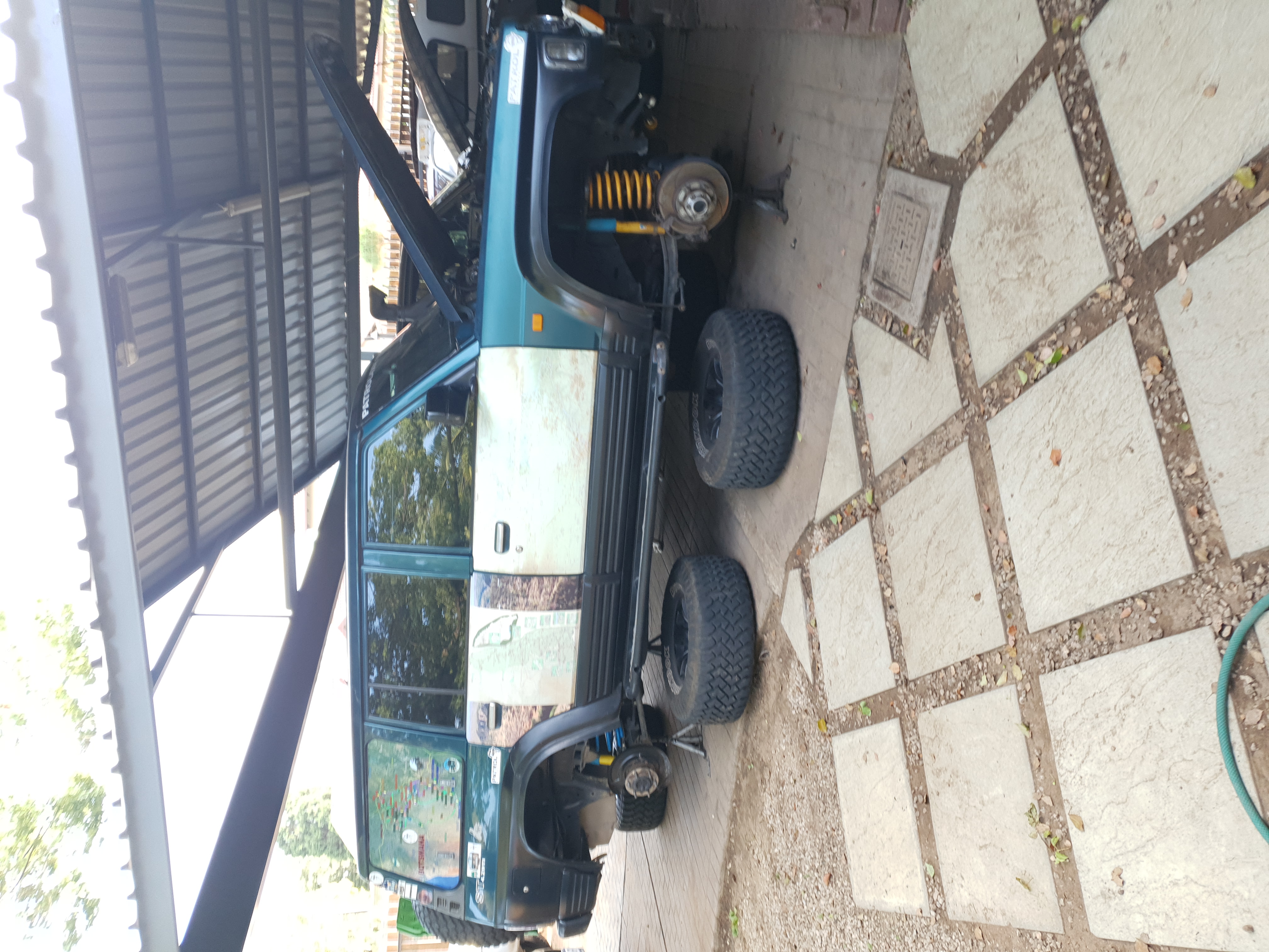

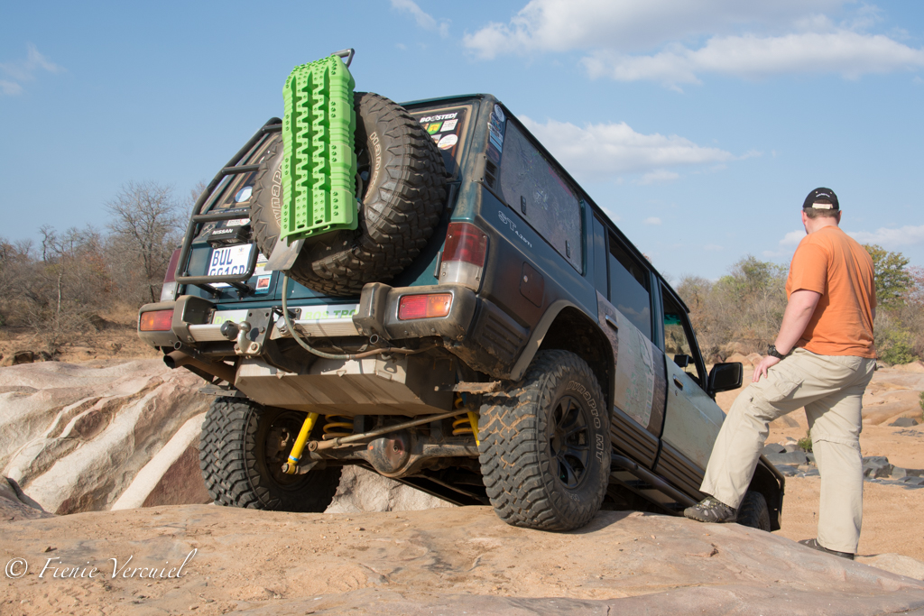

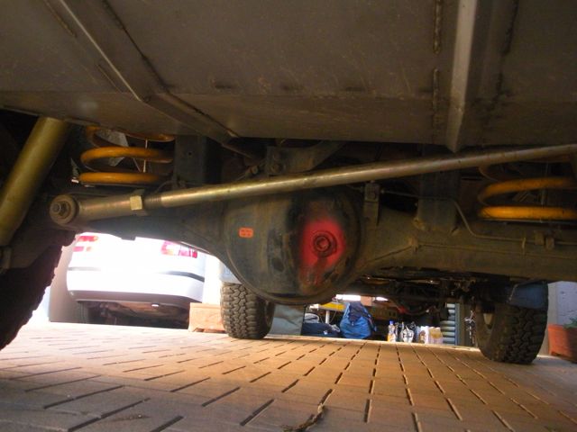

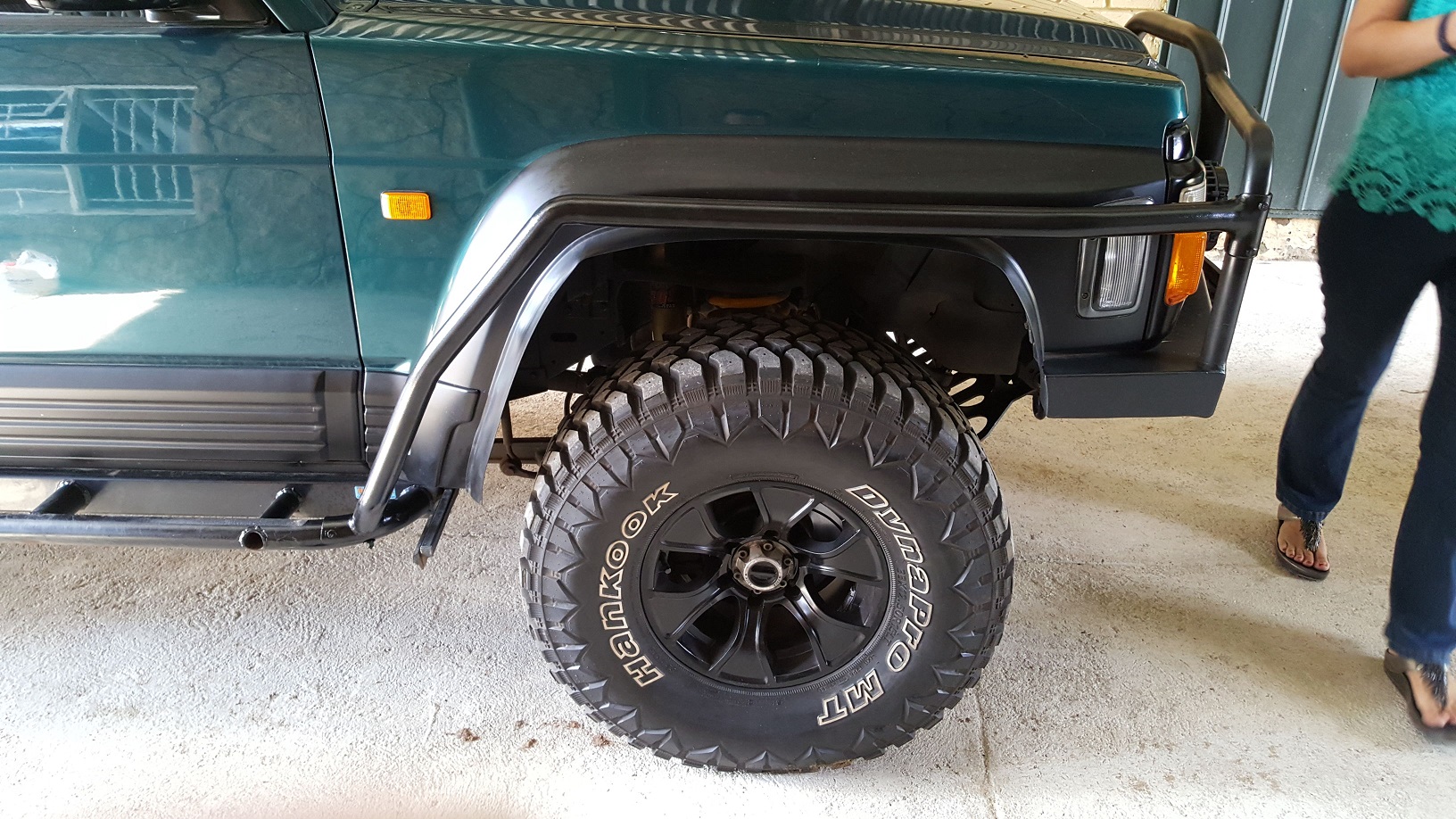

April 2010 - Lifting my GQ with a 90 mm XJS kit. The coils and shocks have been fitted, waiting for Panhard rods as the diff has moved around a 100mm to the right.
Castor correction kit is being fitted and should be in in a week.
Estimated lift from the OME 50 MM KIT IS N ADDITIONAL 100 MM.
August 2010 - Dyno at SAC Diesel is as follows, 360 000km
92 kW on wheels at 3000 rpm
376 nm at the fly wheel at 2200 rpm
November 2010 - spent R 4,100 for a clutch (had it's second clutch fitted at 345k km), pressure plate and thrust bearing from Nissan. It is an absolute must that the fly wheel get skimmed. Prior to the replacement I had excessive clutch juddering in first and second gear. Pressure plate was %$##%%^.
November 2010 - have 90mm gold Edition shocks(long travel) + coils + panhard rods, 3.5 deg caster correction and 100mm drop links for the anti sway bar.
Anything over 50 mm will require panhard rods, castor correction, extended barke lines and diff breathers as well as extended Swaybar links and extended bump stops.

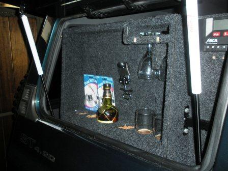

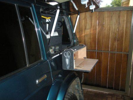

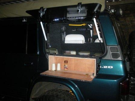

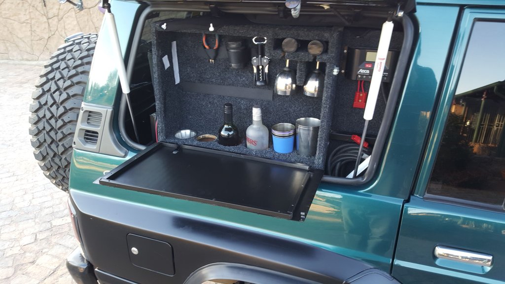

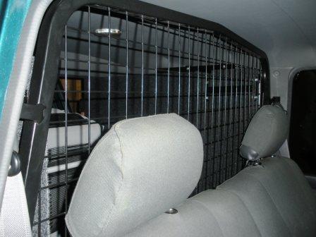

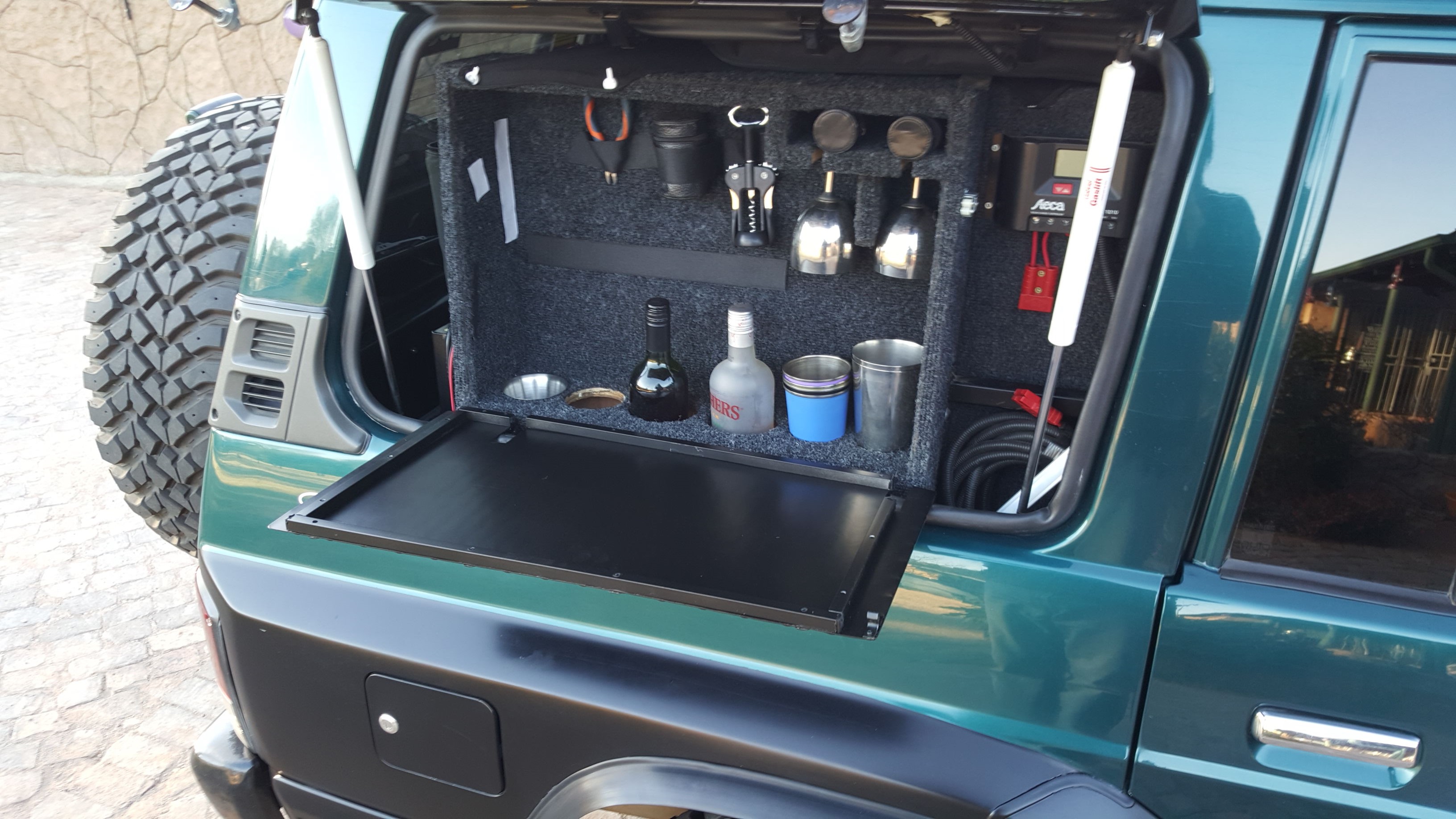

November 2010 - Other mods to date are, Gull wings (3mm steel) in the rear windows, Cargo barrier, IPF spots on the roof rack, Upgraded crystal head lights with 90/100w globes from NARVA.

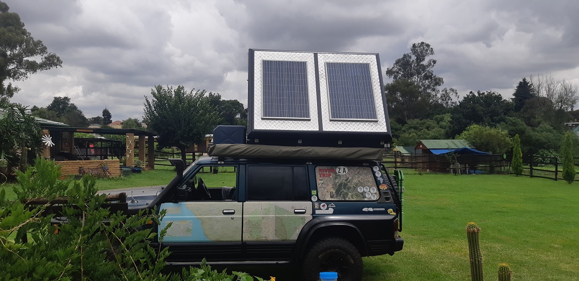

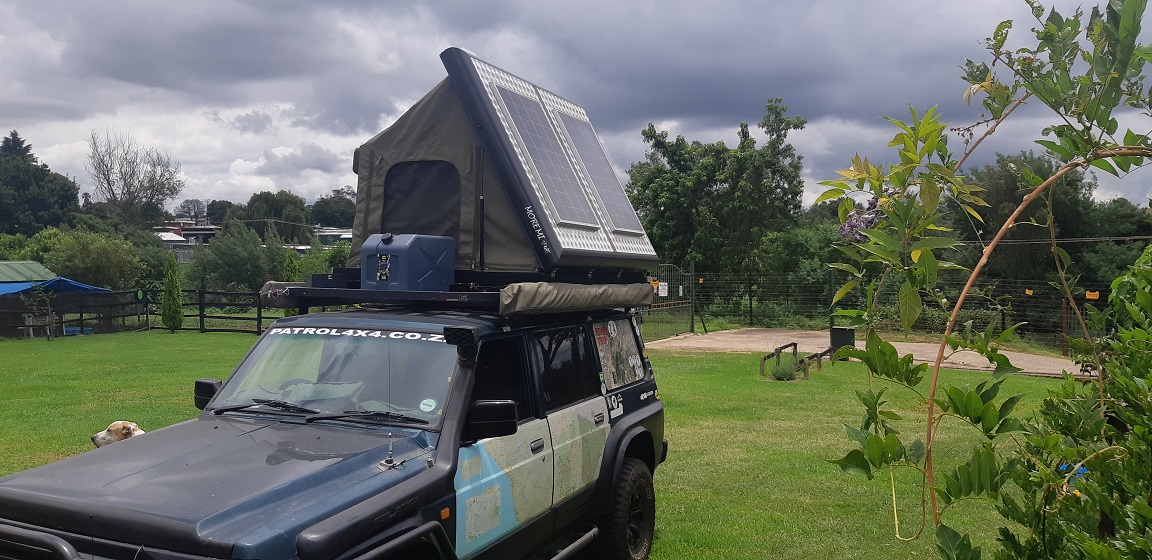

October 2012 - TENESOL 90 W panel fitted under the roof rack. Also a STECA PR 1010 digital regulator.

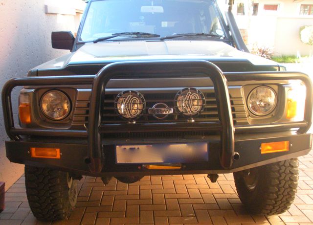

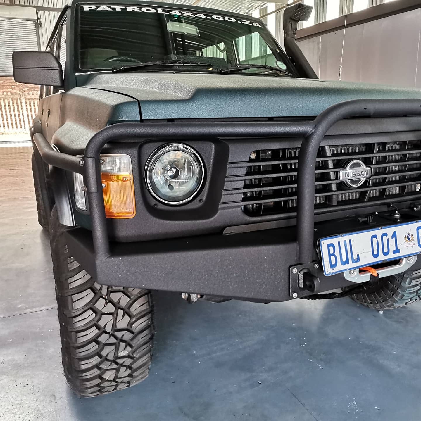

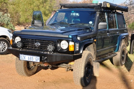

August 2014 - new custom bumper, removed the lights off the roof rack to be legal. Now have round 51W led lights on the bumper.
Fitted the Cetek DC to DC with two 95 amp hour battery's on a customer slider behind the rear seat.

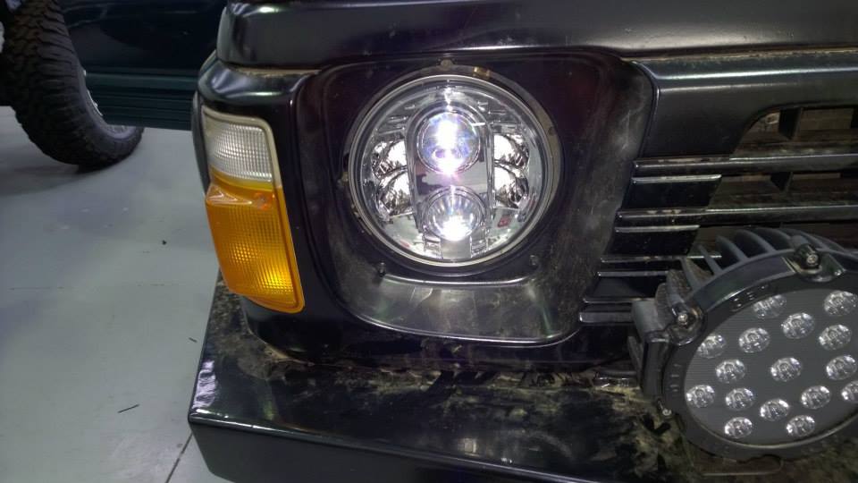

Sep 2014 - New head lights have arrived
Here are the specs on the new lights:
2800 Lumens on Low Beams
4450 Lumens on High Beams
6000K Colour

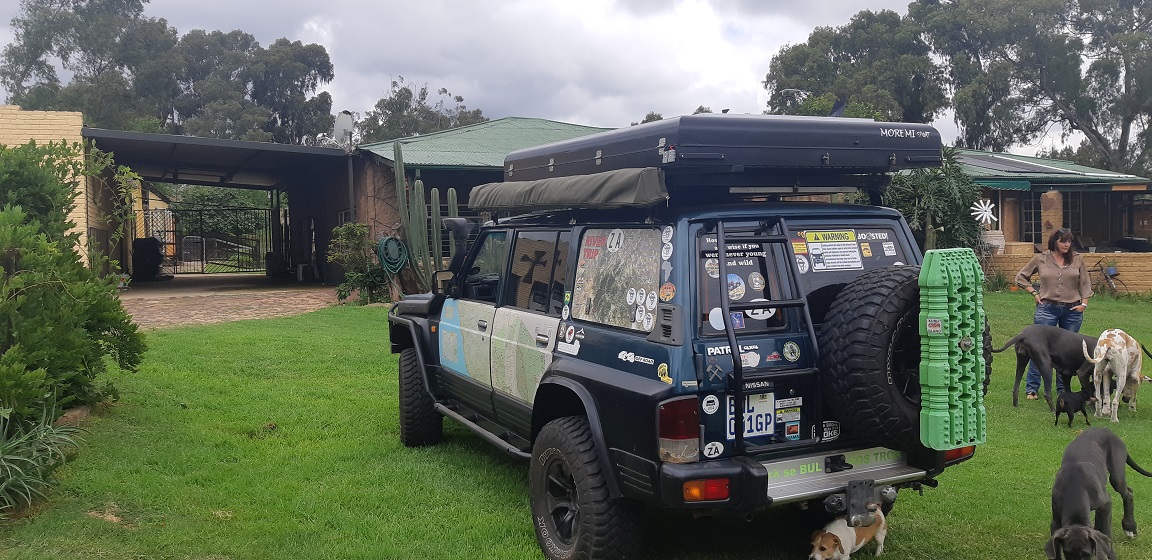

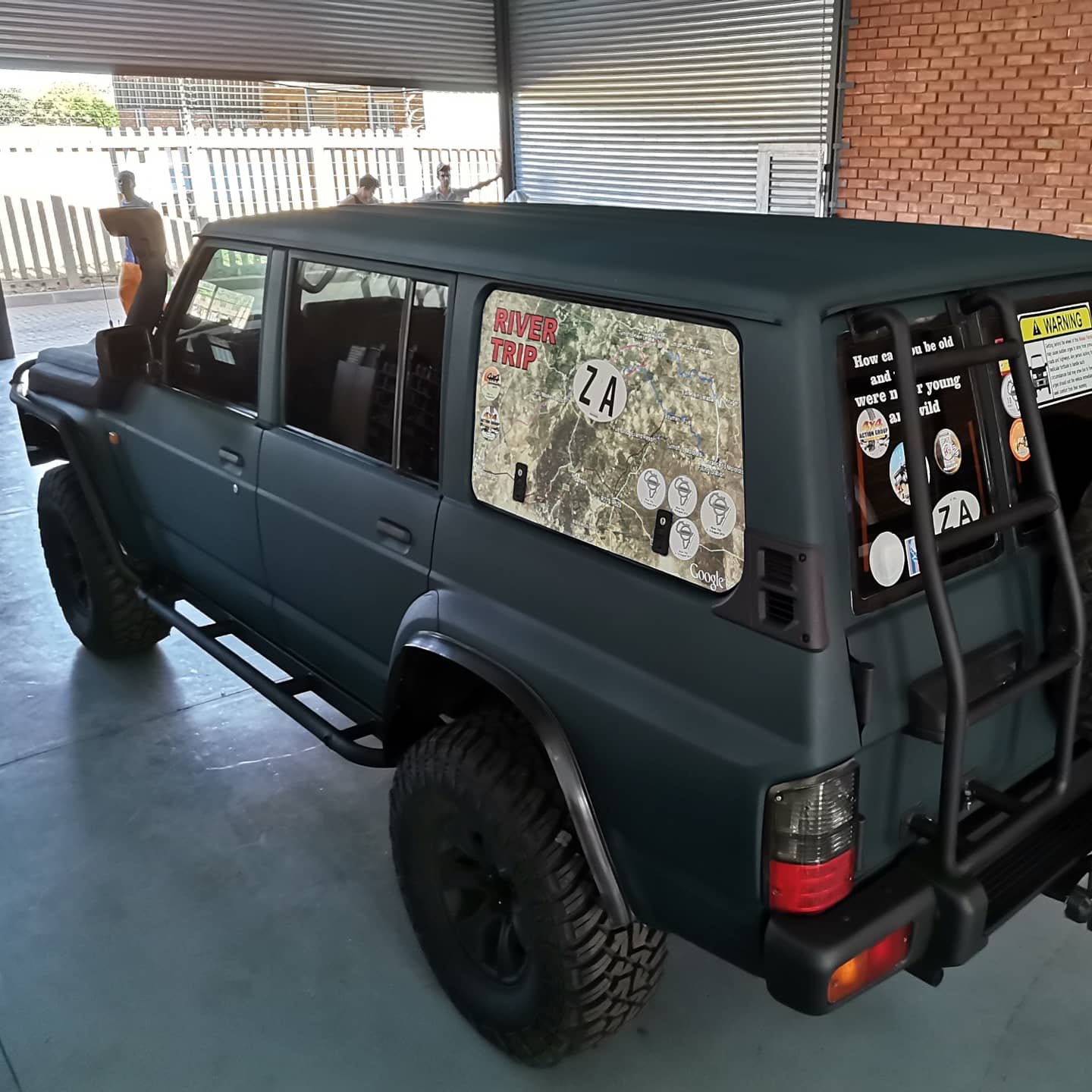

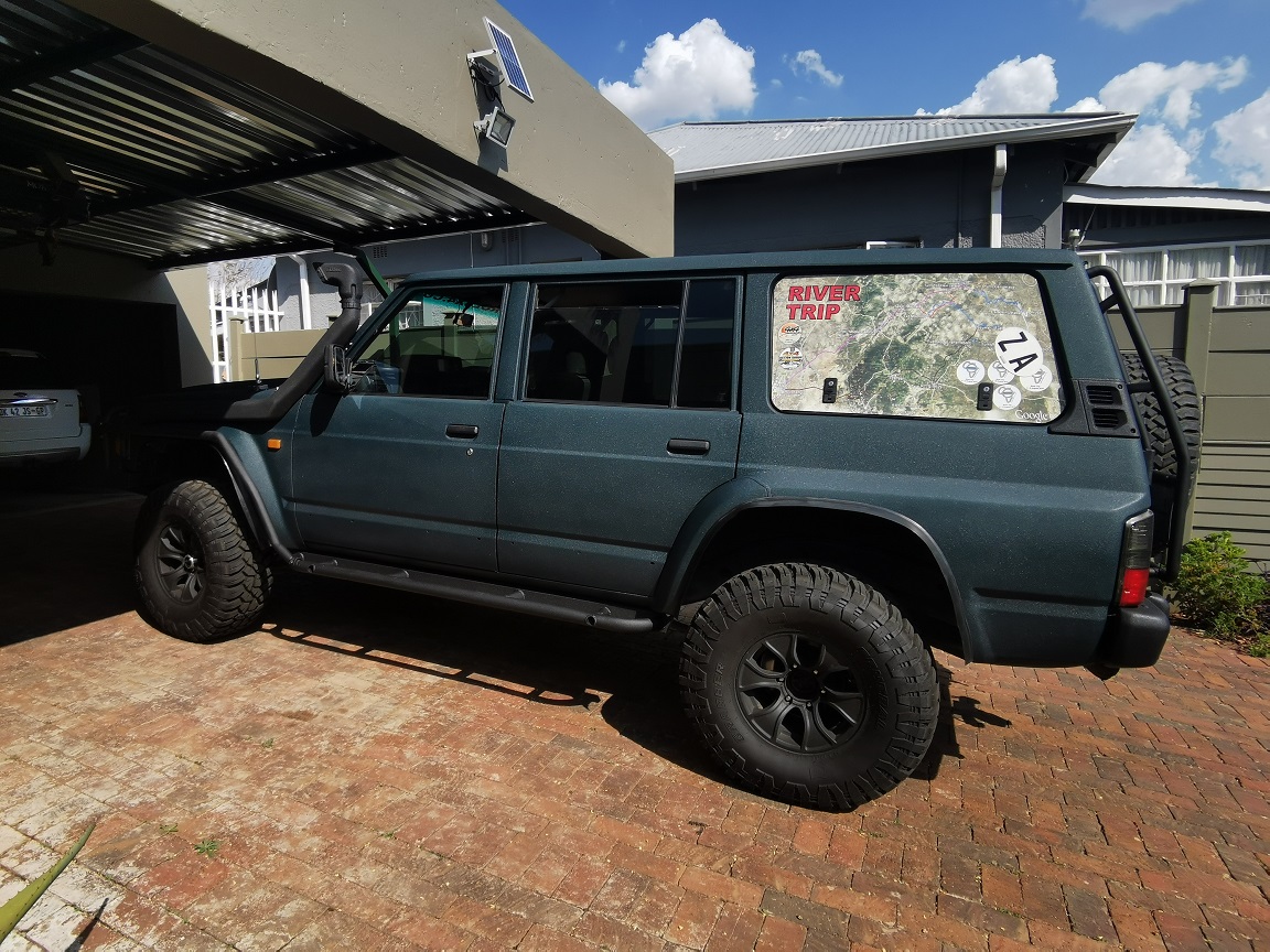

June 2015 – Sold to………… ME. 
July 2015 – Change back to 33/12.5/15 muddies.

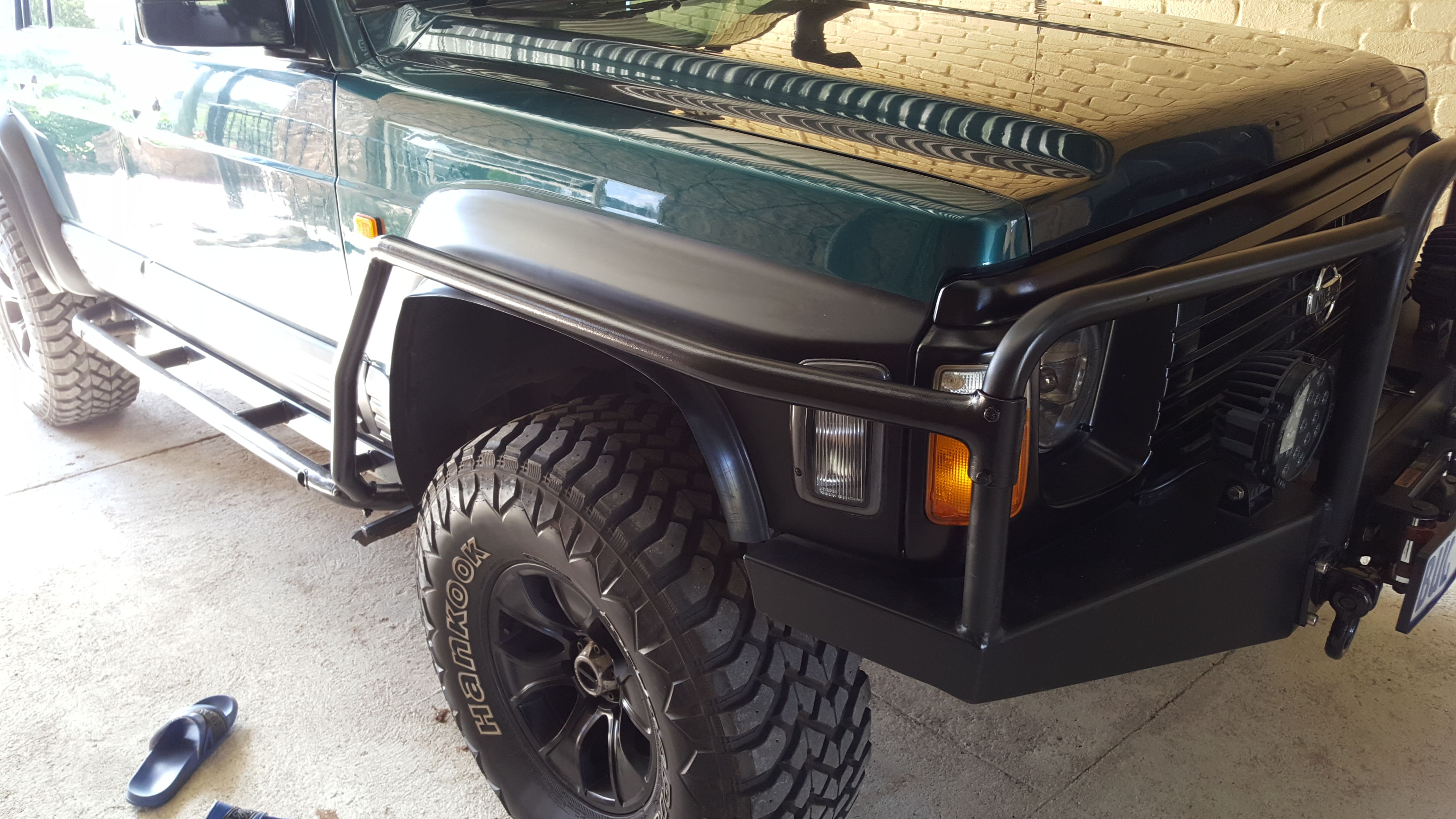

Sep 2015 – Upgrade Front bumper with bars to protect lights and radiator.

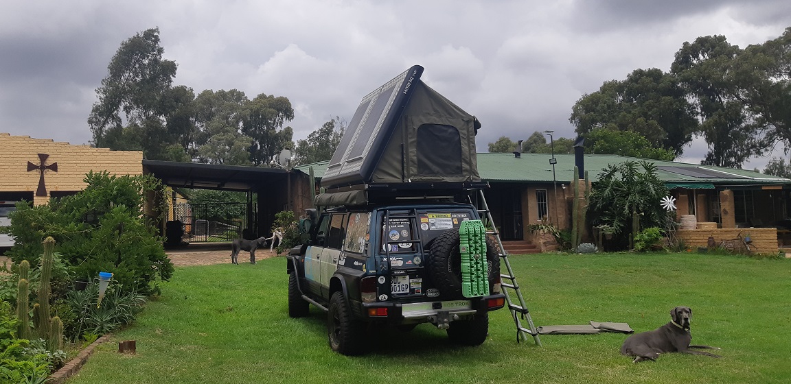

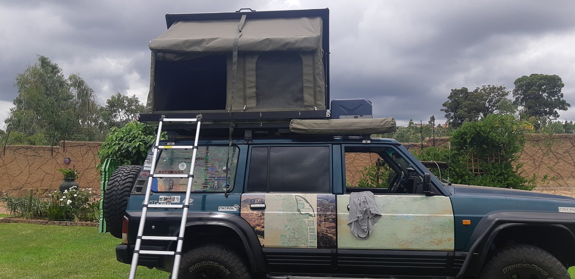

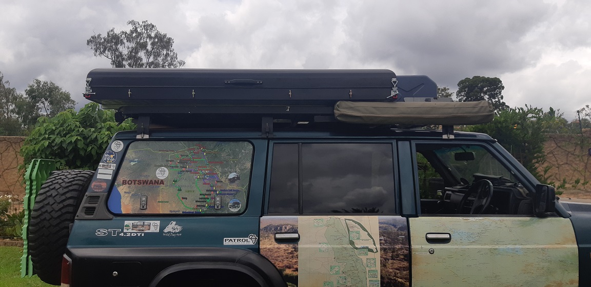

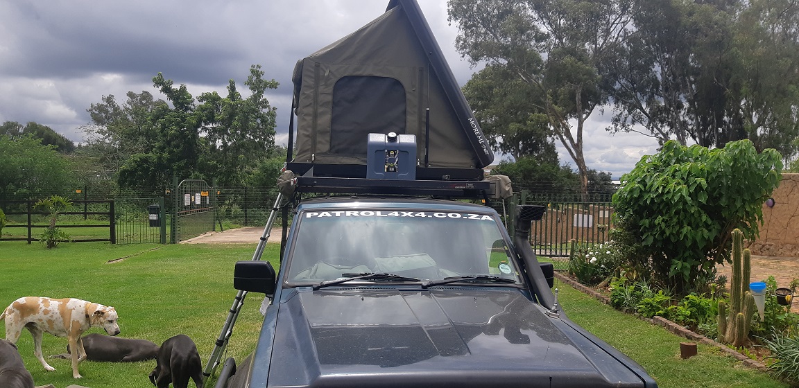

Jan 2016 – Fit howling moon double rooftop tent.
Feb 2016 - Full service (415,692km), Adjust front wheel bearing, re-connect Mad man, grease propshaft, check and test alternator (GTECH)

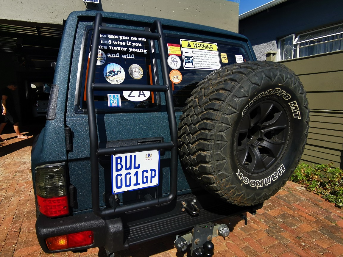

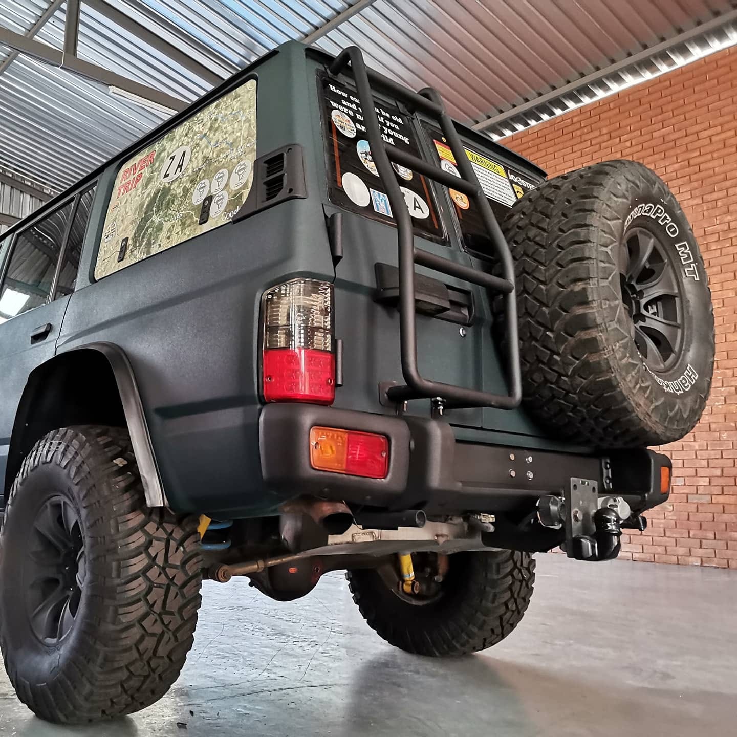

March 2016 – fit new headlights, Spray mags black as well as bottom of Patrol. Rear ladder and bush bars fitted.
August 2016 – Put maps on car and cover with Plasti dip

2017 – Fit rear camera and vintage horn.

New headlights with LED globes

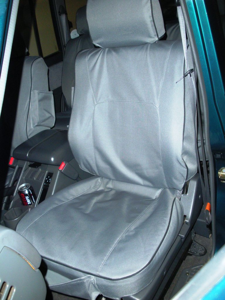

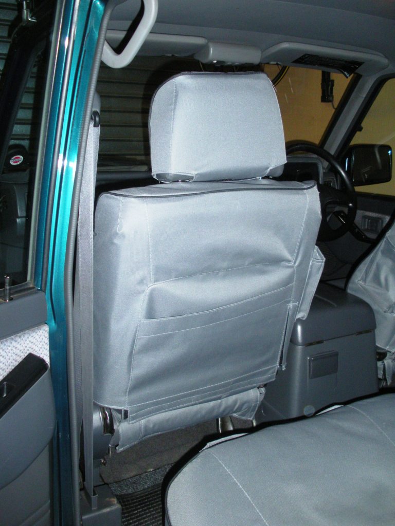

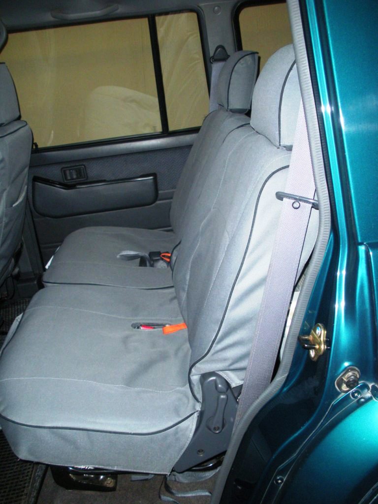

July 2018 Fit new seat covers and TPMS

Fixed gullwing and replaced all gas lifts on gull wings
Updated all solar to Blue Brad Harrison plugs (8)

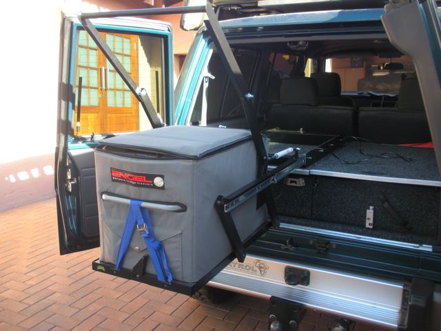

2x Fridge slides - spring latches attached

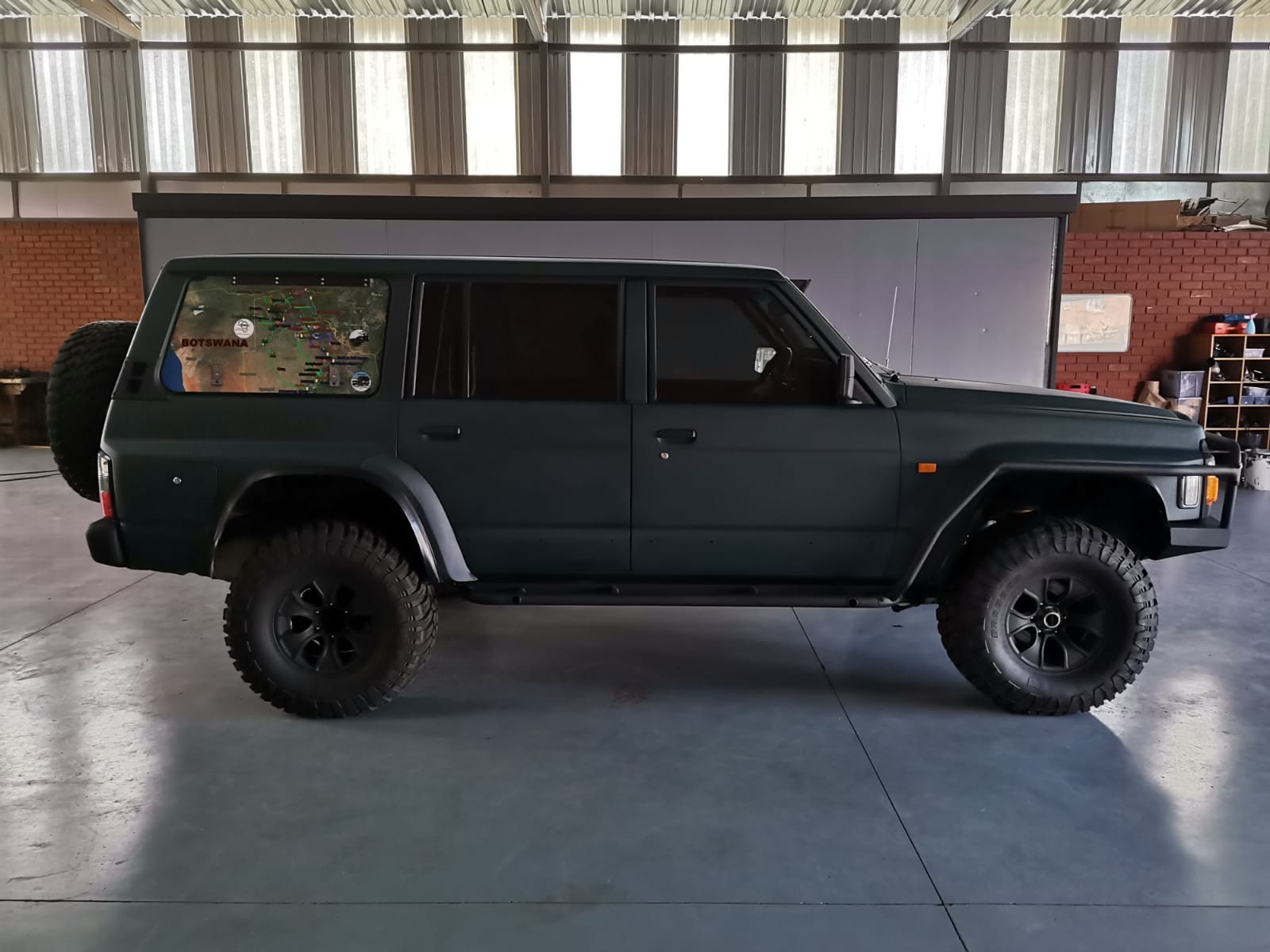

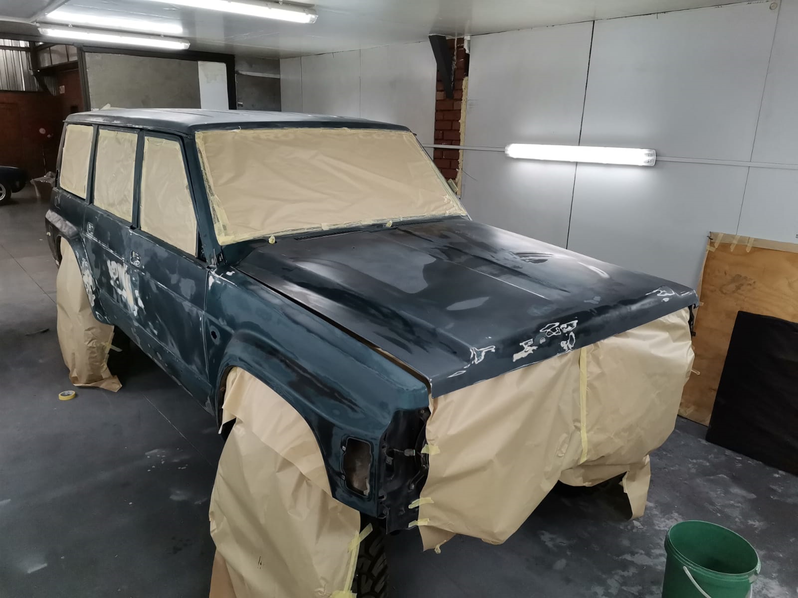

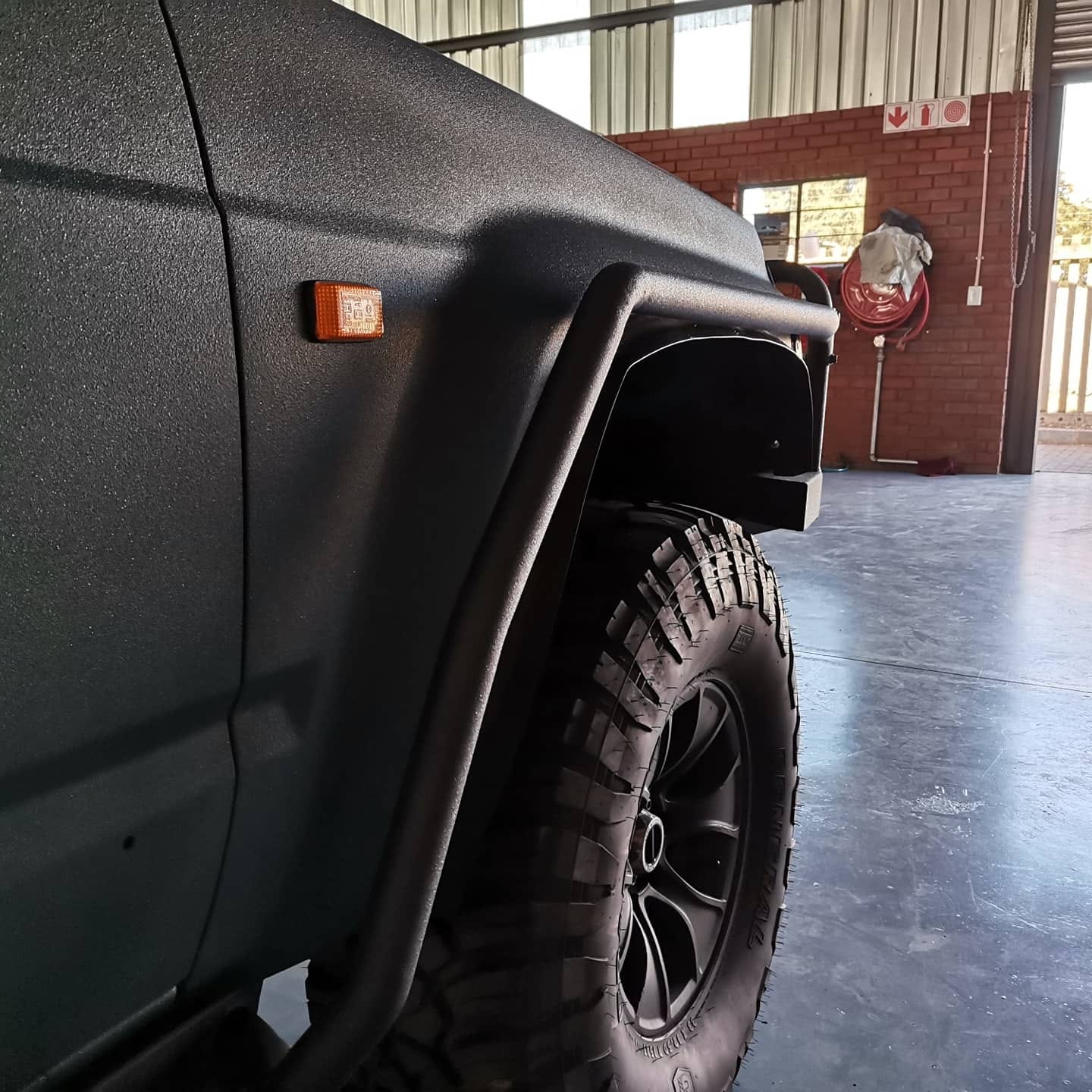

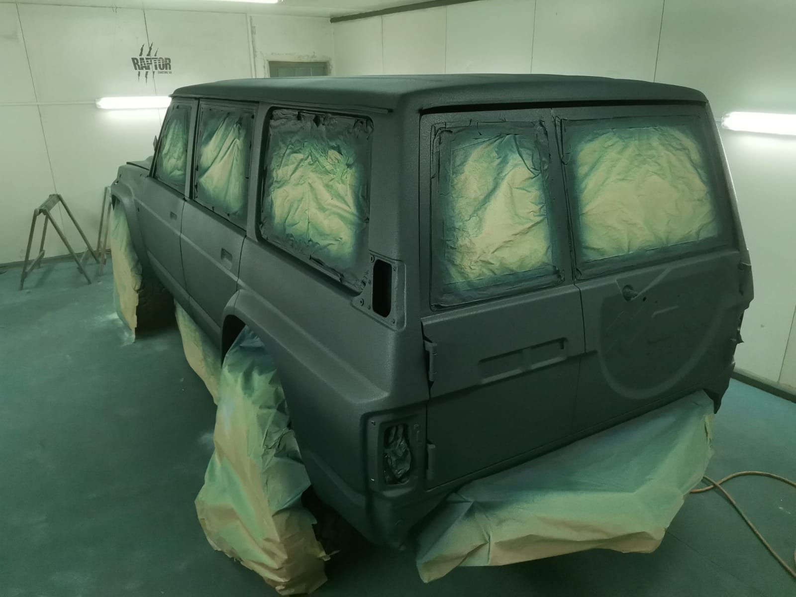

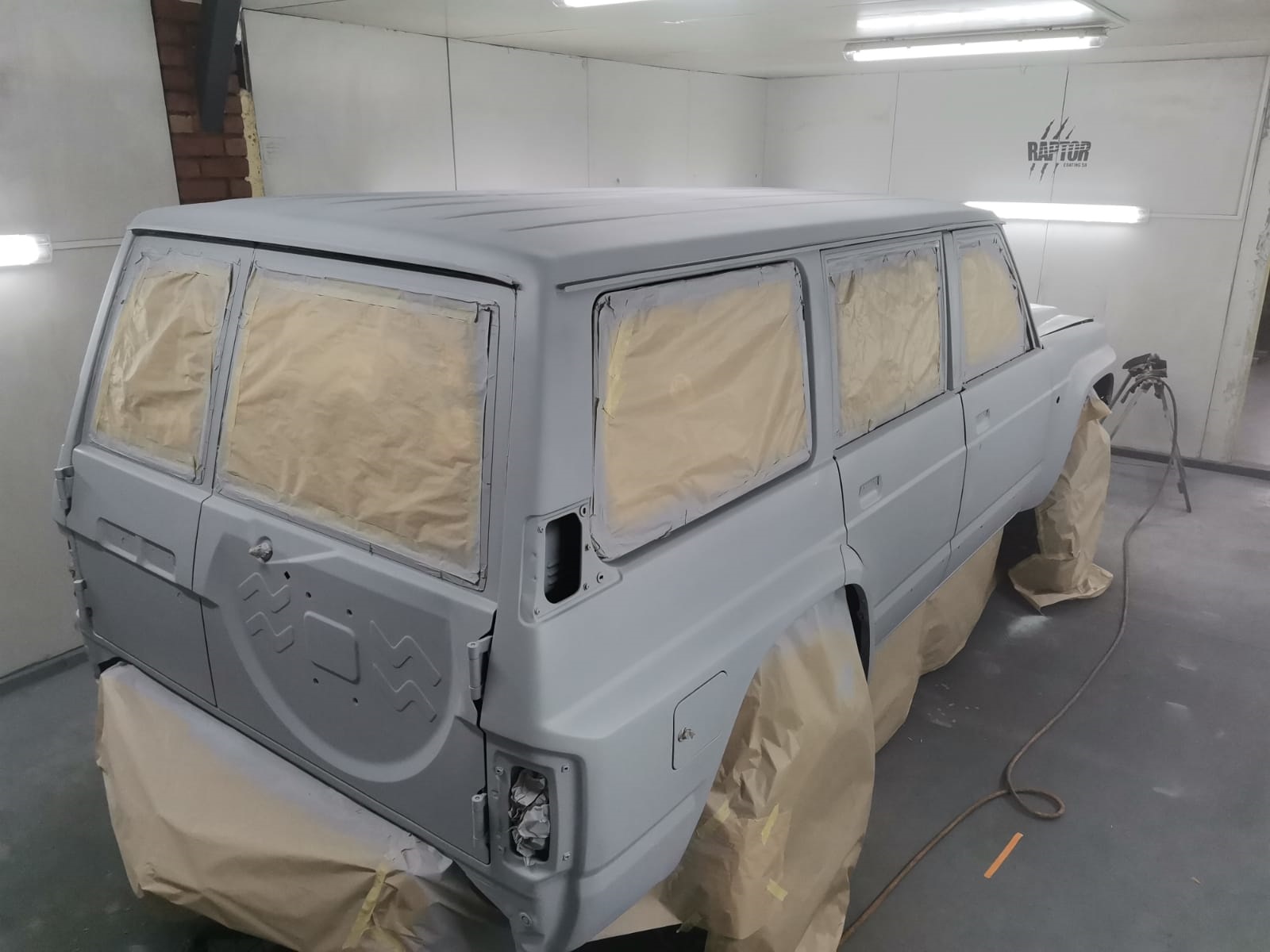

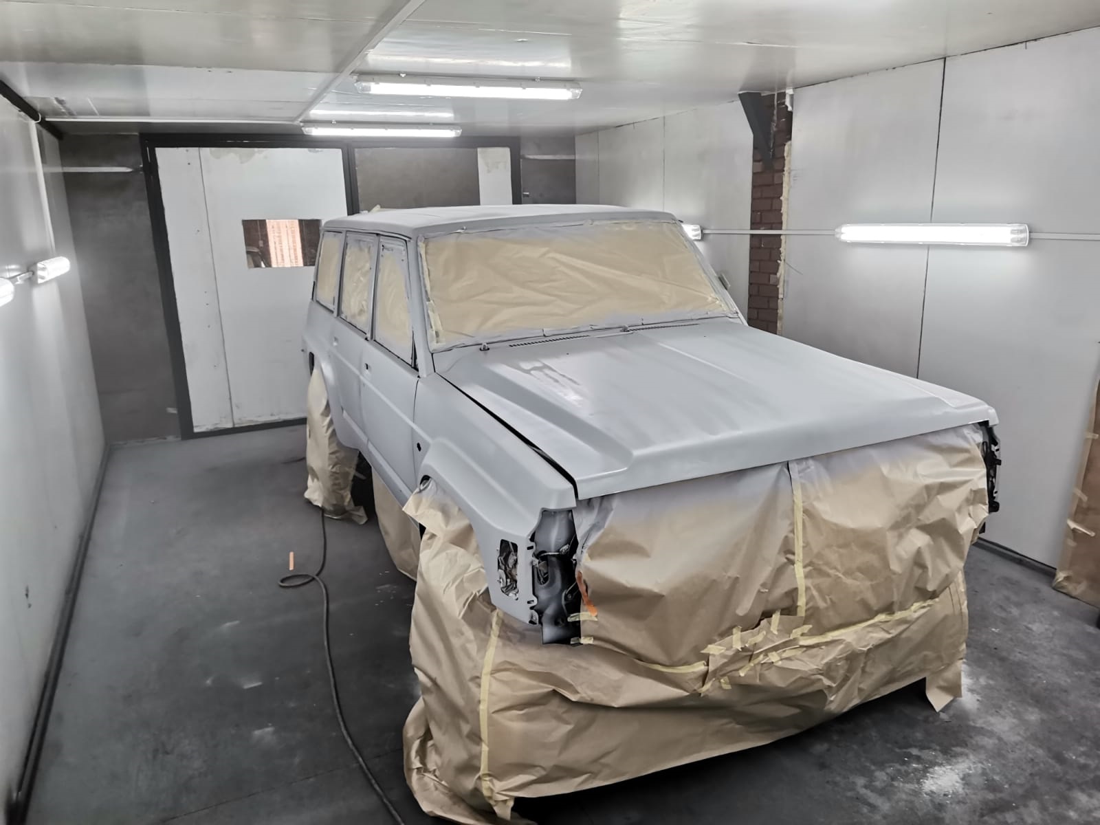

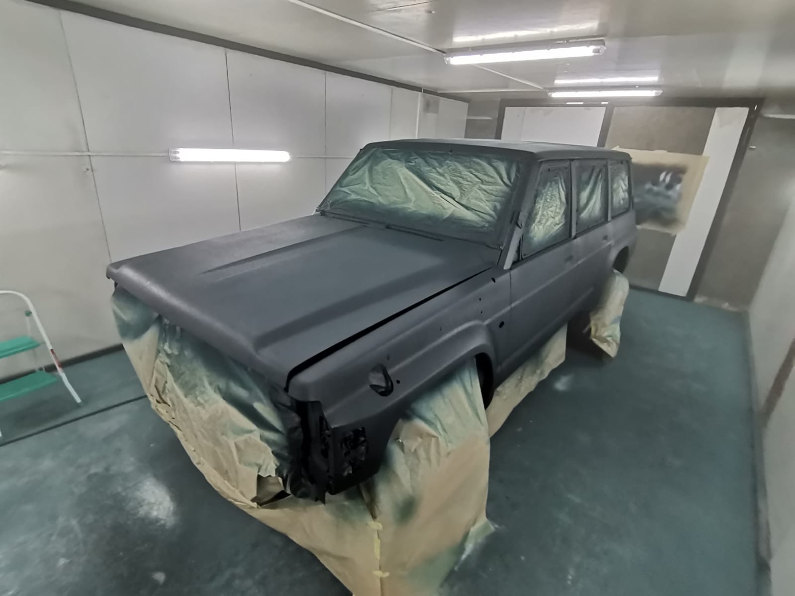

March 2021 - Badass Customs / Raptor SA
454 814km

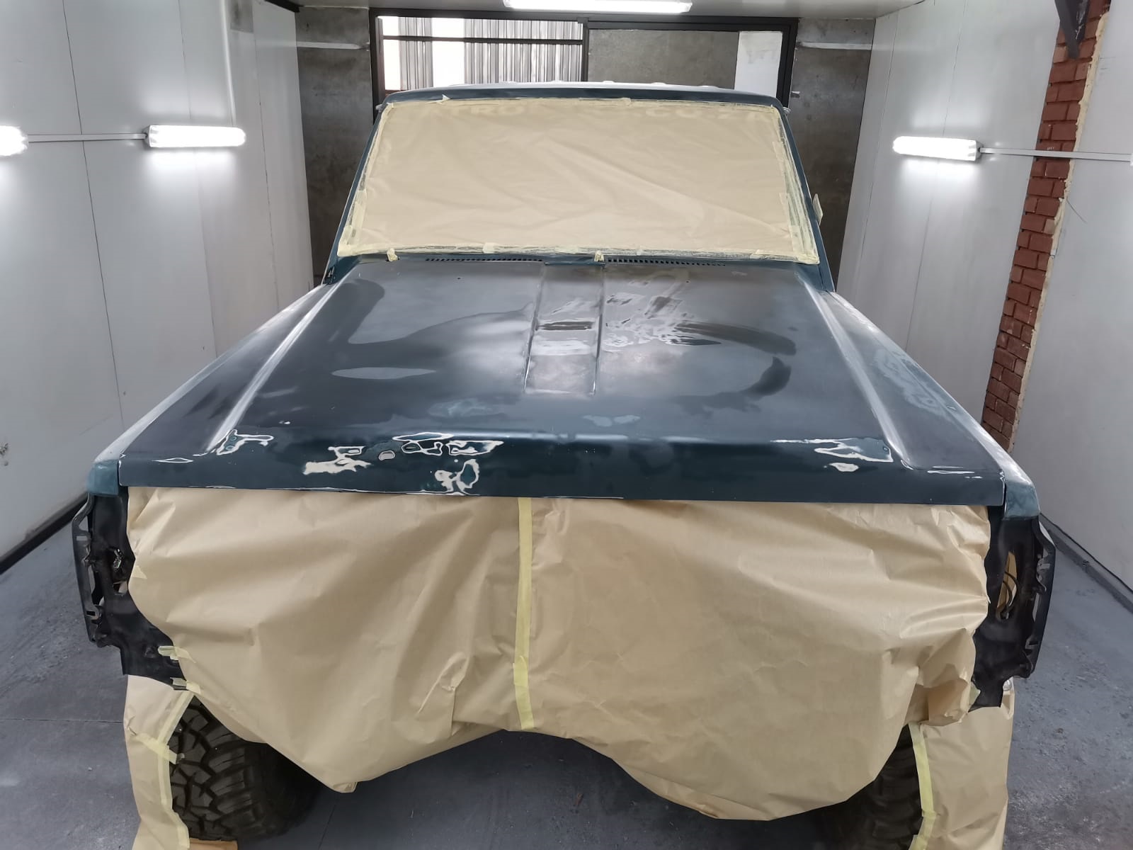

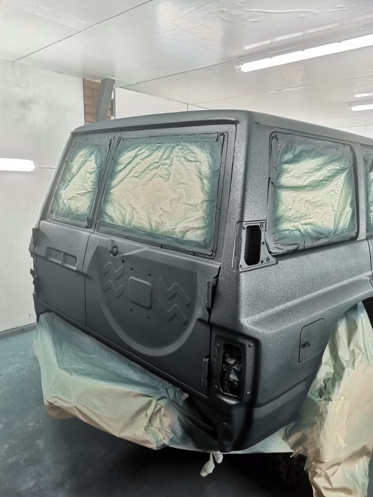

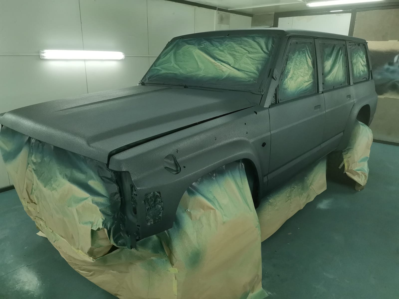

Raptor painted full vehicle

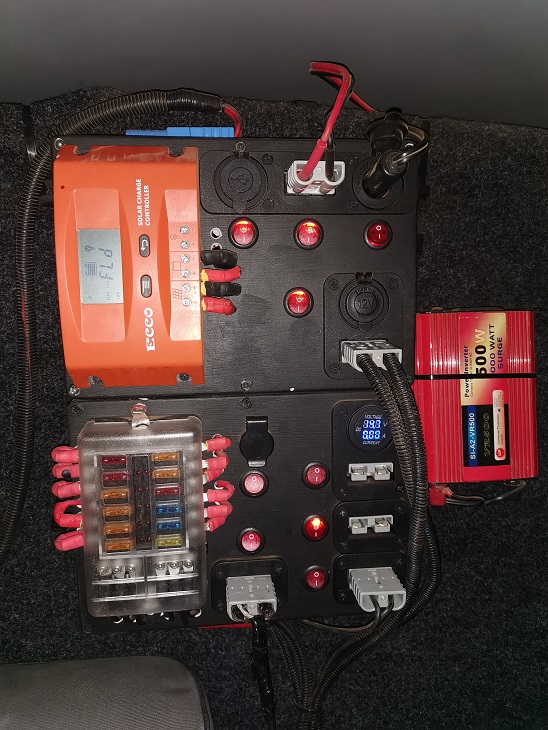

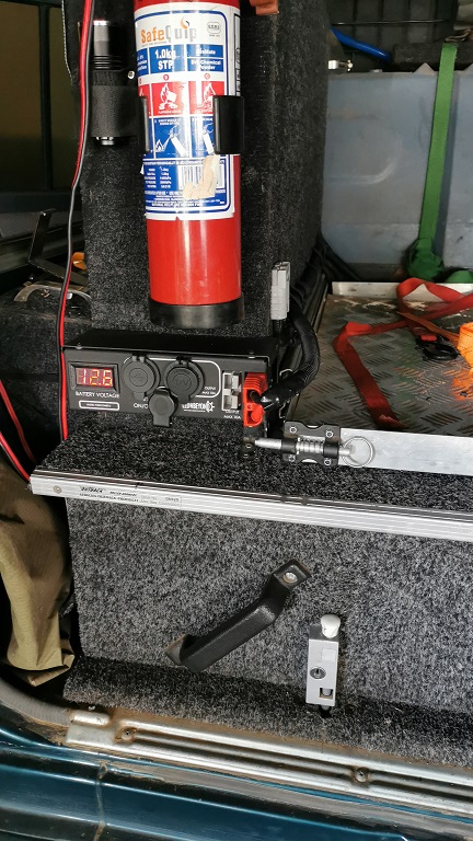

Power (12V) distribution box

Rear Coils from Terrain Tamer - 500kg

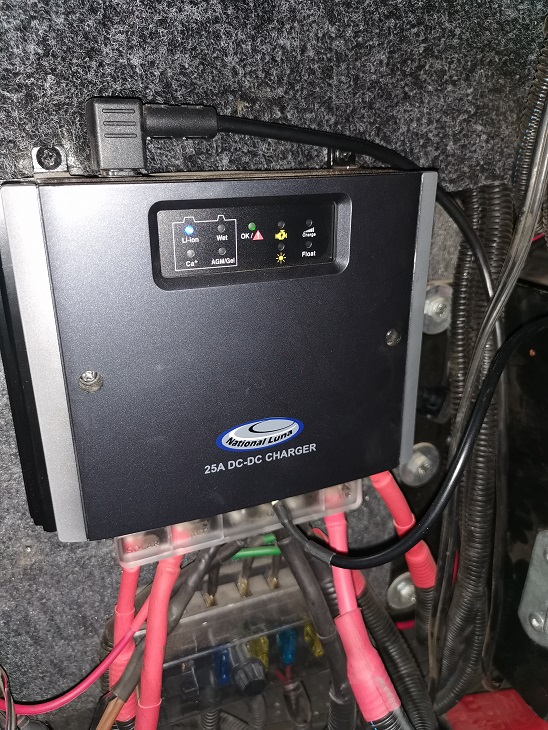

25A National Luna DC/DC with monitor
108A Blue Nova Lithium battery
Brad Harrison plugs fitted to Gullwing to connect rooftop tent to vehicle

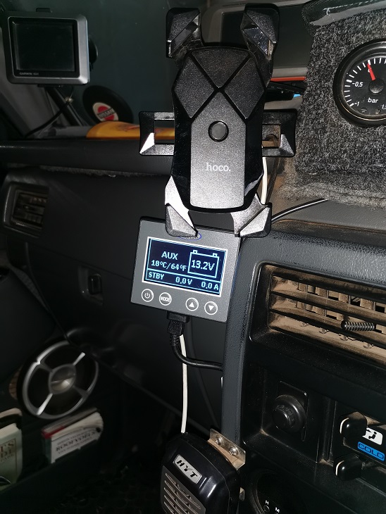

Fit new Victron Smart Blue 15A charger
Fit circuit breaker to Aux battery supply, to isolate LiPo battery

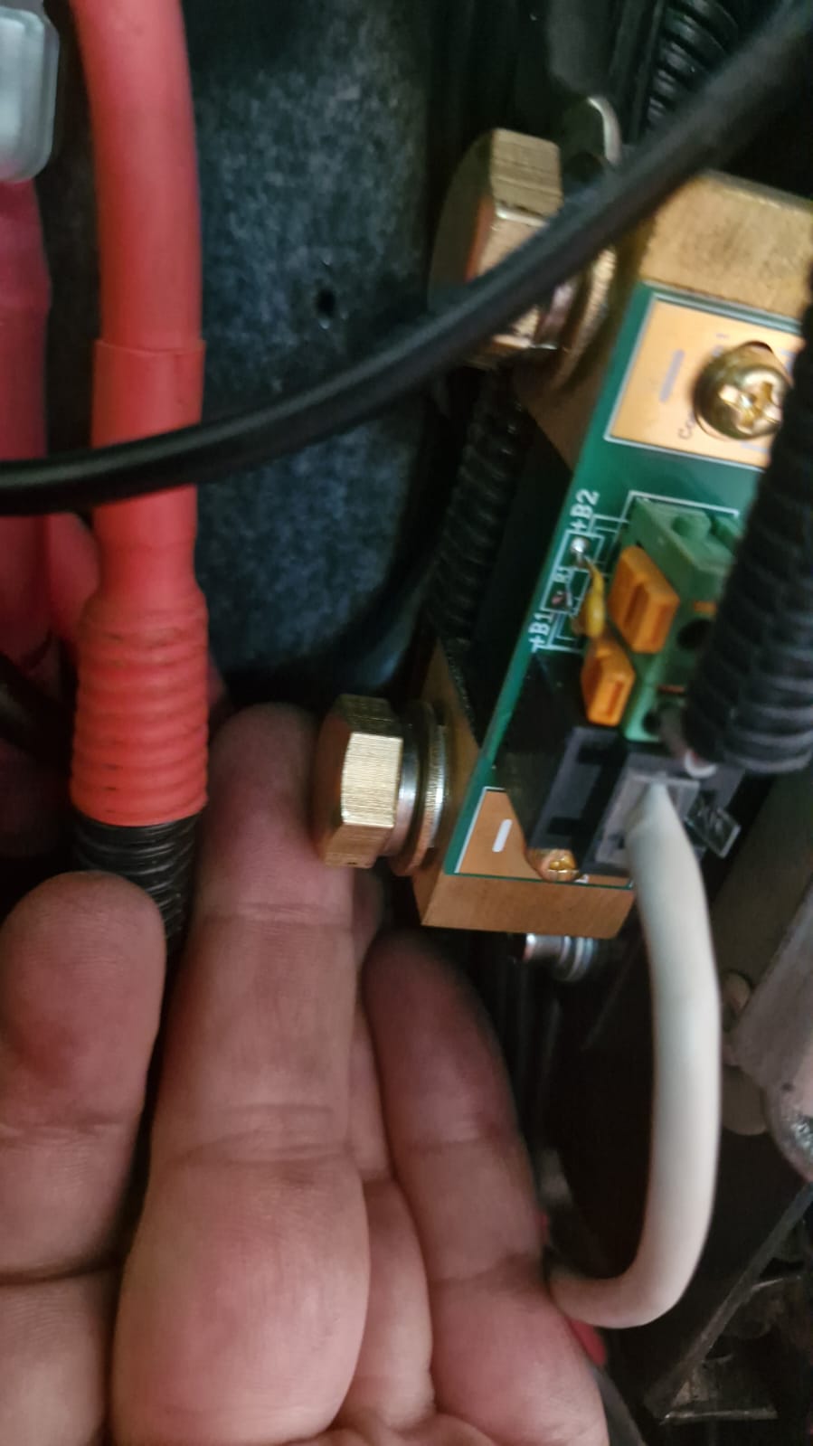

Fuse holder and fuse
Drain oil and fill with new oil
Fit new fuse holder
Make new cable from fuse holder to New isolator
Modify unused bracket to fit new isolator
Fit new terminal on cable to dual battery
Mount Isolator

Fit shunt and modify ground cables to suit

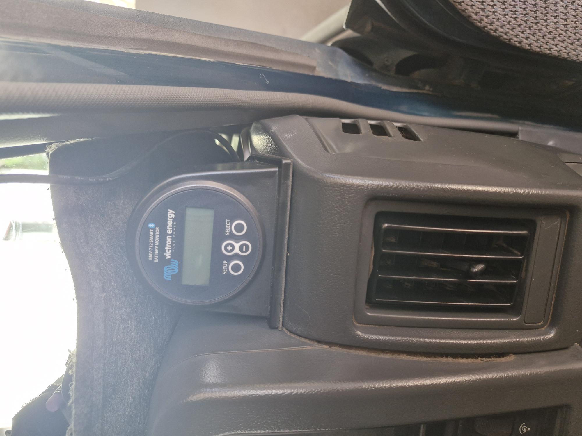

fit and wire Victron display in gauge pod on dash
Fit new 10mm cables with victron charger plug from starter battery to rear cabin

7. 4 inch lift - 500kg constant rear coils and 150 smart progressive in front - Terrain Tamer
8. Bilstein shocks
9. Drop boxes
10. Pan hard rods

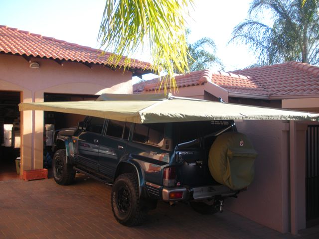

13. 270 Eezi awn awning…
Uthuli Seat covers 1.jpg (129.95 KiB) Viewed 14806 times
Uthuli Seat covers 2.jpg (141.86 KiB) Viewed 14806 times
Uthuli Seat covers 3.jpg (138.73 KiB) Viewed 14806 times
Aug 2010 Outback drawer with drop slide.jpg (54.22 KiB) Viewed 14806 times

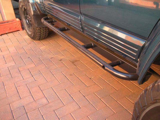

Aug 2010 Rock sliders with jack points.jpg (57.93 KiB) Viewed 14806 times
Aug 2010 TJM 110mm Lift with Panhard rods.jpg (44.35 KiB) Viewed 14806 times
Aug 2010 TJM Bar with KC spots.jpg (54.2 KiB) Viewed 14806 times

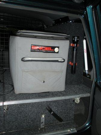

Jan 2011 - 40L Engel fridge.jpg (42.15 KiB) Viewed 14806 times
Jan 2011 Bar unit with gull wing.jpg (46.99 KiB) Viewed 14806 times
Jan 2011 Cargo barrier.jpg (41.03 KiB) Viewed 14806 times
Jan 2011 Gull wing.jpg (39.89 KiB) Viewed 14806 times
Jan 2011 Kitchen with gull wing.jpg (36.85 KiB) Viewed 14806 times
Aug 2014 New custom bumper.jpg (112.71 KiB) Viewed 14806 times
Sep 2014 new headlights.jpg (55.27 KiB) Viewed 14806 times

Some new additions to the Troll.
Sold the double rooftop tent, tried a clamshell and then got myself this Moremi Sport Hard top tent.
Added 2 x 100W solar panels to the tent, wired with 2x lights and usb sockets inside.
Replaced the cover of my awning as it had teared and the zip stripped.
Got myself one of those drop down showers fitted on the side of the roof rack, fitted to a Fernlock slide if I don't want the shower right next to the front door.
On the roofrack I fitted a gas bottel, 60L of water and an Alvava Gas shower.

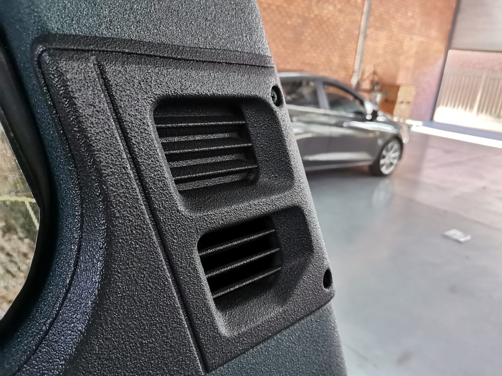

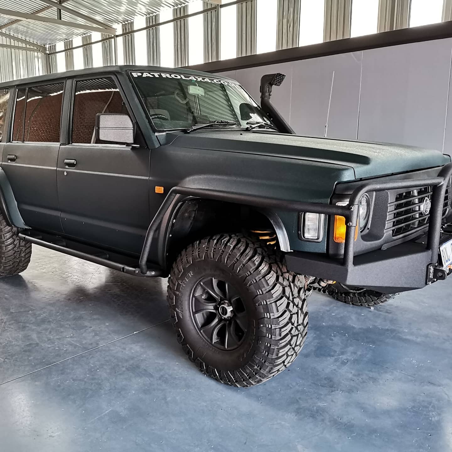

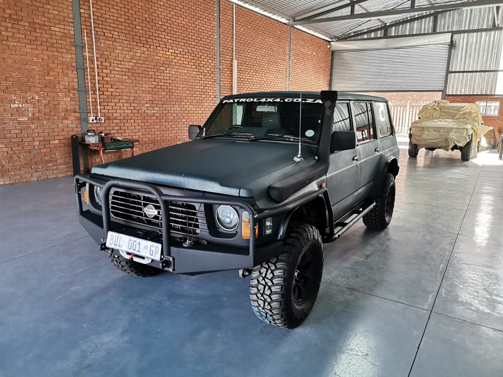

So the GQ had some TLC in the form of a respray with Raptor.
Prep 2.jpg (248.3 KiB) Viewed 10031 times
Prep 1.jpg (233.63 KiB) Viewed 10031 times
Undercoat 1.jpg (225.4 KiB) Viewed 10031 times
Spray 4.jpg (114.46 KiB) Viewed 10031 times
Spray 3.jpg (122.1 KiB) Viewed 10031 times
Spray 2.jpg (149.56 KiB) Viewed 10031 times
Spray 1.jpg (98.8 KiB) Viewed 10031 times

So the latest update was a DIY project that I decided to do myself.
Power distribution panel - with a Solar controller (backup to DC/DC just in case)
Also built in a small one at the back as one can apparently never have enough power points QQQ
Power back.jpg (253.35 KiB) Viewed 9522 times
Power panel.jpg (261.3 KiB) Viewed 9522 times

Re: My GQ and its history.......
Long story short, my C-tek trickle charger moved on....., two 90A batteries moved on..... :doh: :doh:
So it was decision time, do I get another two 90A batteries and replace the C-tek or do I upgrade to current technology??????
After a lot of questions, and reading up on Lithium, I bit the bullet and updated my whole charging system - or should I say Ant's custom workshop :biggrin:
As always the work performed was of the highest quality, and installed the way I wanted it done as opposed to just straight forward.
Firstly got a 108A Blue Nova Lithium battery.
Replaced my C-tek 250S with the National Luna DC/DC which is Lithium ready, and the price at Bushpower included the monitor which was then a no brainer.
This was installed by Ant and worked a charm on the Goerapan trip and 9 day camping trip shortly after.
Next I did my research on the trickle charger that died and came to the conclusion that Lithium does not like trickle charging and neither does it like to be "stored" at 100% charged. So previously my system was set up that the C-tek was plugged in when the vehicle is not used and the charger would maintain the 2 90A batteries as well as my starter battery.
So now the question begged how do I have a system were the starter battery can be maintained without also giving charge to the Lithium battery.
Secondly, if I go camping and there is 220V I would like for everything to still run through my 12V system over an extended period without having to rely on solar as most places have nice spots under big trees or shade net and solar might not operate optimally, or I take a trailer and not the rooftop with attached solar panels.
Solution - Installed a 15A Victron Smart Blue charger which is directly connected to the Lithium battery (and not via the DC/DC as was previously the case), I can thus charge my Lit battery to full just before a trip, and also connect it to 220V at a camp site and it will keep the battery charged whilst I run fridges and lights from 12V over an extended period.
As for the main battery I will connect a 5A C-tek trickle charger to maintain it over periods where the GQ is not used. BUT, it must not charge the Lit via the DC/DC and here ANT installed a "circuit braker" for me that isolate the main battery from the second battery which allows me to use the trickle charge to just maintain the starter battery and as a bonus I can also now drive the Patrol and the DC/DC will not charge the lithium on short trips or if 12V charging is not required.
So now I have basically my 12V system set up in such a manner that I can charge via Alternator, 220V, Solar and all systems are separate from each other and I can chose when or what system will do the charging.
Lastly I replaced my backup/separate solar charger with a new solar charger that is also Lithium specked.

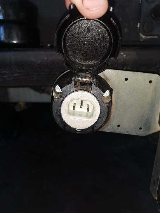

220V input.jpg (164.98 KiB) Viewed 8476 times

Just an update on the GQ
Had some major TLC from Ants customs the past few months (updated on post 1 were I log all that is done on the GQ)
As for the "extra's"
Had some - 2mm swaybar links with Rose joints x2 fitted to replace previous one's that was not working as well as intended.
The Lithium battery and setup ha been working a charm and spending 9 days in the Kruger I did not need to plug in to mains once for the duration of the trip.
The only difficulty, if one can call it that, is that the Lithium provides power for 90%plus of the time at a constant Voltage so it makes it almost impossible to know exactly what the charge rate or state of charge is upuntil it reaches the 90% discharge and then drops rappidly. So the question was how can I measure what goes into and out of the battery and see at what level of charge it is sitting.
Did some homework on the subject and decided that a shunt seems to be the answer to my questions. Bought the Victron 500A smart shunt and Ant's Customs was called upon - Fit shunt and modify ground cables to suit, and fit and wire Victron display in gauge pod on dash - Bob's your uncle and now I can see exactly what is going on with the 2nd battery on either the gauge mounted on my dash or if one wants to play around it is also Bleutooth connected through the app on my phone. As always Ant did a stellar job and all is neatly installed.
Also fitted a set of Stedi spotlights to front bumper with a nice low profile so no interferance with the airflow to the radiator.
Along with all the maintenance the GQ is ready to go for another few thousand worry free kilometre's.
