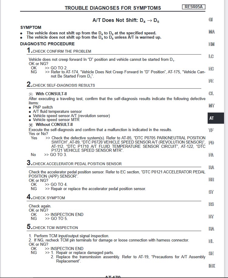

Re: 4.8 Auto box
Ernie, going on vague memory here because my brain is now full and I now only memorise what I'm currently trying to solve not what I notice in peripheral vision along the way
Shortened story....When I was fault-finding non-gearbox related stuff on my GRX I discovered somewhere in the multitude of editions of the manual that there is a fairly thorough fault finding section for the auto box and there are many solenoids n wotnot that operate the various functions. "If it goes into this gear but not into that gear then this solenoid is the problem"..."If there is a delay in down-gearing under X condition in Y gear then check such-n-such circuit" etc etc. Your problem may be very basic!
If you take the trouble to cross reference the manual editions, which can get complicated but that is another story, pretty sure you will find the info you're looking for
Is the 4th to 5th problem while driving in Auto or Tiptronic?

Re: 4.8 Auto box
I had a scratch around and this is the first reference to the problem that I found. There are probably more instances in the various editions. Enough to give you a clue that it might be a minor electrical gremlin
- Screenshot 2022-05-05 163604.jpg (168.55 KiB) Viewed 6023 times
